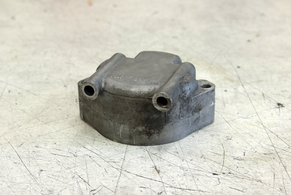

Then I cleaned the insides of end covers, sealed them and proceeded with outer sides.
I could have them polished, but the general idea was to make them look “new stock” so I just refreshed them. As you may see, I removed the output shaft and bearing to clean the end cover through and out.

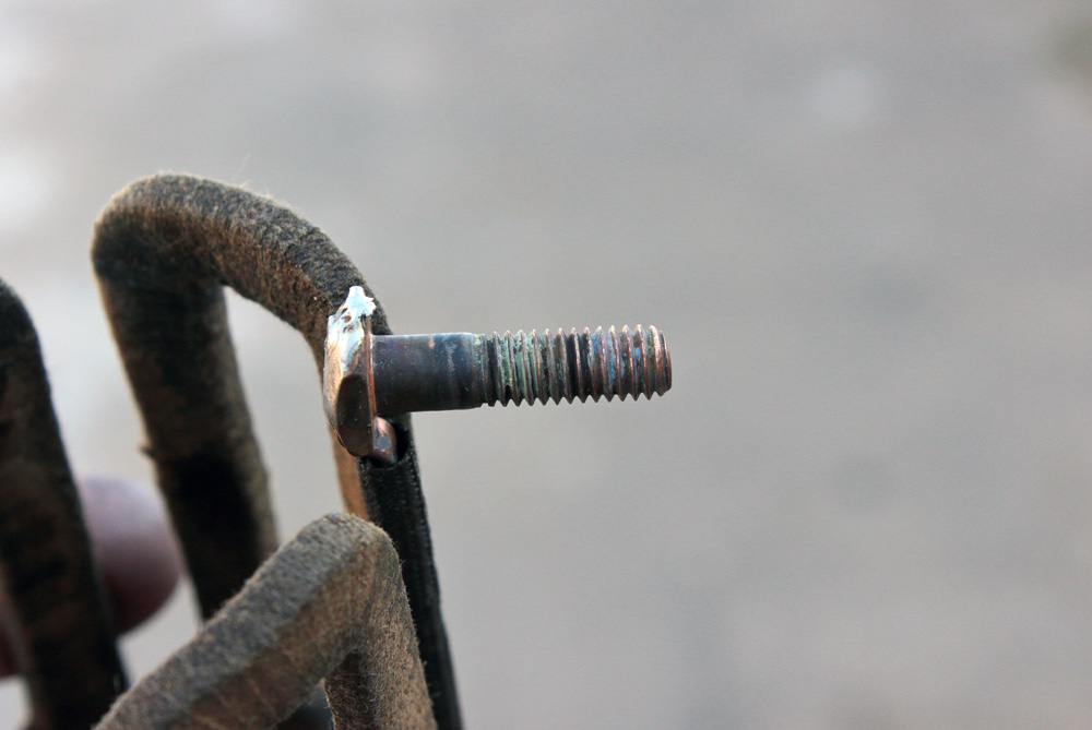

Input terminal of field coils also needed attention.
I cleaned it and removed protrusion of solder.

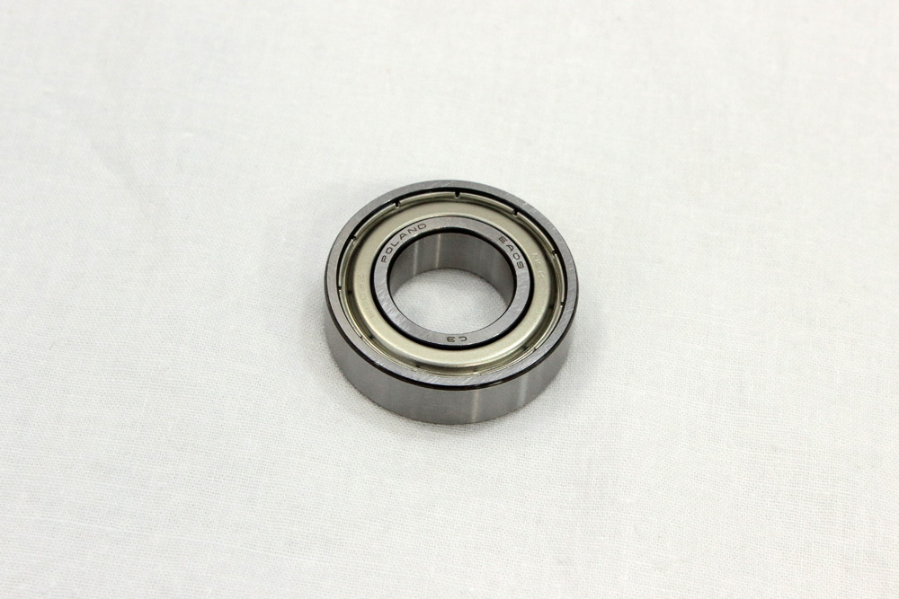

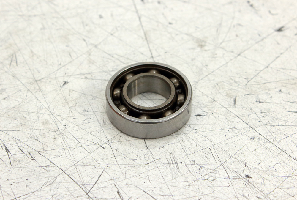

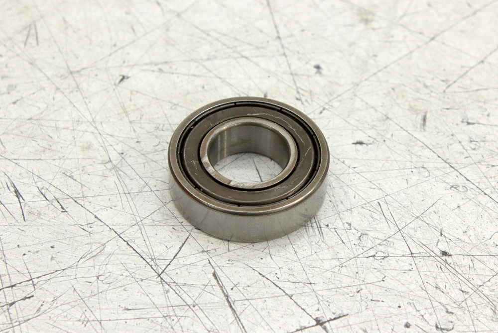

Before I could start assembling the starter motor I had to replace bearing and O-rings. Since O-Rings have part numbers it’s not an issue to buy them.
The bearing of the output shaft is 6003Z bearing. Letter Z or 2Z or ZZ in the end of the ball bearing name means that bearing is equipped with metal shields from both sides (sometimes single Z stands for shield from only one side).
The KZ650 starter bearing looks like it was intended to have two shields (there is a groove for the second shield), but had one of the shields removed. It is very important that it has only one shield.
The fact is the KZ650 starter has oil seal placed right over the bearing. The only bearing shield faces the outer side of the starter cover, and since this shield is non-hermetic, during the work of engine oil mist penetrates it and feeds both: bearing and seal.
Thus, this bearing couldn’t be replaced with RS (equipped with seals) type of bearing. After some thoughts I chose NSK 6003ZZ C3 bearing. C3 stands for additional radial clearance, thus such bearings are more suitable for high temperatures.

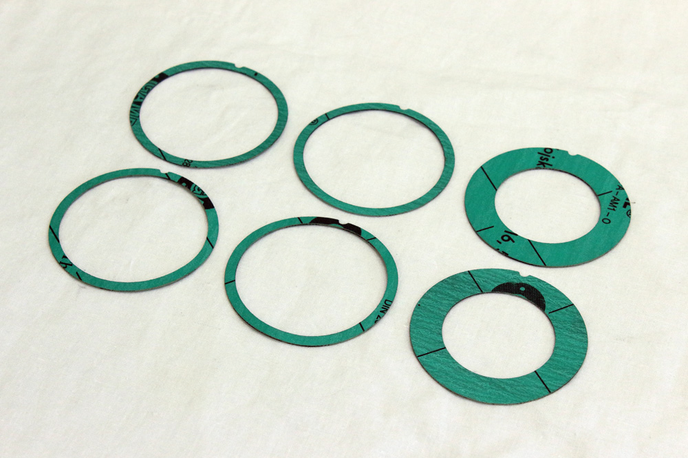

As I wrote in a previous post, KZ electrical starters are equipped with three gaskets that have no part numbers and thus couldn’t be ordered. One of them is most significant. I will explain why in the next part of the story. I measured what remains from old gaskets and places where they have to be installed. On the base of these measurements I drew blueprints for gaskets and then ordered them to be laser cut from Gambit AF-OIL gasket sheet (based on Kevlar® aramide fibres, mineral fibres, and fillers bound with NBR rubber-based binder). As I wasn’t sure about gasket thickness, I ordered two sets of different thickness.

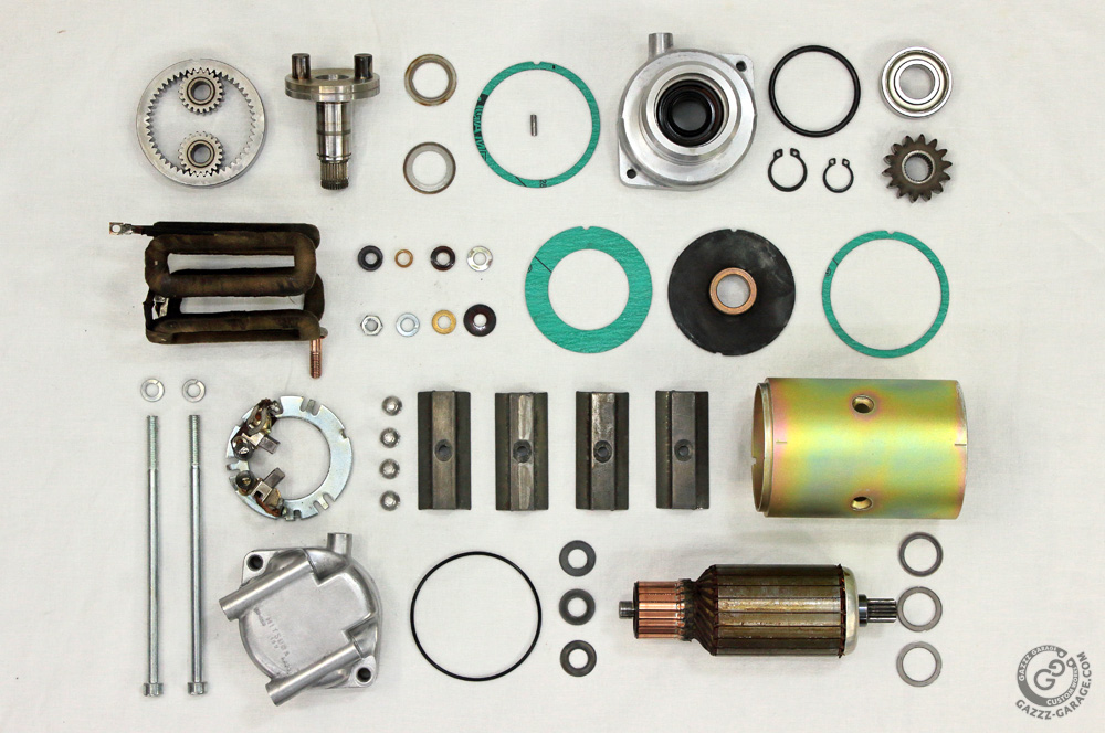

I started assembling the starter motor from yoke assembly. As I already mentioned, Kawasaki service manual indicates that “is not meant to be disassembled”. The reason is simple: the gap between rotor and field coils’ poles is quite small. Thus poles have to be positioned strictly straight along the stator housing and to be parallel to provide that gap. And since we figured conditions of task’ successful fulfilling, yoke assembly’ assembling became a matter of improvised “special tool”.
When I put the assembled part on the table and took my camera to shoot photos, I couldn’t help remembering Nietzsche quote: “And if thou gaze long into an [strike]abyss[/strike] yoke assembly, the [strike]abyss[/strike] yoke assembly will also gaze into thee”…
Next task was output shaft assembly.
