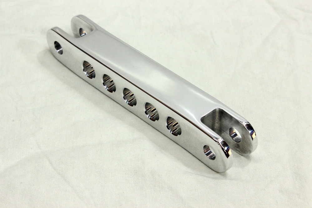

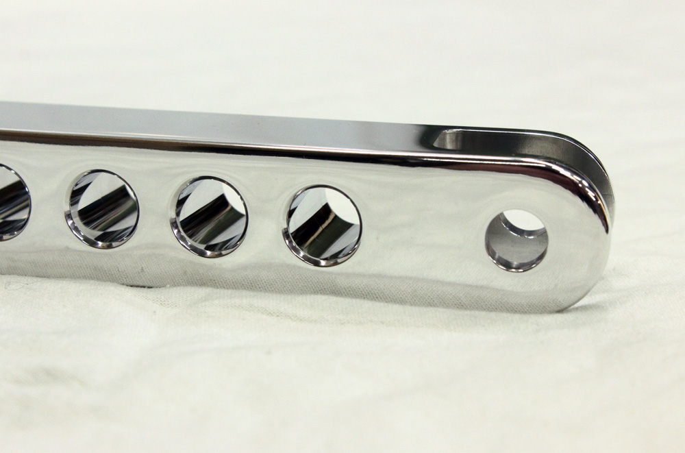

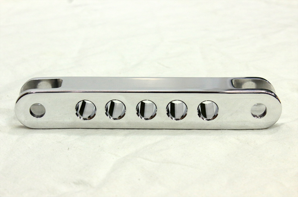

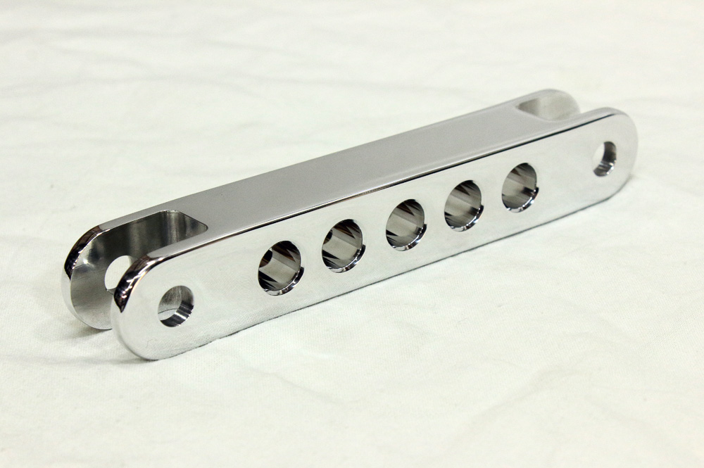

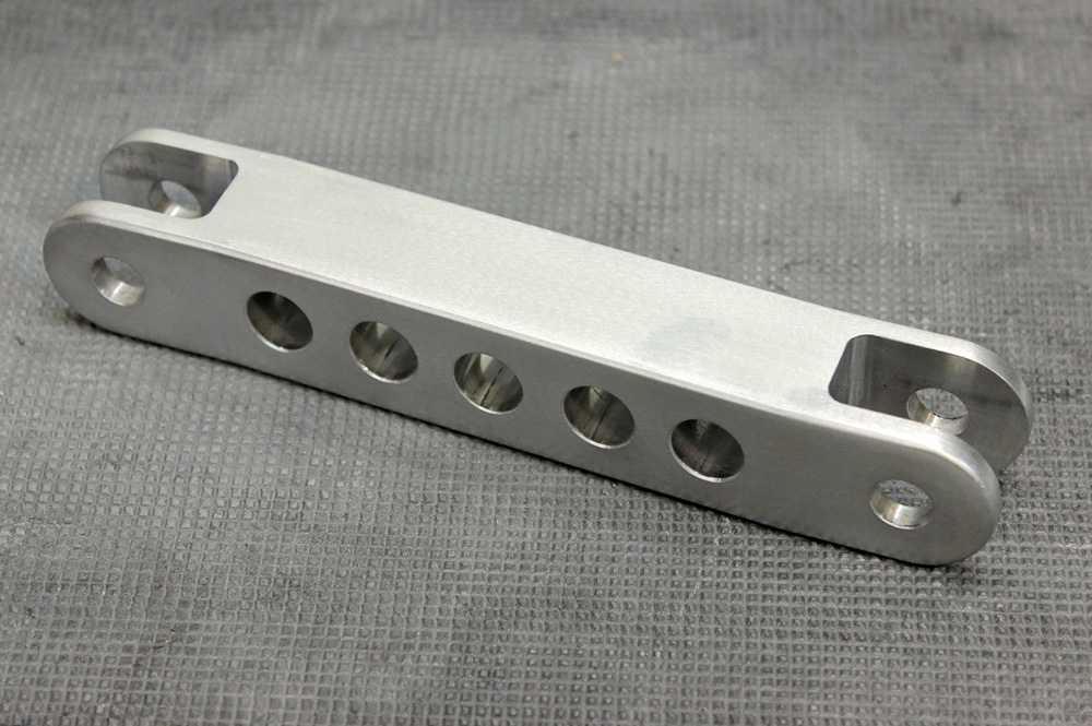

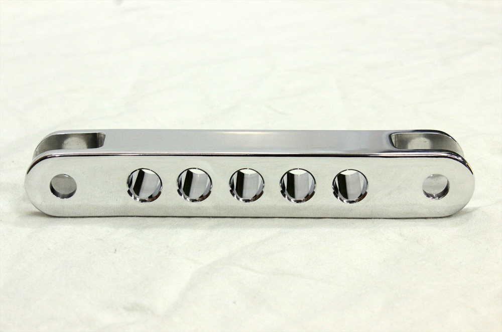

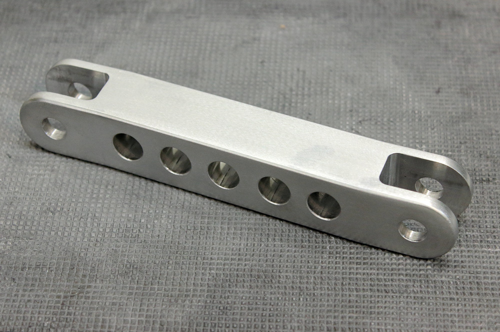

I did some sandpapering:
And polishing. Dunno why I did it, as it’s likely that later I will drill and thread hole/ holes for brake hose clamp/clamps. However, rod looked nice once it was finished. So let’s suppose, that I did polishing to cease the itch of wish to see ready part.

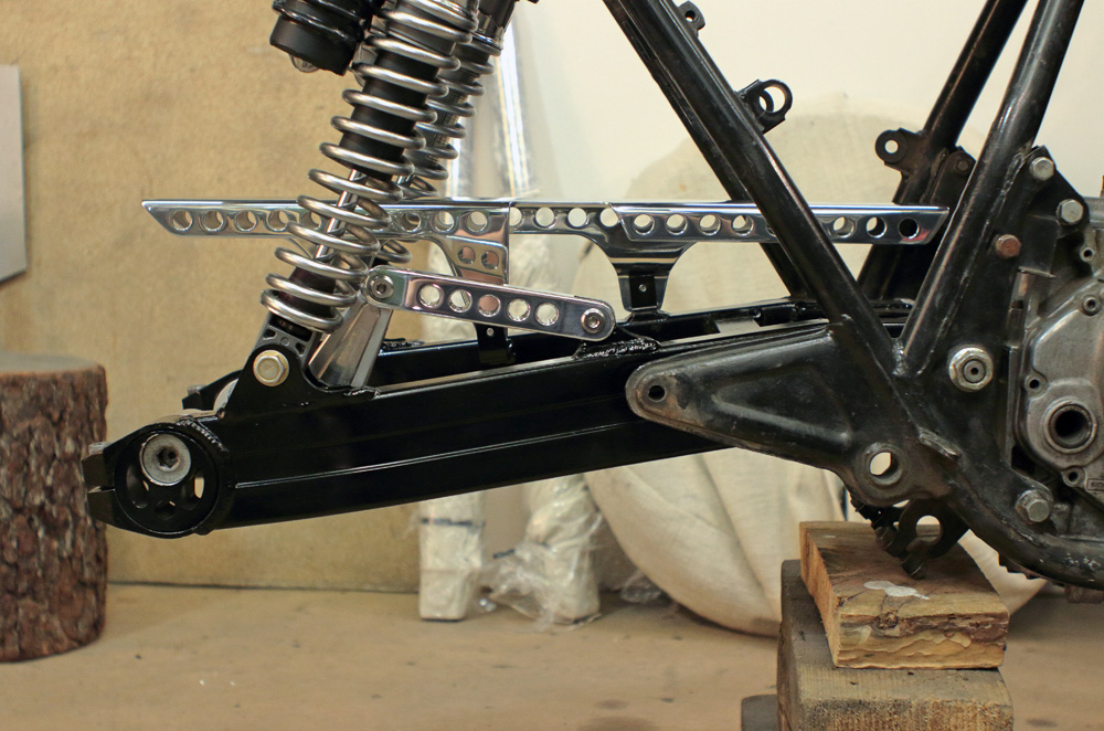

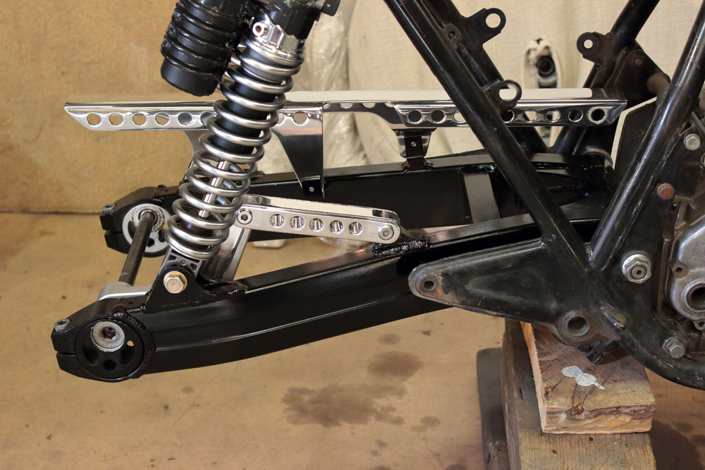

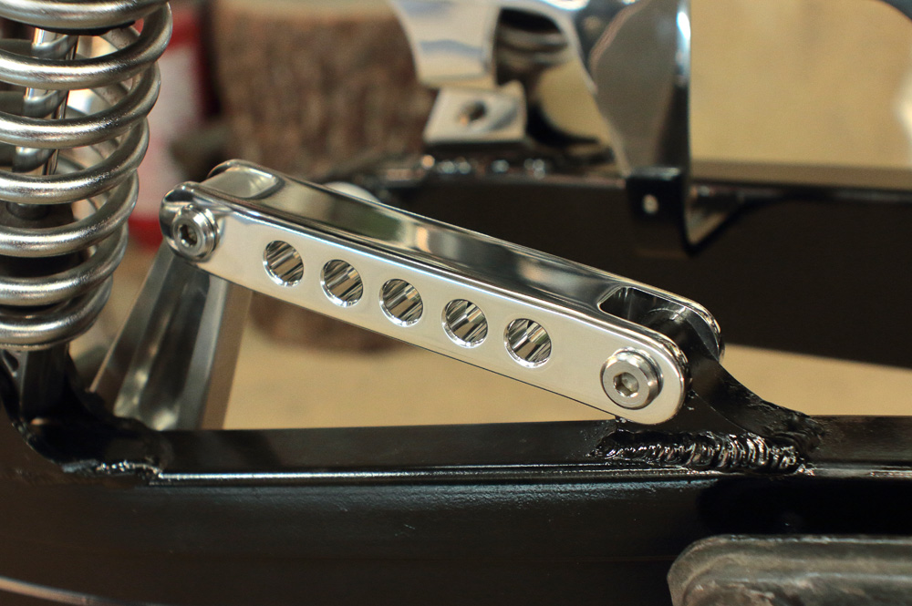

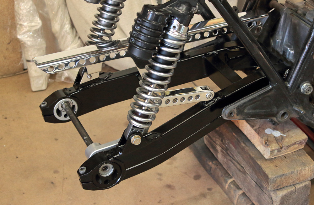

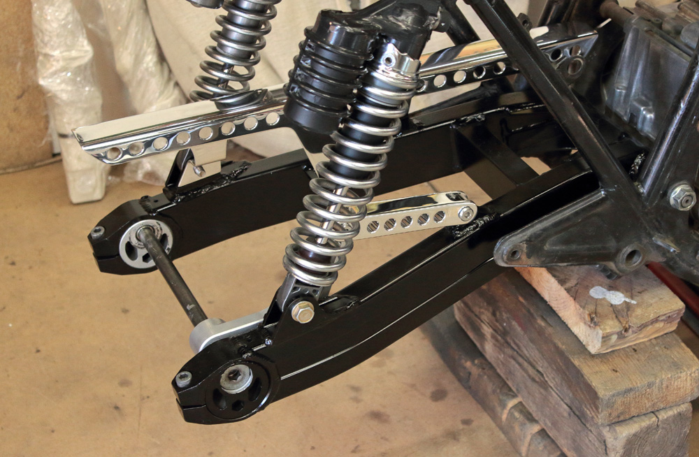

Let’s install torque rod:
Yep! Result was exactly as I planned: torque rod and chain guard look like eggs from the same nest.
Surely, once you took a look on photos above, you noticed, that right shock absorber body is in black, while body of left is in silver. According to my design bodies of both shocks would be in black and I was curious to see how they will look once painted. However, it would be lunacy to do them with rattle can just to see if I am right. So I imitated black painting using black Oracal film and electrical tape. And it looks like this idea of mine was also good.

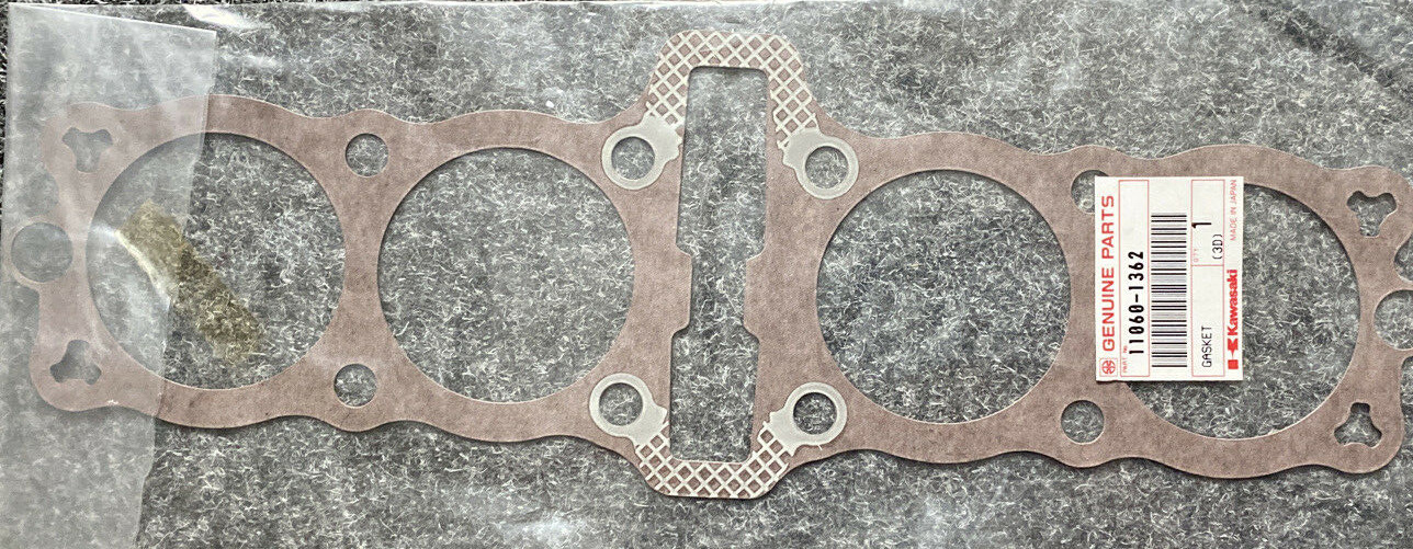

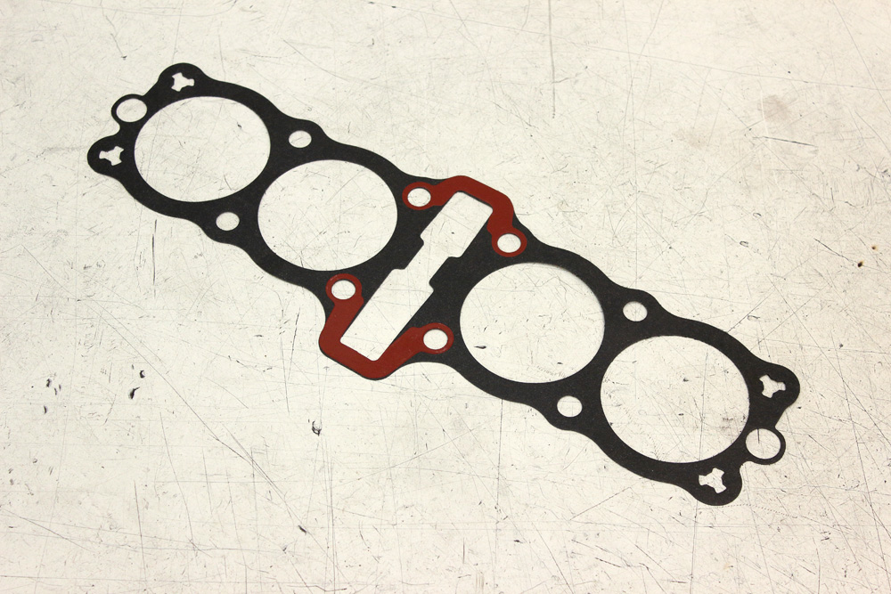

Looks like I have a question which I couldn't figure out on my own. I already have OEM cylinder base gasket 11009-046 (black with red sealant) and it's no good. Even if it looked good and wasn't dried out when arrived it crumpled under my fingers.
I have plan B: to use aftermarket cylinder base gasket. In combination with sealant rubbed int it it would work. However, I don't like the idea of aftermarket gaskets in key points like those under cylinder block. So I found out that part with number 11009-046 was superseded by gasket with part number 11060-1362
And I wonder, if anyone have experience with this part number or similar type of gasket on other KZs and is this gasket any good?

So far I've only had bad luck with old OEM gaskets. I found a compatible one for my 750 by going through the supersession chain until I hit the 90's (it's a coated metal gasket) but in the future I'll probably stick to Vesrah gaskets. I checked for the 650's and 11060-1362 seems to be the newest version.

18 May 2020 14:29calum wrote: So far I've only had bad luck with old OEM gaskets. I found a compatible one for my 750 by going through the supersession chain until I hit the 90's (it's a coated metal gasket) but in the future I'll probably stick to Vesrah gaskets. I checked for the 650's and 11060-1362 seems to be the newest version.
I assume that metal gasket was from Kawasaki Zephyr 750. I have no issues with it even after more than 70K km except of non critical oil sweating right under the timing chain tensioner.
And yep, 11060-1362 is the newest version of KZ650 gasket.

18 May 2020 16:35gazzz wrote: I assume that metal gasket was from Kawasaki Zephyr 750. I have no issues with it even after more than 70K km except of non critical oil sweating right under the timing chain tensioner.
Yep, that's the one. Good to know it will last.
