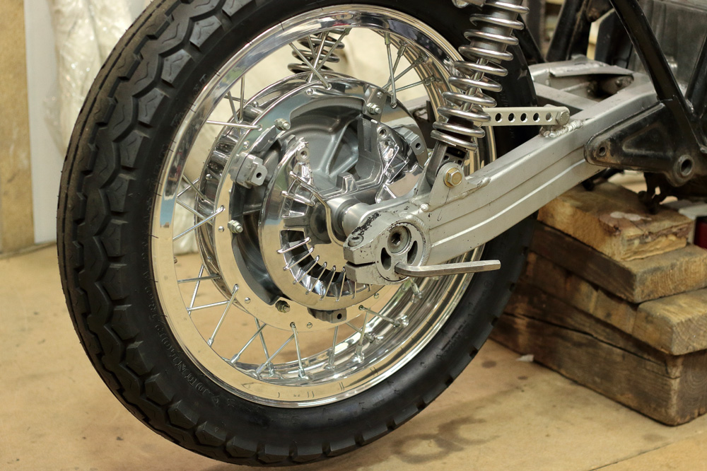

From previous part of story about chain guard attentive reader (or rather attentive picture looker) might notice that chain guard inner mount was already attached to new mount bracket. This mount is longer than original and placed farther from swingarm axle. The reason of such modification is that Kawasaki KZ650 sprockets lay in plane that close to longitudinal axis of motorcycle than plane of Zephyr 550 sprockets. Let me demonstrate this by placing a strip of paper tape on Zephyr 550 swingarm:
This strip of paper tape has width that is slightly larger than width of trace which 525 chain leaves on rubber chain slider, and its position is verified by laser tool. So we may say that it marks optimal position of chain slider for KZ650.
Now let’s put original Zephyr 550 chain guard (used, so we clearly could see the trace of Zephyr 550 drive chain) on the swingarm. And as we could clearly see, potential KZ650 chain’ trace is shifted to right (or to center of swingarm) comparing to trace of 550 drive chain.
On practice it means two things:
- Zephyr 550 chain slider does not cover all operating width of KZ650 chain. It’s likely wouldn’t be an issue, as long as drive chain is properly tightened. However it’s slightly inaccurate, so I will think about possible solutions for this issue;
- KZ650′ chain would be too close to inner mount of chain guard.

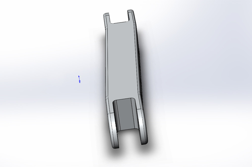

Usually rear brake caliper’ torque rod is strictly utilitarian looking thing. To make it of steel was also the simplest option, especially taking into account the fact that there is a 6mm offset between torque rod mount on swingarm and brake caliper holder. So KZ650 project might have quite ordinary brake torque rod if I wasn’t working on it simultaneously with working on the chain guard.
Idea of torque rode as some kind of “counterpart” to chain guard was pretty obvious to me. First were measurements.
They were closely followed by pencil sketch. I used to do such sketches (or simpler ones) beforehand to drawings that I make on computer.
That’s what I’ve got as an output:
Then I produced 3D drawings and brought them to CNC shop along with plate of 2024 aircraft grade aluminum.
