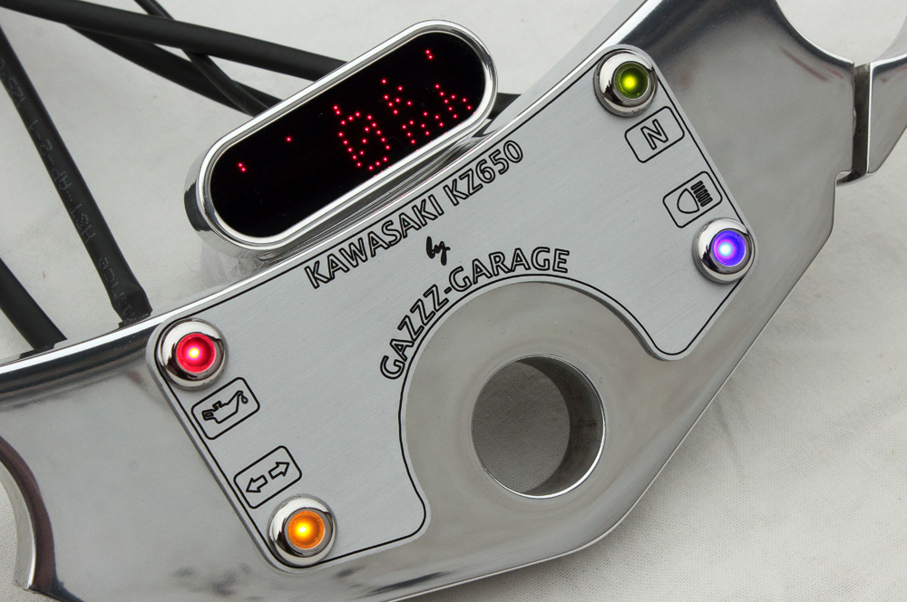

And sure, I couldn’t resist desire to see how all indicators and speedometer look when power is on, therefore some part of these photos are of dashboard with all lights put alight. No photo could convey how it looks in real life, but I did my best. So here we go, just imagine that colours of central points of indicator are more even to their edges (especially for blue light, it’s just blue, without high-pitched magenta tone).

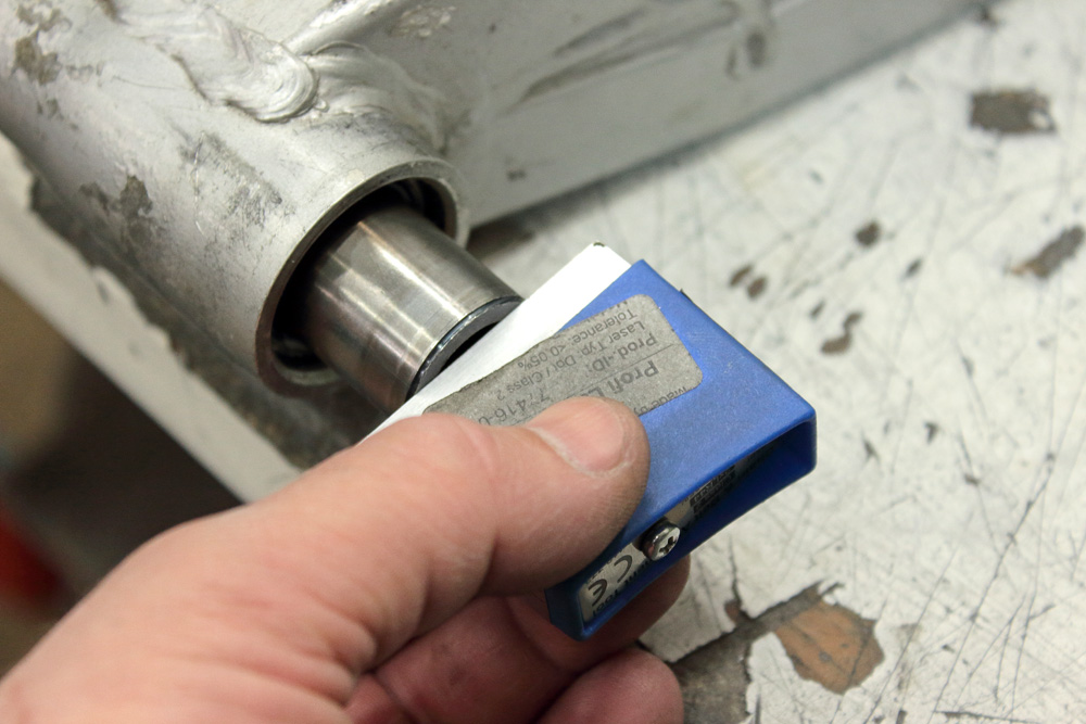

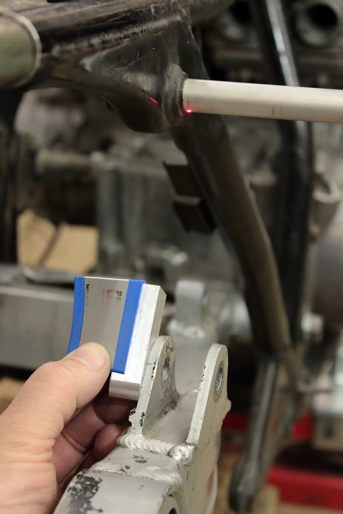

This post is about work on KZ650 chassis: modifying some parts, and calculating, and drawing all adapters I have to order to be made: for Zephyr 550 swingarm, for shocks, and so on. This work needs some concentration, and it’s result doesn’t looks impressive. However, it has some interesting moments. For example, I decided to check, if Zephyr 550 swingarm has symmetrically positioned shock mounts. One may say: what might be easier, just put straight rod to shock mount and check if distance between rod and sleeve housing is similar on both sides. But nope, it wouldn’t work. The only parts that really must be straight and leveled in Zephyr 550 swingarm are: sleeve, its housing, and chain tension eccentrics. Swingarm mounts might be completely in place, but slightly angled to longitude axle. And even one degree of deviation on length of swingarm would end up as 9.5mm of difference. So the best idea is to make measuring depending on things that are straight for sure. So as base for my measuring I used swingarm sleeve being pulled on some fixed distance from bearings.
And sure, I used laser tool instead of rod. I put it to sleeve and pull sleeve to the level where laser beam is aimed to center of left inner shock mount.
Then I measured distance from end of sleeve to sleeve housing and pulled sleeve from other side of housing on same distance. Beam of laser tool, that I put on sleeve, was aimed completely in same point of right shock mount.
This means that shock mount of Zephyr 550 swingarm positioned symmetrically to sleeve and its housing. To make sure that there was no mistake I put some leveled part (like wheel spacer) to sleeve housing and repeated measuring. Result was the same, thus symmetrical position of shock mounts was confirmed.
Little illustration of fact that eccentric’ end and sleeve/housing’ ends are in parallel planes:

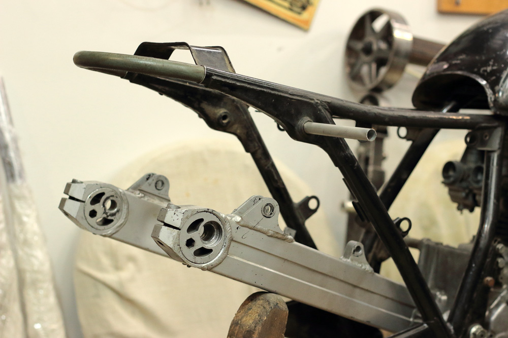

My next task was to check how shocks’ mounts on swingarm match shocks’ mounts on frame. Here I had no choice, but use shock mounts on swingarm as base for laser tool. To decrease influence of fact that mounts might be not strictly perpendicular to swingarm’ sleeve I decreased distance between upper and lower mounts:
Measuring itself looked like this:
It shows that the difference between right and left pairs of shock’ mounts is around 1.5mm. This means less than 1mm of deviance from potential center of motorcycle. Really it’s nothing for frame made more than forty years ago. This even couldn’t be called an issue, as solution is built into shocks themselves: the rubbers that are placed in their lower and upper heads diminish effect of non-parallel shocks or some difference in width between upper and lower shock heads. Moreover, these rubbers could be moved to either side of shock’ head for a couple of millimeters, so position of both shocks might be adjusted to perfect

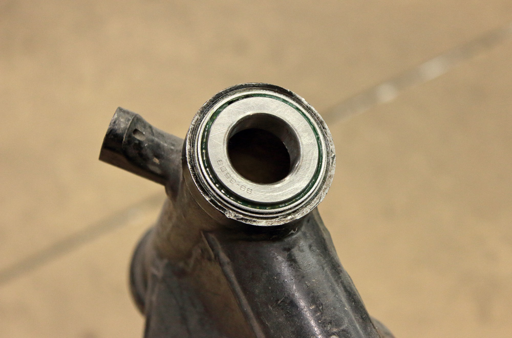

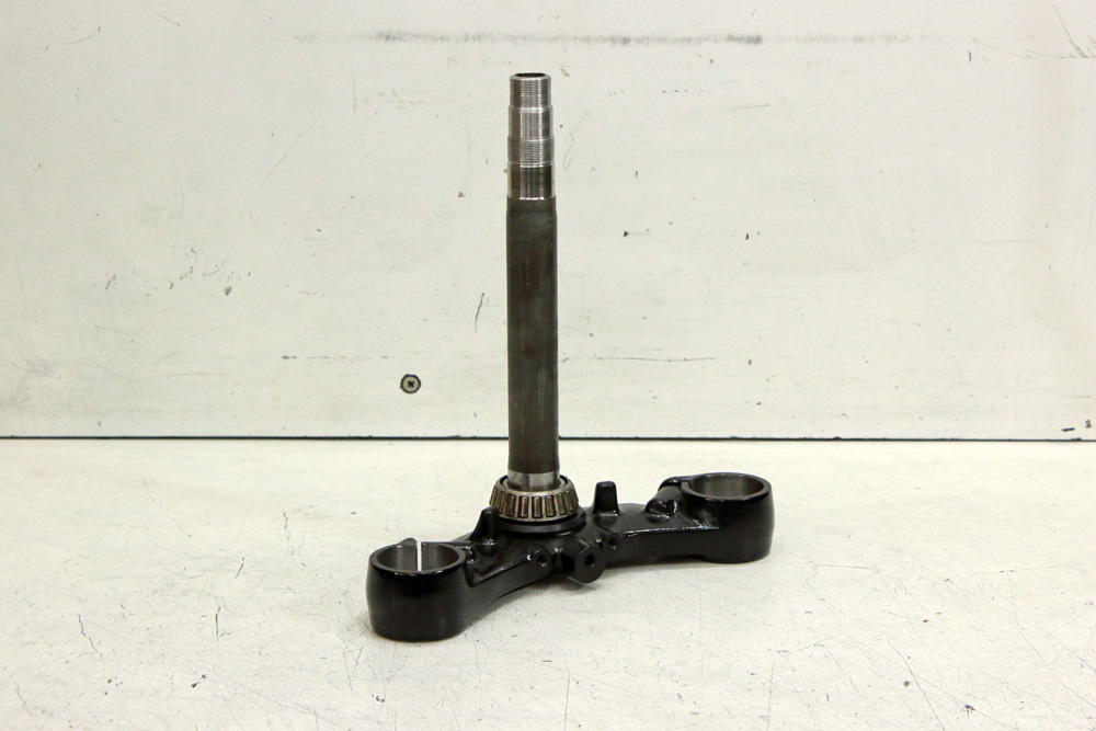

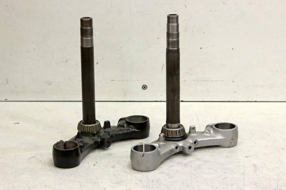

Next part of work on chassis adaptation. I used 41mm fully adjustable front fork from Kawasaki ZX6R, however I didn’t install it in ZX6R triples. In my opinion ZX6R triples have too short forks offset, thus I preferred to make a mix of Kawasaki Zephyr 750 top yoke and Kawasaki ZR7 bottom yoke. ZR7 and Zephyr 750 triples are compatible, even as they have different design, and moreover, distance between fork tubes are similar not only for ZR7 and Zephyr 750 but also for ZX6R. This little fact simplifies matter of front wheel axle.
Here are bottom yokes, left is Zephyr 750 and right is ZR7. However, take into account that I’ve already shortened stem of ZR7 yoke on this photo by 6mm. As you may see, ZR7 has steering stem of bigger diameter, and their upper ends have different design, as top yoke is fixed by bolt on Zephyr 750 and by nut on ZR7.

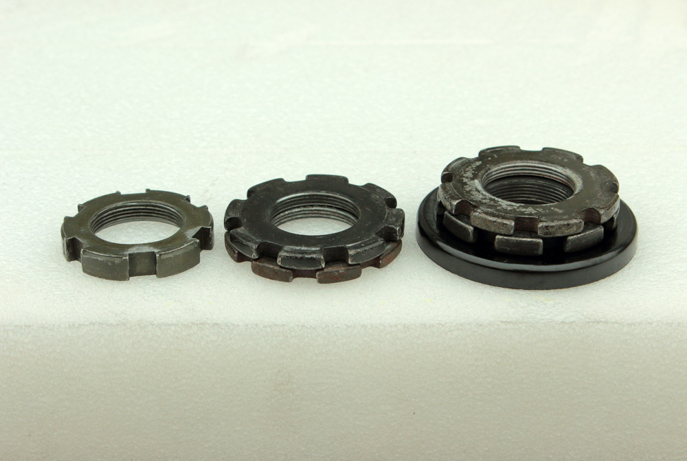

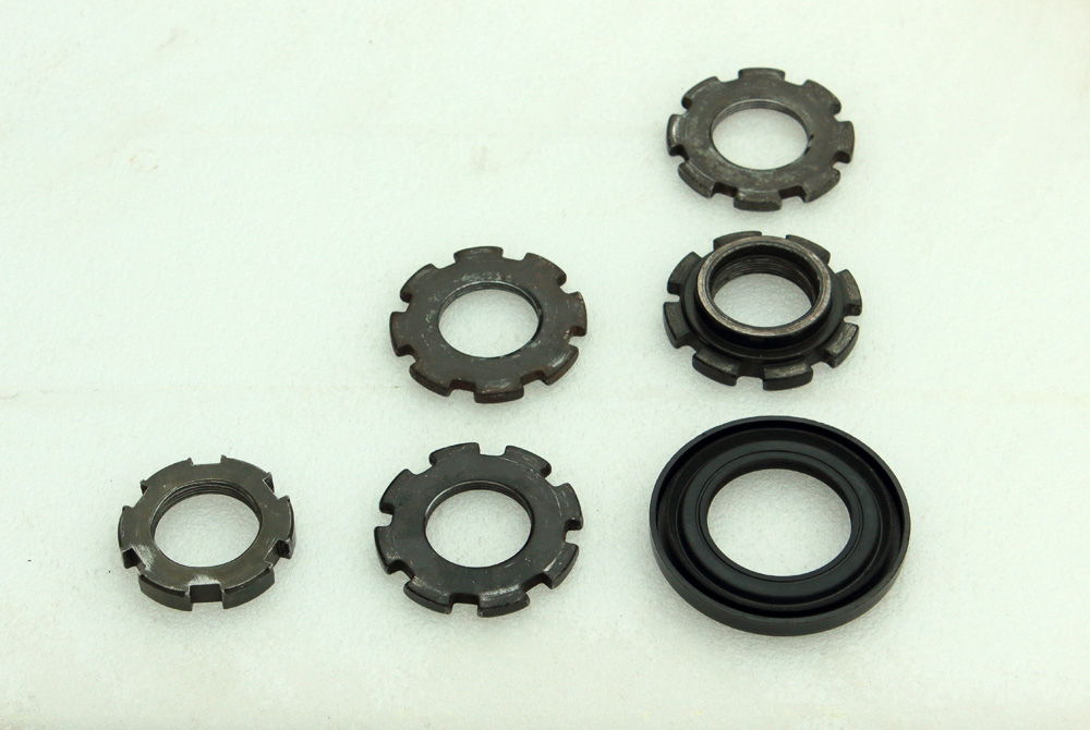

And here are three variants of steering stem nuts:
Right setup is original setup common for Zephyr 750, ZR7 and many other Kawasaki motorcycles. Central setup is in fact combination of two upper (locking) nuts from right setup. Left nut is compatible nut from some Honda. As you may see, right setup is a tallest among three, and as a matter of fact, it wouldn’t work for KZ650, as KZ650 upper steering bearing slightly protrudes above the steering head:

Thus I figured out that central setup which is much lower (6mm of difference) than original and might work slightly more secure than classical one-steering-nut setup. However, I also might use single nut which is for another 1.5mm lower than my setup.
To make steering stem compatible with two left set-ups I ordered to shorten stem for 8 mm on lathe (it might be easily done with ZR7 without stem removing).
ZR7 bottom yoke looked less accurate than Zephyr 750 unit, so I sandpapered it a bit. I also temporarily painted it into black using rattle can. I plan it later to be sand- or glass-blasted and painted in black properly, of course.

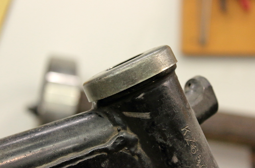

With that setup of steering nuts of mine I had to solve an issue of steering head dust protection.

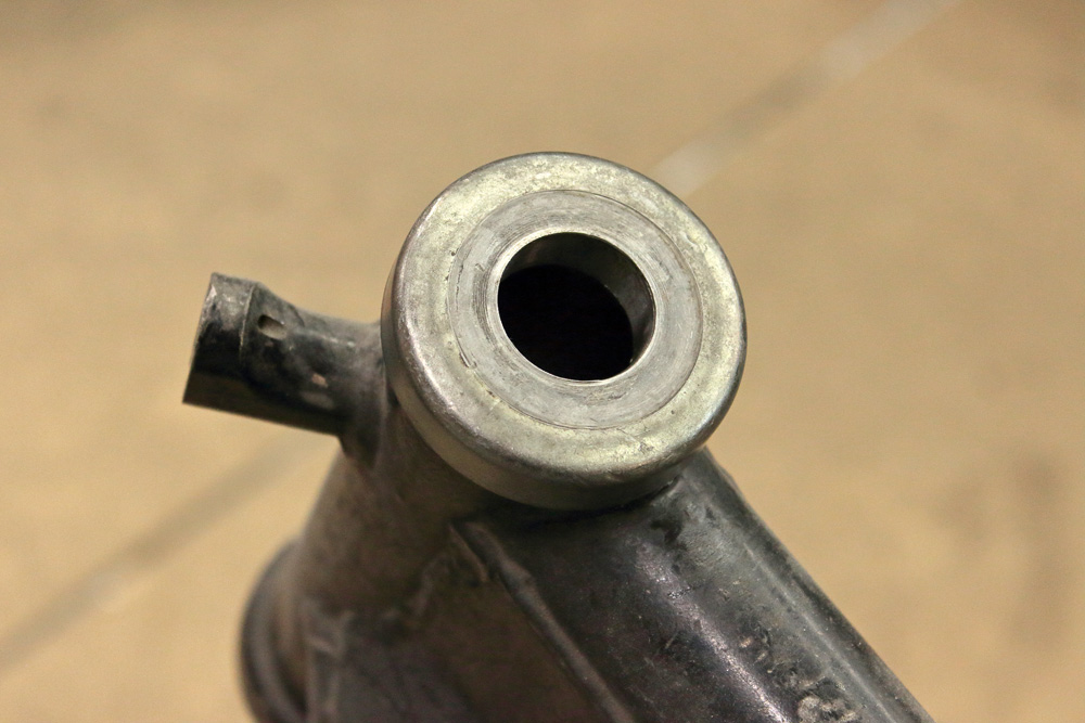

For this purpose I picked steering head cup from Yamaha XJ550 which perfectly fit Kawasaki KZ650 steering head. It sits there like it was made for it:
Later I’ll replace it with new part; however for the moment used part would do perfectly.
And here we came to the end of this part of the story: steering unit is ready for top yoke and fork installation.
