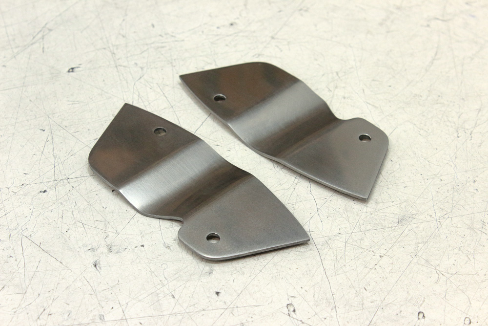

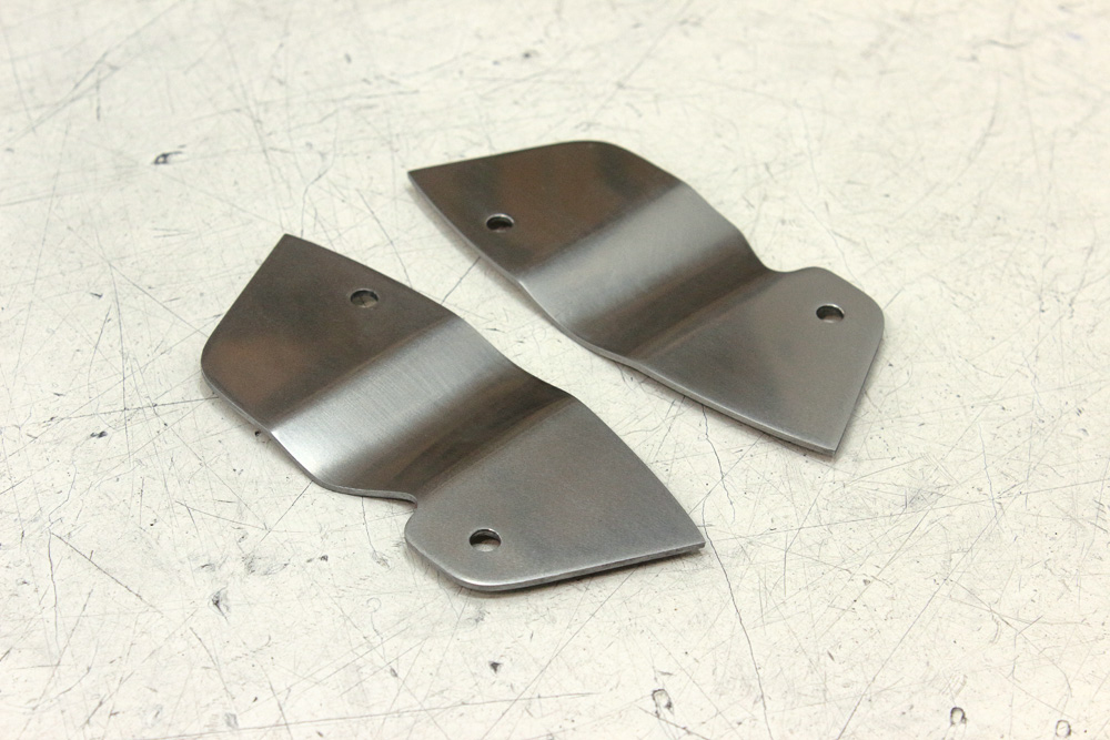

According to my design, the mount of the fender is quite complicated. It is to be made of stainless steel and to consist of four parts made on lathe:
Two 6mm rods bent like this:
And also some mount plates. I didn’t order them to be cut on laser, as they would to be bent before drilling and cutting. However, to get two parts of identical dimensions I used old method: after I bent plates, I drilled mount holes, then screwed them together and only after that shaped them and grinded edges.

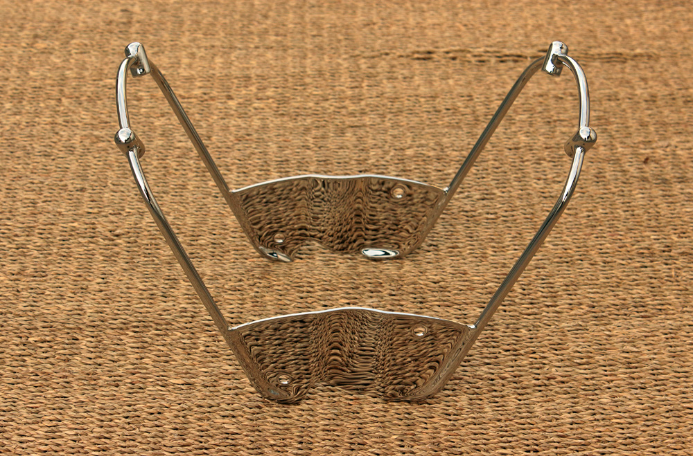

I prefer leaving behind the scenes of how I adjusted and welded together all eight parts of fender mount. After parts were welded together I had a lot of grinding work. And sure, some additional decorative welding was done were it was necessary (to make welding seam zones smooth).
Work took a lot of man-hours as it had to be done very accurately. When the finish of grinding and sandpapering became quite visible, mudguard mount already began to look really nice. I smoothed perfectly welding seams on outer sides of mounting plates, however I wasn’t so picky with inner sides: one have to know the edge between perfection and madness…

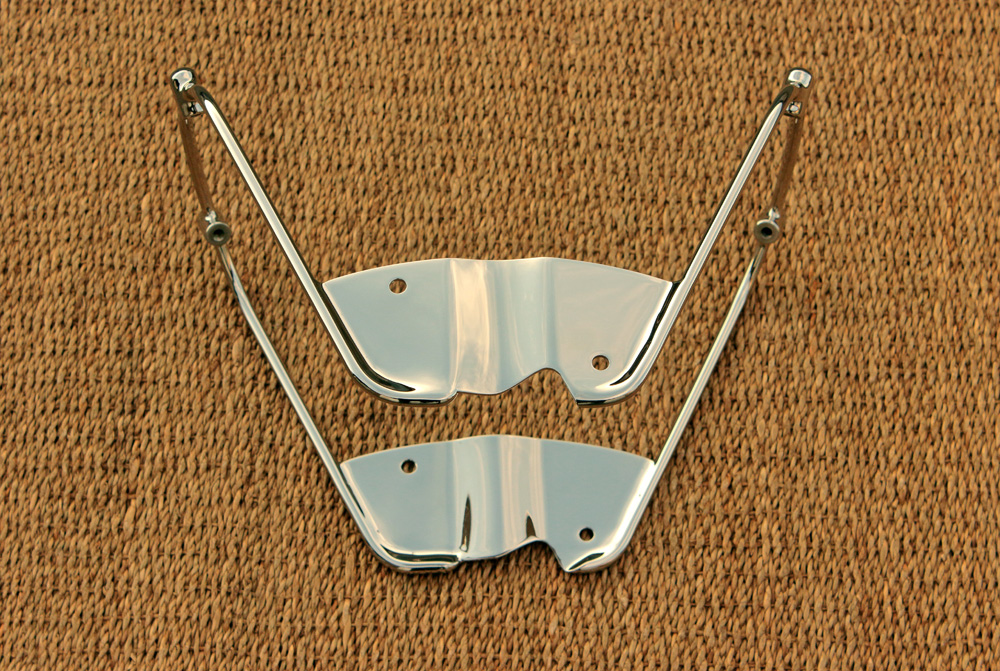

Final sandpapering took some time, still it’s essential to do the job right if you are about to get mirror finish after polishing. I have nothing to say about polishing itself, I just did it as usual: first polishing to show remained flaws in sandpapering, then correction sandpapering, then again polishing, and so on and so forth until I was satisfied. Result looks great:
