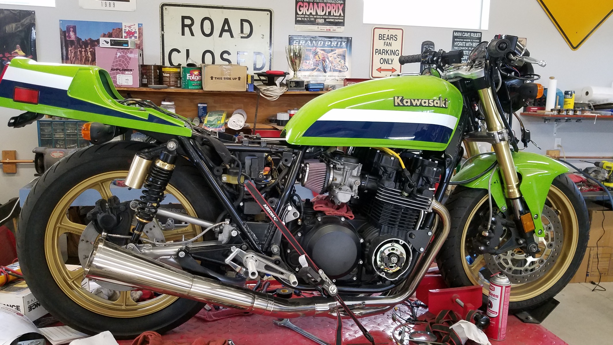

First time running with fuel in the repaired tank. No leaks! Well, in the tank, anyways. The fuel "T" on the carb bank is weeping. I used all new orings. Hoping it doesn't have a hairline crack. I also put the first official heat cycle on the engine since I had a larger fuel supply. Finally showing that golden hue on the stainless head pipes.

I finished positioning the handlebars, mirrors, and levers (for now). Finished routing the wires and put the headlight in. Here's a walk around the front end. First time it's been this complete up front.

The list is getting shorter:
Make steering damper mount
Make seat hinge pins (lost the originals)
Make battery strap (original didn't come with the bike)
Install chain guard
Test/repair horn
Install rear shocks (new ones on order)
GO FOR A TEST RIDE!!!
Install chain guard
Test/repair horn

This never crossed my mind until I sourced the hardware and bolted it up - why design a stabilizer with two heim joints? One of the mounts needs to be rigid, or semi-rigid, for this to work properly and not rattle like a clatter bone in a goose's a$$. Now I need to redesign the frame mount.
