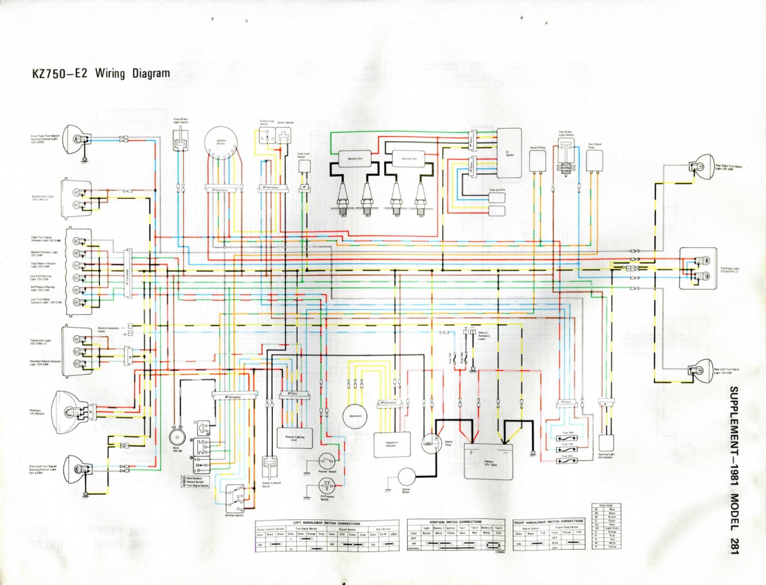

I know the original controls had the hazard switch. The new repops are for a Z1, and do not have that switch. Thus I won't be using the hazard switch wires in the harness. The wiring diagram for my bike is starting to piss me off. I am finding connectors not in the diagram. I didn't think getting the electrical sorted would be this much of a headache. Did I day I hate wiring? Well, I hate wiring...

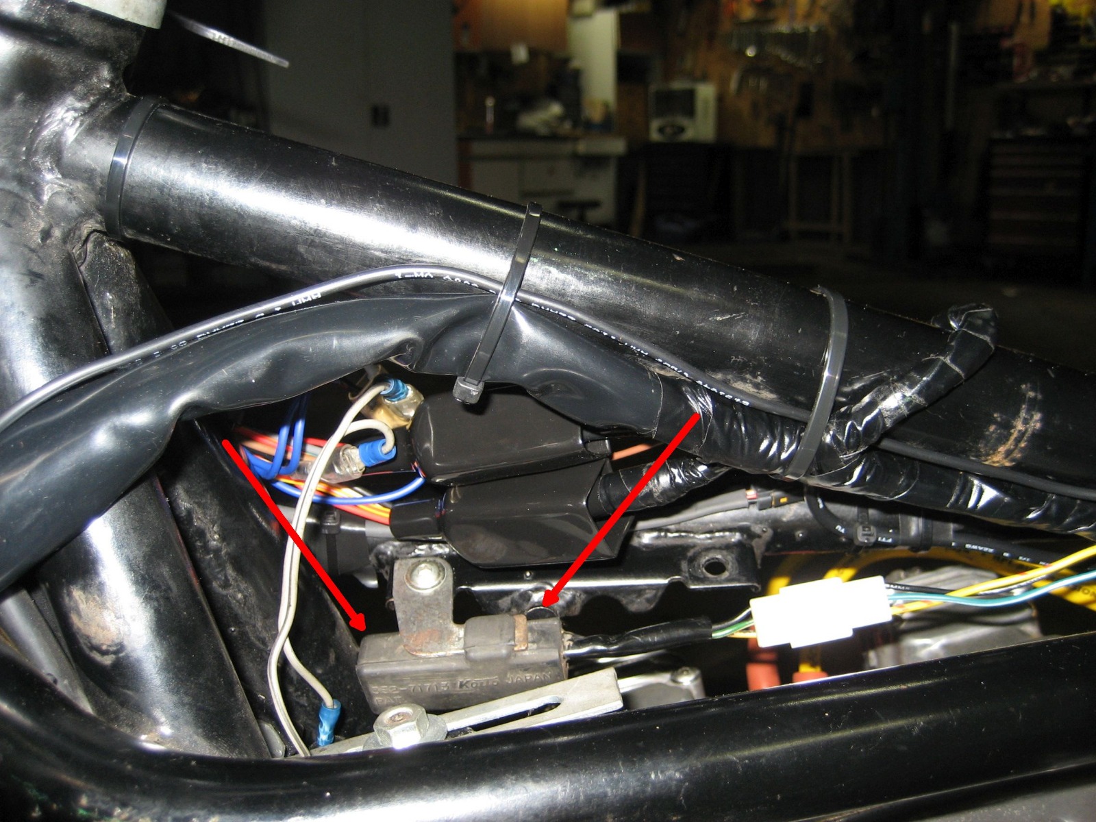

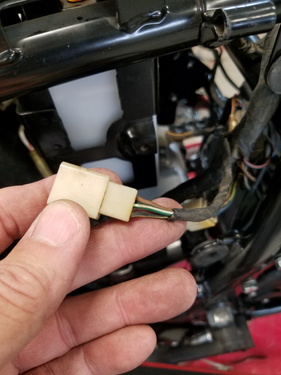

I found this connector, and the diagram lists it for a "warning light self checker". It is coming out of the rear loom on the right side near the battery. Is this for a factory diagnostic tool to plug into? I can't find anything that has the same shape connector on the bike.

The warning light self checker connector need the same electronic divice like the rear break failure "idiot light"

I ended up finding my warning light self checker. I seem to spend the majority of my time looking for parts or fasteners to put this bike together. I was "okay" at bagging and tagging everything, or so I thought. Turns out I am only so-so at that task. Note taken for the next project!

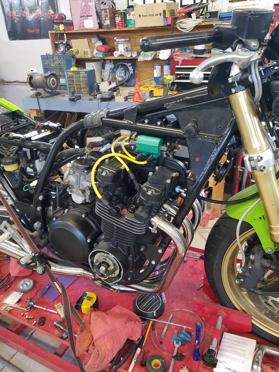

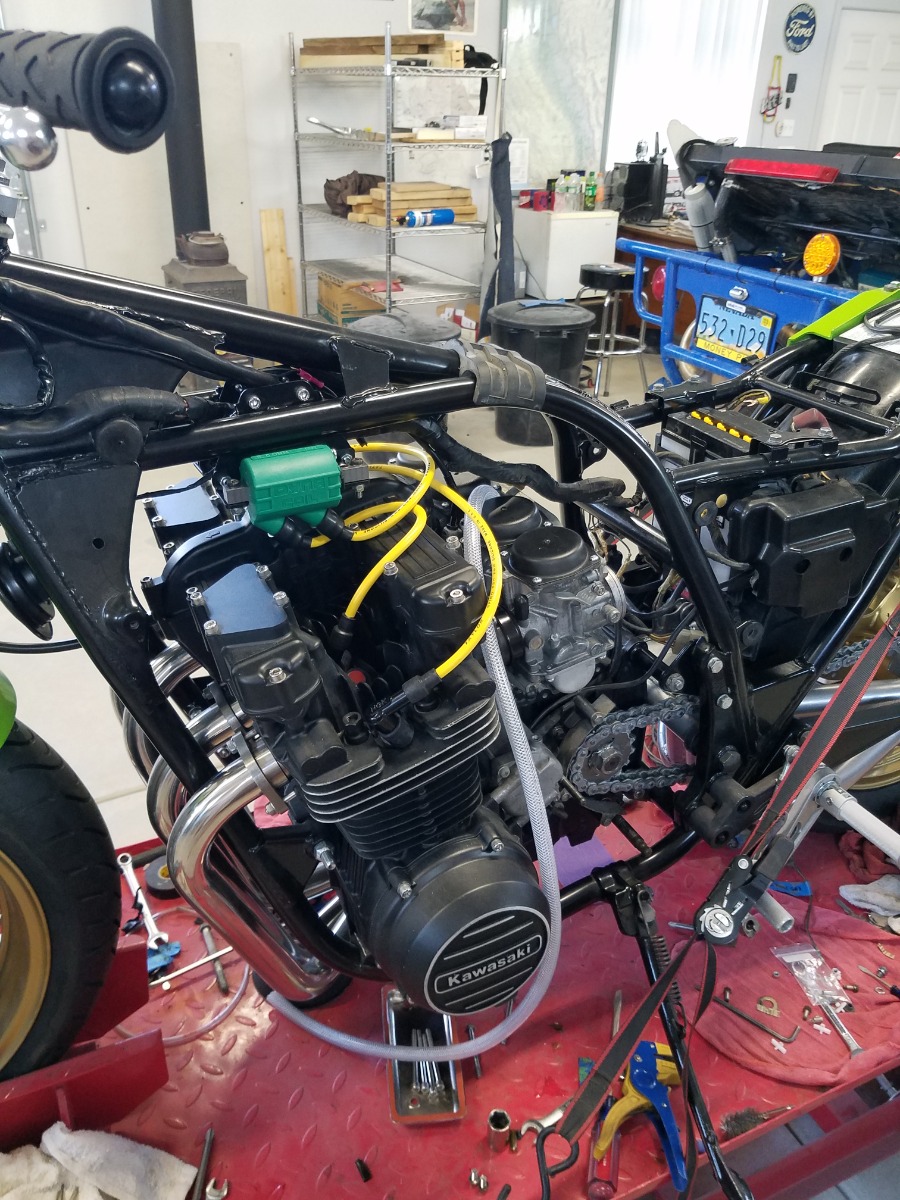

03 Aug 2021 21:48

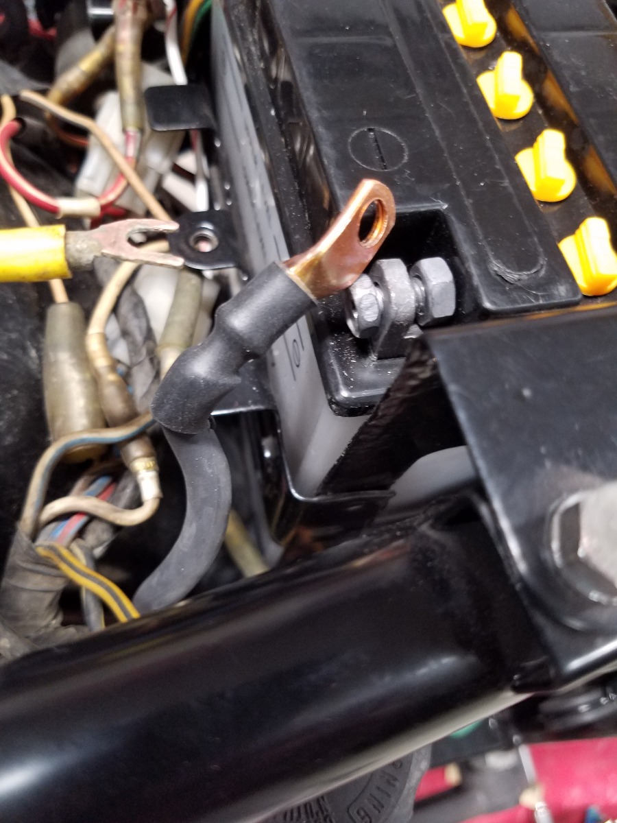

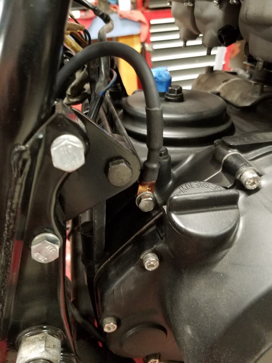

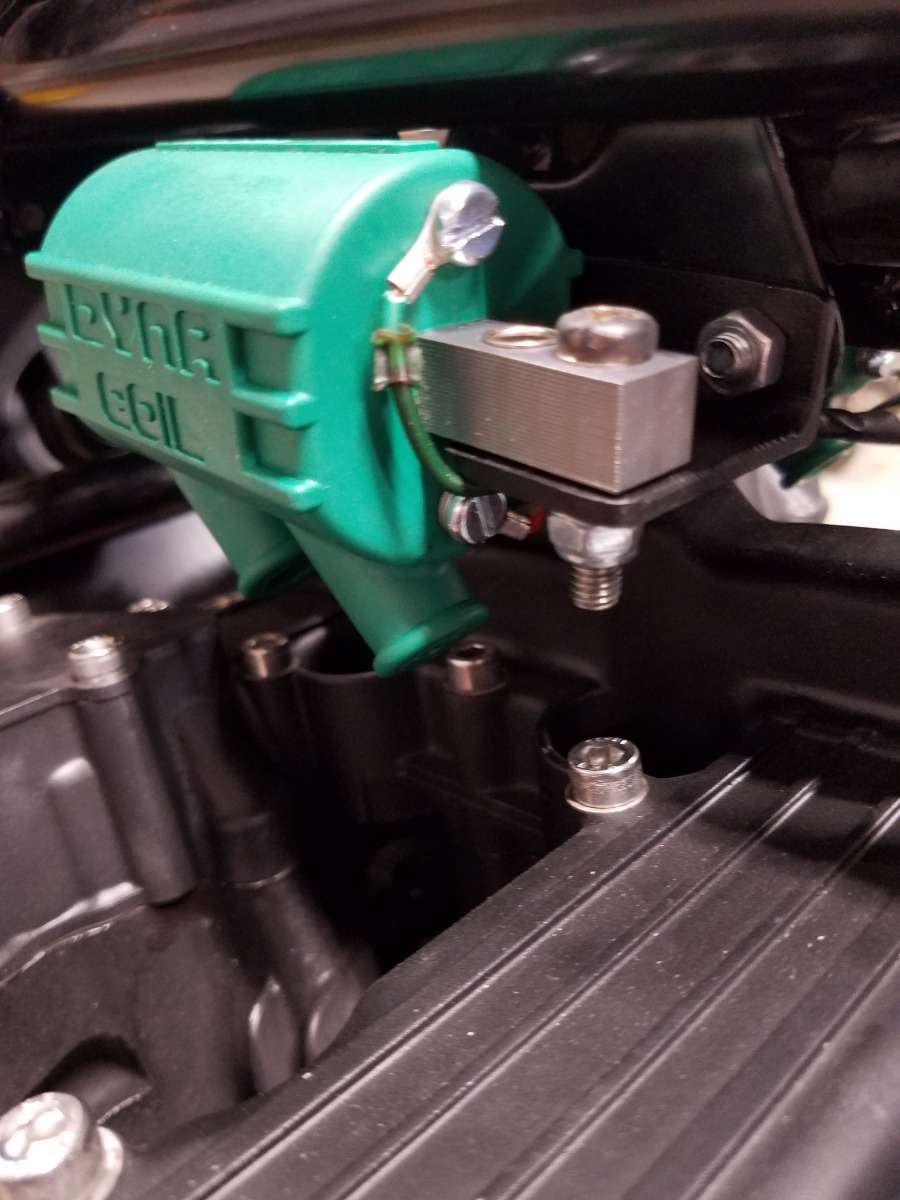

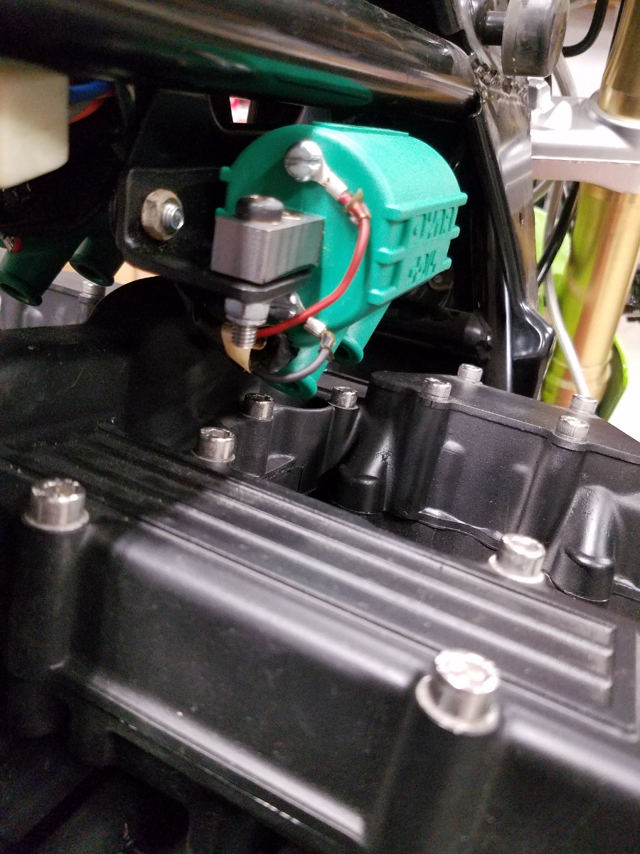

I made a new ground strap from the battery to the engine. One part I spent a lot of time searching for before I threw in the towel and made my own.
I also finished wiring up the ignition coils. Dynatek coils require a different connector than the stock.
The heat keeps me out of the shop in the afternoons. Doesn't seem like much progress, but got to keep pushing forward.

Re: Saving a '81 KZ750-E
04 Aug 2021 13:55
nice work!
What wires and caps are you using?
