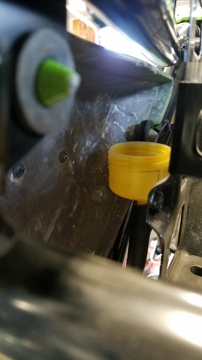

The ZX-6 master uses a different diameter reservoir line than the aftermarket unit I had on there. So I end up needing to use the reservoir that came on the ZX-6. Started test fitting it and found the adapter bracket I made wasn't needed any longer. This reservoir, like the m/c, came with half of it painted black with spray paint, along with it's black cap. After cleaning it, it is quite yellow and discolored. But it looks better than it did.

Make sure your side cover still fits. You could try the hair product the asphalt900 said will whiten yellow plastic. He said cover it with Salon care 40, and place it in a ziplock and marinate. I saw were some let it sit in the sun, the UV rays help.
