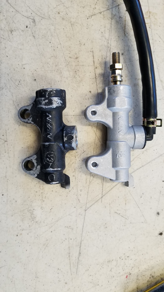

When I had to replace this bike's rear master, I bought an aftermarket unit (new) for an '06 - 08 ZX-6R. It barely lasted through the first bleed before starting to leak. I ended up buying a used OEM unit off Evilbay for an '03 ZX-6R. It showed up really grungy, with one side spray painted. I knew it was a gamble, but upon disassembly it is definitely rebuildable. The mount spacing is still correct, but I need to get different hardware and match some hole sizes to get it bolted up. I ordered all the soft parts from Kawasaki for the rebuild.

I won't be using the reservoir or line that came with it, or the brake line. Everything lines up well with the stock linkage.
