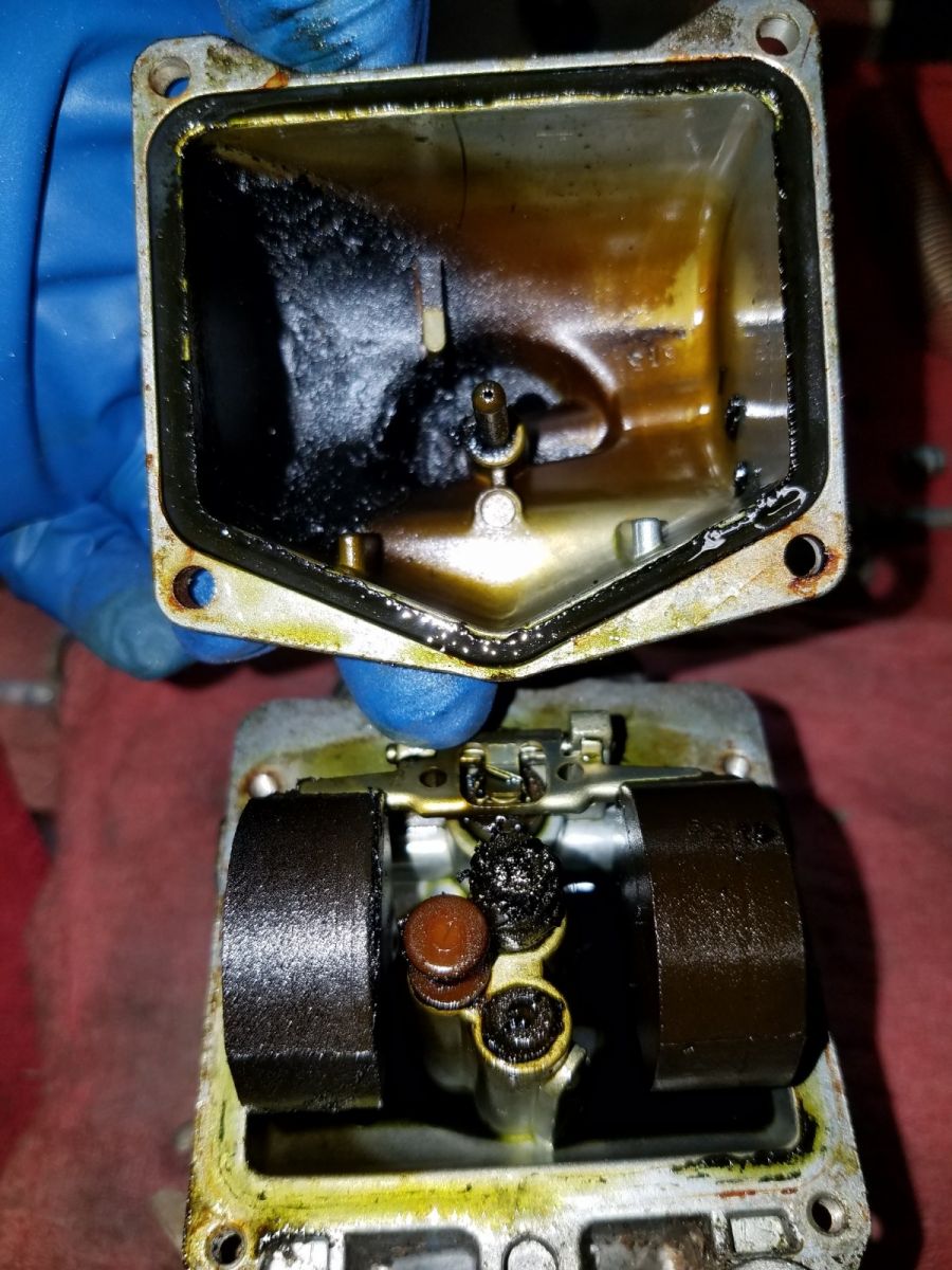

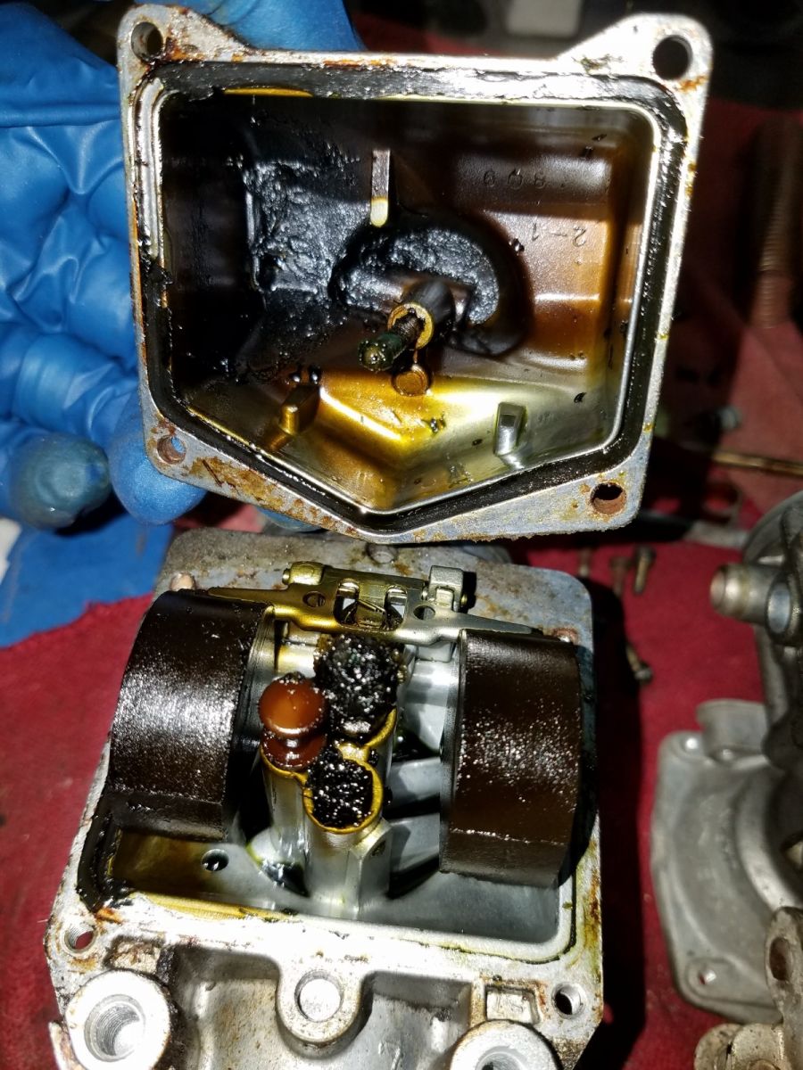

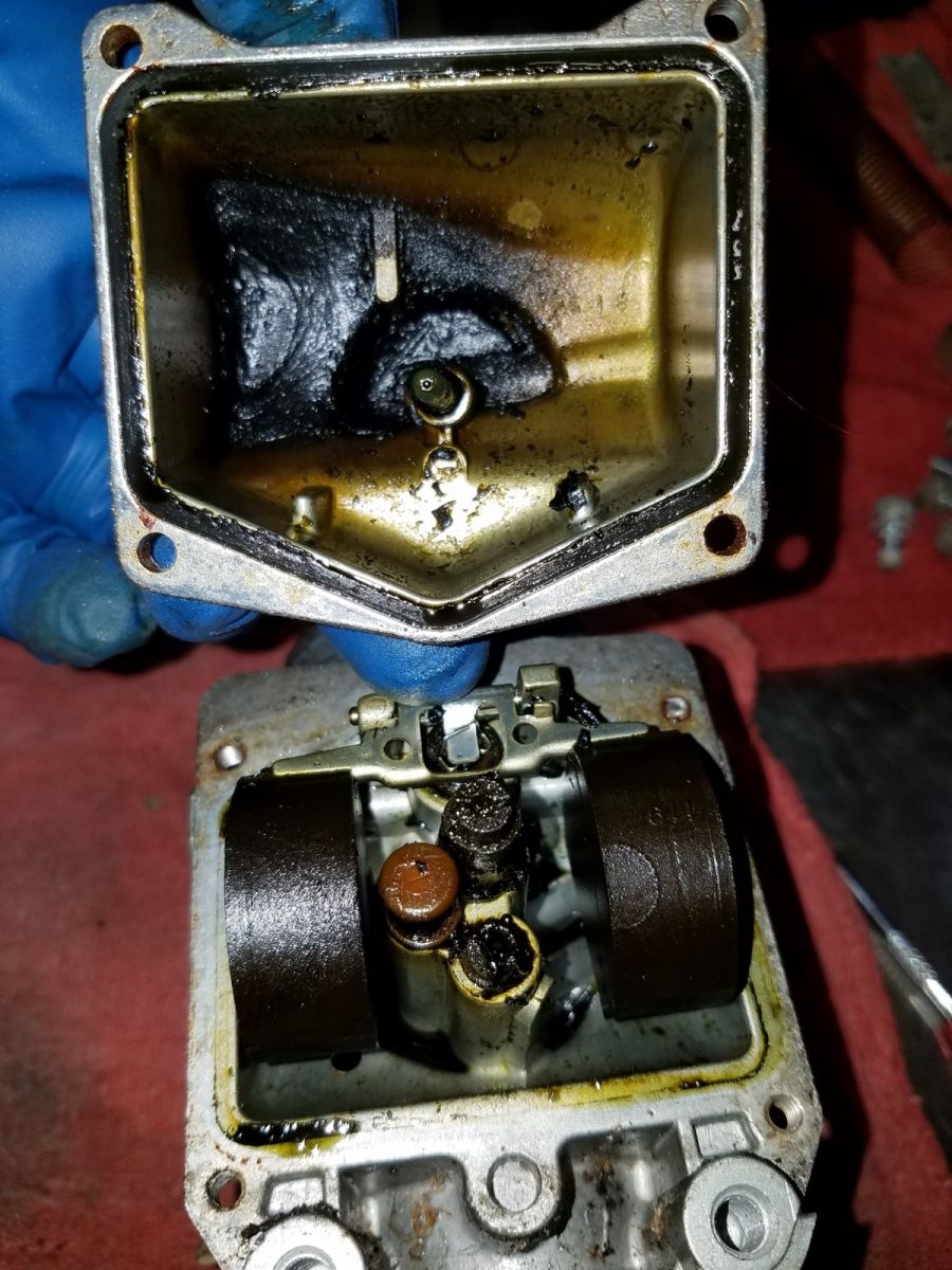

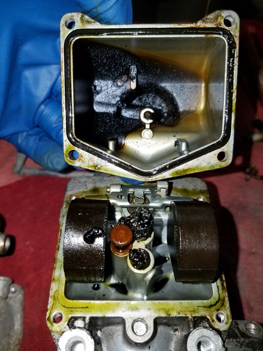

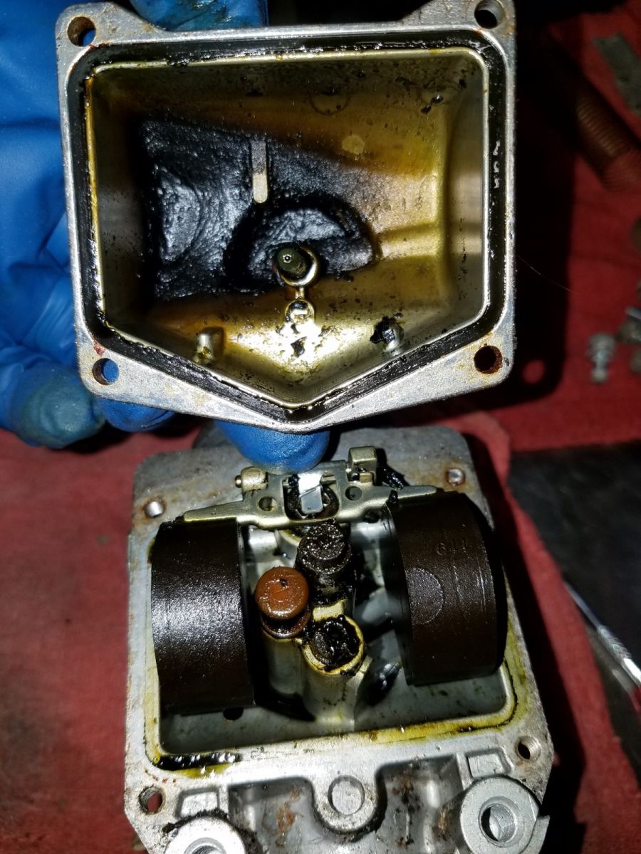

If anyone wonders what happens to gasoline after sitting for 28 years, here is your answer! Getting the float bowl screws out has been the most difficult part so far. 16 possible points, final score - Skidmark =14, float bowl screws =2. At least one broke above the sealing surface, so I won't have to drill it out. The other broke flush. Bummer. This was after soaking with penetrating oil.

I've seen worse. Those will be okay.
If you need float needles get Keyster brand. They are the only ones with a spring strong enough to hold up the float like the OEM parts.

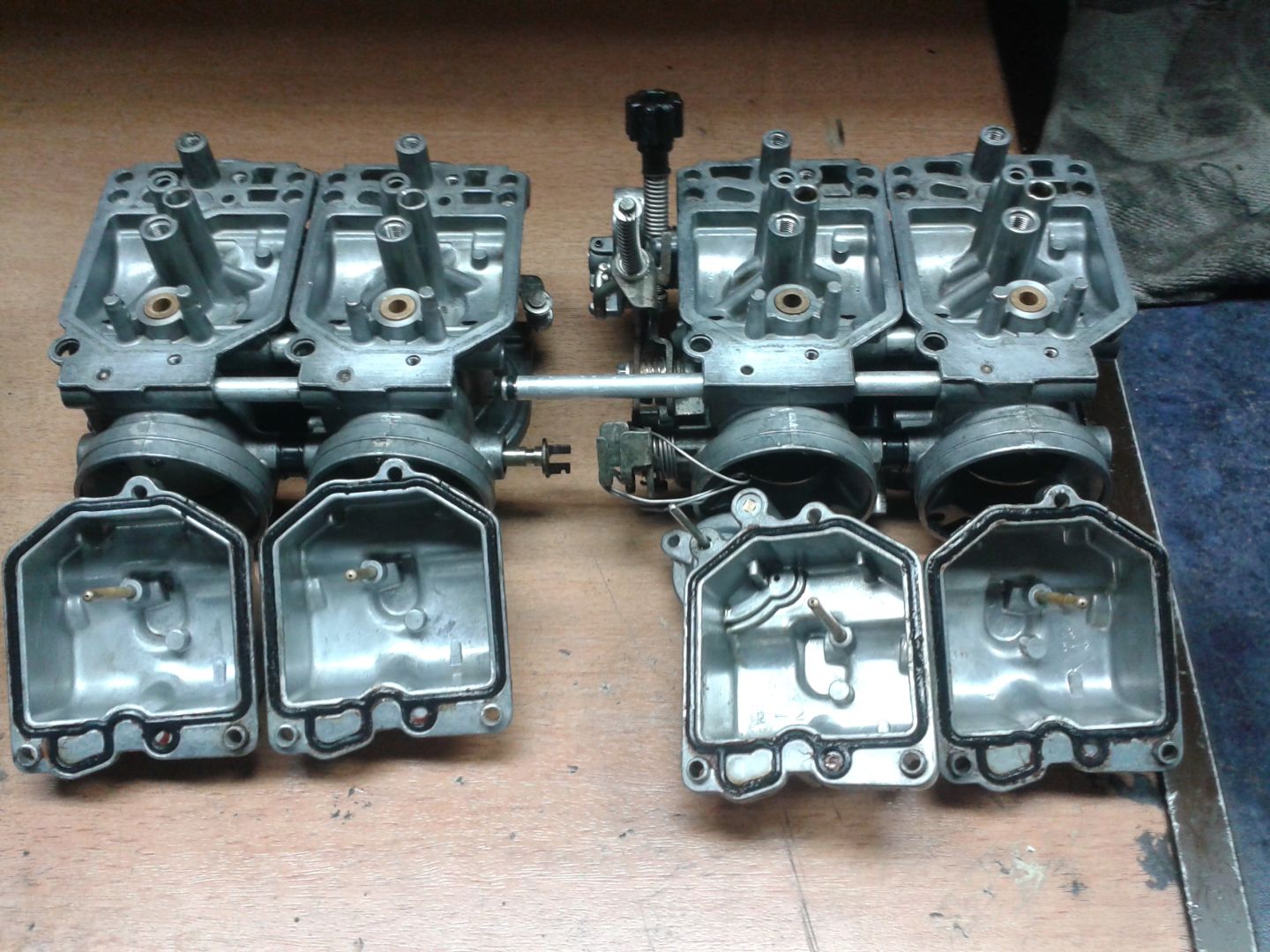

Any issue with soaking these floats in carburetor cleaner for prolonged periods of time?

Never had any issue with the floats in carb dip. This carbs (CB 650) are looking like yours before and are clean as new now.

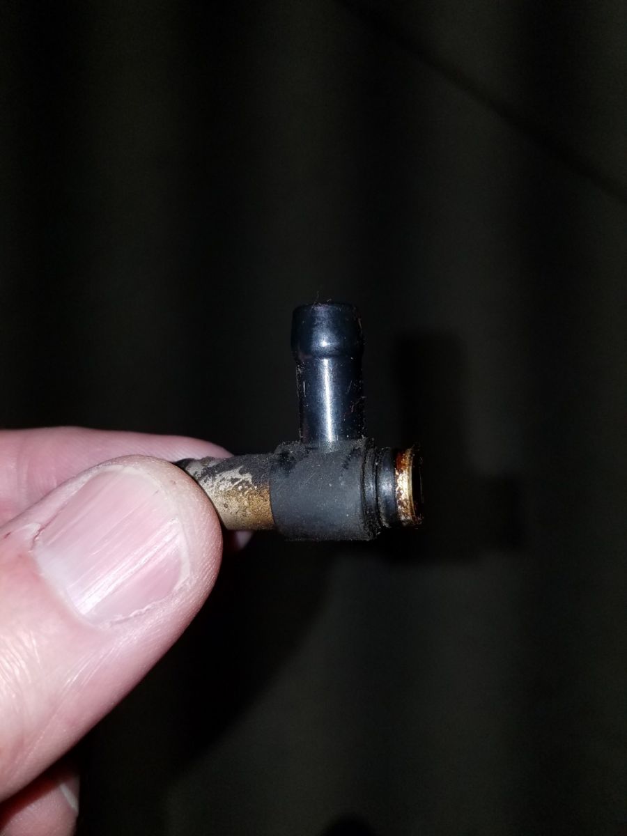

The fuel T looks pretty good, just needs to be cleaned like everything else. I will be extra careful with it as it's probably very brittle.
