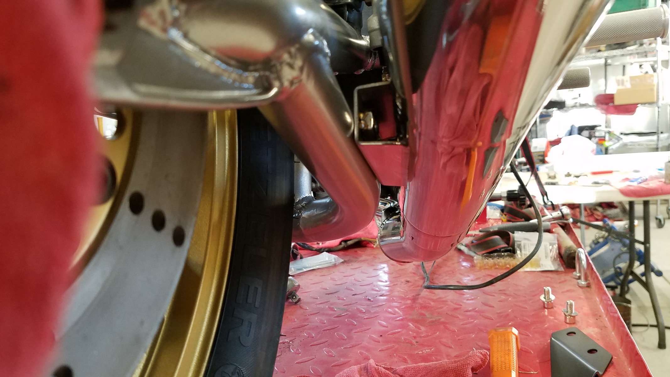

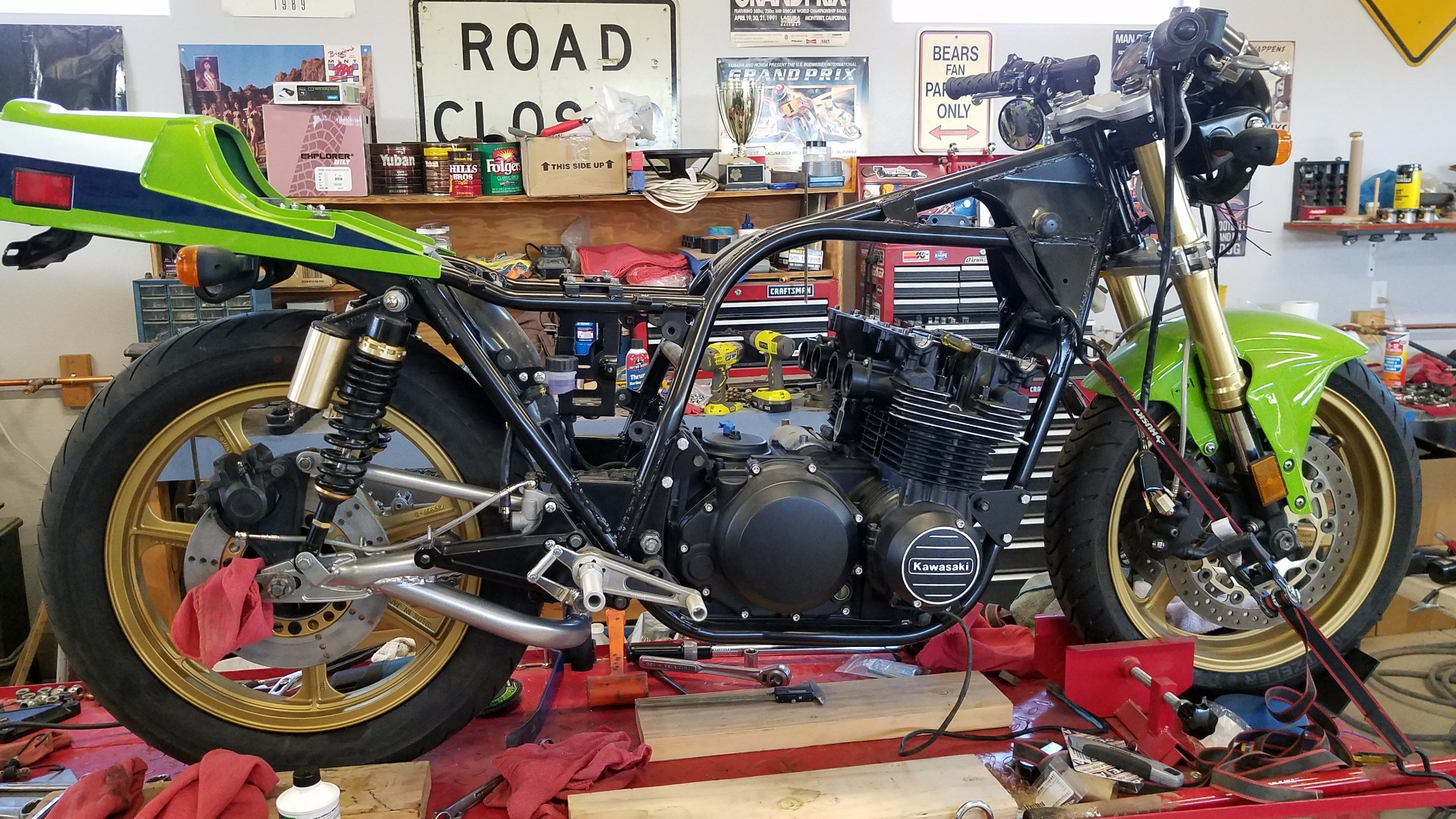

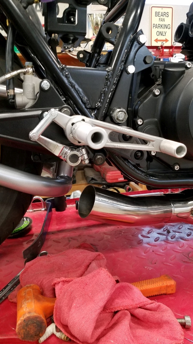

Two steps forward, three steps back. I love the exhaust system, the muffler mount, well, not so much...

Re: Saving a '81 KZ750-E
16 Jan 2021 15:58
Oh man! I feel ya. I have had setbacks also.
Can’t you just put a flexible connector between the muffler and the collector... :silly: kidding

Well, I am certainly NOT modifying the swing arm again... this shouldn't be too difficult to fix. It may entail bending the mount bracket, or at worst some cutting and welding.

There! I fixed it. No more clearance issues! My neighbors won't like me much anymore, though... :silly:

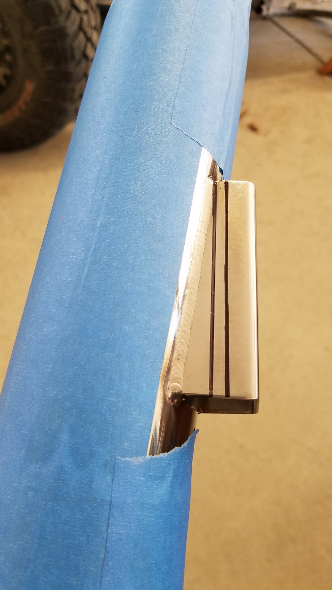

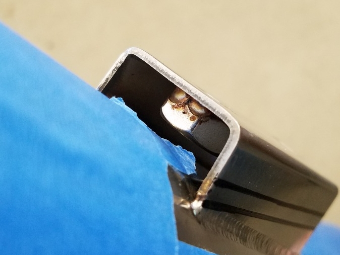

In a game of inches, or fractions thereof, take what you can. For starters I can make another 3/8" or so by moving the mount bracket closer to the muffler. Two cuts on each side, the weld it back on. All taped and marked up, ready to cut and weld. I will gain more room by bending the bracket that bolts to the footpeg bracket. I can only go so far before the nut contacts the muffler body. I may put a strategic dent in the muffler to recess the nut farther to gain a little more space.
