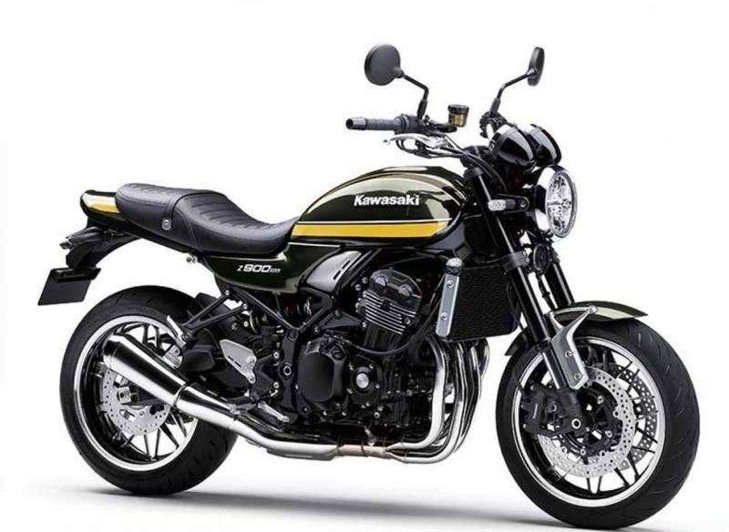

30 Dec 2020 09:59These bikes have been out since 2018-ish. I want one so bad. I think I'd go for one from the first 2 years, as they have the original orange/brown Z1 colour scheme, and they're starting to slowly pop up in the used market.

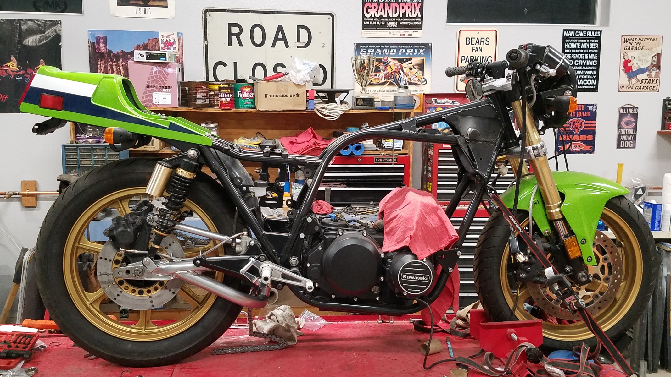

She is back on both feet again. I packed the swing arm bearings and pressed them in today. Got the back end put back together. Now if I could just get to the bench with the cylinder head on it... :dry:

Note* this is not ride height, the front suspension is being compressed by the tie downs.

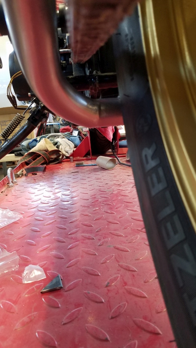

Good work, looks like your back on track again. How much chain clearance did you end up with?

Loads of space!
I imagine you can hardly see the change to the swingarm from the side. Nice work.
