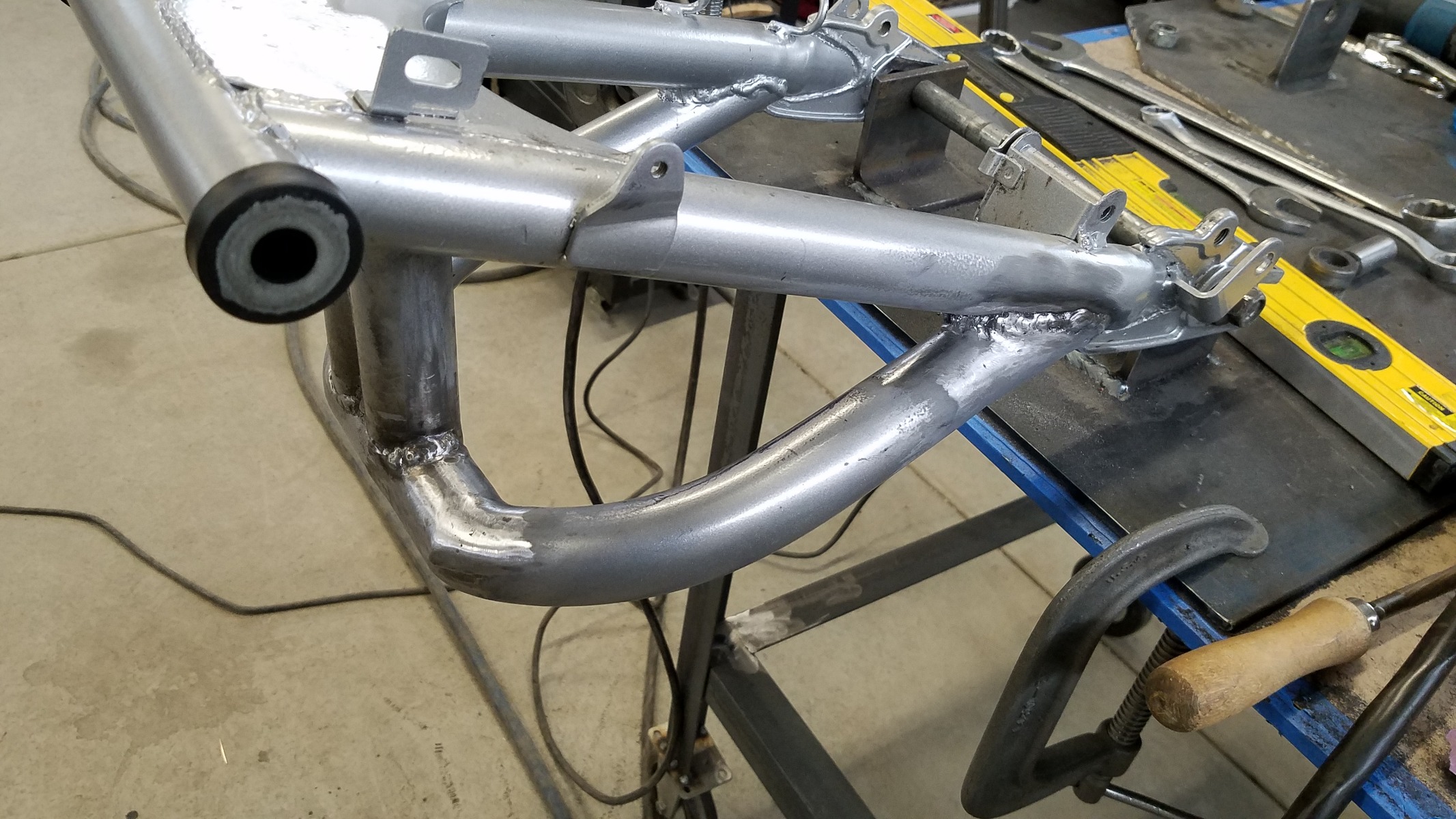

Since that is a stressed menber, I would take it to a pro to get the most penetration. Just my opinion. Way to think out of the box. I'd also have that shifter worked on!!
- Skidmark
- Posts: 1087
- Thanks: 312
Re: Saving a '81 KZ750-E
17 Dec 2020 10:30
The tubing is .083" wall thickness. My welder is set hot enough to easily blow hole through the tube wall if I am not very careful. There is plenty of penetration under these weld conditions. And the brace is not a "stressed member". It will only come under load with a torsional force to the OEM swing arm it is welded to. As always, I appreciate opinions and comments. But you know the saying... we all have 'em!

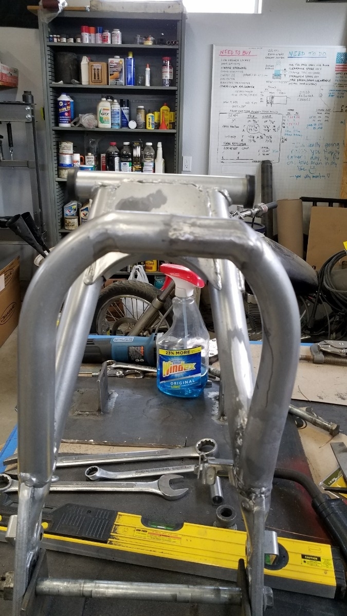

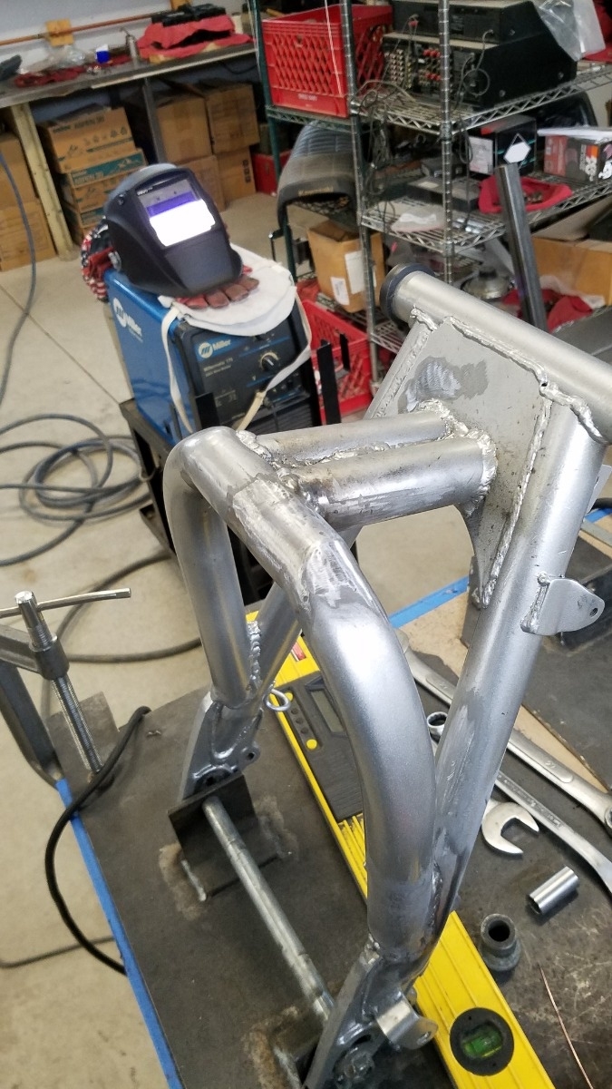

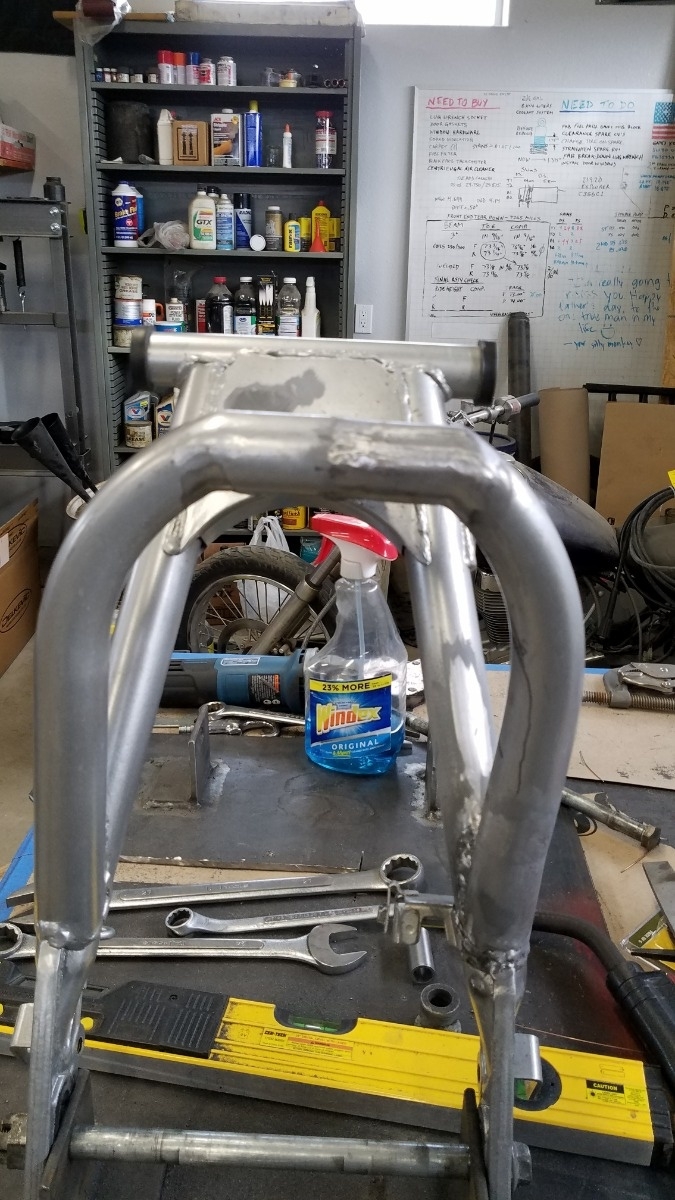

I am getting very close to having the swing arm ready for powder coating. Still doing some finish grinding and sanding, then I need to pull the bearings out. I found some replacement bearings at a company called Motion Industries for $6 each cheaper than both Partzilla and Z1E. The replacements should be here before the powder coating is completed. Once all of the prep work is done I will post some more pictures of it before it goes out for coating.

Getting closer with the grinding and sanding. Should have it out for powder coating in the next week.
