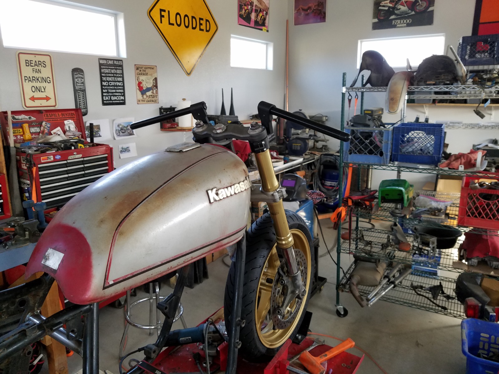

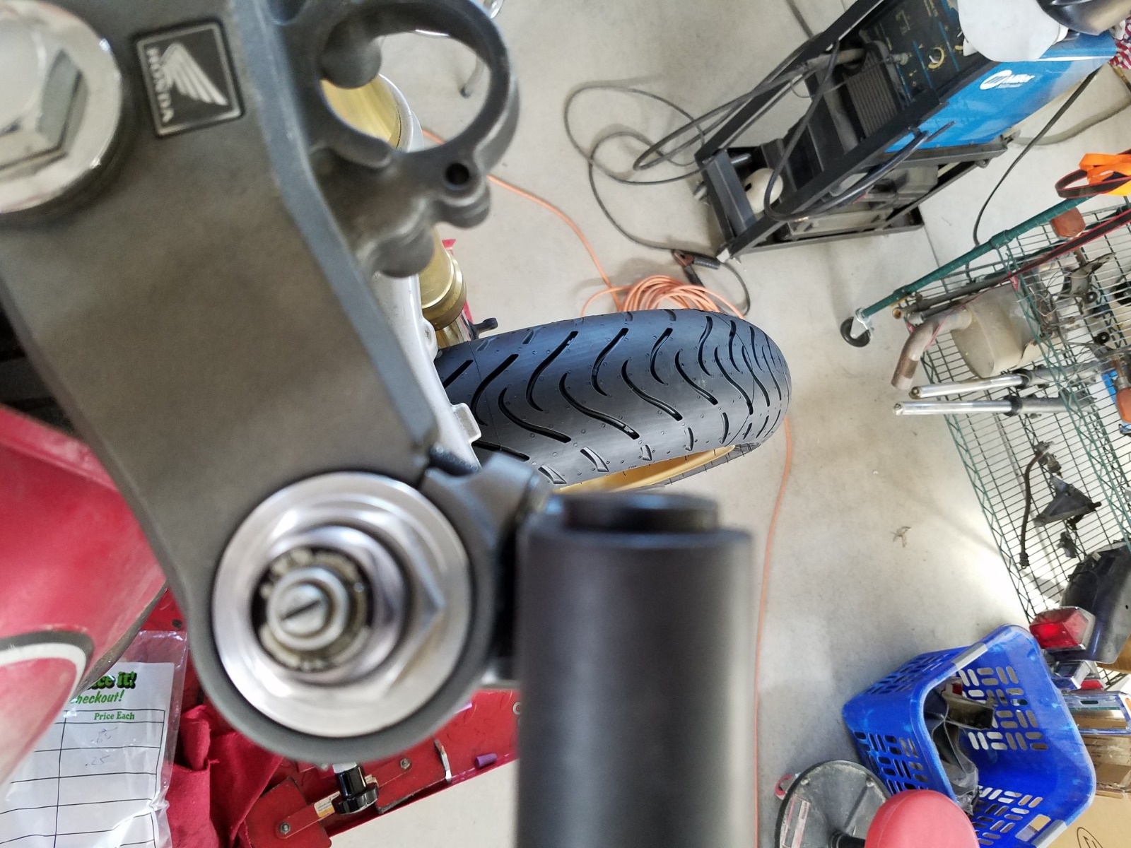

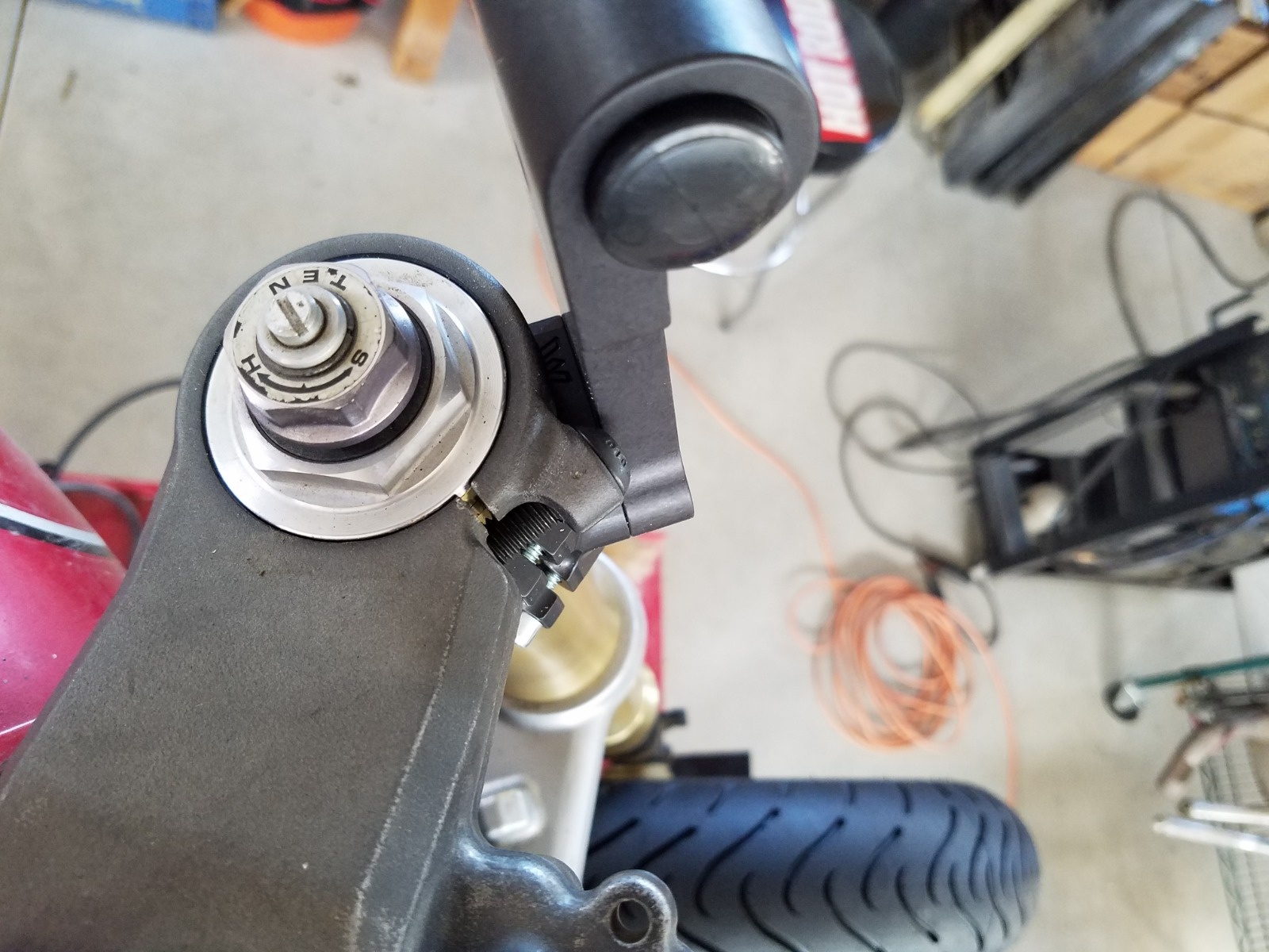

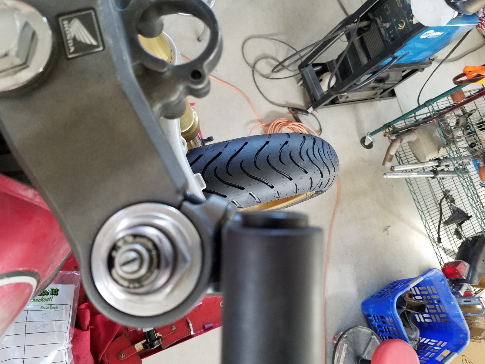

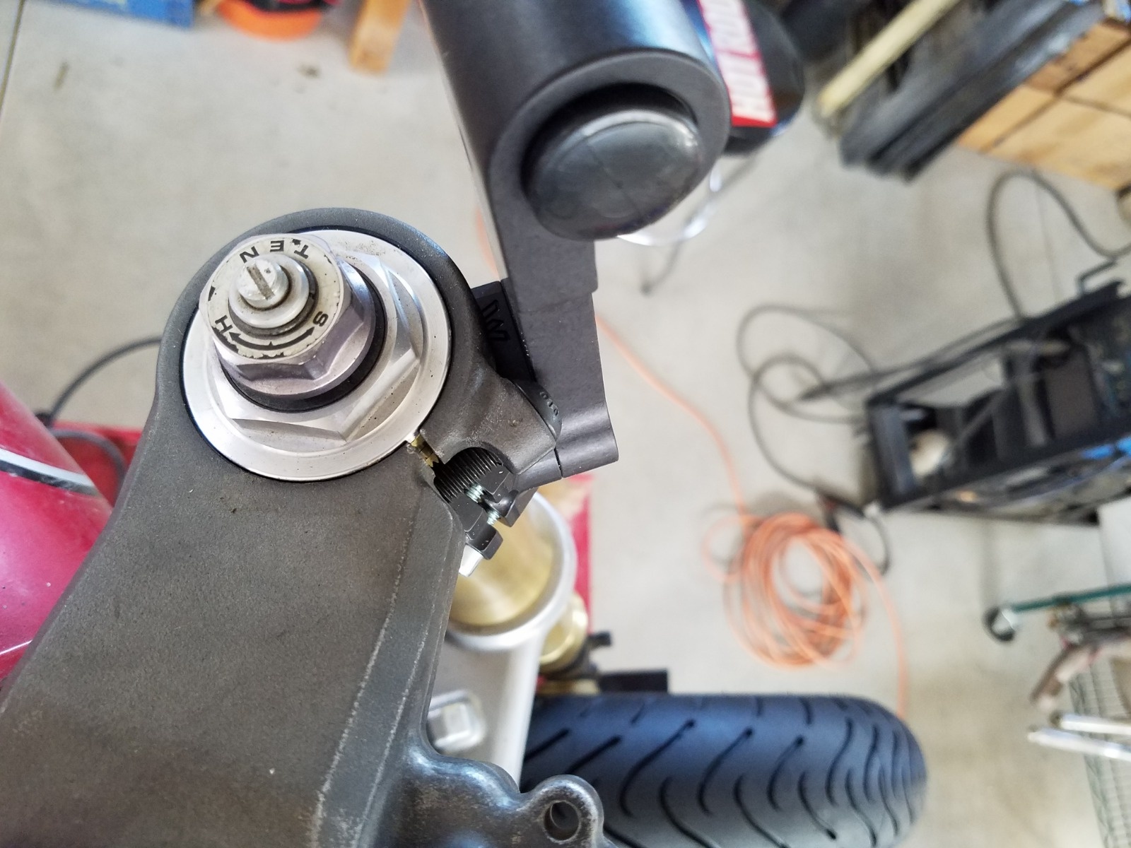

I found some pan head screws today that allowed the bars to move another 3/4" forward. I will use this position to get the steering stops dialed in. I'm planning on about a 1/2" of clearance at the tank at full turn.

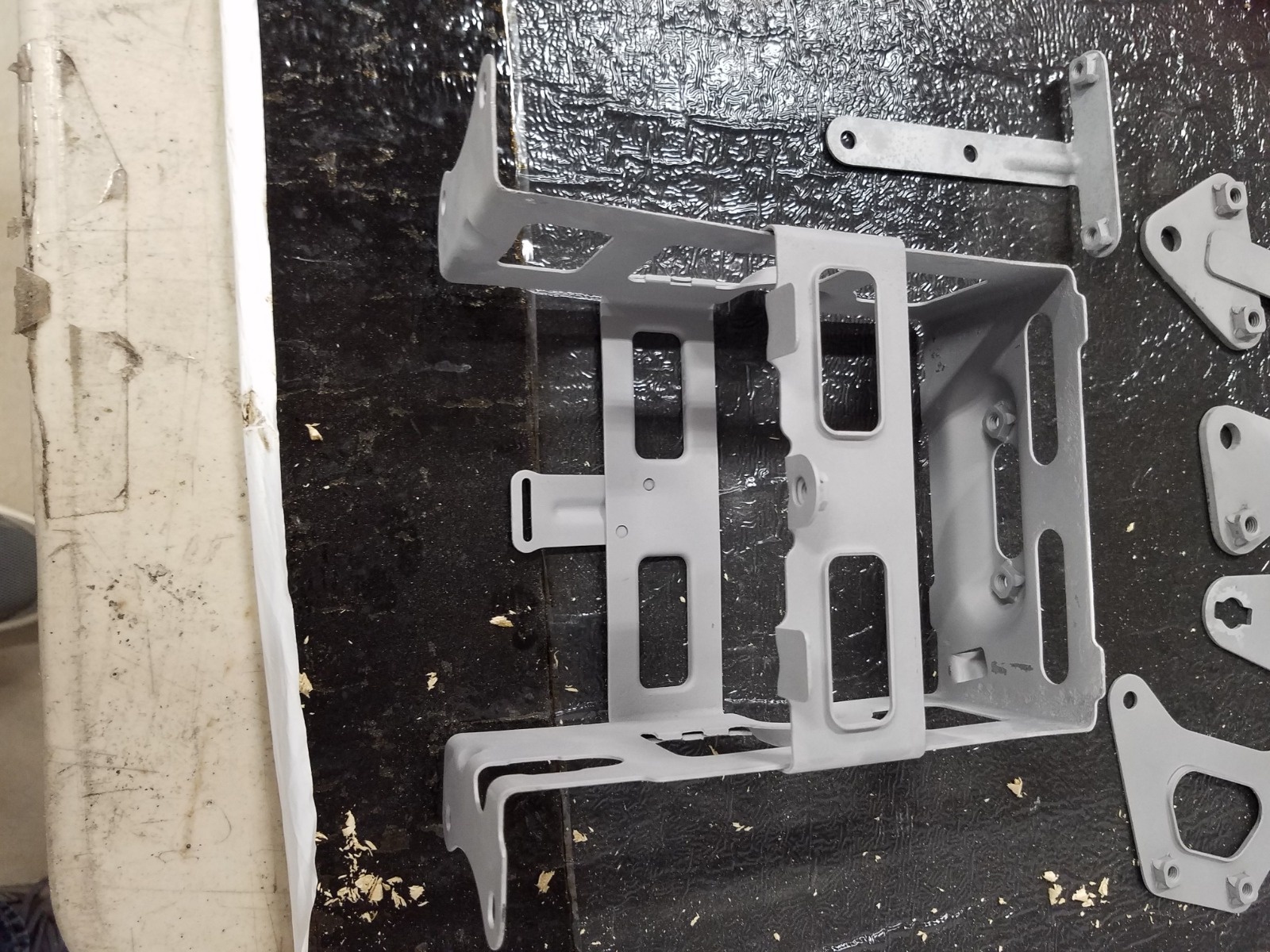

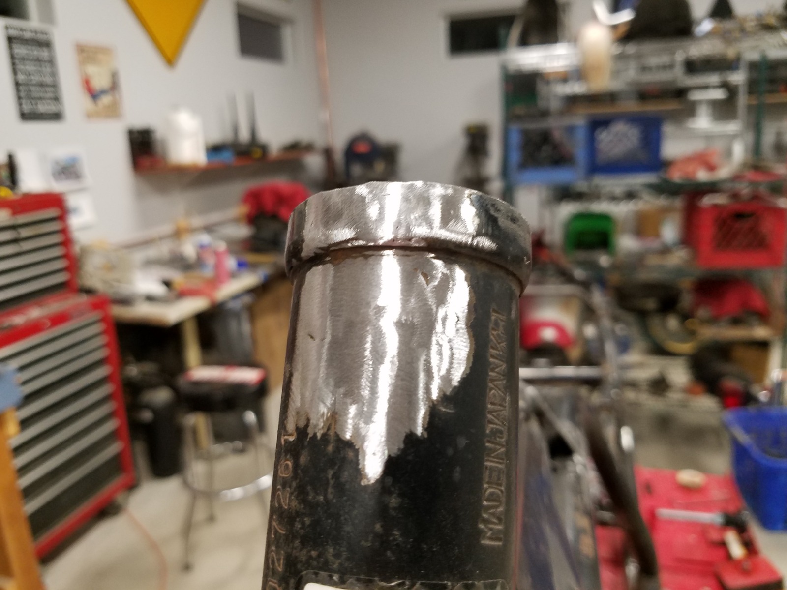

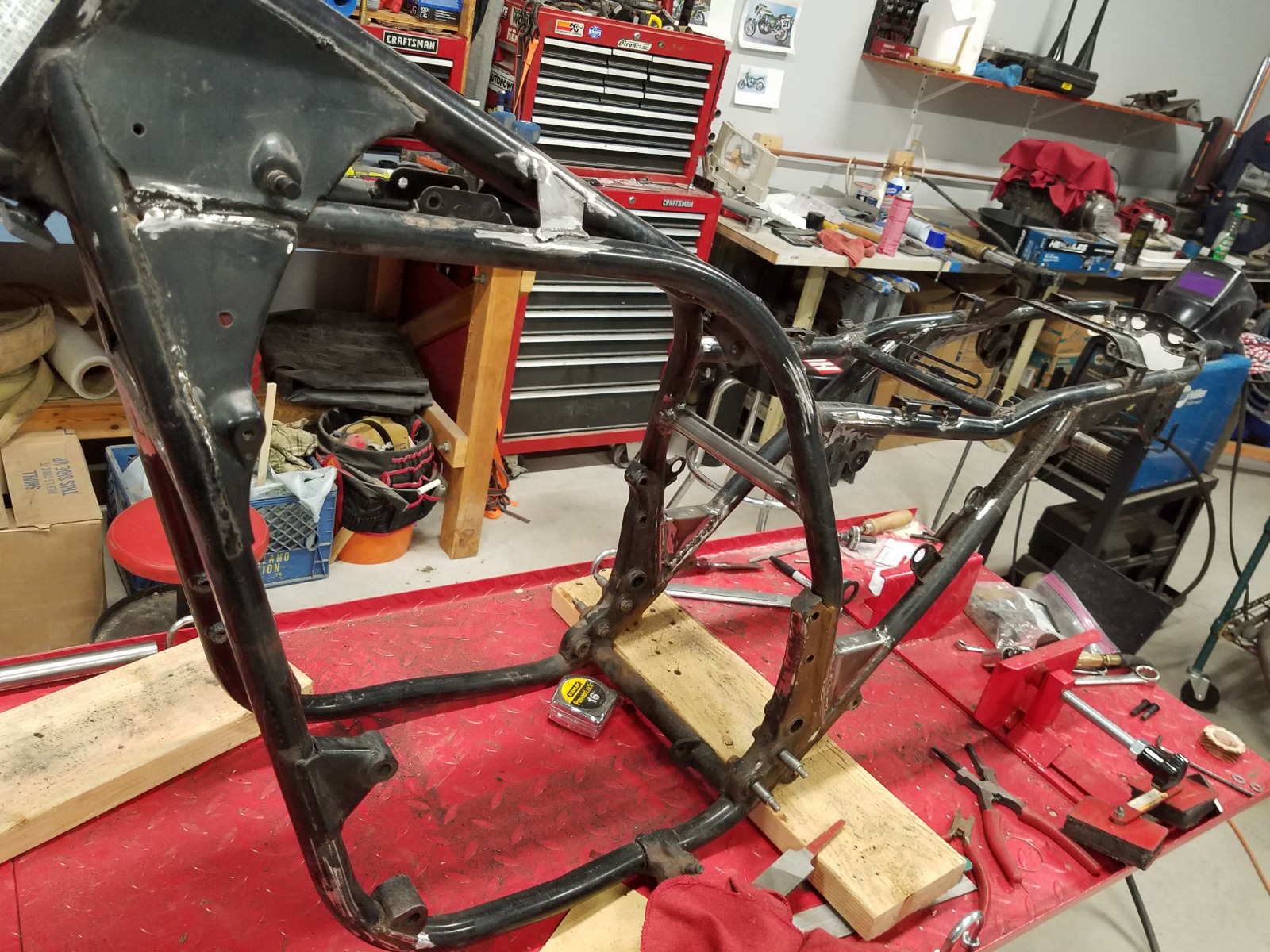

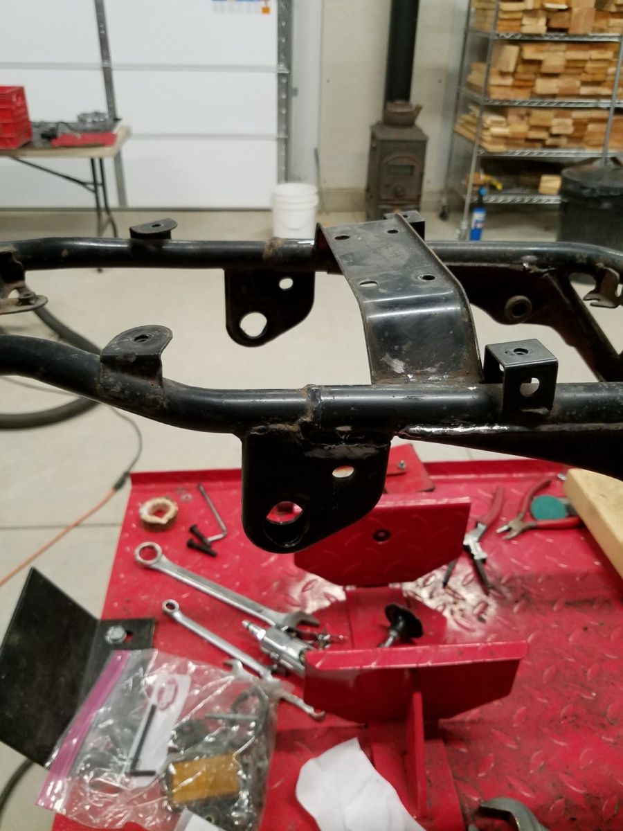

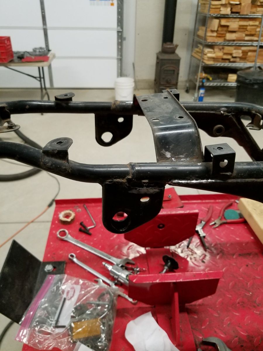

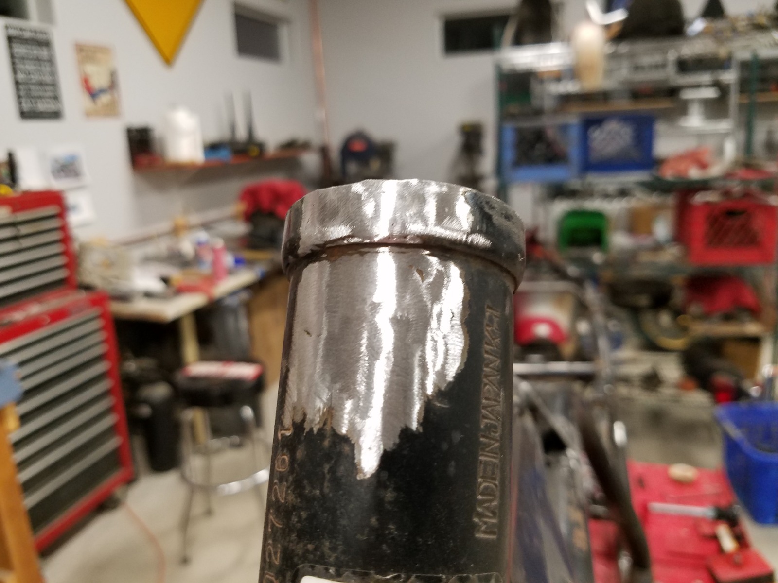

I spent a couple hours today just cleaning up the frame with an air grinder. What Kawasaki left on and around their production welds was pretty disappointing to me. But if I am going to powder coat it, may as well fix all the ugly stuff.

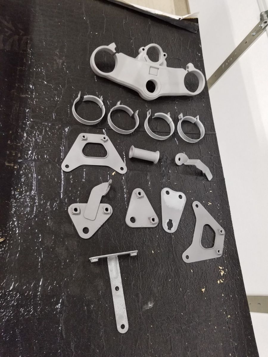

I started to clean all the other bracketry that will get coated with the frame. I love my blast cabinet!

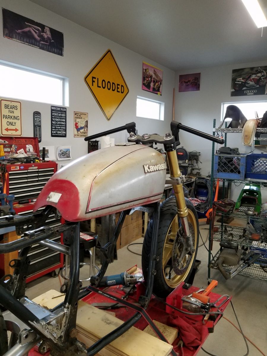

Trying to decide to reduce the size of the stock rear signal brackets, or cut them all the way off and make my own to fit the turn signals I buy. I'm not putting the grab rails back on, or the rear foot pegs. But thinking leaving it optional for a future owner may be a good thing.

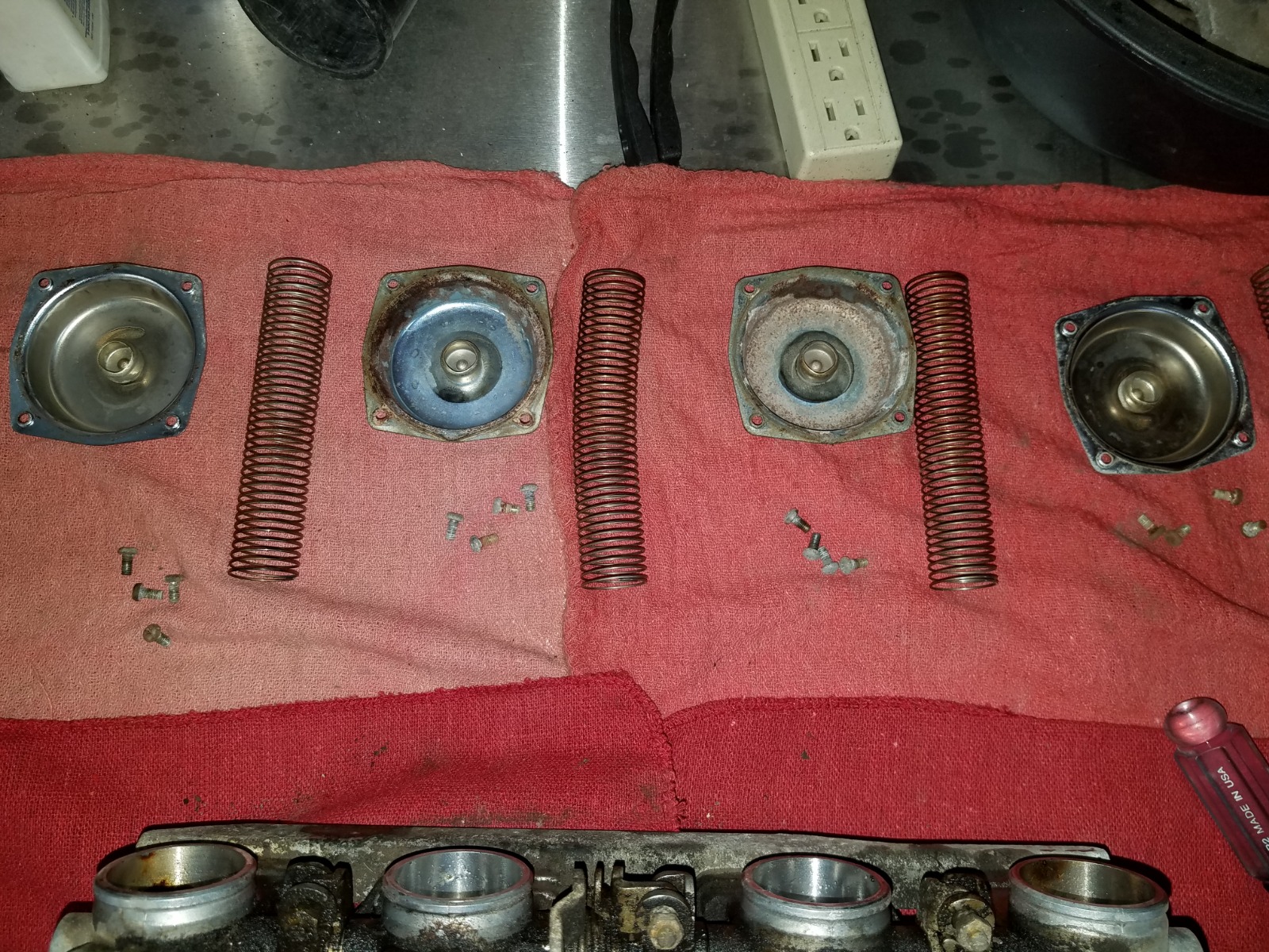

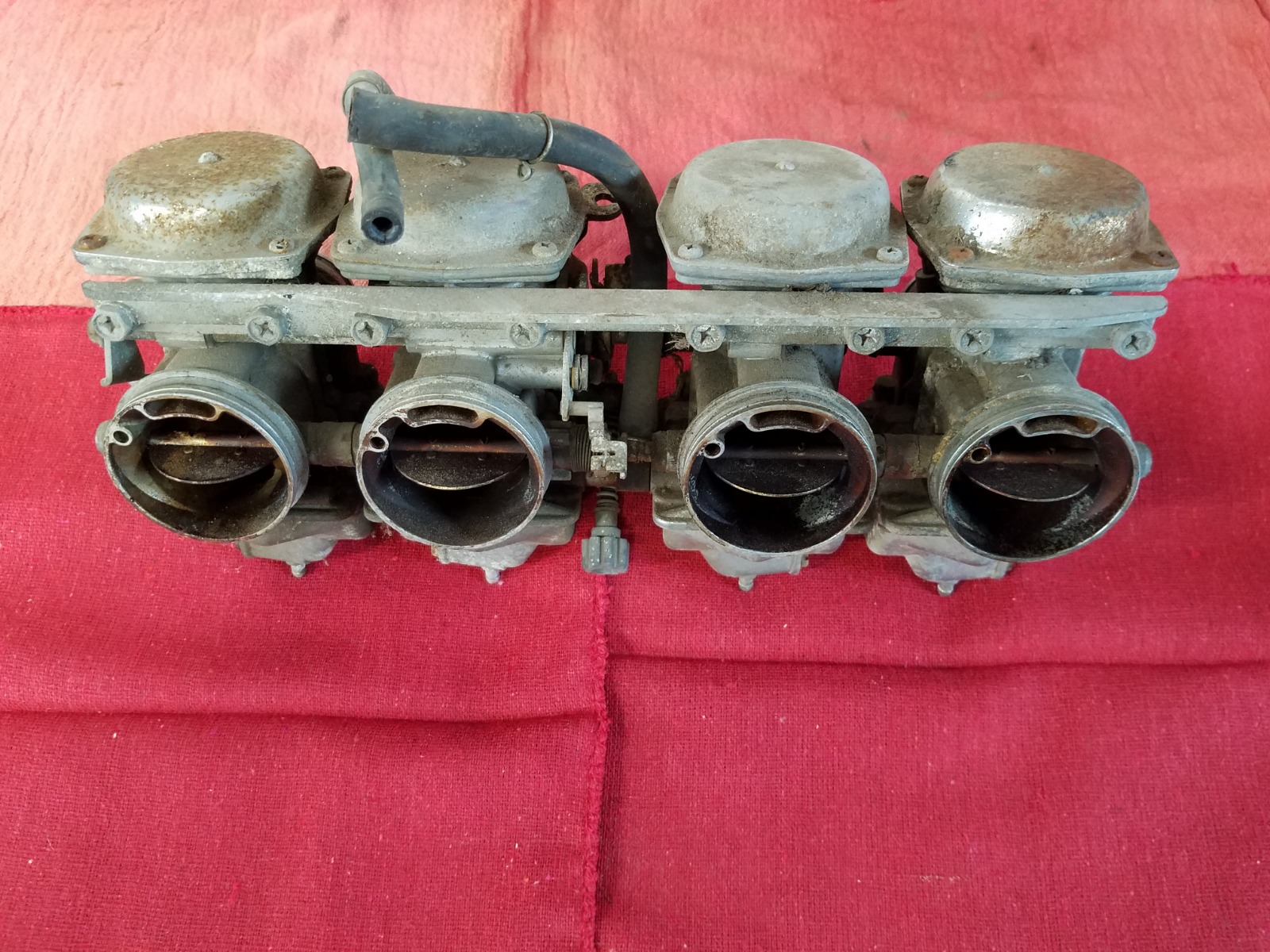

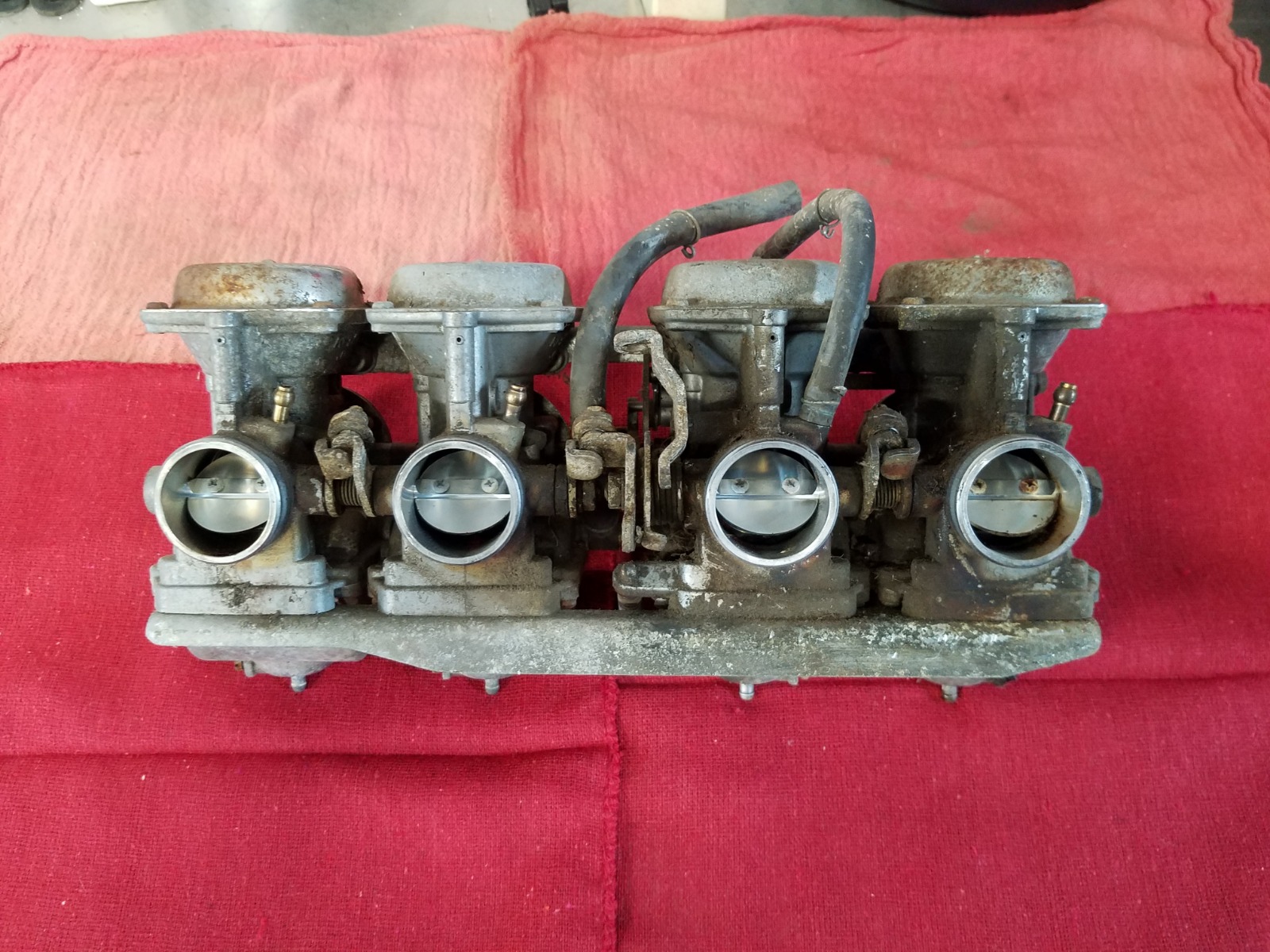

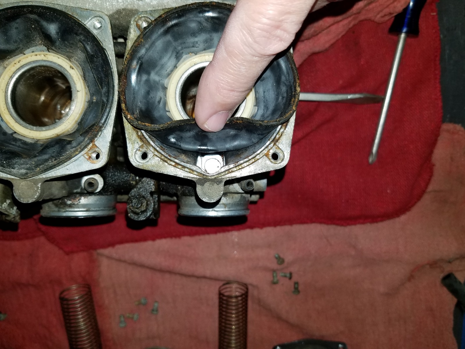

I finally started looking at the carburetors today. With some WD40 I was able to get the choke and throttle shafts moving again. Decided to get the vacuum pistons out and see how the diaphragms are looking. All the pistons were frozen in place. After liberal quantities of WD40, I was able to get 3 of the 4 out. Both outers were more difficult, with one of them being the last remaining. I hope I am up to the task of saving these!
Retired gearhead
'81 KZ-750 E2
'81 KZ-750 E2
- Skidmark
- Posts: 1087
- Thanks: 312
Re: Saving a '81 KZ750-E
20 Nov 2019 16:33
The diaphragms are still pretty pliable and crack free. The corrosion will be the big deal in getting these working or not.
Retired gearhead
'81 KZ-750 E2
'81 KZ-750 E2
- Posts: 8144
- Thanks: 3527
20 Nov 2019 17:02
Heat on the body will soften the varnish holding the slide.
