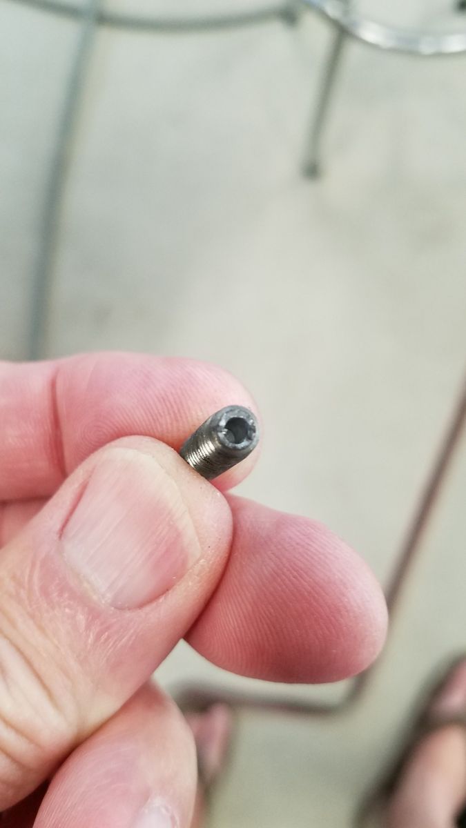

Not something to be proud about, but I am getting rather good at this crap... five new clutch bolts are on their way.

06 Oct 2020 16:58Skidmark wrote: Not something to be proud about, but I am getting rather good at this crap... five new clutch bolts are on their way.
Getting good at breaking them??? lol

Yes, which leads to experience taking them out.

Sunday I was heartbroken, I was going over the cases looking for any issues before I send them to vapor hone, and sure as Hattie's I find a a broken bolt in the upper case for the clutch cover. Threw it up on the bench and started to pick at it to see what I was up against... Whoo Hoo it just silicone. Dug most of it out and run a 6mx1.00 tap in and all set...
Sorry didn't mean to rub it in... carry on... Mikey Likey!!!
