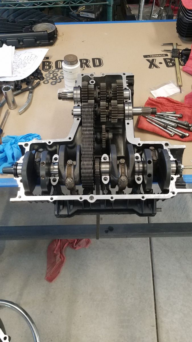

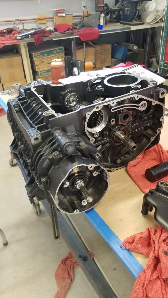

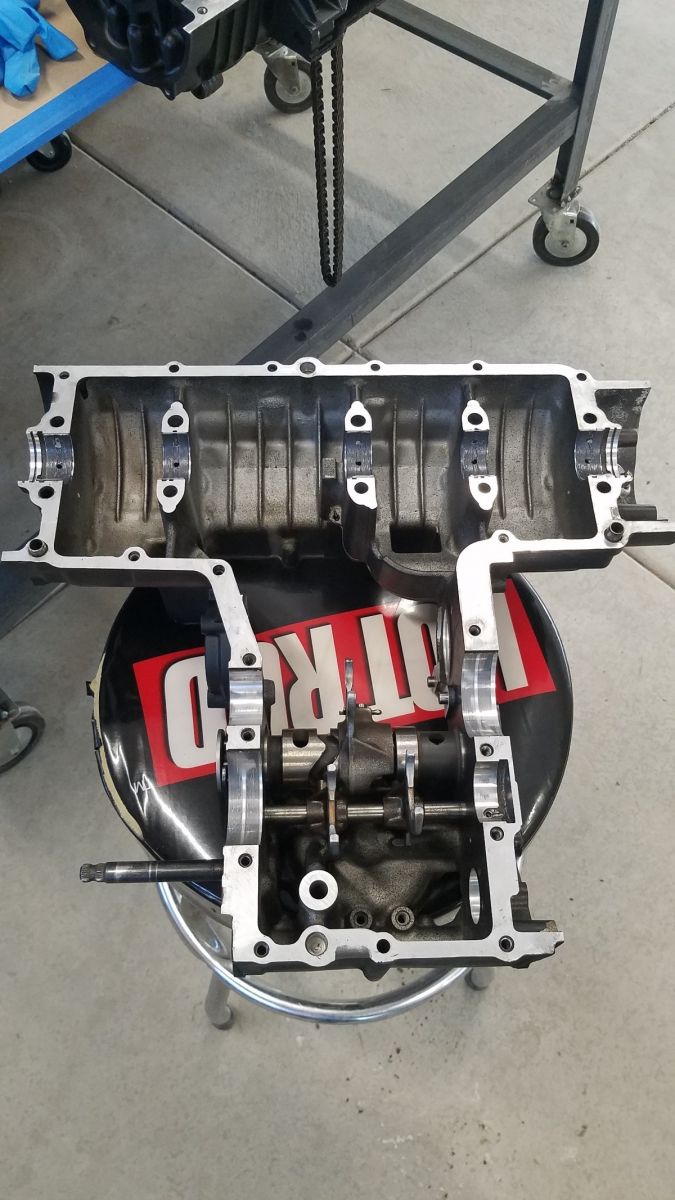

20 Sep 2020 17:24
Retired gearhead

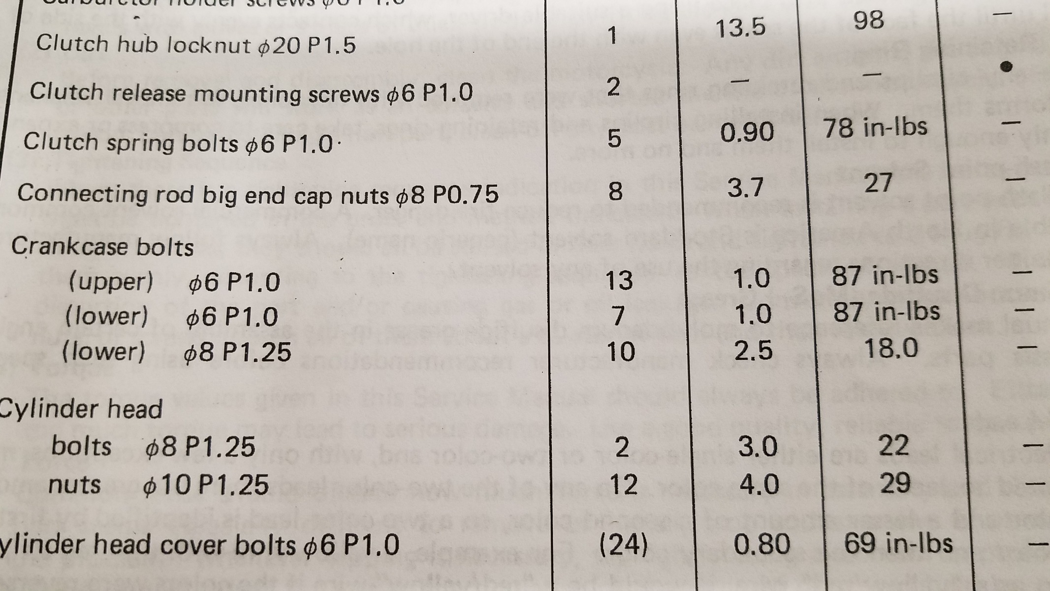

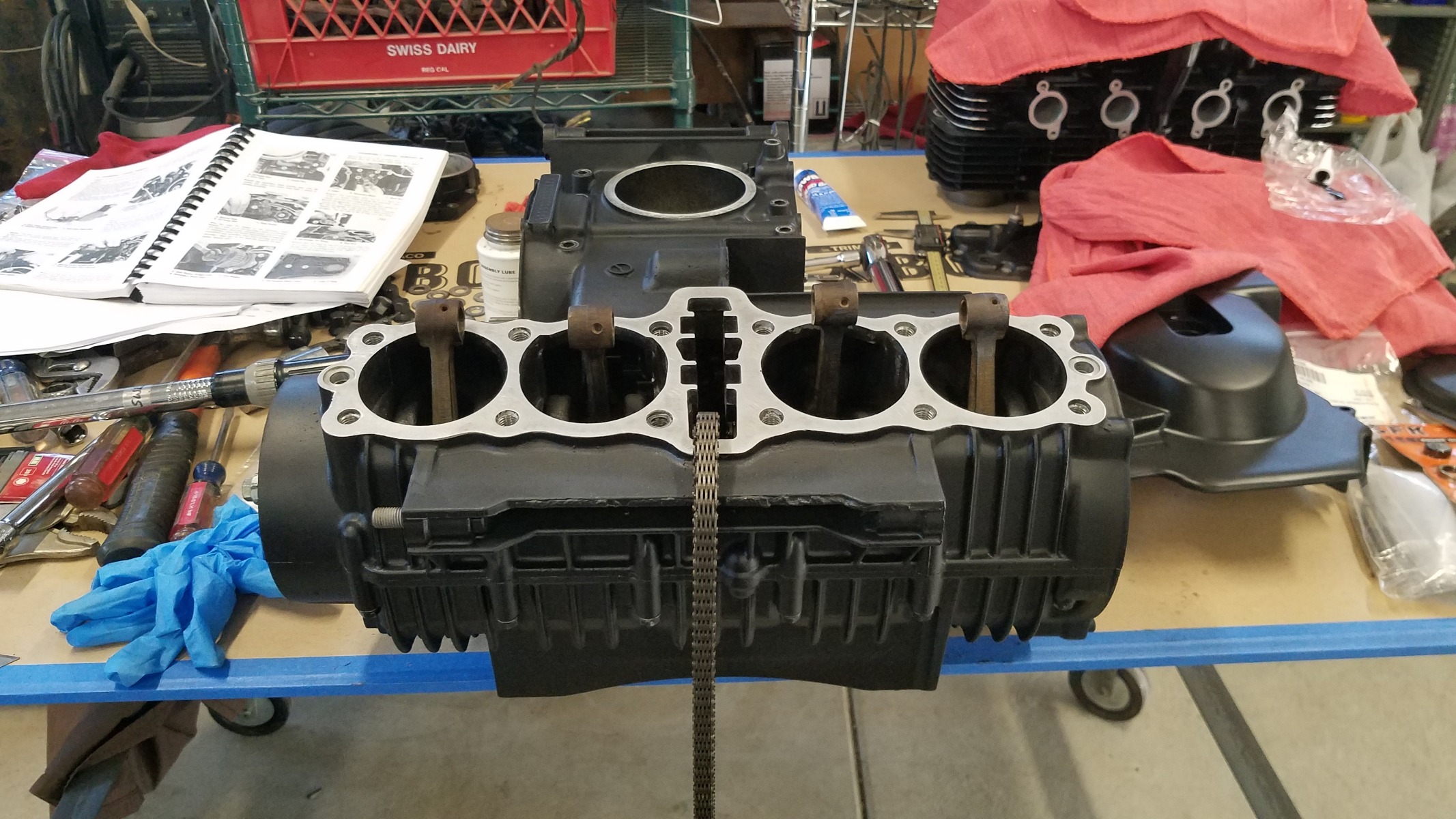

Re: Saving a '81 KZ750-E
20 Sep 2020 17:34
The 6 mm lower case bolts should be torqued to 87 in/lb, according to the shop manual. I verified the torque setting several times, but my torque wrench isn't clicking. I am at a tension that I do not feel comfortable going beyond, for fear of damaging case threads. It may be time for a new torque wrench. Cheaper than messing up the case threads!

- KZJOE900
- Administrator
Super Users
- Posts: 1984
- Thanks: 455
20 Sep 2020 18:45 - 20 Sep 2020 18:45
One hundred percent agree with you. Nothing will ruin your day more than a stripping a bolt. Your patience will pay off. Even 87 in/lb seems high for a 6 mm. The 6 mm bolts for my 900 take 69 in/lb. What shop manual are you using? I would only trust the factory service manual. I have run into some wrong torque specs with my Clymer shop manual. Would have stripped some cam bolts if I would have used the recommendation in the Clymer on my bike.

- Skidmark
- Posts: 1087
- Thanks: 312
20 Sep 2020 19:41
I am using the factory shop manual. But my gut is telling me to stop.

- Posts: 8066
- Thanks: 3453
20 Sep 2020 20:00
You're gut is right. Allow your judgement to override the stupid wrench. Way too many threads are pulled out from guys blindly following some torque value in the manual when it's not critical.
20 Sep 2020 20:24
FSM states a 6mm bolt should have 54 to 78 Inch pounds

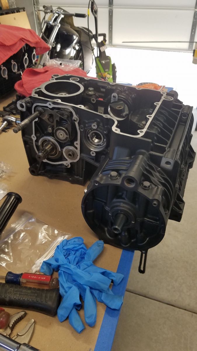

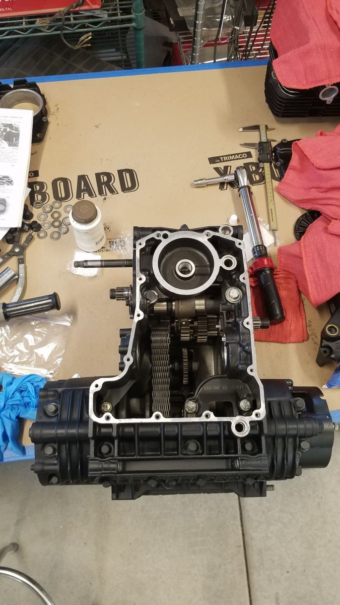

20 Sep 2020 22:30
Retired gearhead
