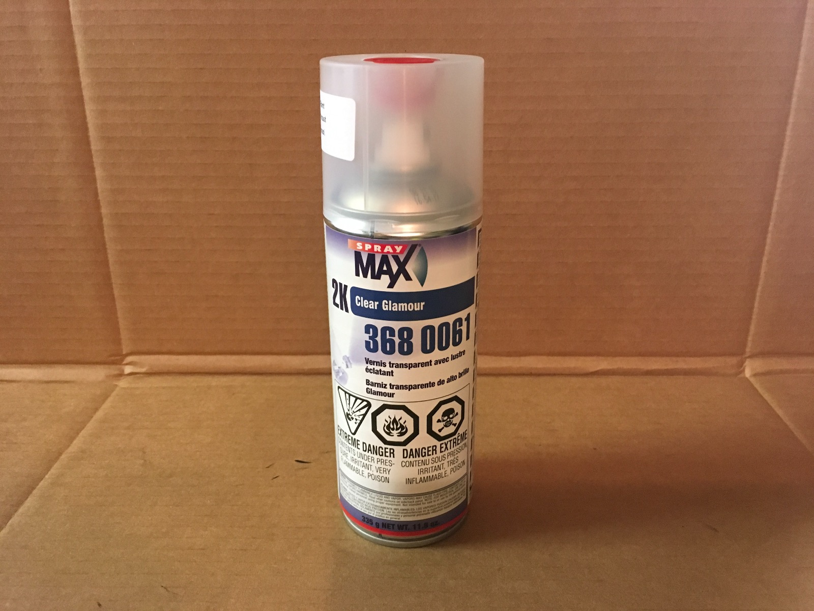

16 Aug 2020 22:02Mikaw wrote:Skidmark wrote:calum wrote: I put clear on mine, but it was 2K clear engine paint through a gun.
I tried looking for quarts or liquid, not aerosol.
I do not believe 2K Clear is available in the US - EU countries cannot ship it here.
It’s available at painters supply in the states. not sure if this one is high heat but they carry 2K

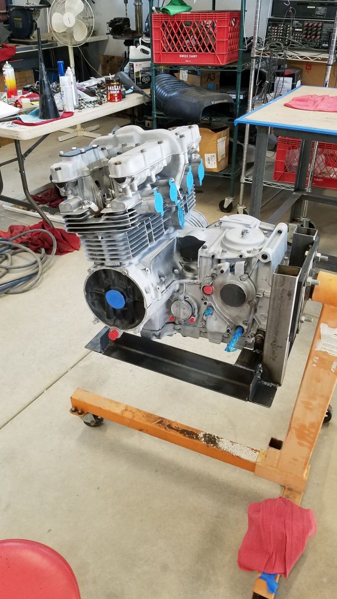

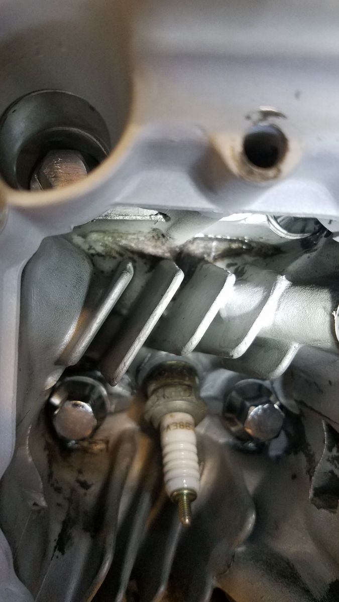

I had thought the ultrasonic cleaning on the cylinder head had just left some of the OG paint behind... now that masking for paint is nearing completion I began doing a really thorough inspection. Old oil and road bits were congealed on top of the head between the fins. A lot of pick work, to be followed up with brake cleaner (carb cleaner doesn't cut it). Yeah, no one will see it, but I will! This thing will be clean. Surface prep means everything to paint adhesion.
Retired gearhead
'81 KZ-750 E2
'81 KZ-750 E2
- Skidmark
- Posts: 1087
- Thanks: 312
Re: Saving a '81 KZ750-E
17 Aug 2020 14:39 - 17 Aug 2020 14:39
While cleaning up the residue left on the cylinder head, I cleaned up the threads in the head for the valve cover using a tap. I was extremely careful cleaning the threads out afterward. I also picked up a thread chasing die to repair some of the bolts. Even though these will not be used during final assembly (only for painting), I didn't want them to mess up the inside threads again. All bolts had the threads cleaned on the wire wheel, then chased with the die. With all that said, the valve cover is on for the last time and ready for paint. I had to order another set of urethane masking plugs to protect the balance of threaded holes, so I have to wait for those to arrive before I can begin the paint process. Small steps... but needed.

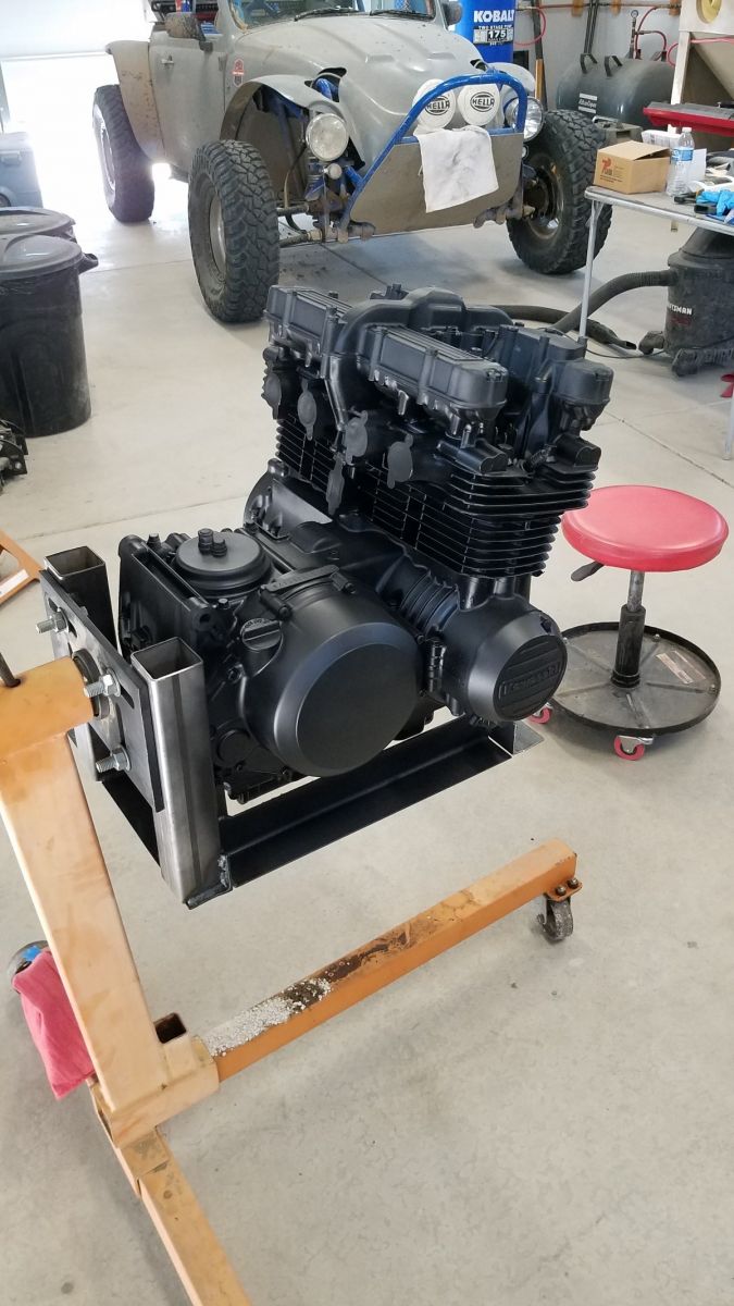

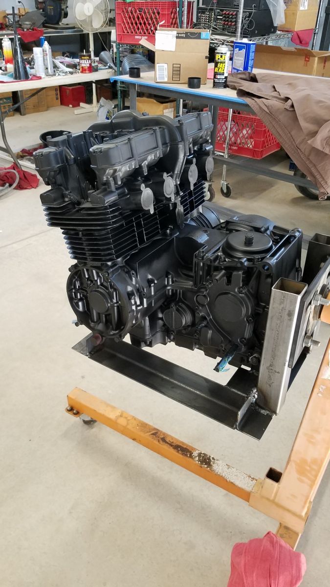

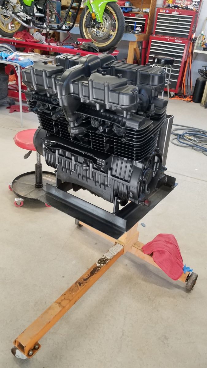

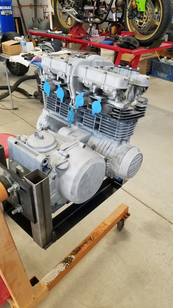

The reason some areas appear glossier than others is I just couldn't wait to take some pics!!! :laugh: Those areas are still wet while the others are drier.
Retired gearhead
'81 KZ-750 E2
'81 KZ-750 E2
- Skidmark
- Posts: 1087
- Thanks: 312
21 Aug 2020 14:54
One aerosol can almost covered the entire engine with a light coat. I am planning on three coats of black, with the remainder of the fourth can left for touch up and stand mounting points.
