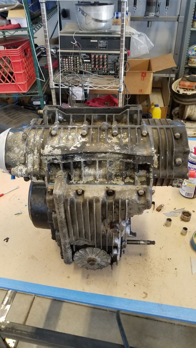

Because I usually end up going down the wrong path first... After my morning coffee, I decided I better get a tape measure out and check the engine size versus the size of my blast cabinet. I could fit the engine in the cabinet, barely. Leaving no room to maneuver the gun. Well, crap! That lead to finding a company nearby that does soda blasting. So the u-turn on this build rears it's ugly head yet one more time. Now it is going to be completely disassembled so I can take the cases in for soda blasting. Always a learning experience. Always. One step forward, two steps back.

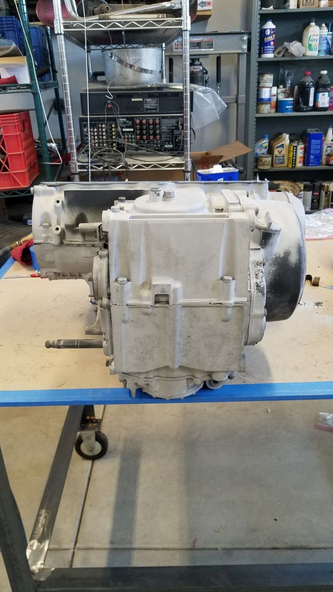

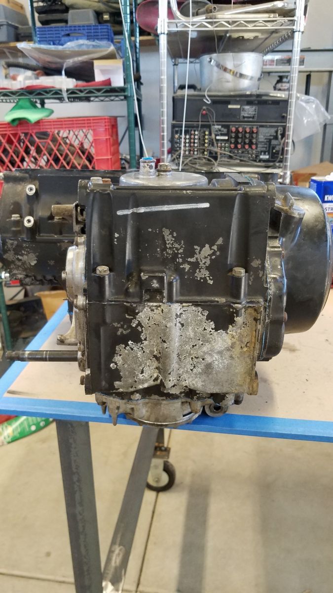

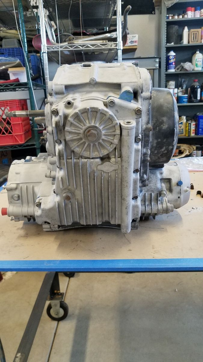

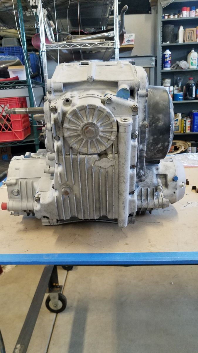

So the local soda blast guy retired and is not longer in business. So why not do another about face? I decided to take the top end off, mask everything off, and get it into my blast cabinet after all. Every part will still get a thorough cleaning after paint anyway. So here we are, ready to go into bead blast...

I blasted my engine in my blast cabinet. Only thing that wasn't was the cylinder head which was soda blasted outdoors. The head has blind oil passages which are not easy to clean so you gotta be careful there. The cases, even if you get media inside, can be cleaned easily enough.

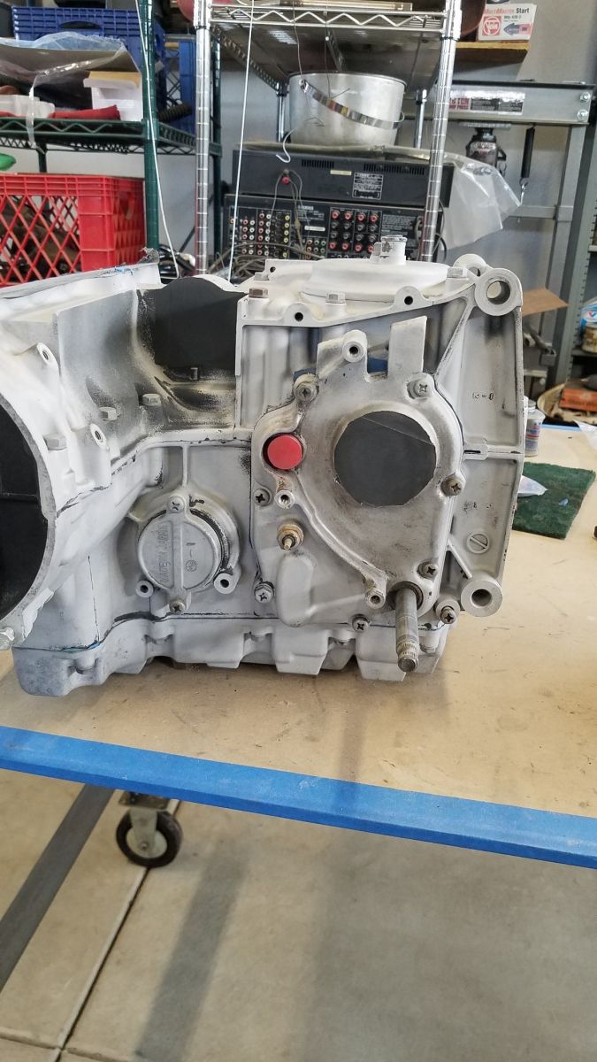

13 Aug 2020 10:46Nessism wrote: I blasted my engine in my blast cabinet. Only thing that wasn't was the cylinder head which was soda blasted outdoors. The head has blind oil passages which are not easy to clean so you gotta be careful there. The cases, even if you get media inside, can be cleaned easily enough.
My cylinder head was cleaned ultrasonically when the head was rebuilt. No blasting necessary. It did not take all of the original factory paint off, but it remains mostly deep between the fins.
I took the engine out f the cabinet to blow it off and look for areas missed. I got around 80-90% of it, so back into the cabinet this morning for more blasting. Once I get it done and cleaned, I will put more pics up.

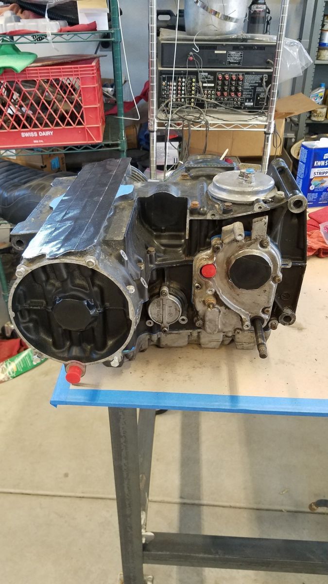

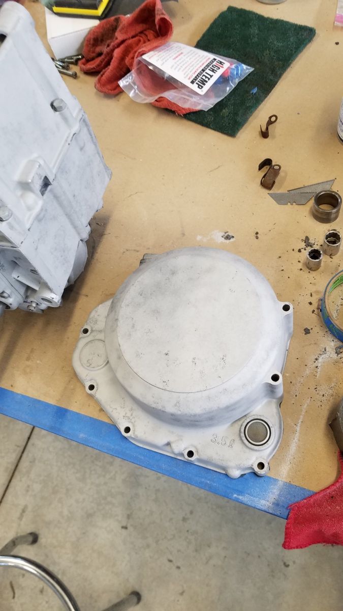

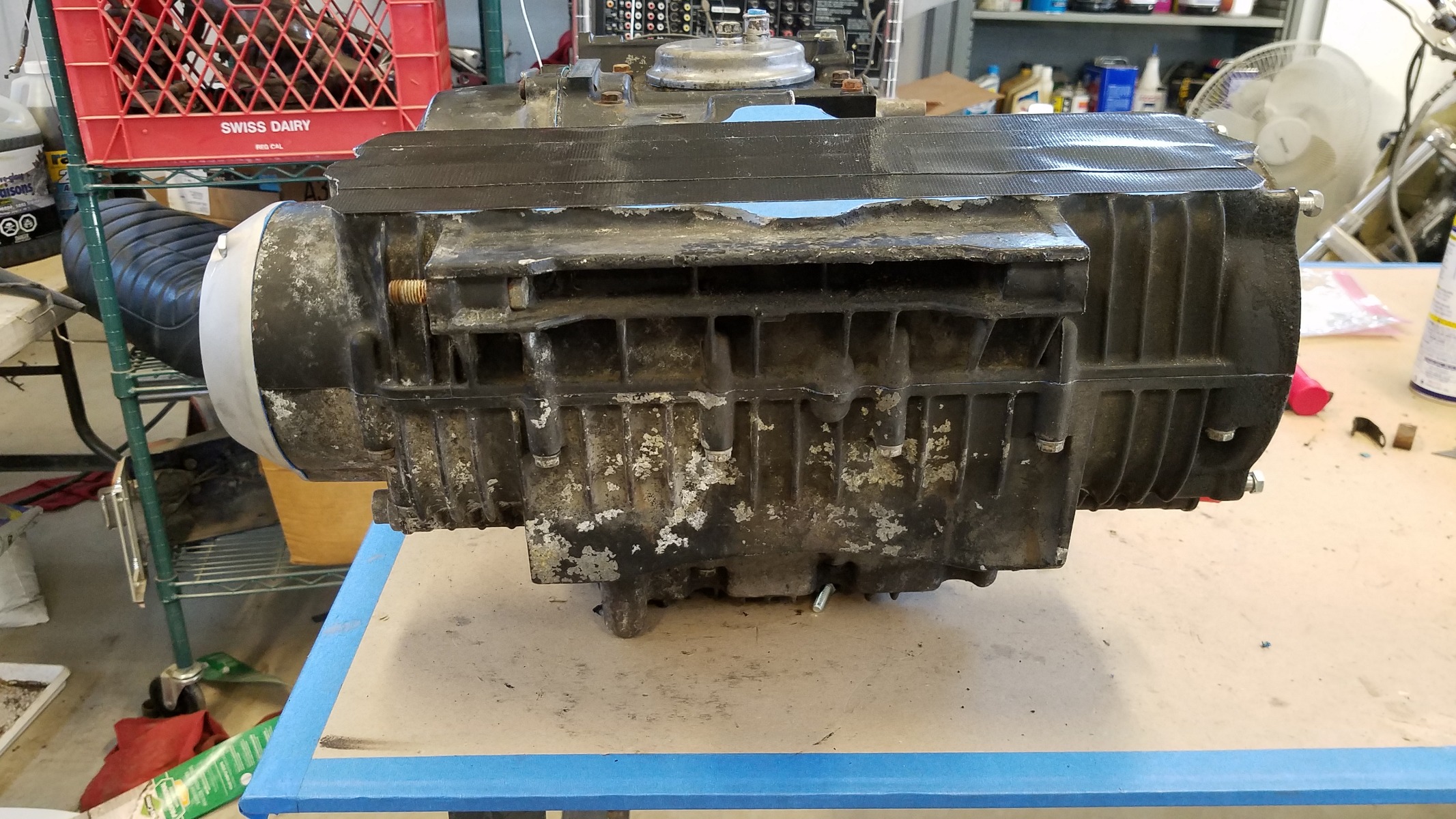

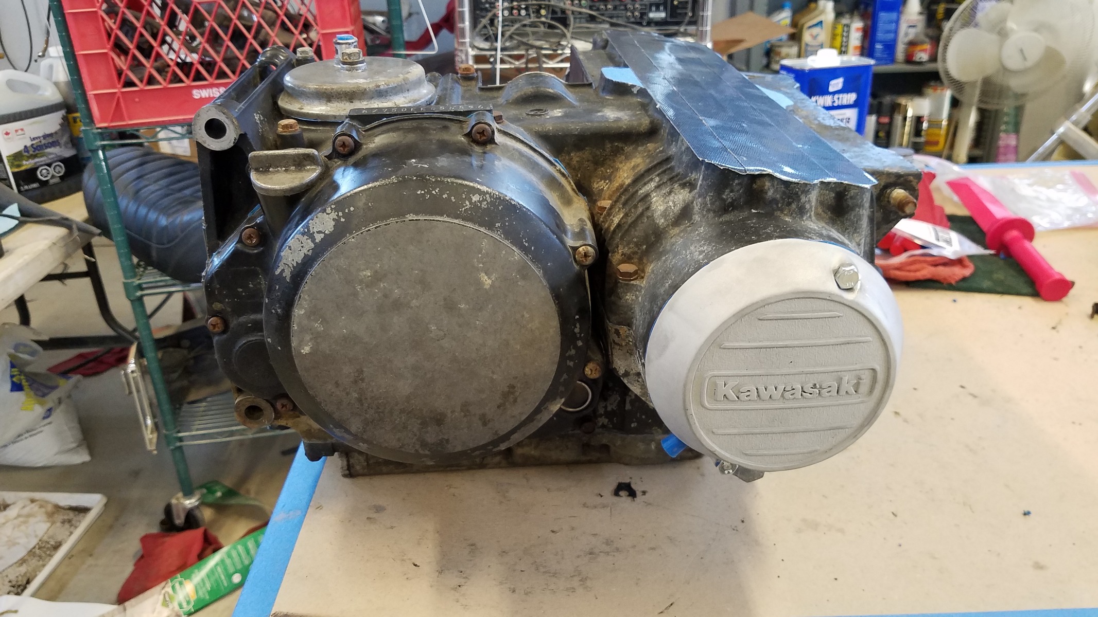

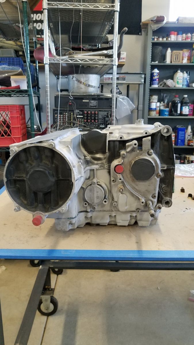

Hmmm. Okay, it has to go back in a third time. The glass bead fills up pockets blocking the view making it hard to get full coverage. The clutch cover will be shot on it's own - it is just a masking device for the case blasting. The starter area I wasn't worried about since it will not be seen.

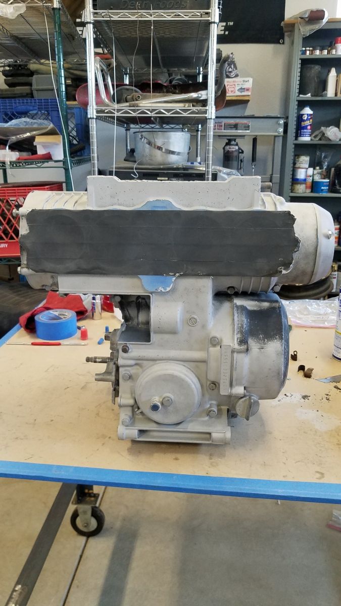

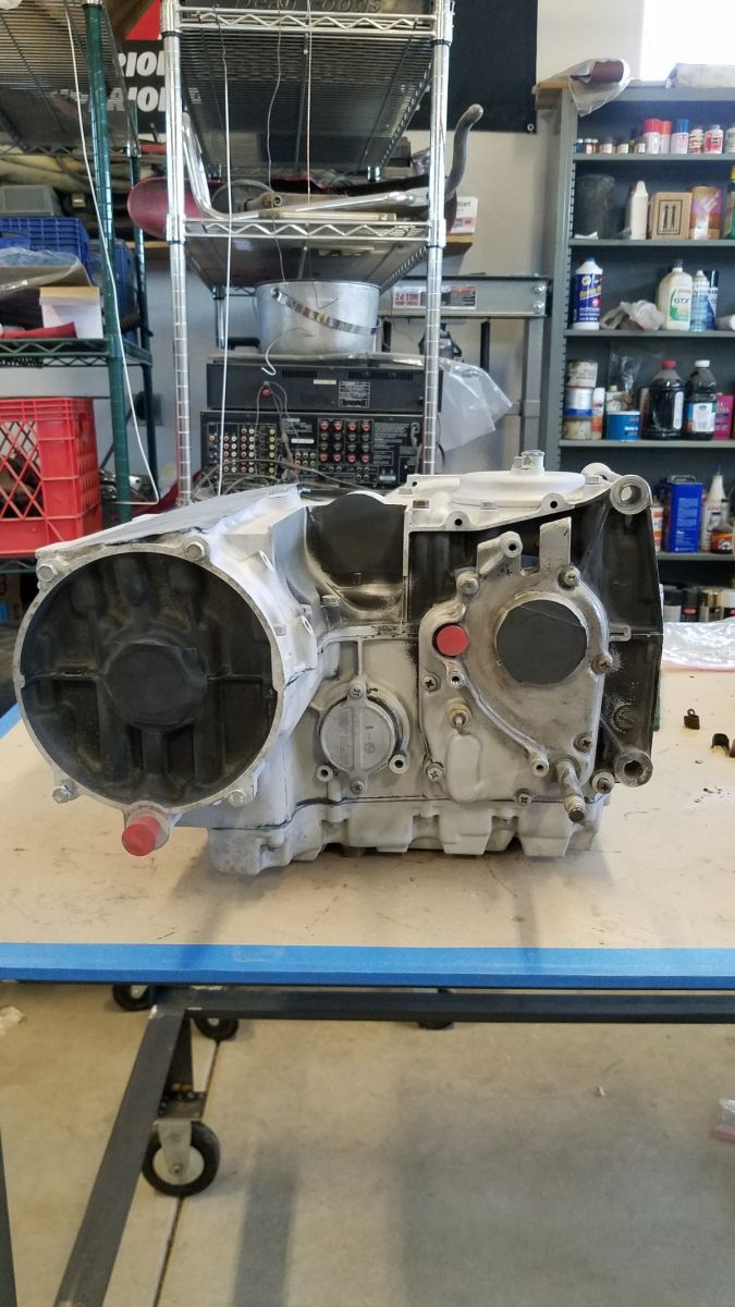

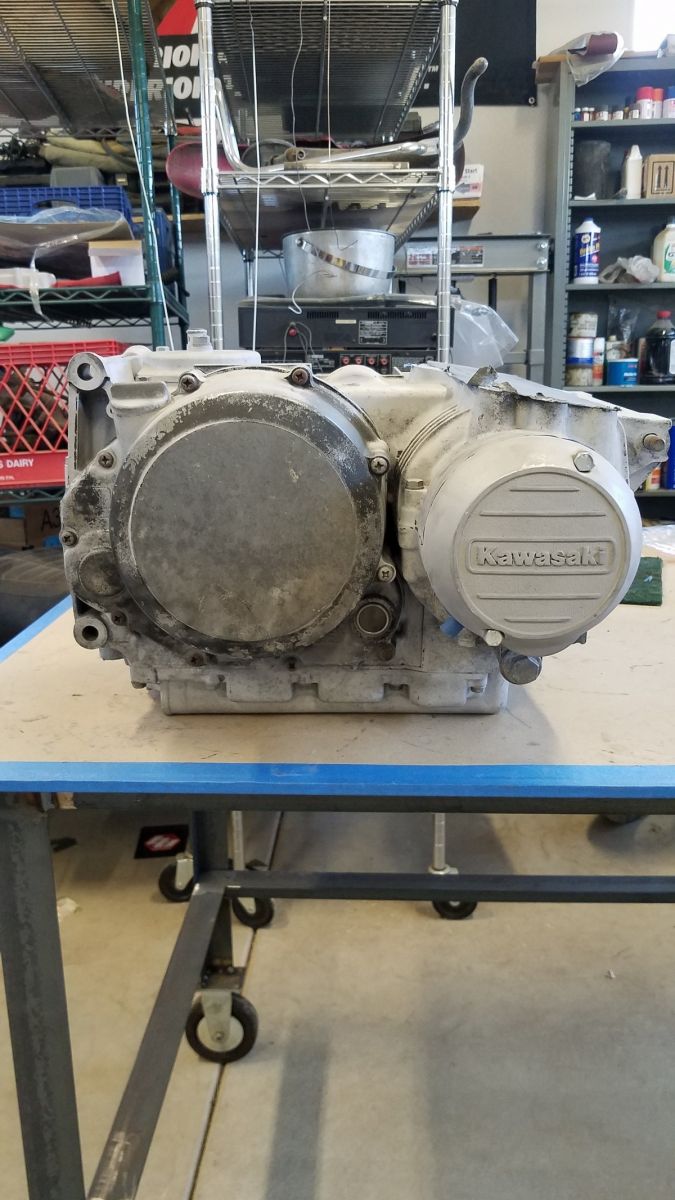

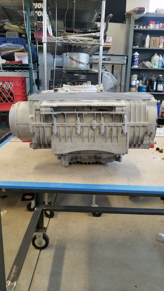

Knocking the ugly off it!!!

After I put the top end back on and clean the entire engine, I should be ready to get it on the engine mount and be ready for paint. High temps, low winds, and low humidity are in the forecast for the next 3 or 4 days. Conditions are good to get the black on. I'm ordering the high temp clear tonight. Some local touch up may be required so I have time before the clear is needed.
