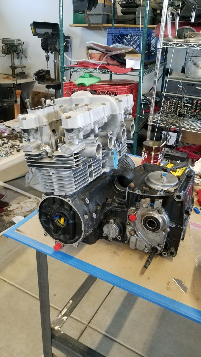

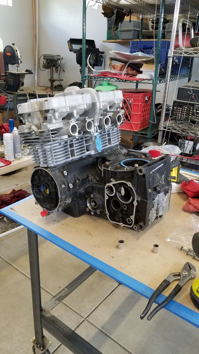

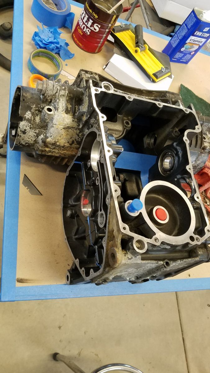

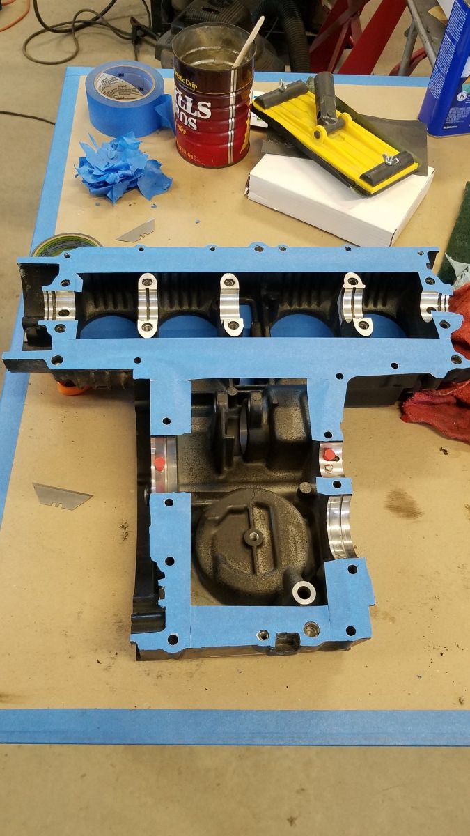

A bit more cleaning and I can start the masking on all the mating surfaces.
The block and head hve been at this point for quite a while, now.

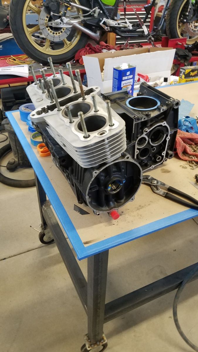

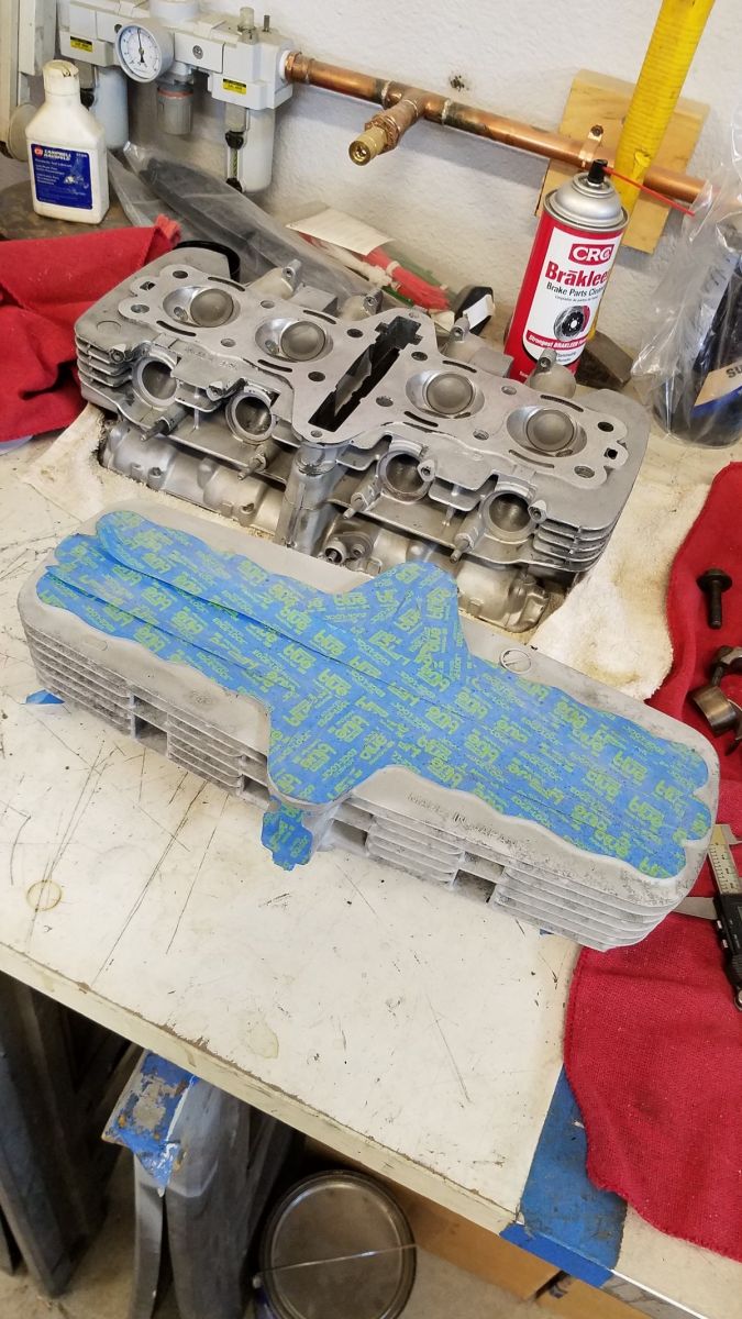

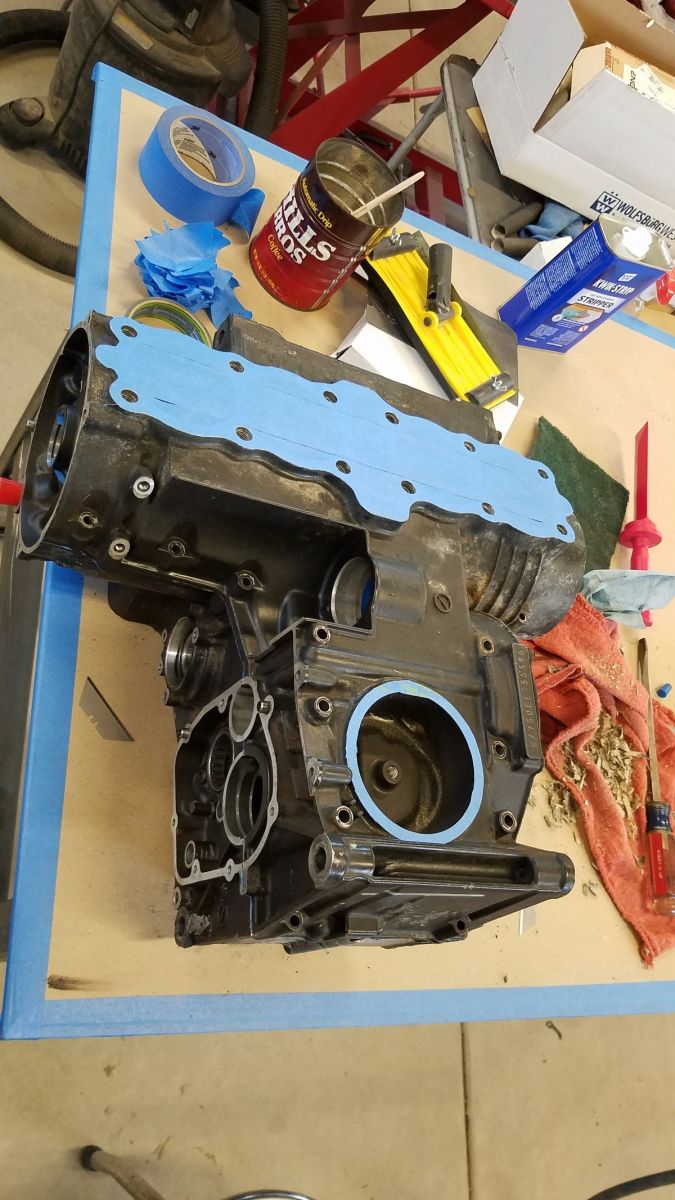

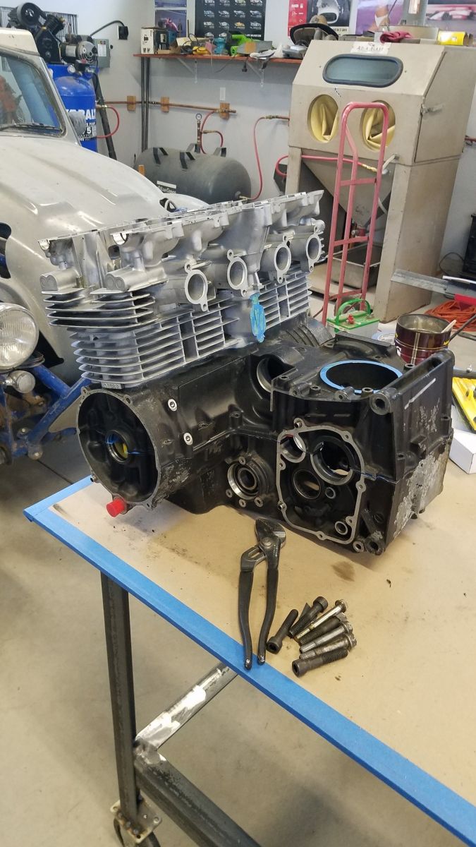

The top end is almost sealed. All of the side/case covers require cleaning before they get put on. Still need to cap off the valve cover vents, intake/exhaust ports.

I am using all of the old hardware and studs at this point. Final assembly will with APE studs and stainless case screws.

I am going to use PJ1 engine and case paint (rattle can). I have not found a heat resistant semigloss clear yet. They have the good stuff in the EU, but they are not allowed to ship it to the US. Since I plan on exposing the aluminum (fins, text, cam cover ends) I wanted to put a couple coats of clear on it.

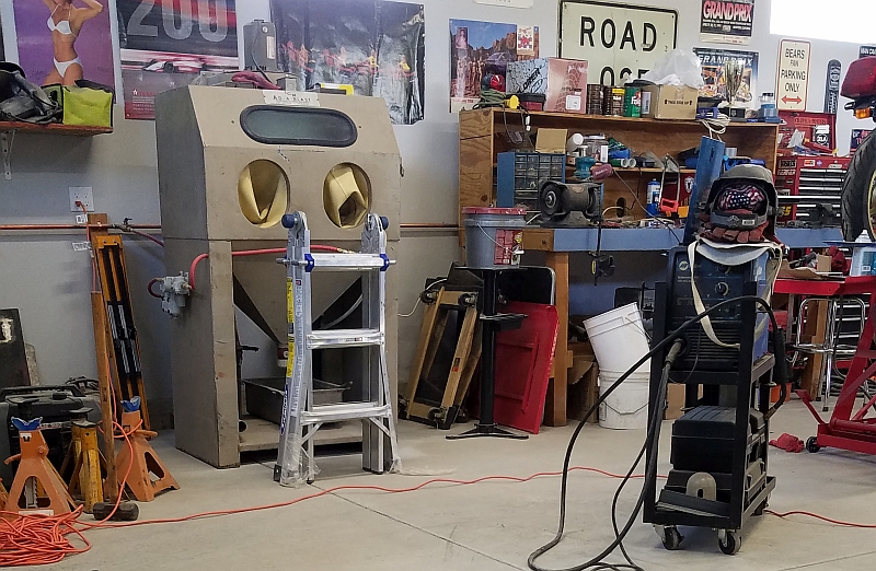

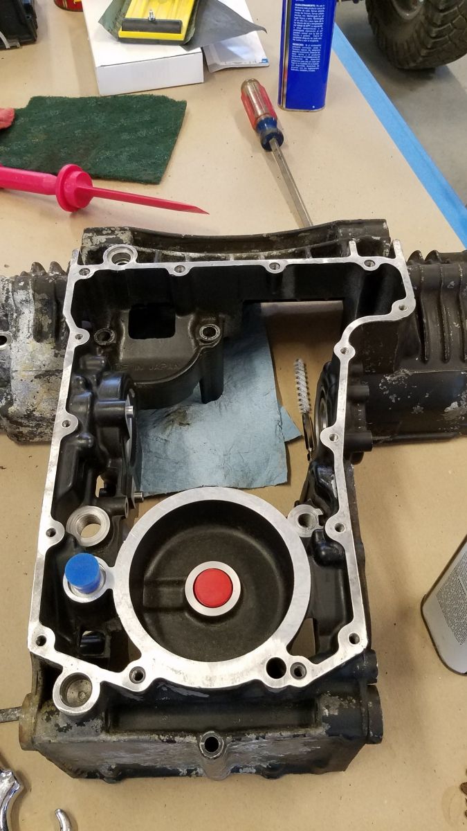

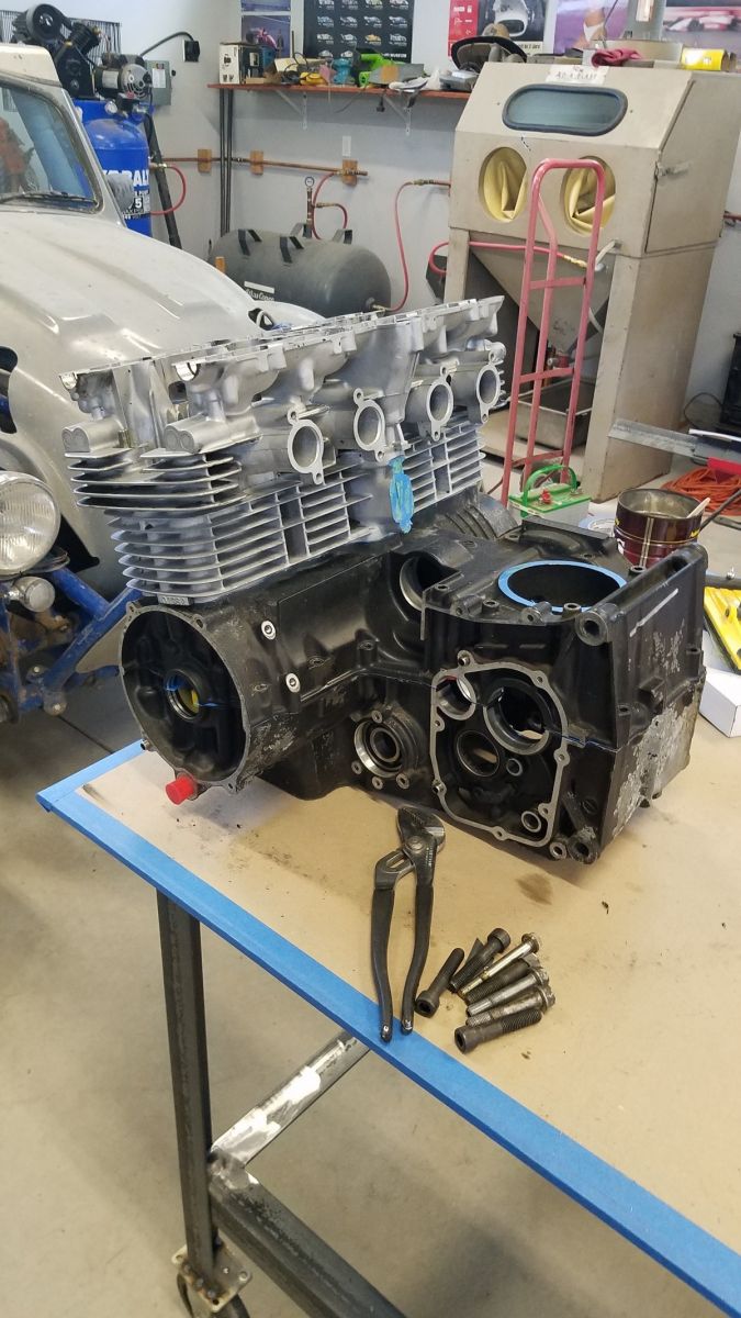

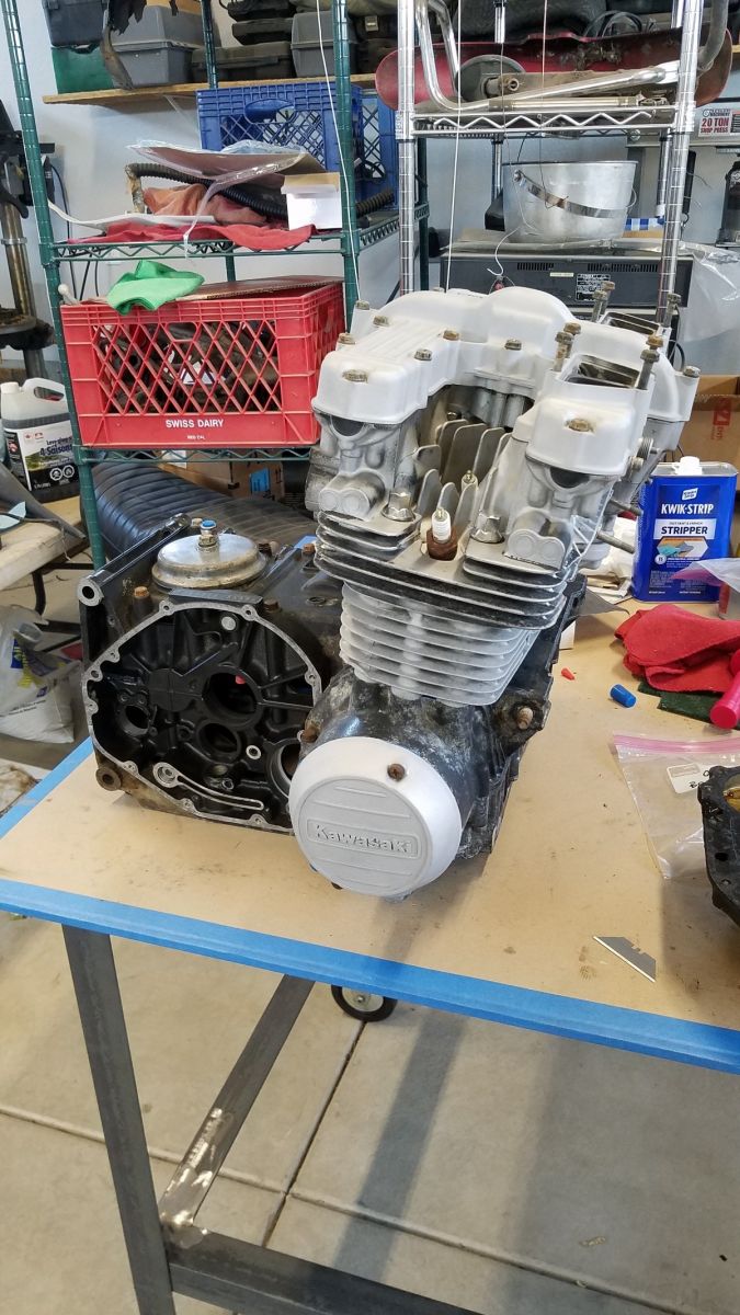

Cleaning all the gasket surfaces is getting very time consuming. The final assembly will go quicker than this, I bet! Slowly getting closer to trying to lift this thing into my blast cabinet. I hope I have enough room to move the gun around with it in there...

Re: Saving a '81 KZ750-E
11 Aug 2020 18:17
Go buy an old lazy Susan from Salvation Army so you can spin it in your cabinet
- Skidmark
- Posts: 1087
- Thanks: 312
11 Aug 2020 18:35 - 11 Aug 2020 18:37
You can see the blast cabinet against the wall. I think it will be too tight a fit to spin around in there! Good idea, though. I will need to put it in and take it out for repositioning several times. It's not the biggest cabinet, for sure.
