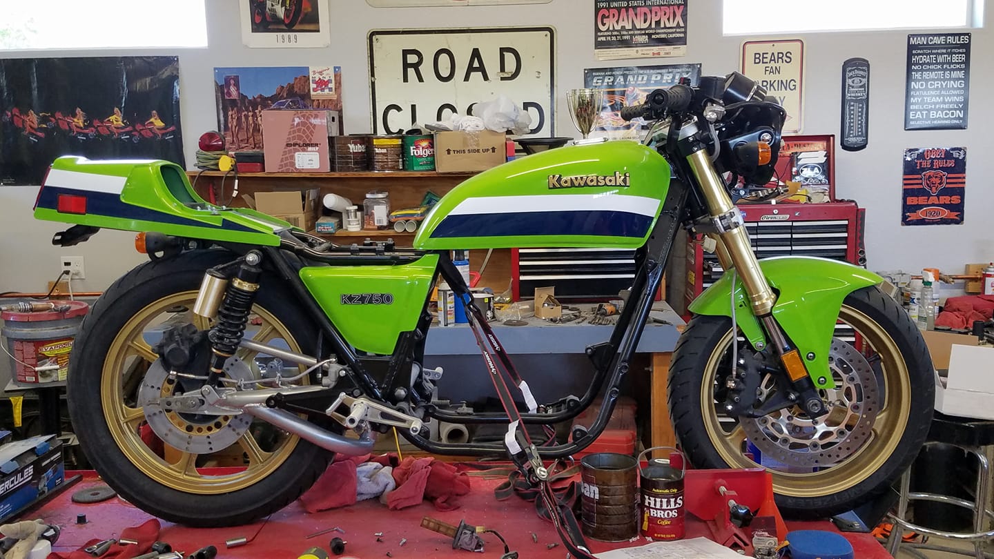

Re: Saving a '81 KZ750-E
23 Jun 2020 18:55
Those look really good. I will put mine on the steering head when I remove the forks for the reseal. And since it's been a couple pages since this thread was green...
