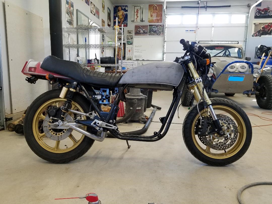

Hope it all works out on Saturday! It's been a bit of an ordeal with that tank - you, sir, have shown some serious perseverance!
The chassis looks good with that front end. Looks like a nice riding position and quick on those corners... looking forward to the first ride report.

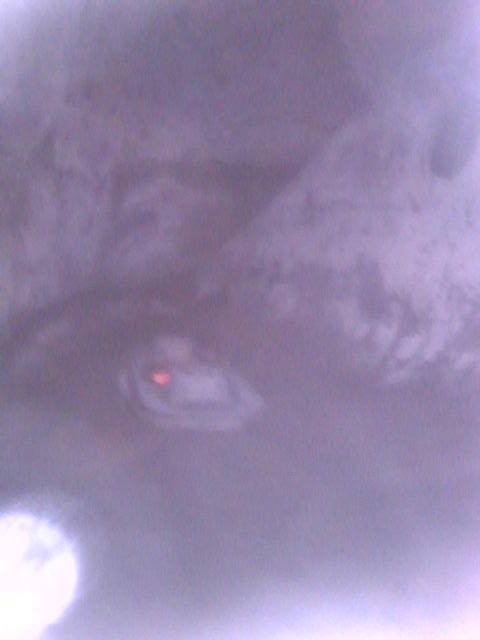

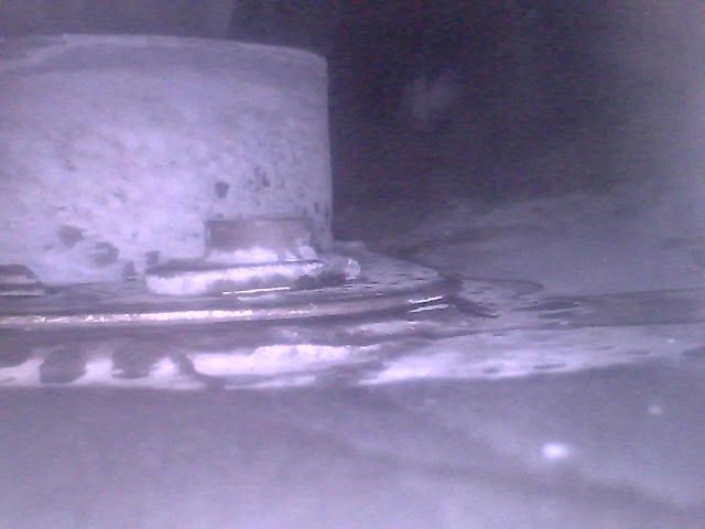

I ordered the POR15 Tank Sealer, and it had shipped by the time Caswell was recommended by DoctoRot. I certainly don't want to do it twice, but on the other hand I don't want to wait for a different brand to ship, and spend twice as much. So I figured I would run with what I bought. Everything is taking longer to ship with the pandemic affecting warehouse labor. More bore scope inspections are in order after the next treatment. I am hoping to minimize the flash rust by rinsing a second time with alcohol after the water, and before drying with compressed air. Once dry and fume free I will run the heat gun through it as insurance no moisture of any kind remains. I think the performance of these sealers relies heavily on the prep work. If I can get the inside flash rust free, I think the POR15 will work as designed.

It looks like rinsing with alcohol solved the flash rust problem! Finally a rust and leak free tank!! I will run a heat gun in it for a while to make sure it's dry, along with letting it sit overnight, before I use the sealer.

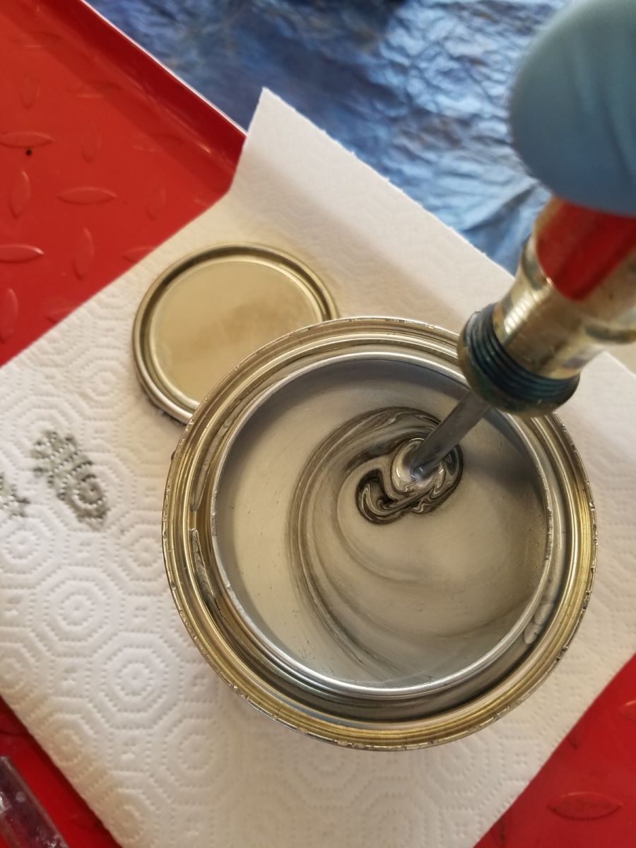

First time using a tank sealer product. Time to get this sealer party started! Process seems pretty straight forward. Just going to take my time and hope I get full coverage...

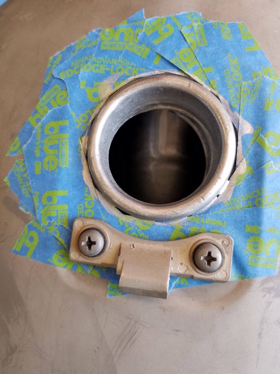

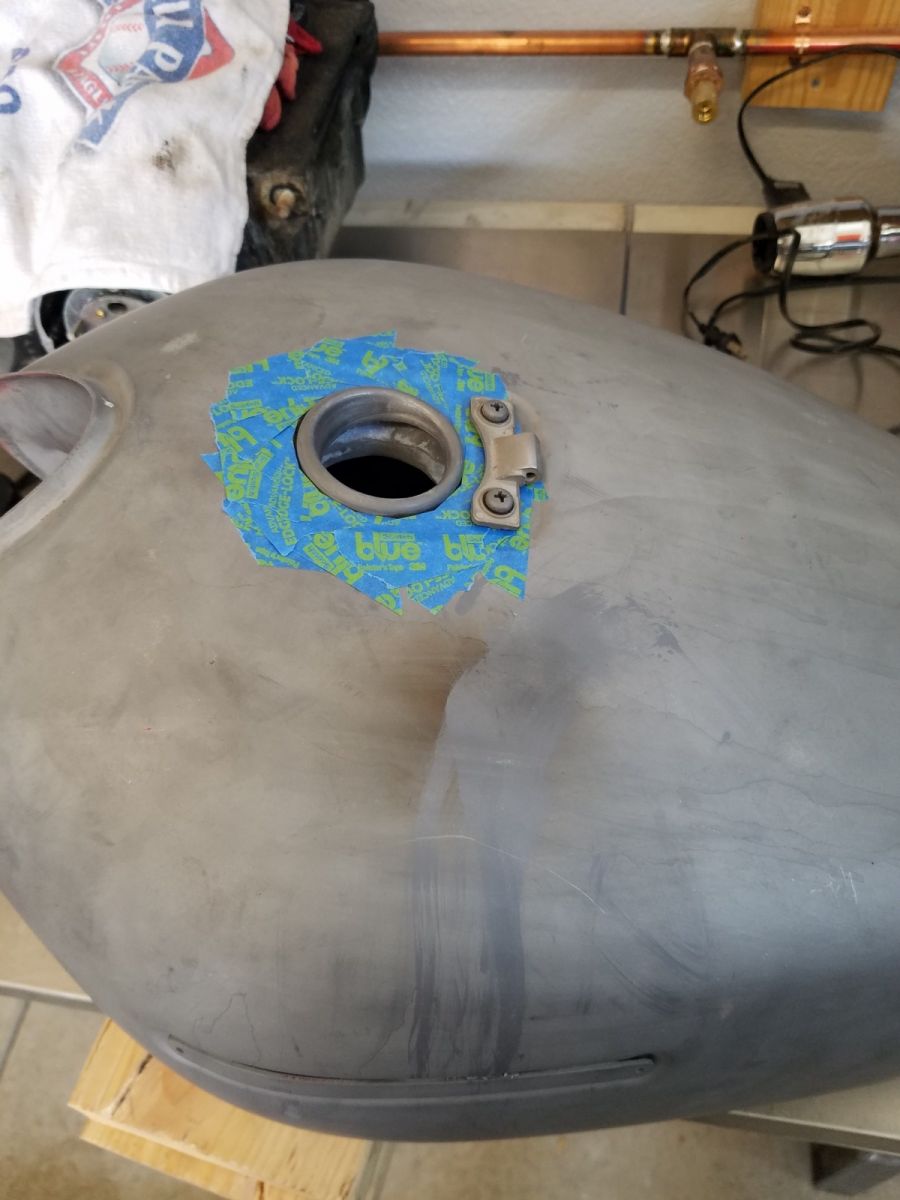

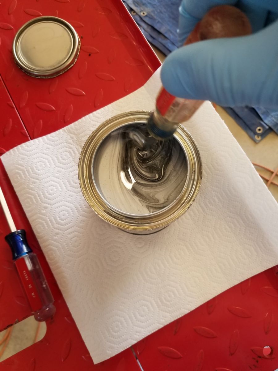

After rolling the tank for 30 minutes, I drained it, and rolled it around another 30 minutes. Pulled all the cover plates and filler plug, then coated the top of the filler with a brush. Instructions call for a 96 hour cure before putting fuel in it. Yeah, I still have to get it painted, and do the motor as well. So that won't be a problem.
What it looks like before stirring.
After 15 minutes of constant stirring. I guess it never achieves a solid color.
Filler neck coated.
Filler neck coated.

06 May 2020 16:57
Nice job! You should be good to go now! I think that a lot of tank coating failures are self inflected injuries. Getting rid of all the old rust like you did and making sure the metal is clean is the key to success.
