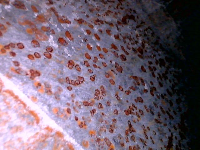

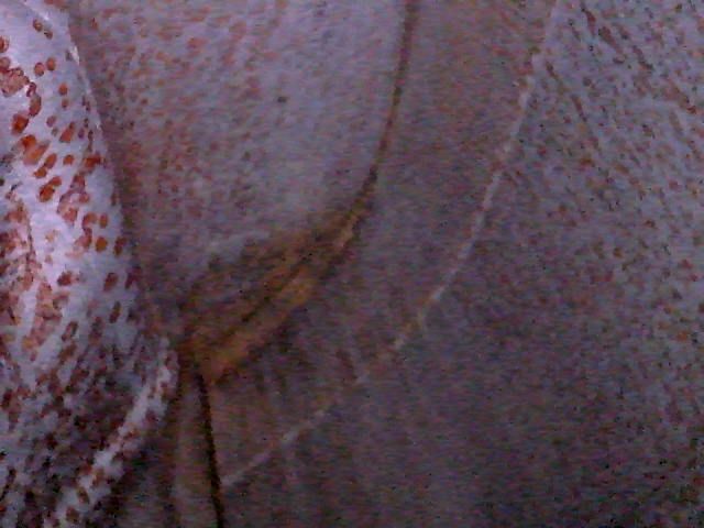

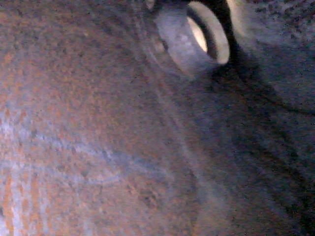

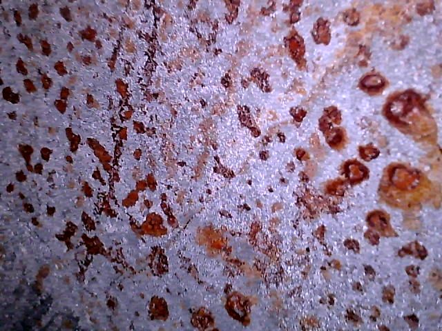

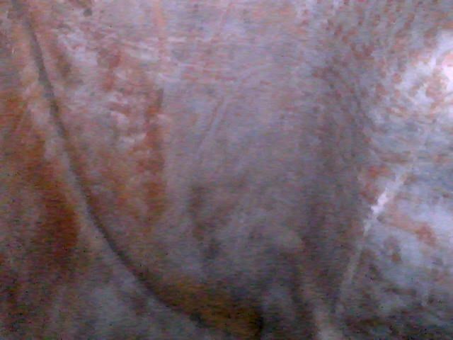

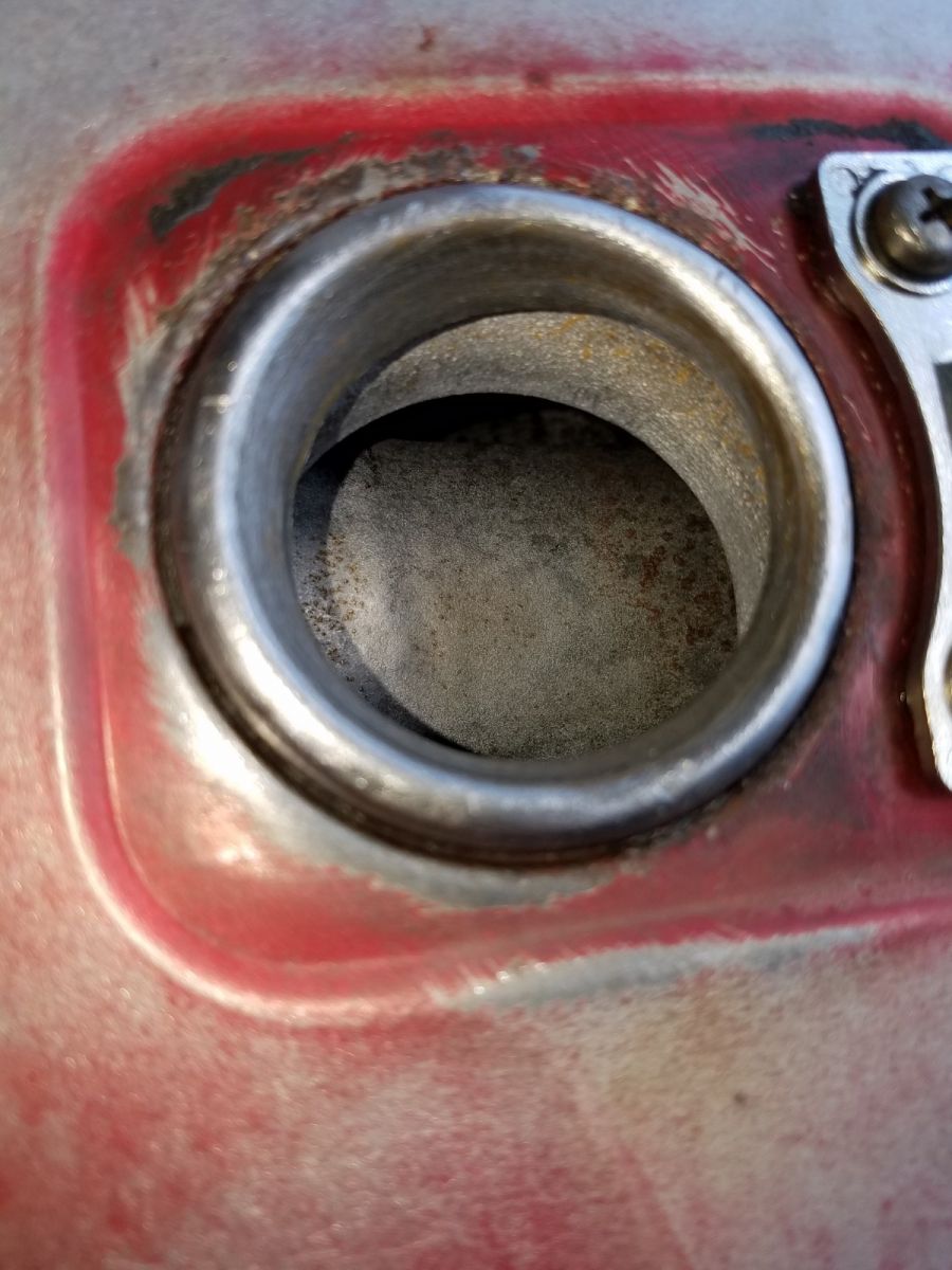

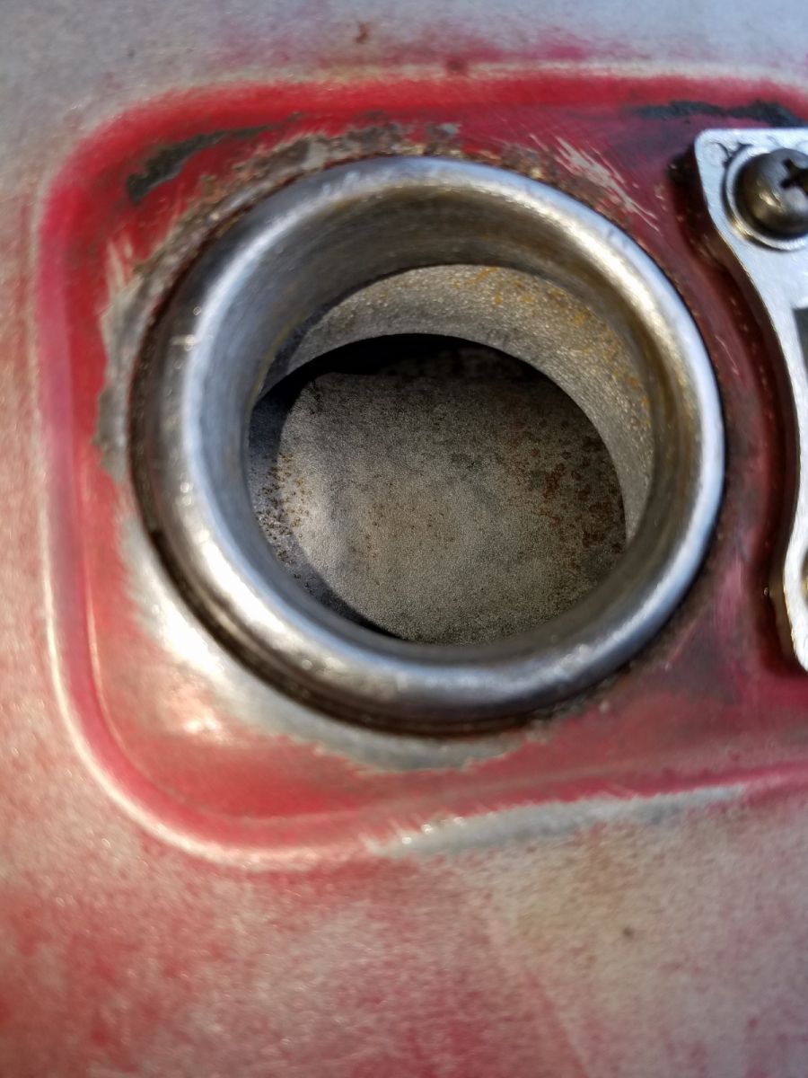

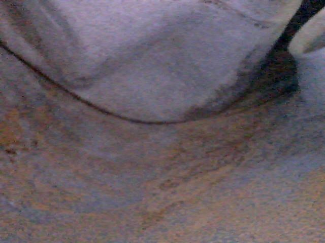

Just getting a first look down the filler. As I thought, you can catch a bit of orange on the center rib. As soon as it's dry I will get some deeper bore scope shots. Definitely better.

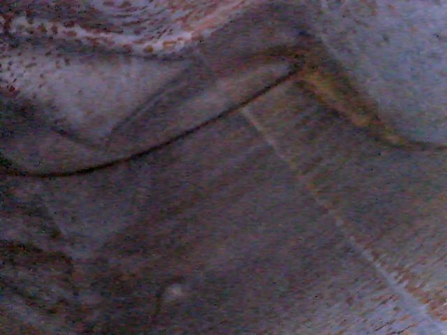

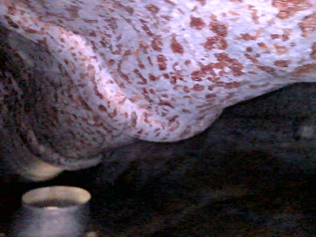

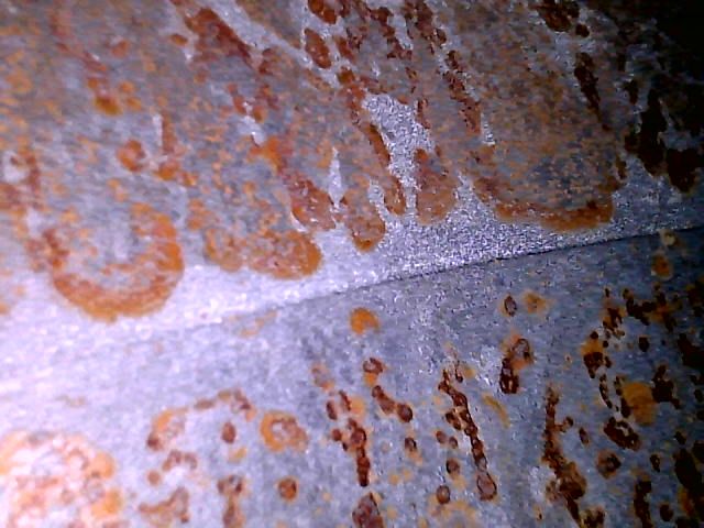

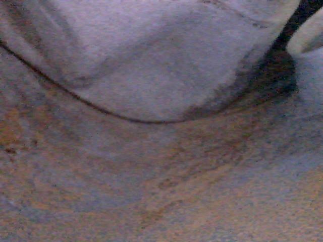

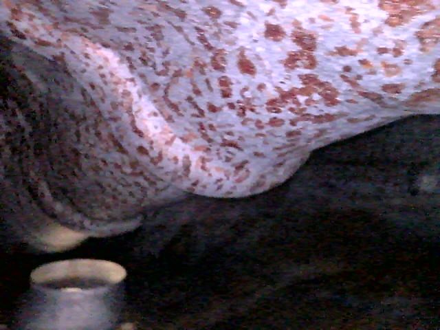

After getting the tank dry I got out the bore scope. Not what I wanted to see, but the seams look better than expected. There is that one corner, though, that gives me pause. (Last pic)

As someone that's gone down the tank cleaning rabbit hole several times I want to applaud your effort. Your tank was in an amazingly sorry state and you have come far to get to where you are now.
One possible issue as I see it: there seems to be rust/crud spots down into pits in the metal and if there is any varnish covering over the pits that reduces the ability of the derust sauce from reaching the oxide. You might want to shoot a can of spray carb cleaner into the tank so see if it loosens any of that brown stuff up. If it does you then will have to attack the varnish one more time before going back to the phosphate.
The phosphate will start to leave behind a white chalky coating in the tank as the dwell time increases. I can already see that in places in your photos. It's not a problem per say but obviously, you don't want too much of that. I've used aquarium rocks before in the tank and shook the hell out of it to help scrub some of that off before.
Lastly, your tank is definitely borderline in terms of a candidate for cleaning alone vs. cleaning and coating. The POR-15 coating paint is good stuff and I wouldn't be afraid of using it, particularly since your tank was so rusty and the metal is likely weakened in places. I've got some tricks when it comes to coating so PM me if you decide to go down that road and I'll share.
