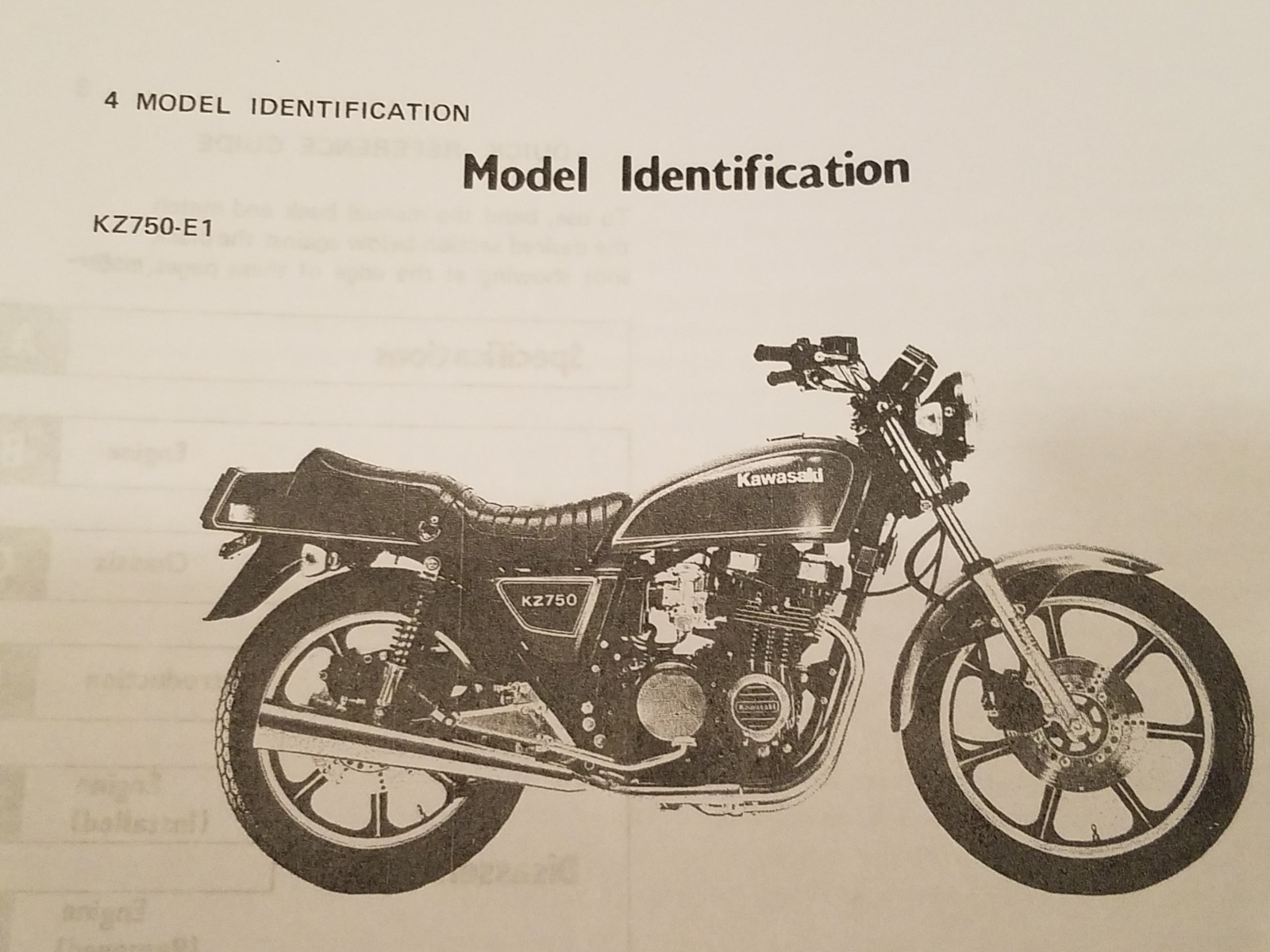

Was that engine painted when it was new? I ask because my 1977 KZ650-C1 was not and it has been very easy to keep it looking fresh. I've seen many painted engines (including the cylinders on my old BSA) that very quickly looked pretty bad as the paint failed. Ed

14 Apr 2020 16:24650ed wrote: Was that engine painted when it was new? I ask because my 1977 KZ650-C1 was not and it has been very easy to keep it looking fresh. I've seen many painted engines (including the cylinders on my old BSA) that very quickly looked pretty bad as the paint failed. Ed
Yes, the cases where painted black at the factory. Clutch cover and sprocket cover were clear coat. Other two covers were half paint, half clear coat. I have not decided on what parts will get which finishes yet. Still looking for a high temp clear in the US, but haven't looked real hard yet. EU has paint that cannot be shipped to the US. One thing I do know is that I don't want to be doing much polishing on the engine. I may black out the entire engine, except for the fin edges on the head. Still undecided...
