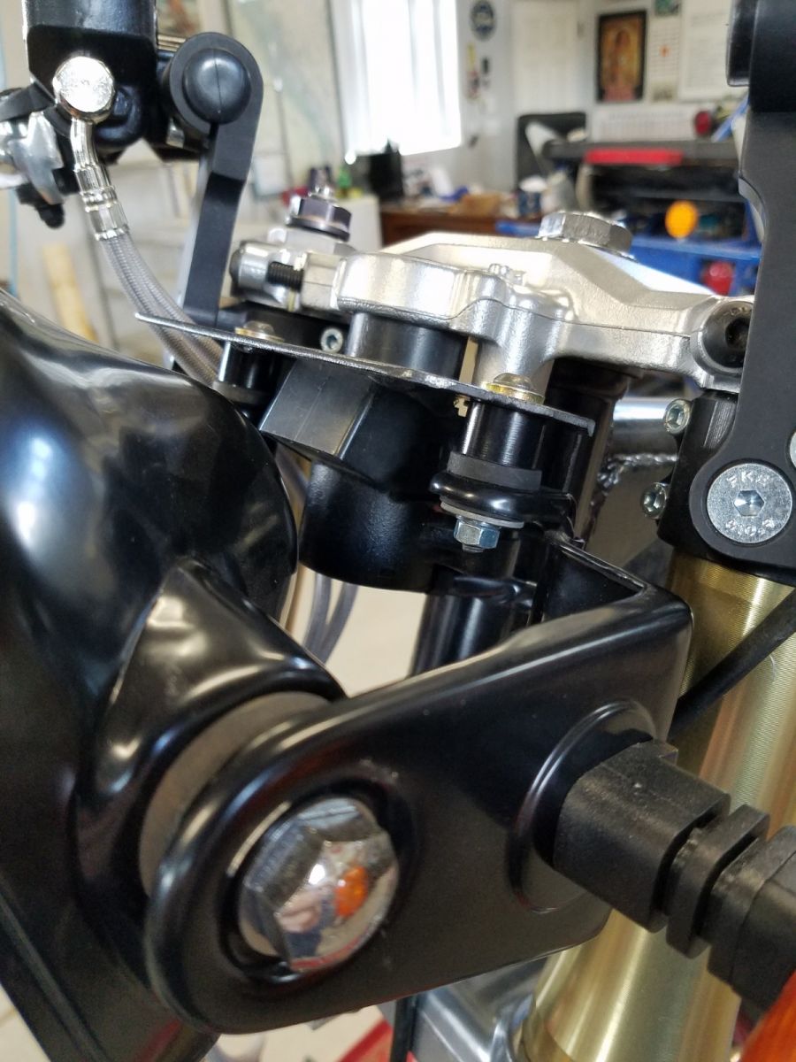

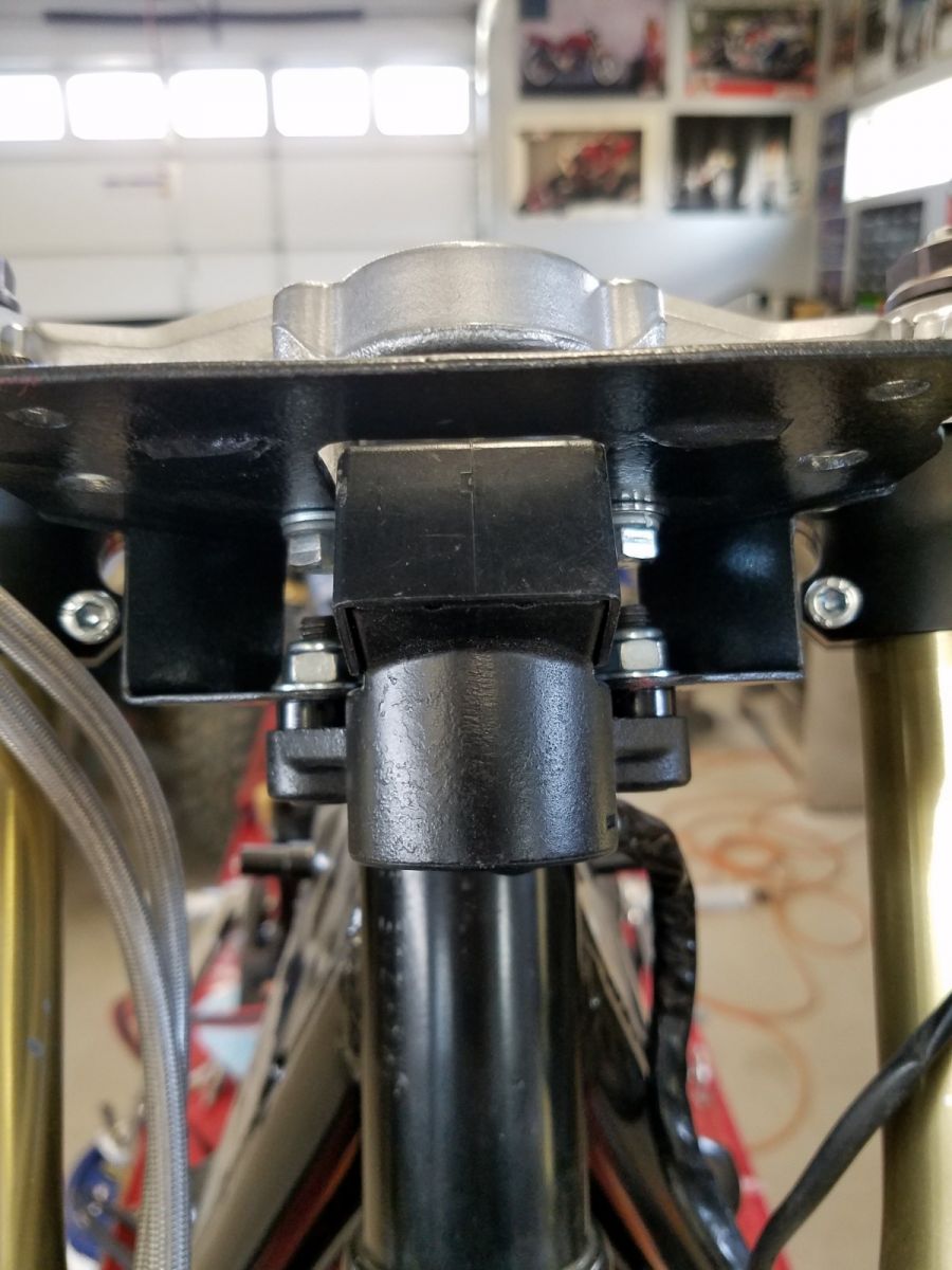

I finally got some custom spacers made and painted. One set positions the ignition switch.
The other set positions the headlight bracket.

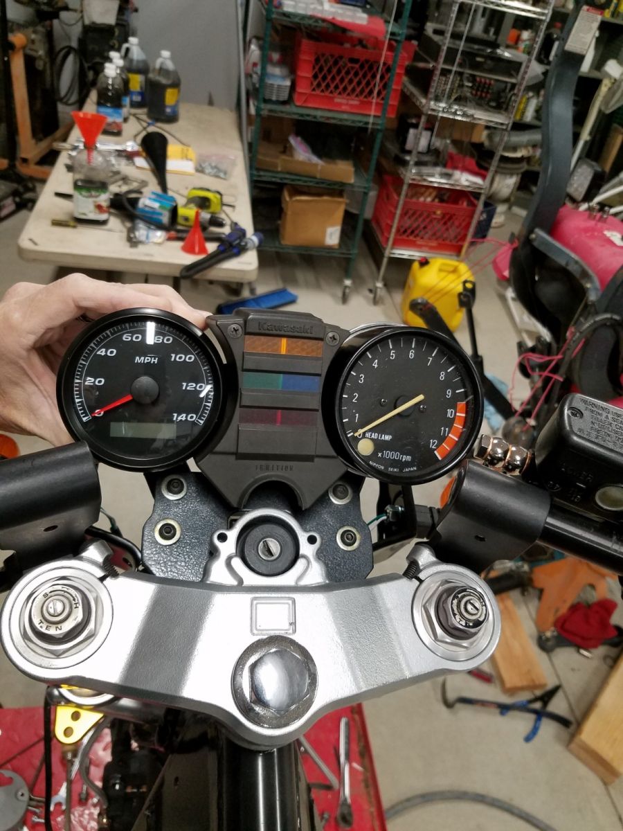

I wanted to see how the new speedo looks from the rider's viewpoint. Still need to design a mounting system for it, but it looks pretty good.

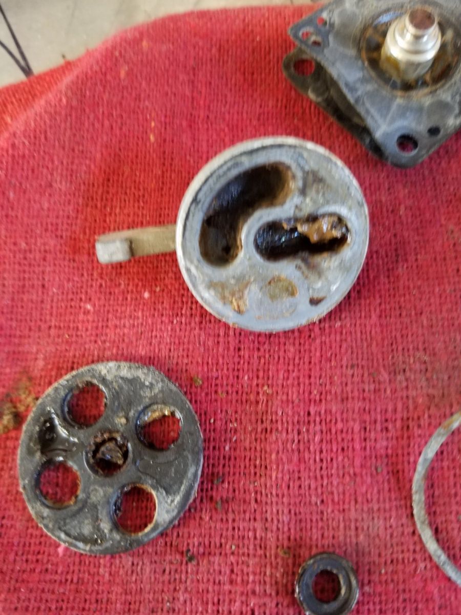

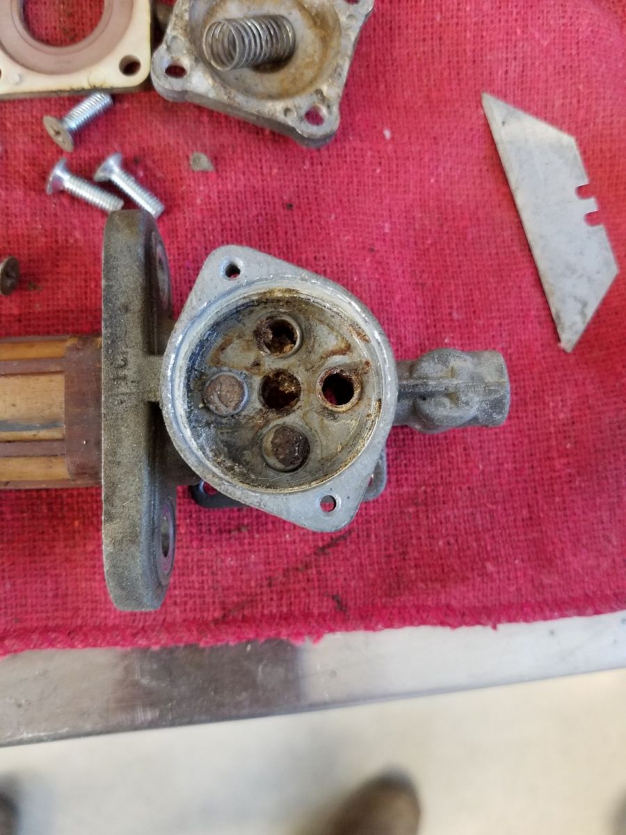

Still dealing with nasty fuel system parts. How does the screen frame come off? Is it just a mild press into the petcock body? I was thinking it should be removed before soaking in carb dip, but I don't want to break it. The rebuild kit from Z1 Enterprises looks like the small o-ring isn't included.

29 Mar 2020 16:46
Looks like you've got some work to do
The rebuild kit that I got came with the small o-ring already installed: www.bts-motorradteile.de/images/product_...es/bild2_7243827.jpg
The large o-ring didn't fit well and the tap was really hard to turn. This seems to be a common problem with the rebuild kits so I ordered a couple of OEM ones. Haven't tested them out yet but it's quite high on the list (as long as it stays too cold to paint). I'll let you know.

The large o-ring didn't appear to be the right size in the picture, so I already suspected that. I'm wondering if the screen and screen frame will withstand the carb dip. It will take a good 24 hours to eat all that gunk away. I am sure the frame is brittle, and certainly don't want to break it.

Yeah, I'd want to get the screen off first as well. Unfortunately (or fortunately for me
) I can't help you - the tank and petcock on my 750 were in really good nick.
