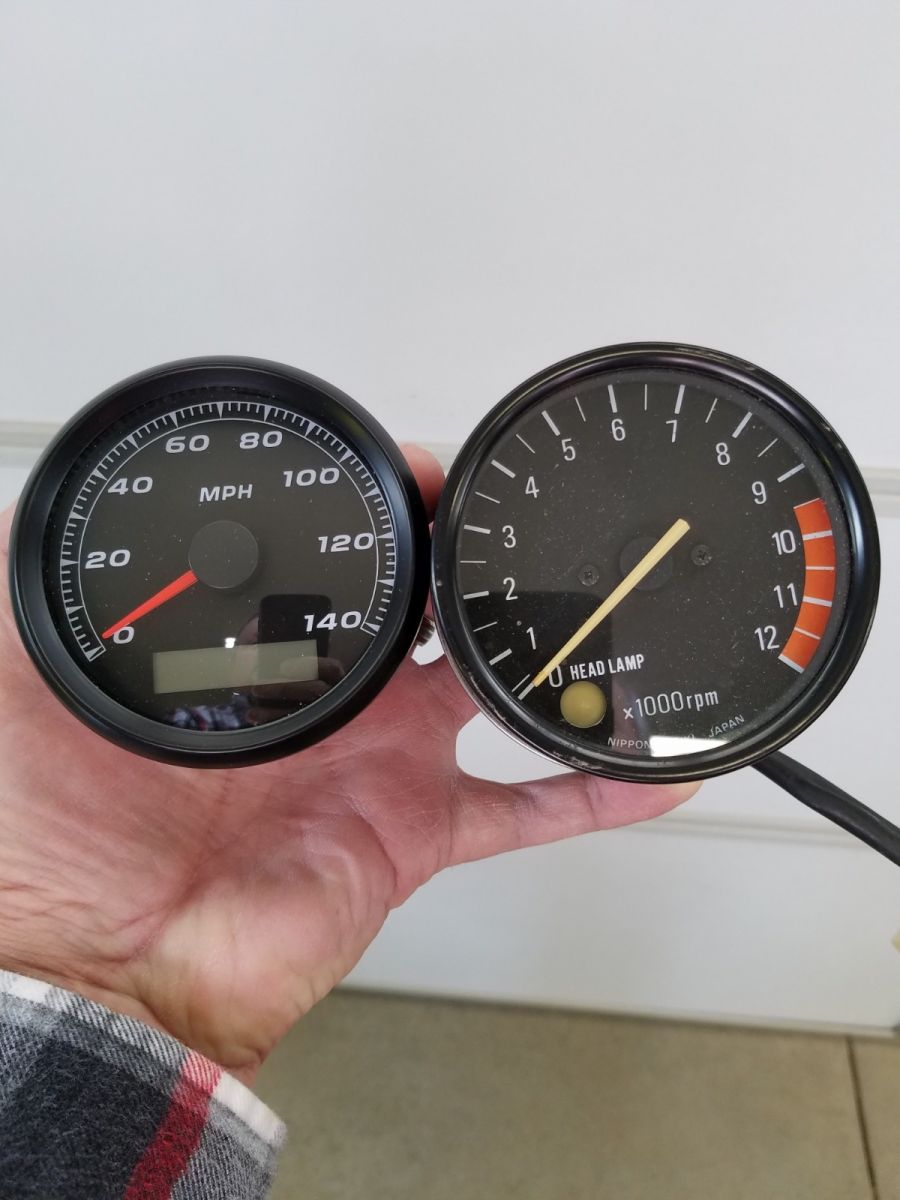

I've been gone for a little while. Trip to Canada, working on a neighbor's tractor, and life in general pulling me away from the bike project. Finally have some free time, and look what shows up.
Now I need to design a clean mounting method. This is a GPS driven speedo that is meant to be mounted in a hole in a dash panel. Since I won't be running a nose fairing it will need to look clean when installed.

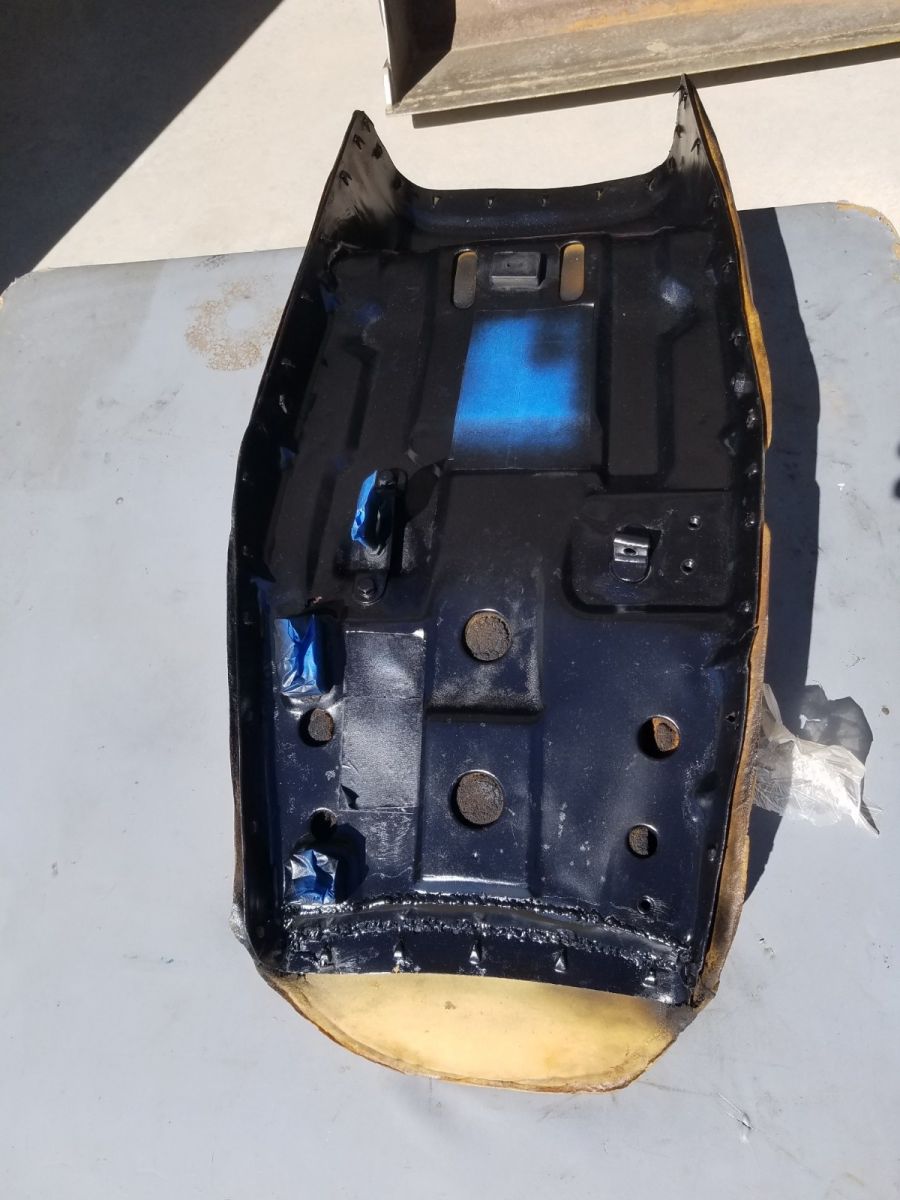

I ended up having to add a strip of steel sheet to the front of the seat pan to repair rusted through metal. I wish I learned how to TIG weld! Using a MIG welder for thin sheet is difficult at best, so don't critique too harshly. Some painting and clean up and it will ready for the upholstery.

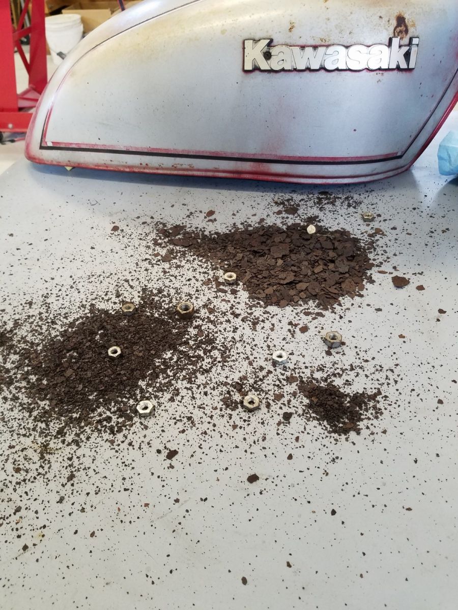

After draining the 28 yo gasoline and letting the tank dry inside, I threw in a handfull of nuts and got to shaking. Wow. I didn't expect this much to come out...

- calum
- Posts: 1144
- Thanks: 415
Re: Saving a '81 KZ750-E
14 Mar 2020 13:21
Back end looks good!
But man, that tank was really in need of some TLC. Hope there's no holes...

I have been using this stuff with amazing results. The plan is to fill the tank with it (mostly) and let it soak for several days inverted.

I love the fact that the shape of the tank works great with a 5 gal bucket! My sophisticated leak containment system. The old petcock o-ring is seeping a little. The gas cap leaks a lot, so I will pick up an expanding rubber plug for when it gets flipped over for the other half. I put about 3 gallons in it, so it will be above the soak line. This tank is about 4.5 gal capacity.
