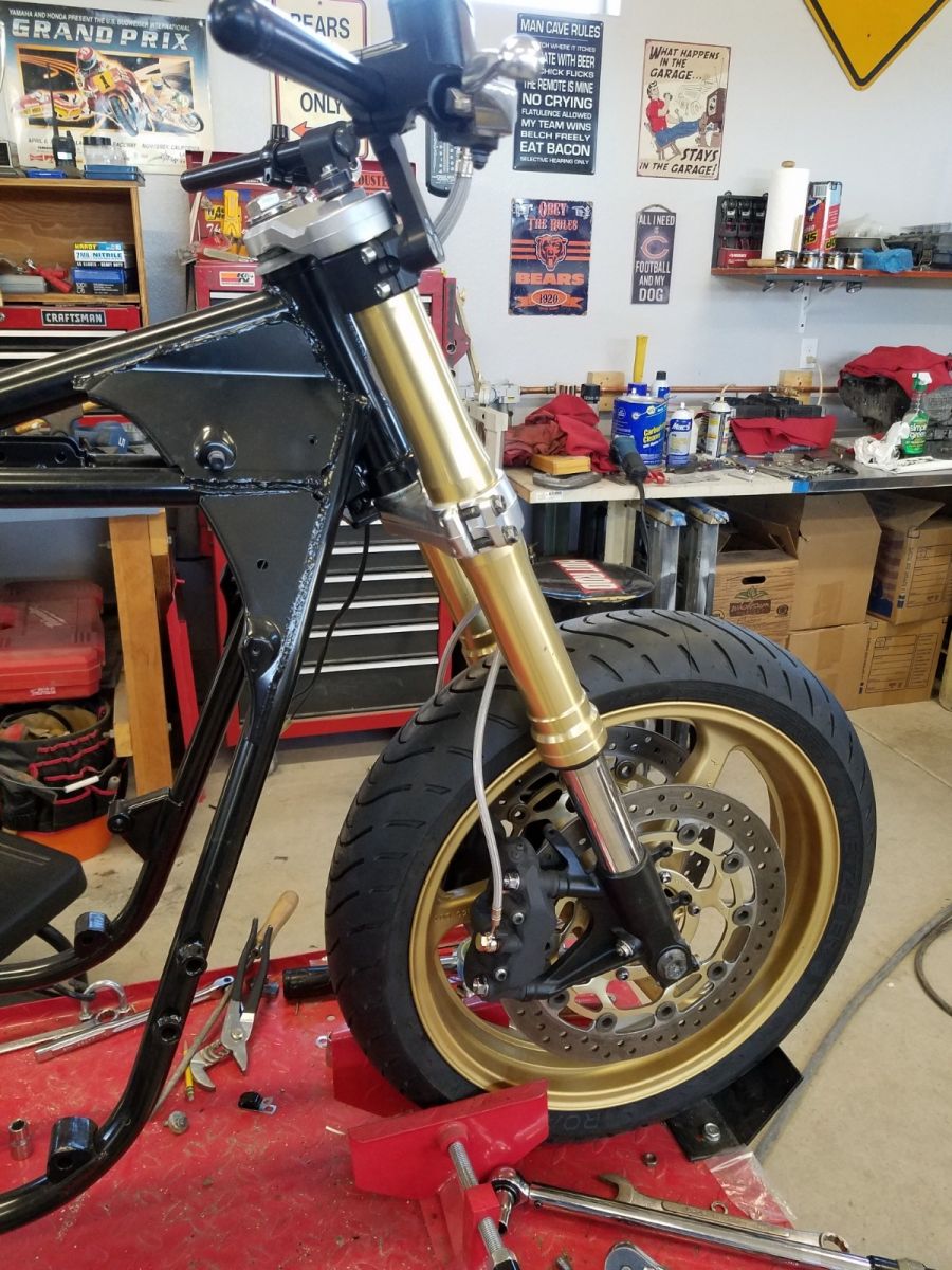

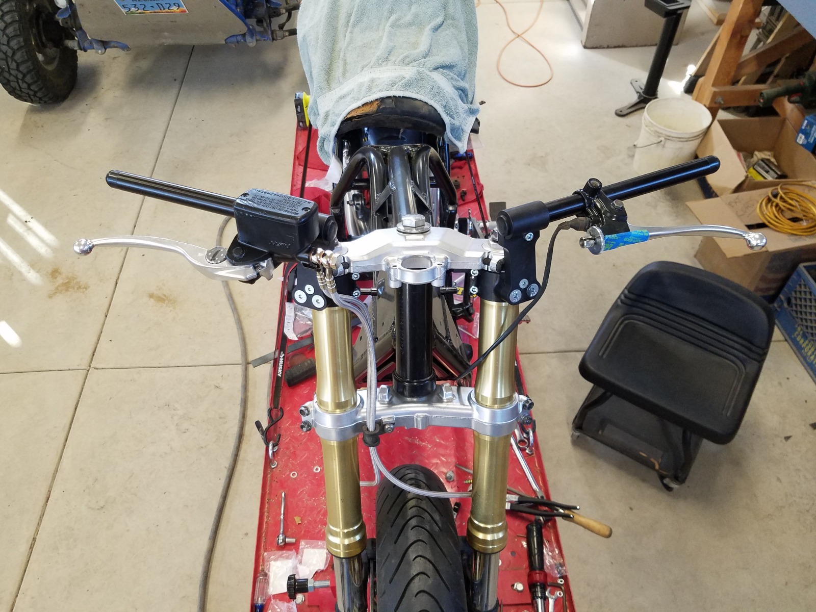

I got my new Galfer braided lines today. Front brakes are done, just need to bleed. Since I had to have custom lines made, I went two single lines instead of the staock Honda "Y" line.

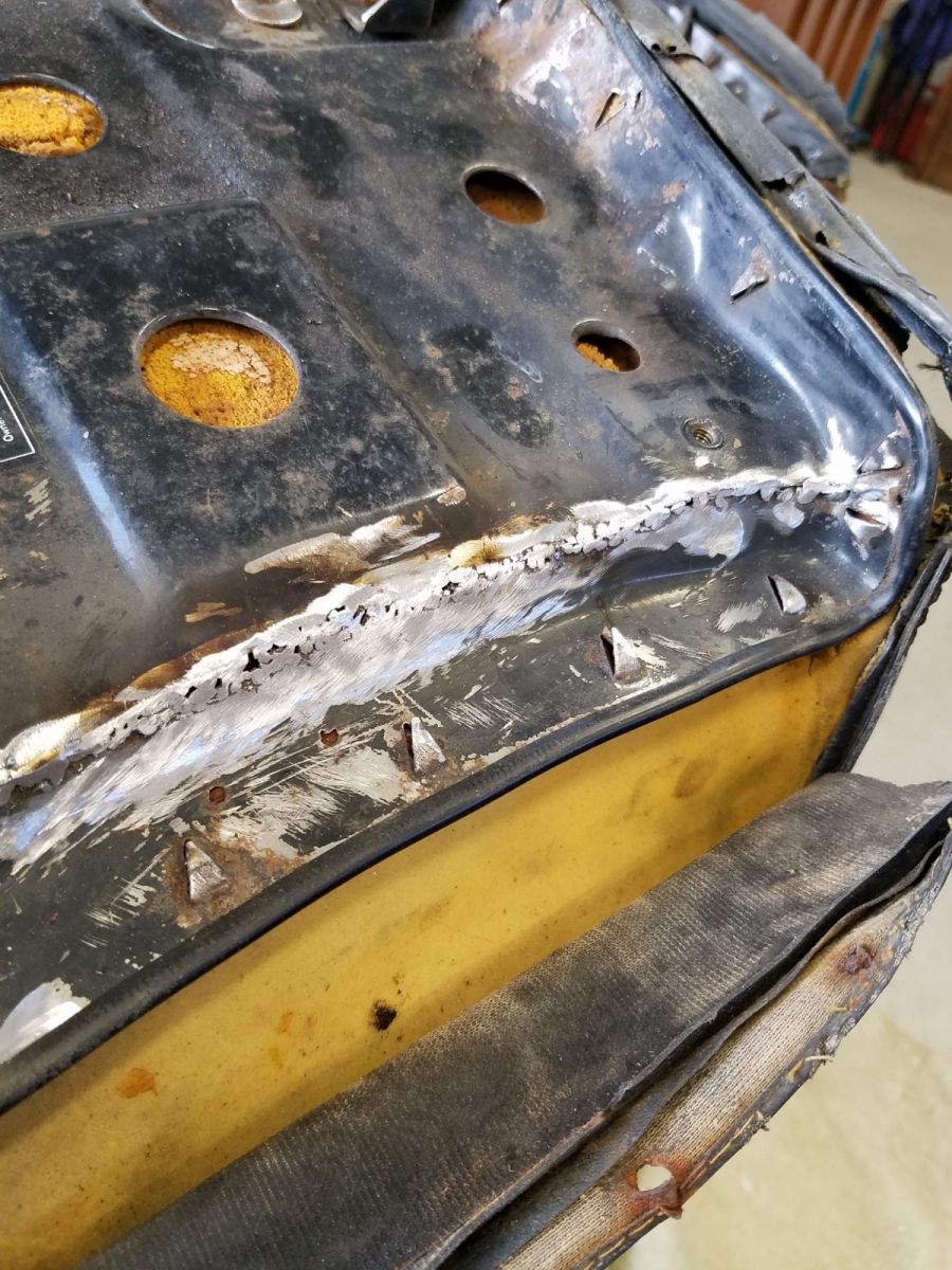

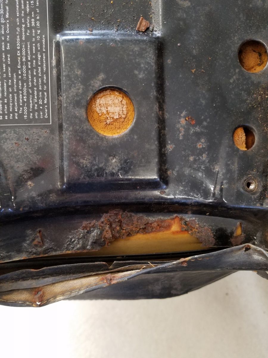

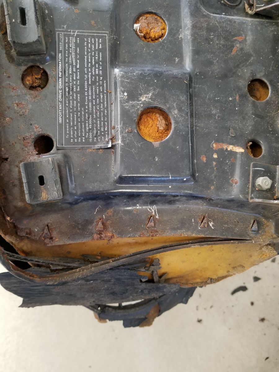

The used seat arrived yesterday. So much for "no rust thru or holes" in the pan... Ebay people really suck sometimes.
This bit was conveniently not in any pictures, and was covered by the seat cover. Several barbs missing. Luckily my old seat was in better shape there. Welding really thin, old, rusty sheet metal is not easy - even more so when trying not to burn the foam.

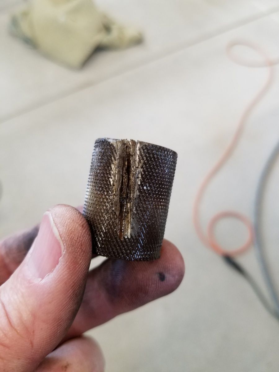

Another small success! I was able to remove the brake shaft without damaging the OD of the shaft. I had to break the bushing out of the aluminum bracket, then cut through the bushing with a grinder and cut off wheel. I had to make sure not to cut all the way through, then use a chisel in the cut groove to finally crack the bushing. Using penetrating oil in the crack, I got the bushing to turn, eventually working it all the way off. After soaking it for a few days in the rust treatment, I will polish the shaft. Now I can replace the stock rear footpeg bracket with a used one that doesn't have the brake shaft. Yay!
