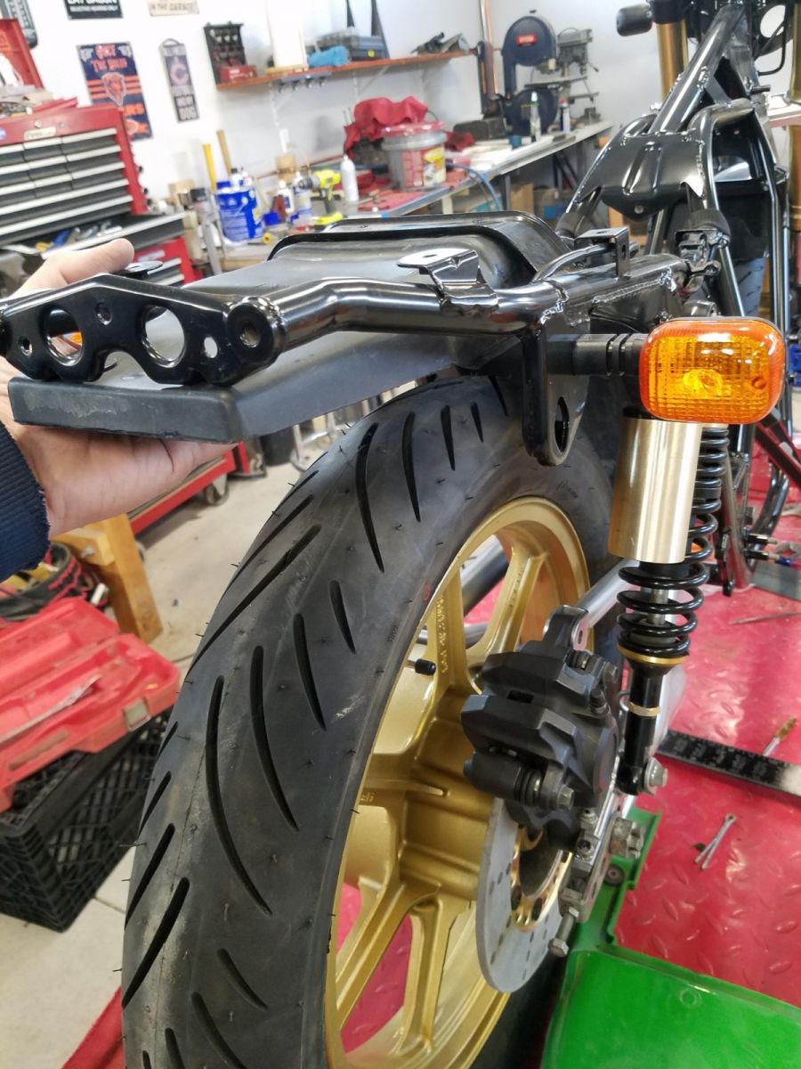

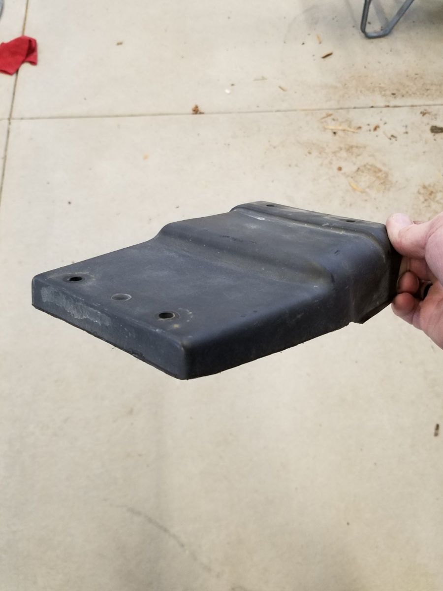

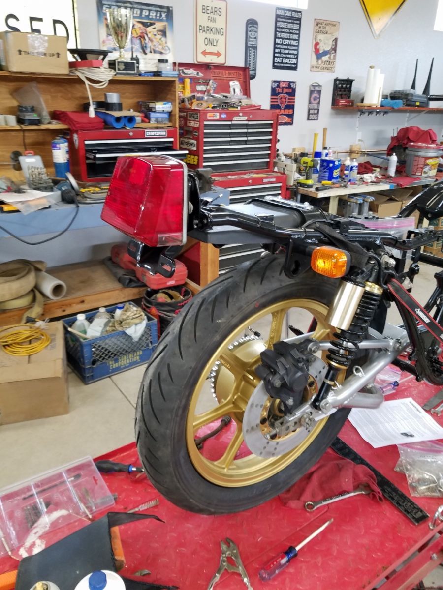

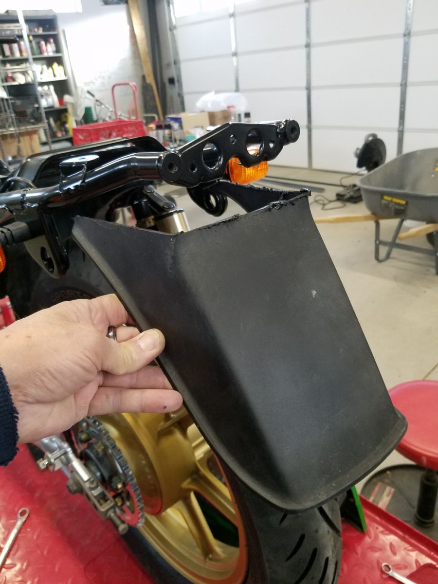

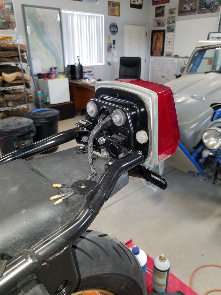

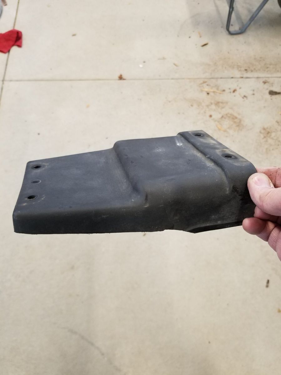

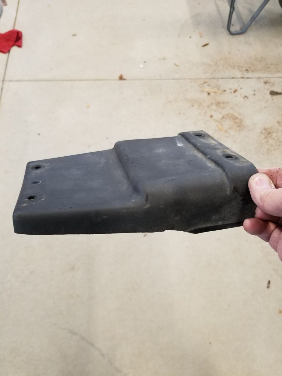

Working on the tail end today. Took apart the tail light and blasted all the rusty parts. I decided to clean and fit the rear fender back up. It didn't take long to decide the rear fender needed a serious trim job!
I took a large chunk off.
The only thing hanging below the tail section will be the license plate and bracket.

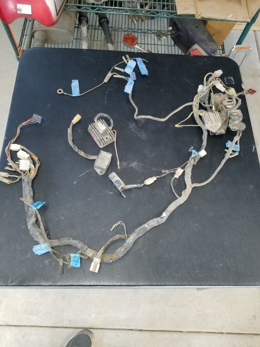

I started to clean the wiring harness yesterday. By the time I got to the main bracket holding most of the components, and got rid of the spider webs and egg sacs, it was obvious the bracket requires refinishing (like everything else on this bike!). Now that I have blasted it clean, I am realizing I have enough parts to warrant another run to the powder coat shop. I was wrestling with the idea of repainting a lot of pieces myself, but the winter temps here are not friendly to painting. Besides, powder coat is stronger, better looking, and more scratch resistant than paint.

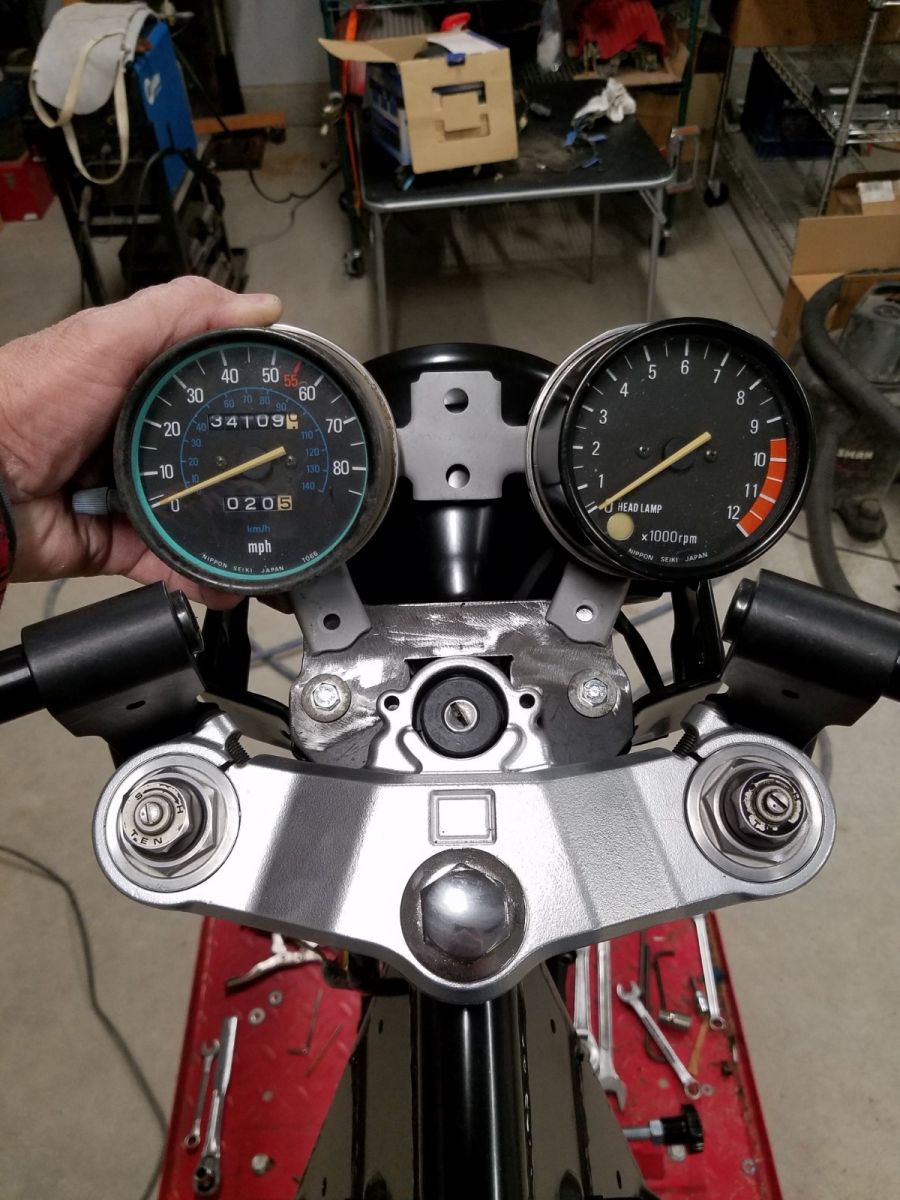

I still need to finish the gauge cluster mount, but I think I have to have the new speedometer before I can finalize the design. Since I went with a modern front end, it is no longer able to cable drive the stock speedometer. The Honda used an electronic sender off the motor for its speedometer. I have been searching the internet for a GPS speedometer, but most are set up to mount into a panel (dashboard). Another issue I am finding is very few actually show the back of the gauge they are selling. I would like to try and reduce or eliminate the need to make a decorative bezel to house the new gauge, while getting a face that looks decent next to the stock tachometer. Really not having much luck in this regard. It would be really nice to look at and hold one prior to purchasing, but I live in an area that does not have any retailers carrying these type of parts. On top of that, the nearest motorcycle salvage yard is 3 hours away and in another state.

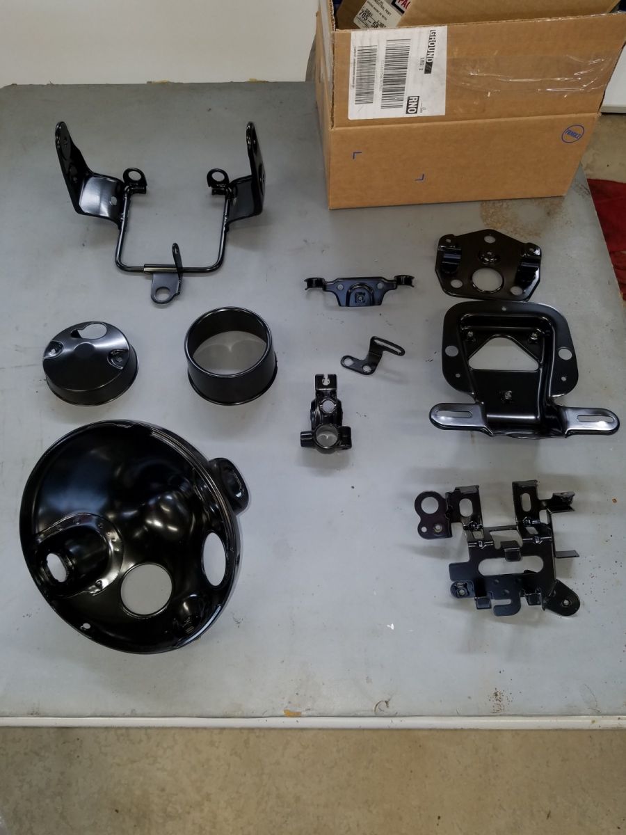

More parts back from powder coat! Dropped them off yesterday. Can't say enough good about this local shop!

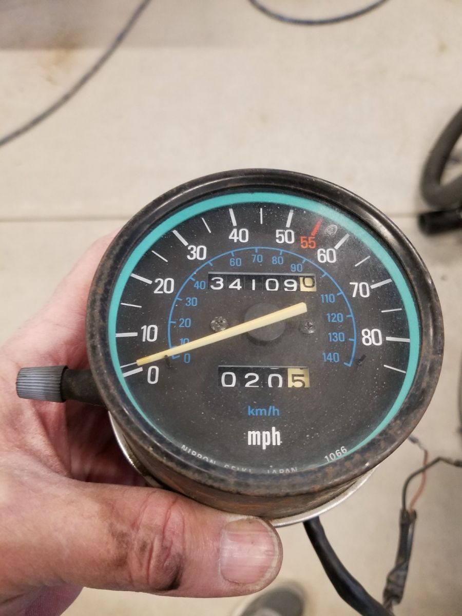

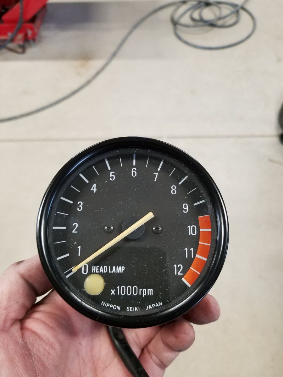

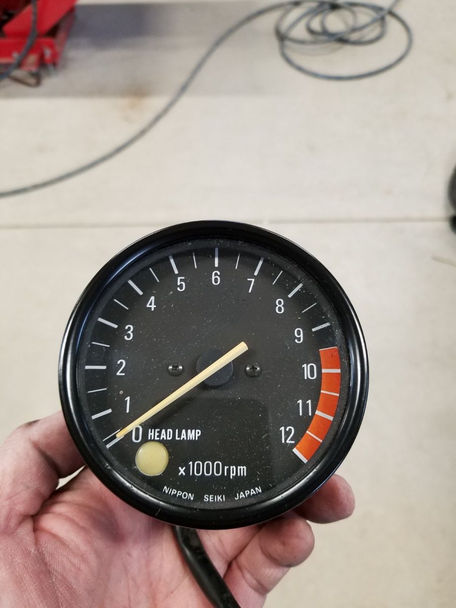

I disassembled the tach for two reasons - refinish the bezels due to mild rust, and black out the light green around the edge of the gauge. I think it looks cleaner this way. Posting a pic of the stock speedo for comparison.

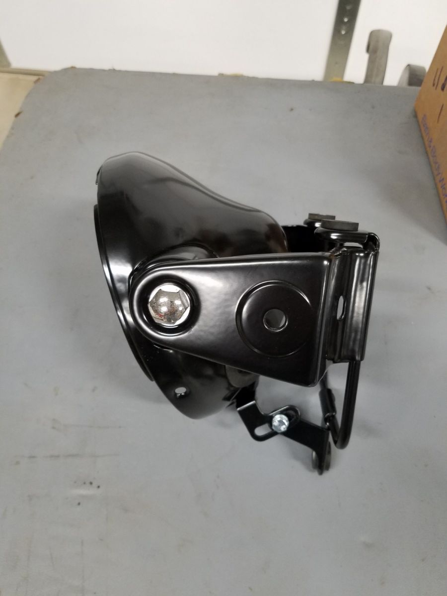

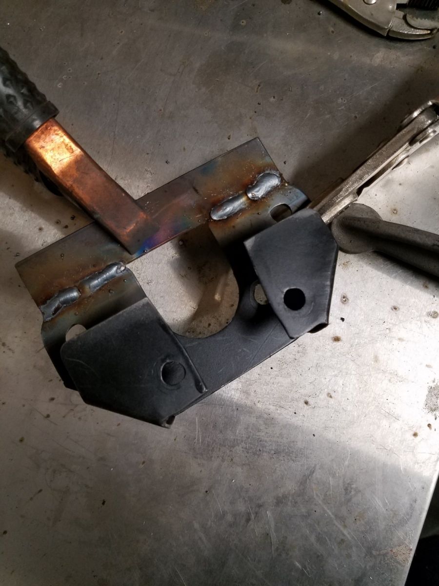

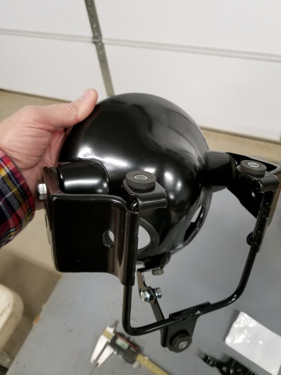

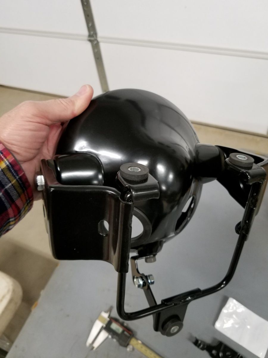

My solution to needing to move the gauge cluster away from the handlebars. Instead of using spacers to raise the mount plane, I am lowering the headlight mount. This will make the dash area look much cleaner.

I ground the welds smooth on the top side. Still some edge contouring needed, but this will be the new gauge position, from the rider's view. I'm thinking about painting the bracket with wrinkle finish paint. It would make a nice accent to the dash.
