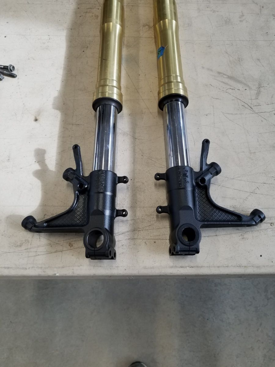

I've been working on the brakes (obviously), and cleaning/refinishing as I go along. I bead blasted the rear caliper mount. Going to repaint it semigloss black. I also repainted the fork lowers.

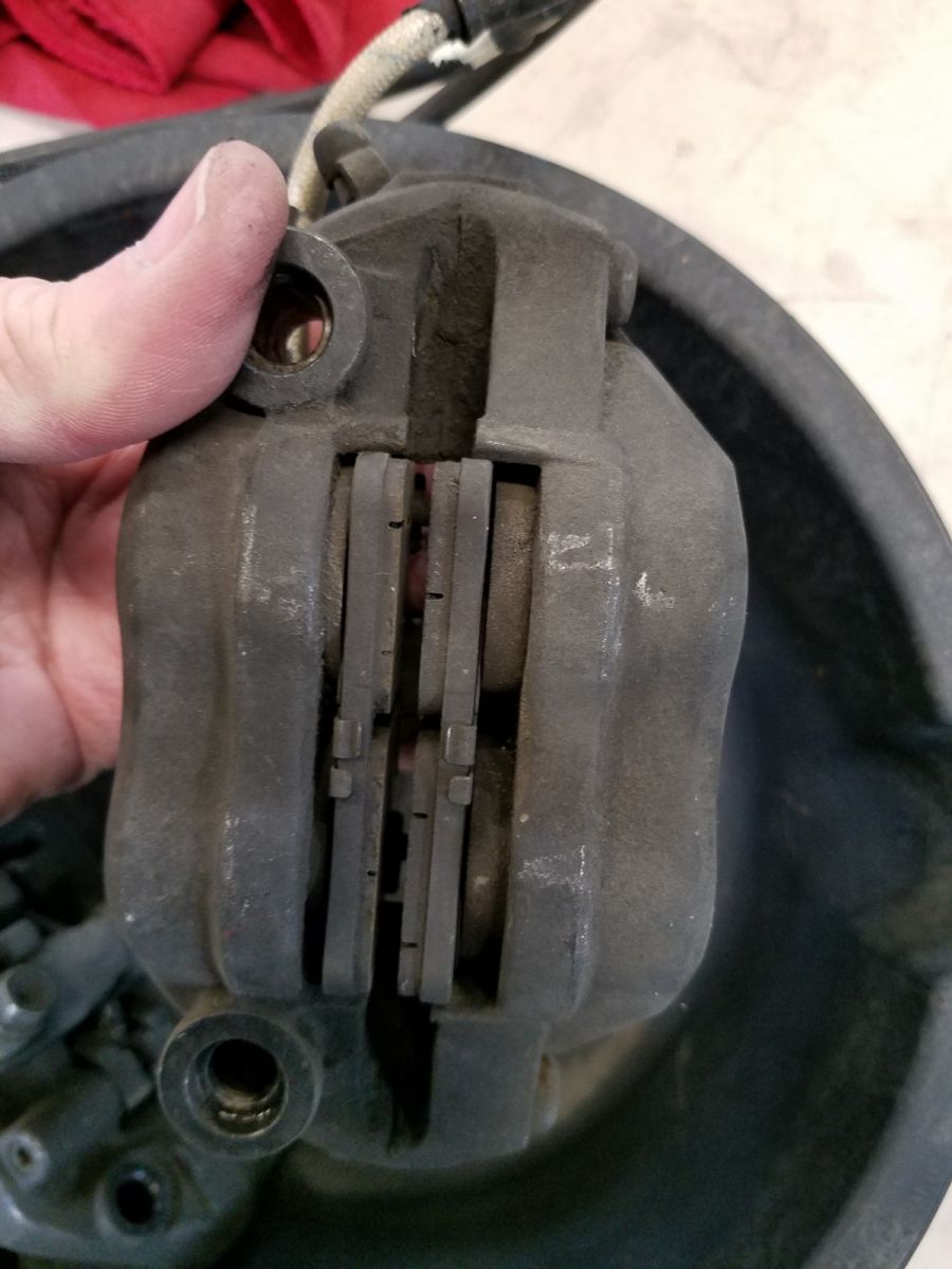

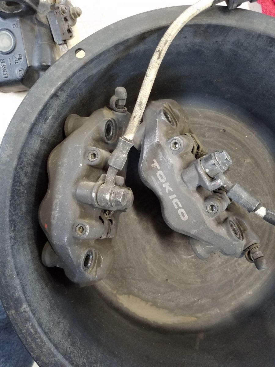

While I have been working on getting the rear brake system disassembled, I drug out the front brakes. These are going to need some love, too. They have seen better days.

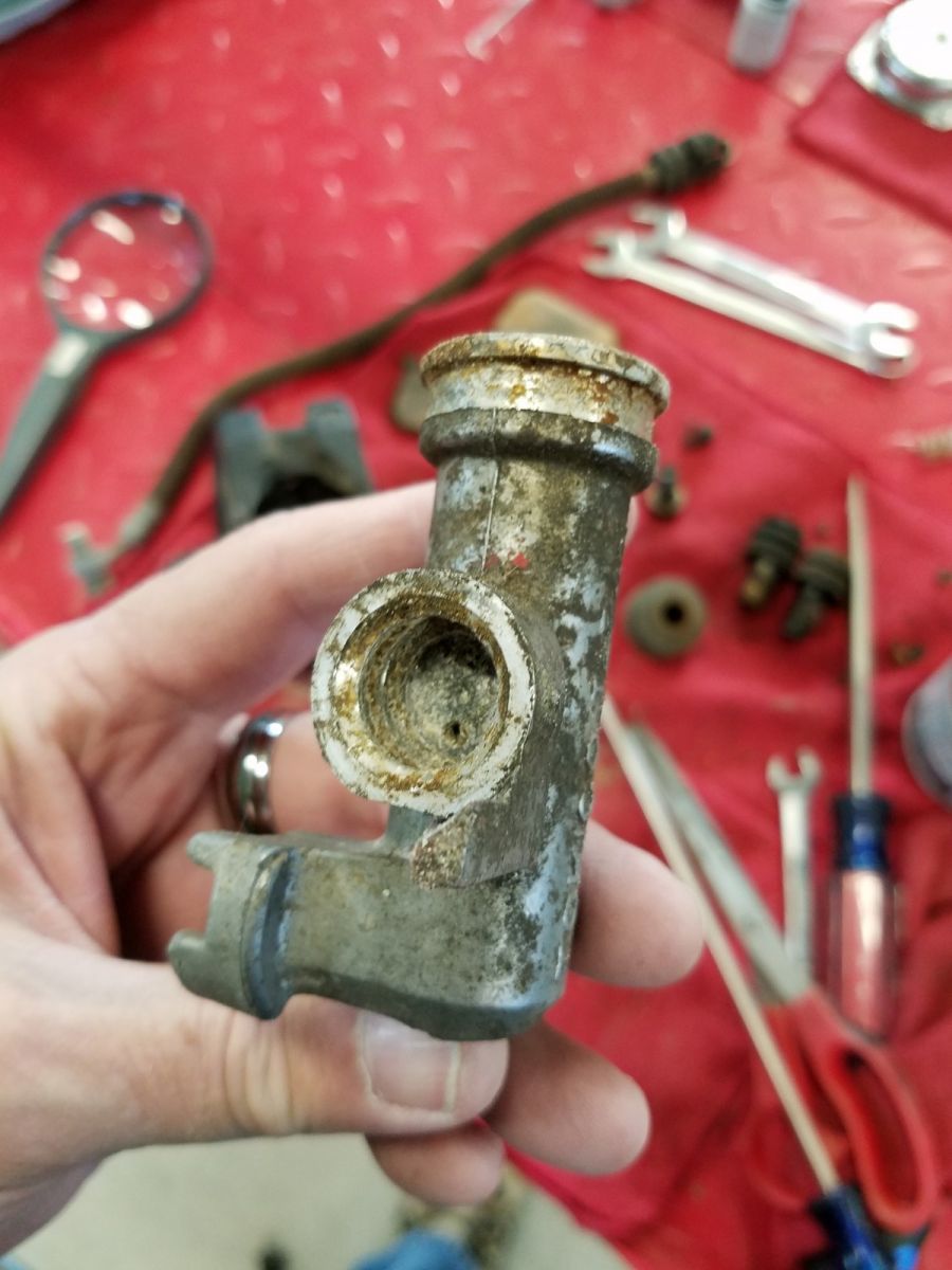

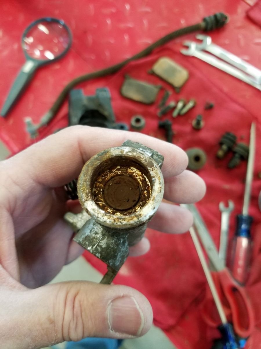

The rear master cylinder has a frozen piston as well. So for lunch today, I am whipping up a batch of caliper soup on my shop stove. Once I get the pistons out, I will decide if they have to be replaced or not. At least the front brakes are only 15 years old and still have fluid in them.

I wouldn't waste time on that master. It's junk. Sure to be corroded on the inside. I had a dickens of a time finding a good, corrosion free, unit for my 750. It can be done though, or you can adapt something newer to work.

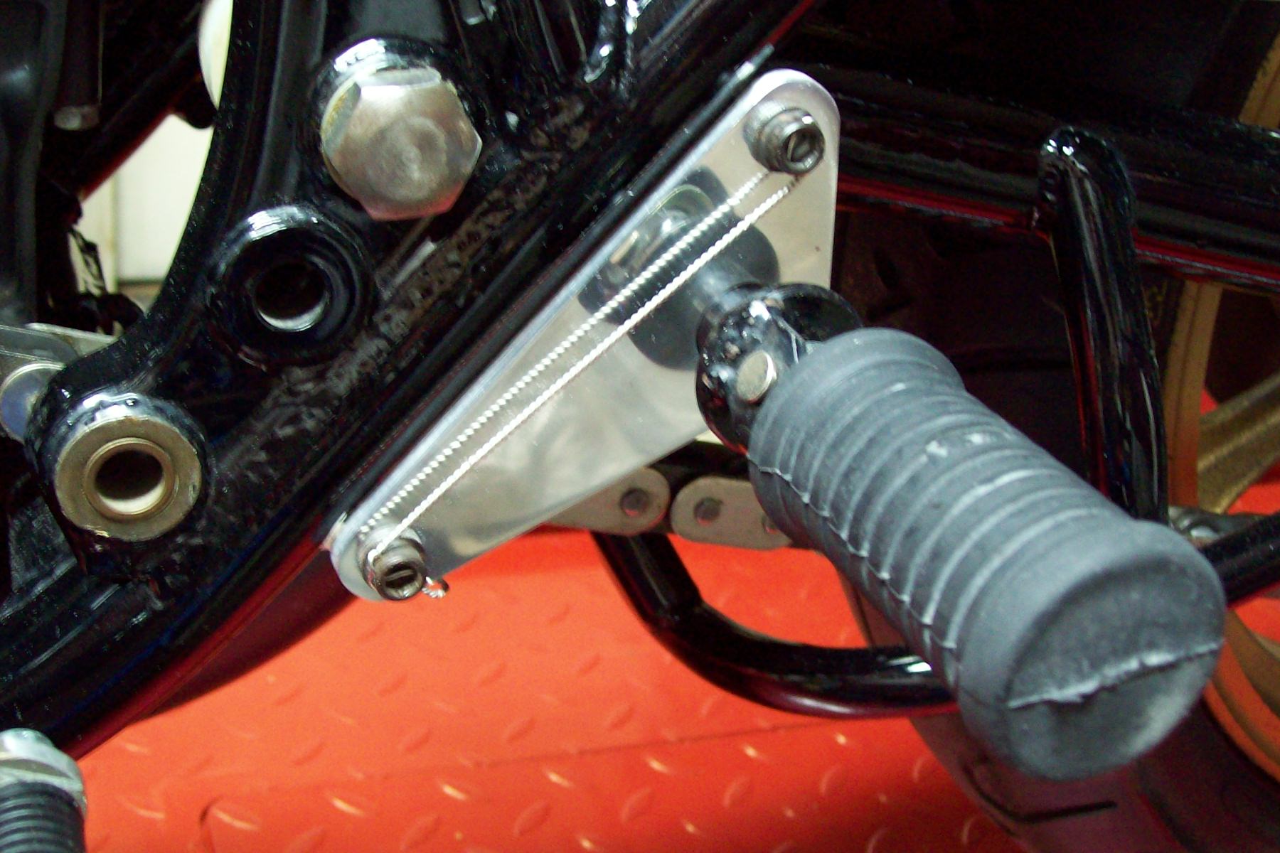

Instead of buying somebodies rearsets for your 750E, just make them. You already have the bosses on your frame you can use to mount the rearsets. I started out on mine with some 1/4 inch good grade aluminum for the brackets, and the buddy pegs from a '76 Kz900. I copied the bracket shape from my old Kawasaki road racer. They are the same on both sides. Most of my shifter linkage is from the '82 GPz750. Only the shift lever itself is not from the GPz750. That you would have to fab up yourself.
The brake side I even used a Kz750E master cylinder with a longer linkage to connect to the brake pedal. The footpeg again is a buddypeg from the '76 Kz900. The brake lever is from my old Kawasaki road racer. That would be the only piece you would have to fab up. I mounted the rear master to the frame with two simple brackets welded to the frame. I used a simple spring setup to return the brake pedal. I used a old style brake light switch and spring for my rear brake switch. I come from the K.I.S.S. way of doing things, Keep It Simple Stupid!!!!!
To me all those aftermarket rearsets just look too cluttered for my taste. I like to go for that clean uncluttered look myself.
