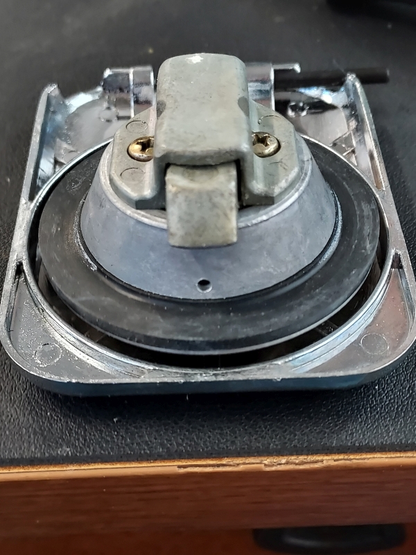

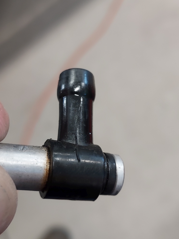

I followed all the instructions from Pingel, and I am happy to report that it is sealed up on the first install. However, I now have a fuel leak at the low fuel indicator sender. Time to remove it and use a cover plate. It appears I am also leaking fuel at the "T" between carb 3 & 4 were the fuel line attaches. These were all leak free before. I don't know if the o-rings need to swell to seal, or if they shrank from having the tank dry. I just drained the tank again so I can remove the low fuel sender. While draining the tank I noticed the flow would slow down until I rocked the tank, then the it would go to full flow again. It appears my tank is not venting. I put a replacement fill cap on the tank from Z1 Enterprises that looks exactly like the stock one. Anyone had to create a vent hole in one of these to keep a Pingel flowing?

The fuel Tee and transfer tubes use 2.0 x 5.0mm O-rings. Buna N O-rings will swell with gas contact, but yours shouldn't have shrunk enough to leak after only a short time like this.

After removing the fuel cap and disassembling it, I determined this to be a good spot for a vent hole. After re-installation the Pingel petcock flows at full force. So beware some of these repops may not be everything the OEM one was. My original fuel cap was so far corroded I threw it away once I got the new one. Should have waited, I guess. It works now. Time to get the tank back on and see if the carb "T" is still seeping.

I took the fuel "T" out from between #2 and #3 carbs to put new o-rings on. O-rings were not the problem. I have a cracked fuel "T". This part is no longer available. Anyone have a spare they would be willing to sell?
