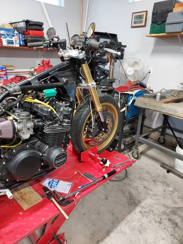

Re: Saving a '81 KZ750-E
20 Nov 2021 16:25

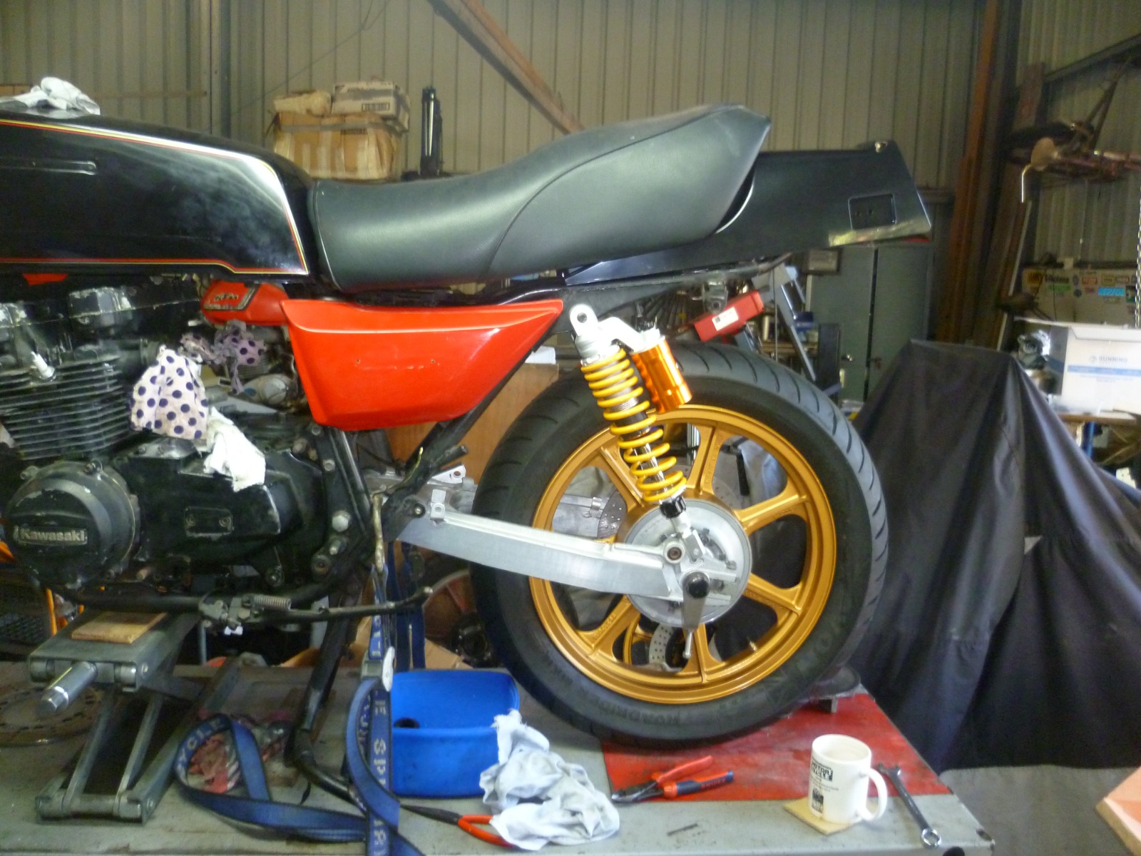

With two opposing tie downs on each side it is more stable than it looks. I can grab the frame and shake it without any movement, except the lift itself.
20 Nov 2021 21:04Yep, two tie downs on mine too....With two opposing tie downs on each side it is more stable than it looks. I can grab the frame and shake it without any movement, except the lift itself.

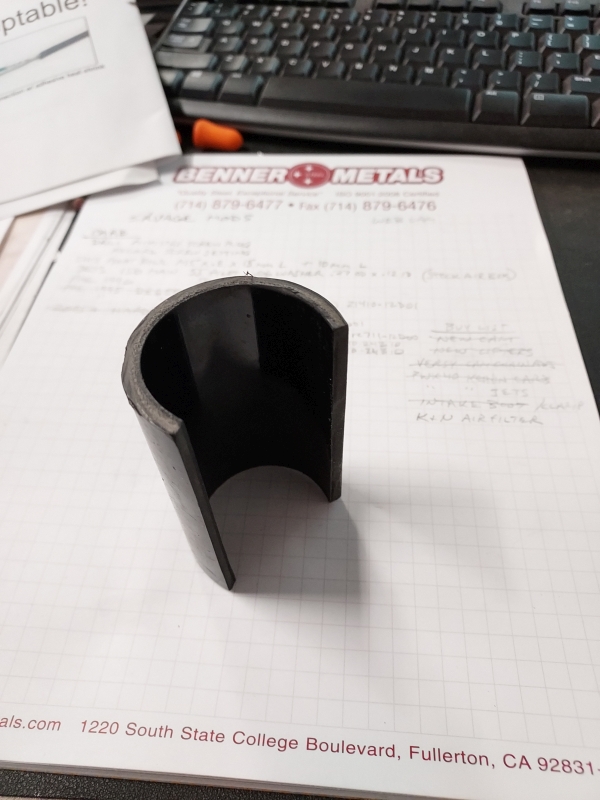

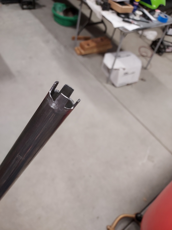

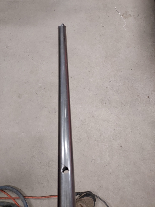

It took a while for me to get these Honda CBR600RR forks rebuilt, but they are finally done and back on the bike. The oil was definitely in need of changing, so I am a little glad they started to leak on the first real test drive. I should have done this rebuild before, but oh well... they are done now. In order to achieve the proper torque on the damper bolt, the FSM calls for another special tool (I hate special tools!) to keep the damper from spinning. Partzilla has it, but for way too much money. So I found the correct size steel tubing, and made my own. I found a piece of round tube just the right size laying in my metal scrap pile. A half hour later, I had what I needed. Saved $76.
I had a piece of PVC tubing to drive fork seals in, but I was using it for standard forks. Had to be removable for the upside down forks, so I cut out a section so it would stay on the slider. Another special tool cost avoided.

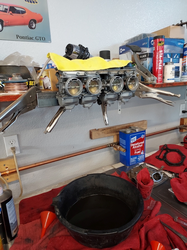

Rechecking the float levels on the carbs. I decided bending over the vise was not comfortable, so with some shims I got the carbs level on both axis using some 2" x 2" angle and vise grips on my work bench shelf. #1, 3, and 4 were within spec. #2 was not. The fuel level was flush with the sealing surface of the carb. Thought I had it right, but it is what it is. Trying to be gentle with the 40 year old float, my first three attempts to lower the fuel level to the required 4 +/-1 mm, I rechecked with zero change. Fourth try and I over compensated. It measured at 5.3 mm. Finally on the fifth try, I got it within the spec. I know, I know... I am getting old.
Now they are ready to go back on the bike to recheck the sync. Probably got that wrong last time, too considering my track record so far. Once they are sorted I will wait for a sunny dry day and grit my teeth in the cold for another test ride.

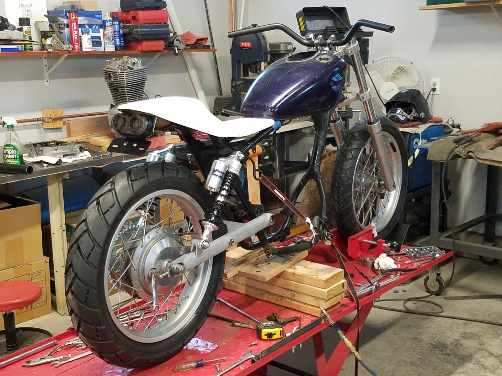

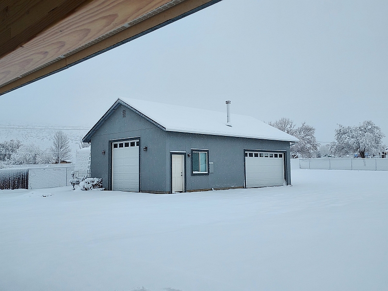

The weather has not been kind this December. Wave after wave of snow storms, coupled with high winds. It's really the wind that prevents the next step on my Green Monster. I can't run the bike inside the shop without opening the roll up doors due to exhaust accumulation, and the wind has been too strong to keep the doors open. And if the wind dies down, opening the doors lets all the heat out. Anybody have a tissue for my issue?! I know I am whining... the next week has highs in the upper 20/s to low 30's, and overnight lows in the teens. Keeping the shop doors open is not going to happen. It may be time to swap project bikes on the lift and work on something that doesn't need the engine running. My Street Tracker needs a lot of love as well.
