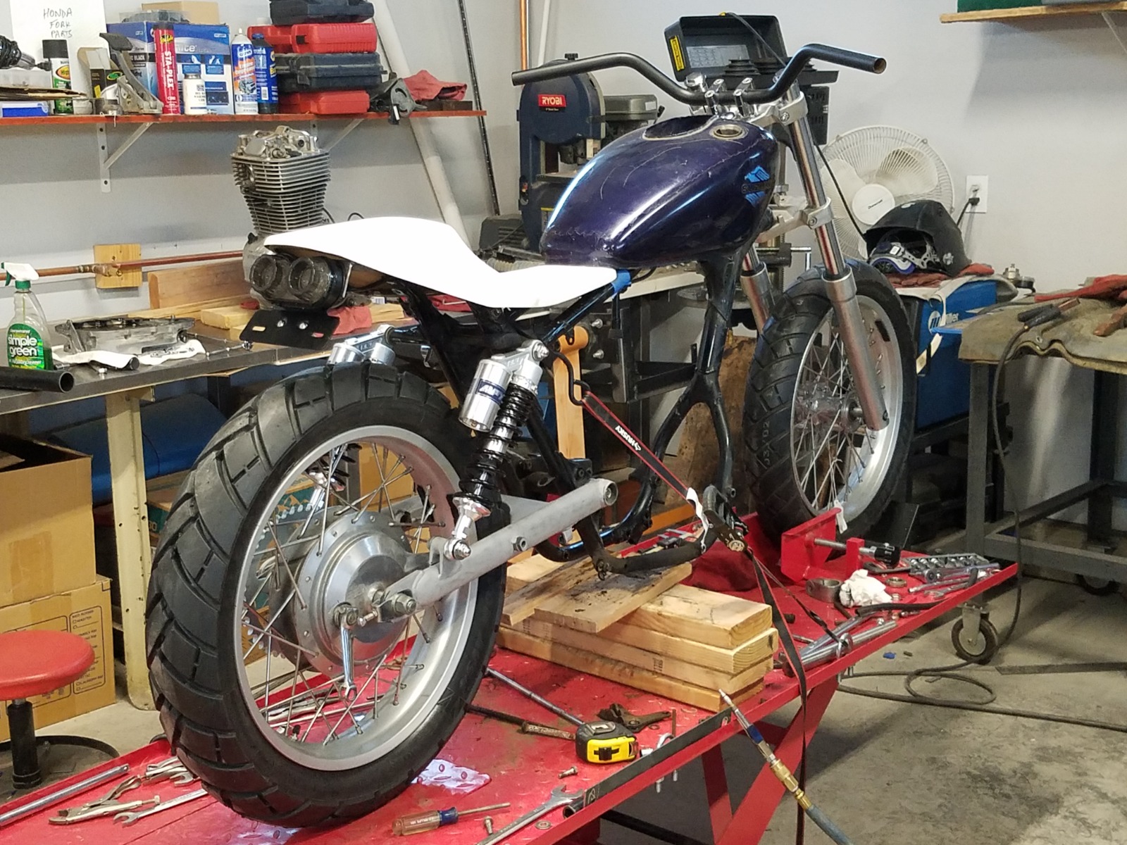

Well, the first real test ride didn't go so well. There is a bunch of stuff that needs addressing prior to taking it on another "real" ride. Today's venture was a whopping 6 miles. Here is a list of things needing attention:
1) The tach is squealing pretty bad. I lubed the cable, but I think it may be the gage from sitting for so long. The gage needs to be removed, and lubricated.
2) Both forks began to leak oil, the left one pretty badly. I knew they weeped a little bit, but now the left one is dripping on the ground. Luckily no oil made it onto the brake. I have all of the new seals to do these forks, I just didn't think they were bad enough to address right away, I was wrong on that one.
3) The chain needs to be adjusted better. It wasn't tight enough to begin with, and it loosened up more.
4) The idle needs adjusting, and there is a miss at 1/8 - 1/4 throttle. I may have partially fowled a plug, as the last time I started it, it belched smoke pretty bad but cleared up quickly. It had some mild smoke afterward so I turned it off. This issue went away after torqueing the head this morning. No more smoking. As far as the missing, I am going to have to look into that. I will recheck the carb sync and the timing, but I am leaning toward the sync being off.
5) The bolt attaching the steering stabilizer to the fork clamp decided to leave the party. I have to source a new one, and install it with Loctite this time.
What little riding I did showed me the steering is pretty sensitive. The front brakes are OH MY GOD powerful!! It surprised the crap out of me how touchy the brakes are. I can one finger stop in a big hurry with these brakes. Something I will need to get used to. I was really hoping to get some miles on this bike today, but I have better judgement with everything I am seeing and feeling. Too much work left to be done. All things considered, the list is pretty minor stuff for a frame off rebuild. I didn't accelerate very hard but I can already tell this motor has some giddyup. My current project bike just became a roller again, so it's perfect timing to get it off the lift and put the green monster back on it. I know it isn't a KZ, or a Kawasaki for that matter, but here is a glimpse of project bike #2 - a street tracker build ('87 Suzuki LS650 Savage)
