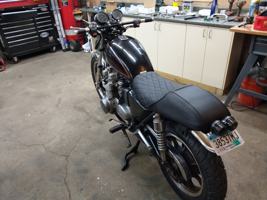

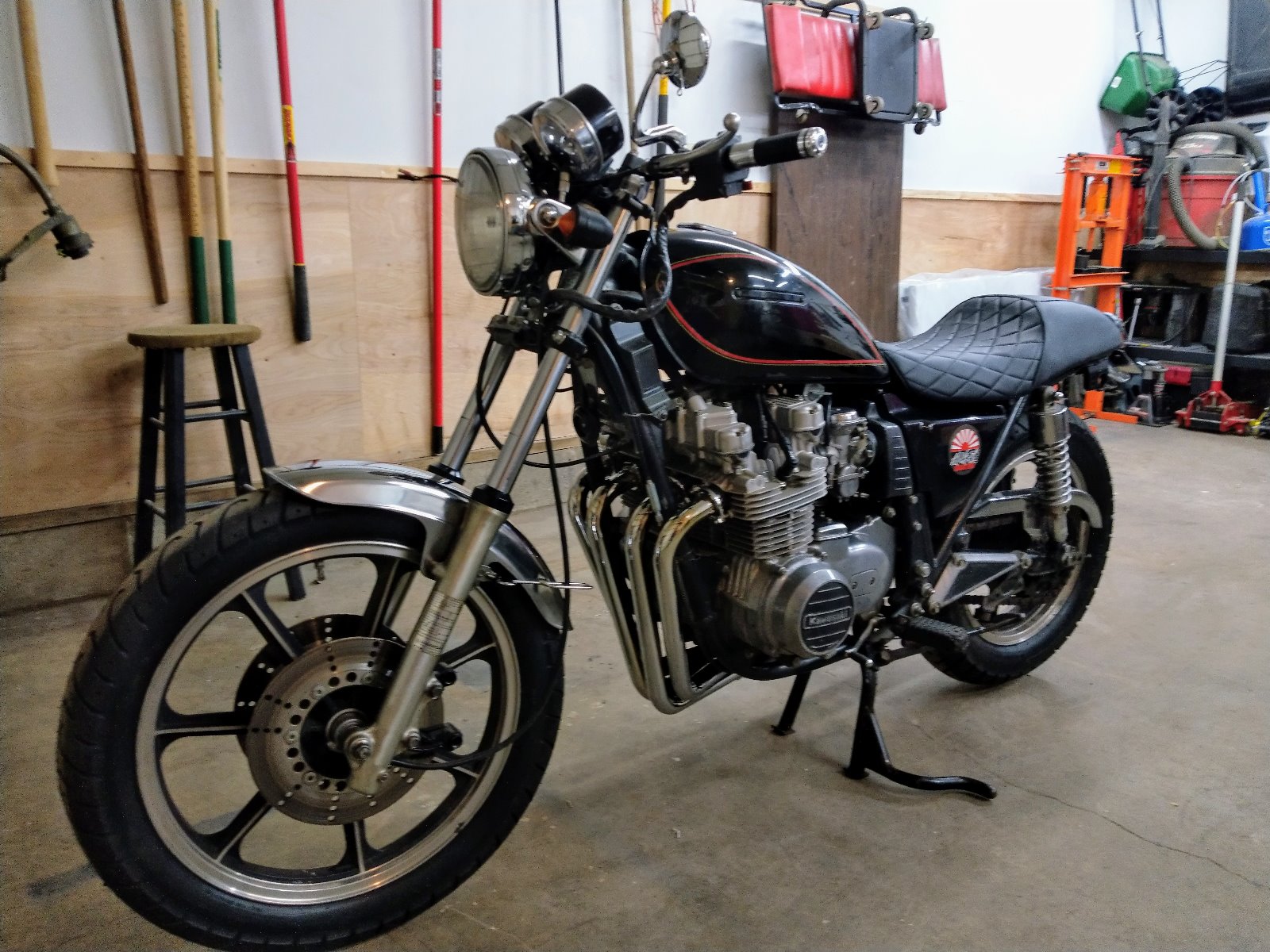

Took it out for a short shakedown ride today, once it cools down I'll check all the important bolts again.. Haven't ridden a bike since I was 17 (32 years ago}. Aside from stalling it at half the stop signs I took off from, it seemed fine. Only thing I want to do for sure is get some fatter grips on it.

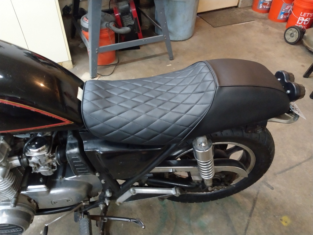

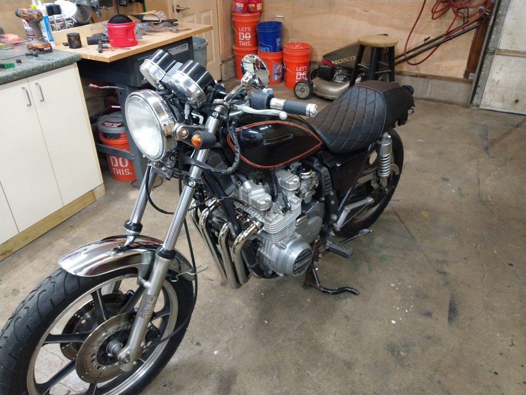

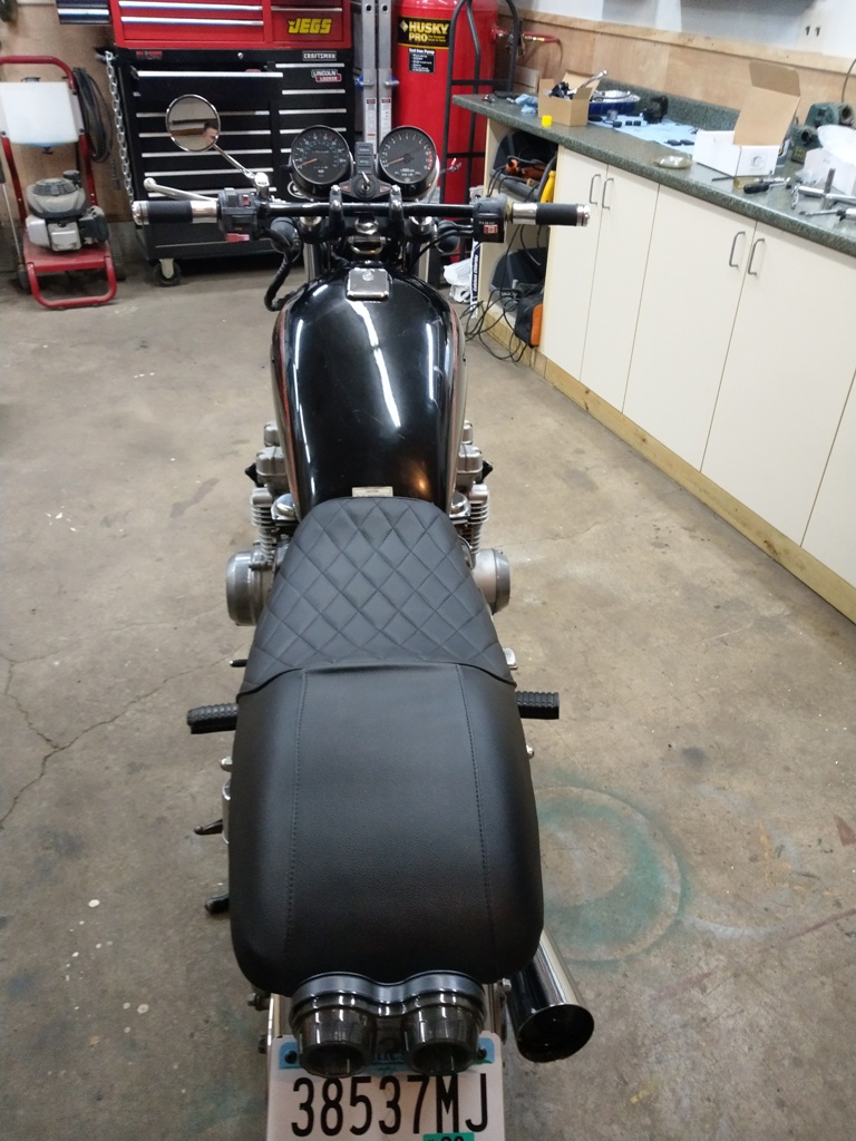

Seat, mirrors and some of the brake parts showed up today. Seat is very nice quality and you just remove your stock seat hardware and install it on the new seat. So the stock seat latch and hinges all work. They also had the holes to put that plastic checklist thing on - but I didn't.

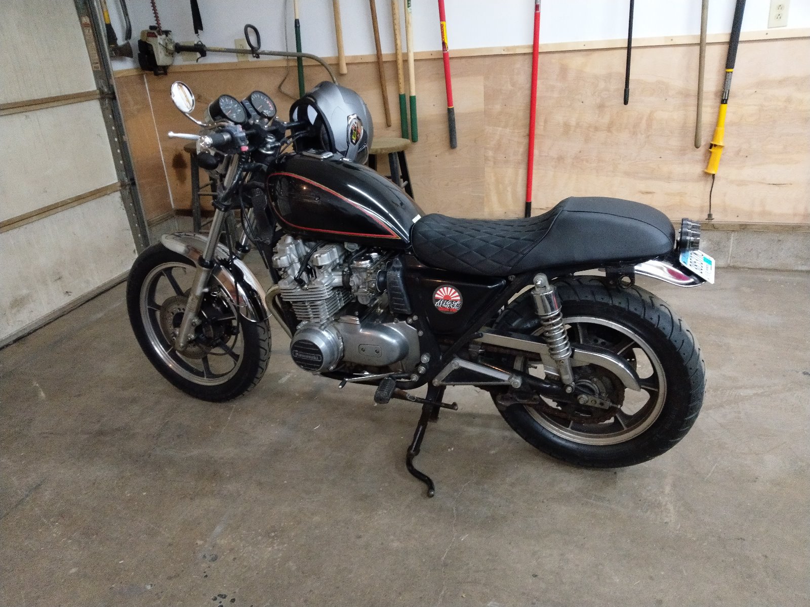

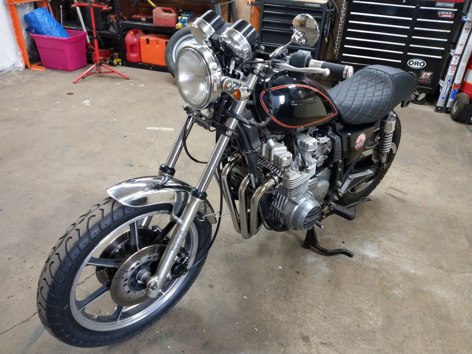

Brake lines are still out in USPS land somewhere, but the calipers are all rebuilt and as soon as the lines get here - maybe Monday then it'll be done for now. I had been planning on a café style fuel tank, but came to the conclusion that the engine is so wide that having knee bump ins over the already protruding carbs would be silly and non functional. So I think a new paint job and something to cover up where the stock Kawasaki logos screw onto the tank will be the final product. I've tried every other method known to man to get the pinstripes off, so sand paper is going to be the final effort. Might also consider removing the cut-down rear fender and attaching the lights another way - but I appreciate the protection that it provides. Not in these pictures are the tucked in chrome front turn signals that I put on to replace the plastic things that the PO put on.

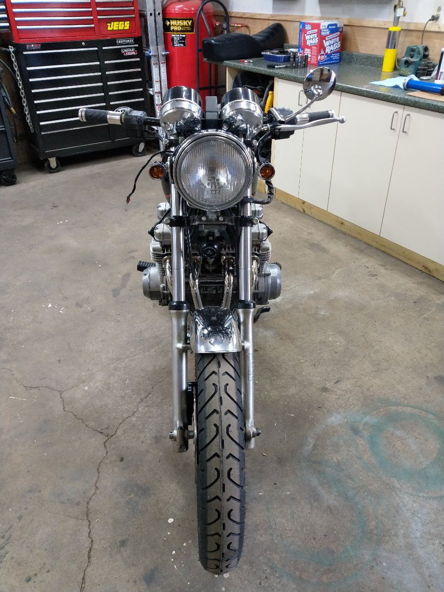

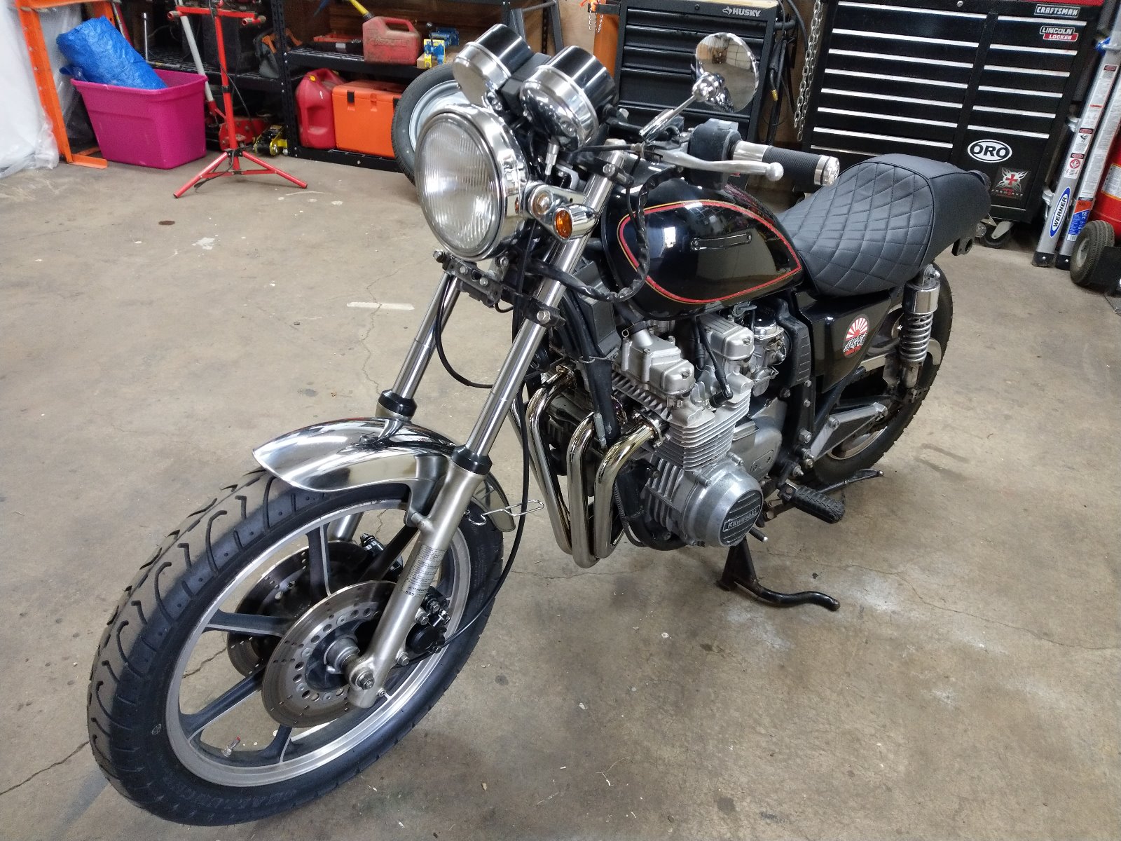

Brake lines came in yesterday, got the brakes all installed and bled out. Just got done with a 15 mile ride and it all seems to be working well now. Only complaint is that the mirrors are completely useless. Need to do some work on that.

Did you have to do anything to make your seat in line with your tank? I also got a seat from Texavina but it leans forward just a little bit. I'm thinking of maybe just adding some spacers under the hardware or something to get it leveled up front.

No, just bolted the stock hardware on. The hinges and brackets have a little adjustment, and it took a couple of tries to center it and get the latch to work. No shims.
Something in your picture looks off. the plastic side cover doesn't look parallel to the seat bottom.

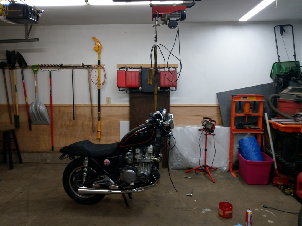

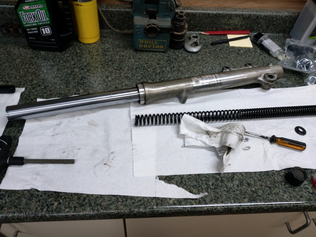

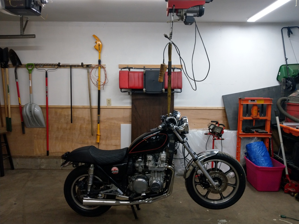

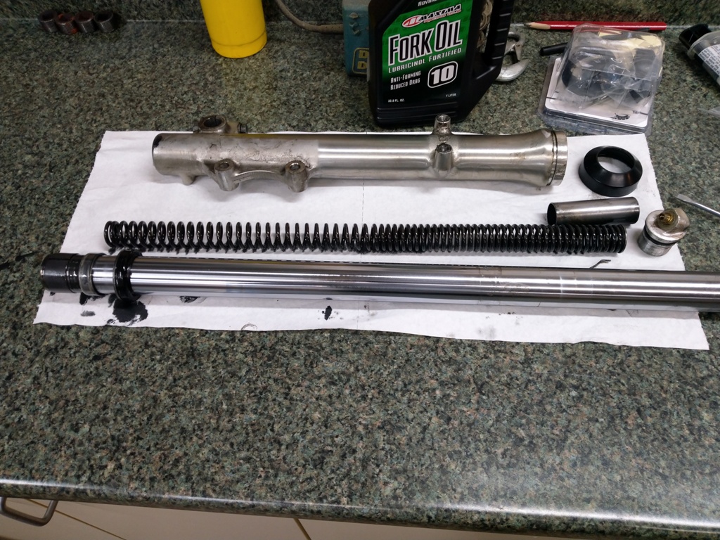

Started last night on fork rebuild. Realized that I needed a 8mm hex key that I can put on my impact to get one of the bolts out, so only finished one side. Hopefully when I'm done the front end won't be so squishy. Also need to pick up a pump to charge the air shocks. I haven't got anything with a gauge that is accurate down in the 10lb range.

After I got it all put back together and put about 8.5Lbs of air in the forks the difference was pretty amazing. Guess that 38 year old fork oil wasn't really doing its job. Put about 40 miles on it Saturday and it was working like a dream. Only remaining complaint is that the mirrors suck no matter what position they are in, so I ordered some longer ones. Been busy the last few days in the shop cleaning up and doing minor repairs on my wife's new ML crisis - I think it looks a little nicer than mine.

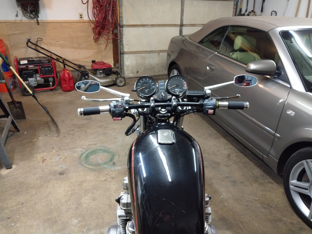

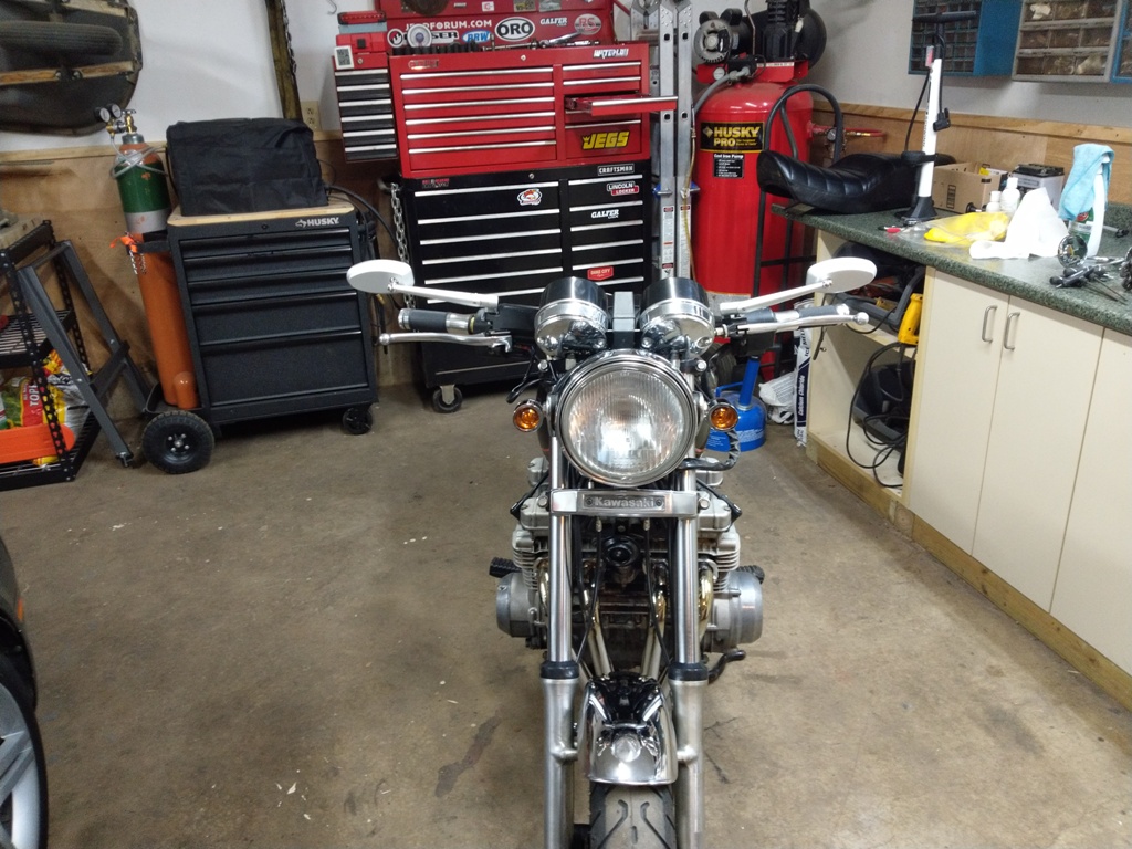

New mirrors showed up today from Dime City. Pretty fancy for this bike, but they should work better than the last ones I had on there. Hopefully can take it for a spin later.

The mirrors work really well and I found out what the range of the bike is before I have to skulk off to a gas station on the reserve
I think I'll try them with the extenders, but they gave a good range of view for lane changes and a little bit behind me.
