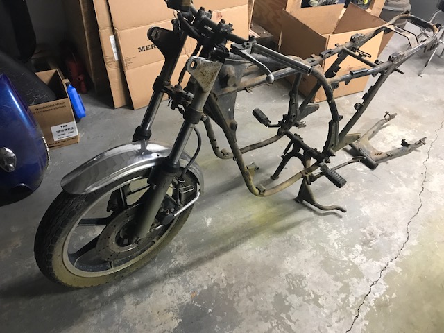

The engine is on hold until I get a few more tools. In the mean time I decided to strip the bike further to get to the frame. Looks like I'll need to invest in a sandblaster to take care of the swing arm and frame.
Here's the machine after a couple of hours work this evening.

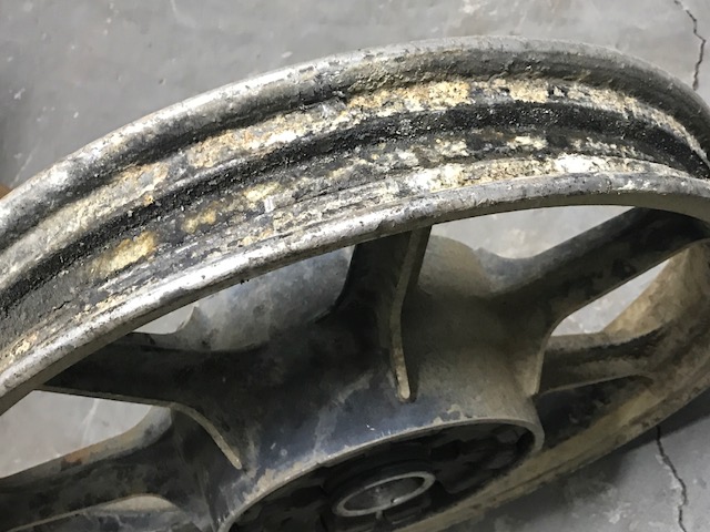

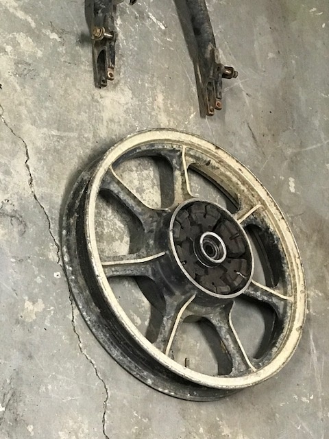

Got the old Metzler off of the wheel and discovered a strange funk in there.
Not quite sure how I'm going to get the wheels cleaned up and ready for paint or powedercoat.

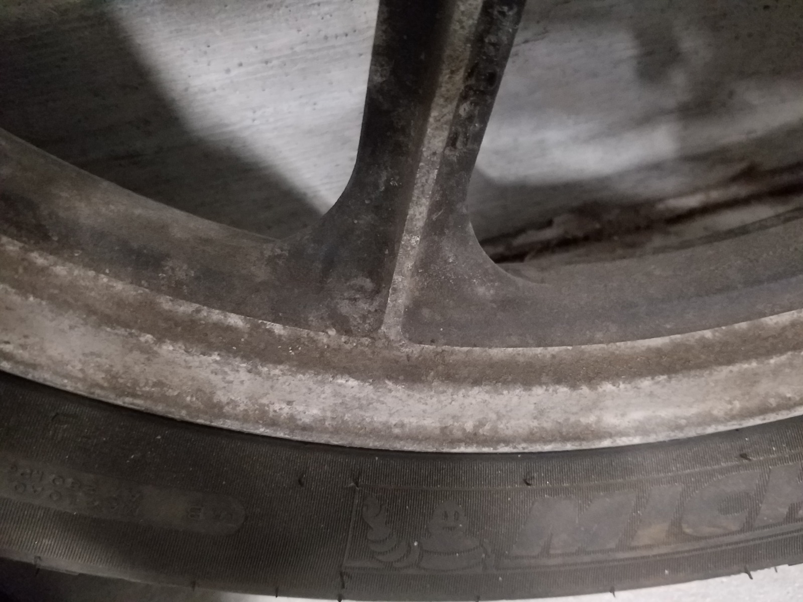

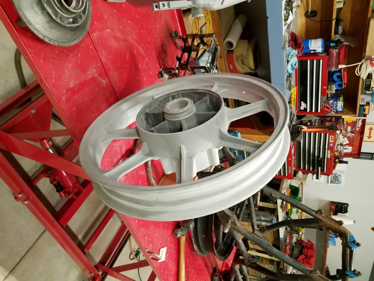

My wheels were pretty corroded as well, but using 80 grit glass bead media cleaned them up nicely for powder coating.
