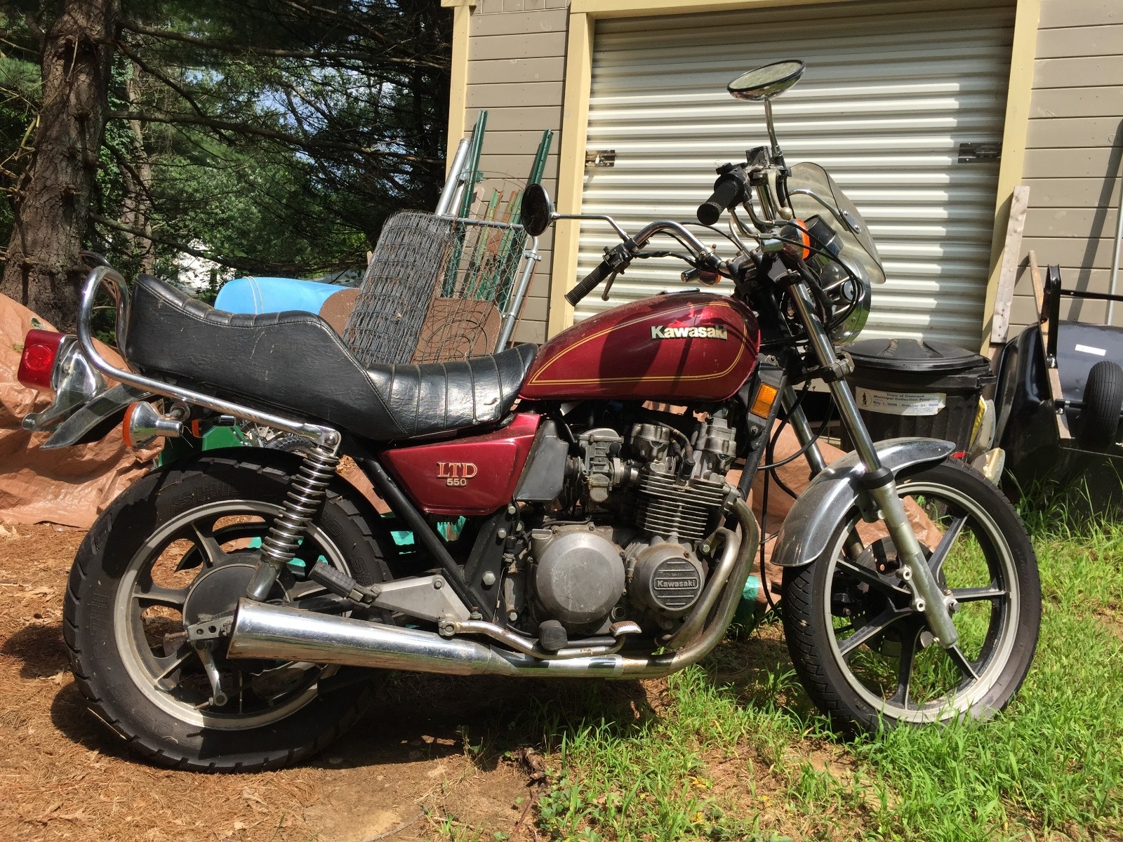

Also, a picture for you guys. Thanks so much for all your input, it's really helpful.
AJS - thanks for pointing out the oil issue. It shouldn't hurt to change out the oil to what you recommend right? I'd love to learn more about a wet clutch, I've never really heard of that. I'll do some reading. Also, thanks for the tip on screwdrivers. I see a lot of near stripped screws, and I'd rather not have to replace them.
Martin - thanks for the direction to partzilla. I'll see what I can find. I don't need an OEM kit, happy to put together the tools I need to fix it and make a pouch or case that fits under the seat. Just want to make sure I have the right tools in there.
Regarding the brakes and lights - after riding for a few miles they seem to work intermittently, and sometimes I get the flashing brake lamp bulb but the brake light still works. I'm going to clean all the connections before I dive deeper into this puzzle, as most of the bullet connectors and wires on the bike are showing some mild to medium corrosion. Easier to start from a place where I know all the wires are working correctly.
Nessism - Valve adjustment huh? I know very little about motor internals, but I got this bike to learn with so I'm happy to take a swing at it. I'll read up on loud's valve cover information and see what I can find about fine tuning the valves. It sounds like there's a little tapping in the motor, maybe this could fix that?

hardrock - unfortunately only the straps remain. The tool kit itself is gone. I was able to find a list of the tools it had, and have bought some to keep on the bike with me.
ajs - thanks for the note, I didn't realize the connectors were plated. I'm considering rebuilding the wiring harness, but I'll see what the engine internals look like this winter before I commit to a project like that. I'll keep an eye on them for more corrosion in the future.
1980 550 LTD - first bike project

That doesn't look too bad for $1. I think you did good.
