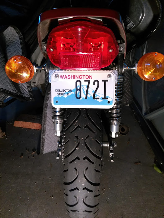

It looks like he said the tailight is from a ZX11. Very good Looking bike.

She looks nice and could run circles around lesser bikes. That taillight looks like it was built for it. She is well cared for and it shows.

Correct! The taillight is off a zx-11, just flipped upside down and mounted. Not sure about the brakes. It had the dual discs when i got it. Yeah, I got lucky. It's been just about a perfect platform. This winter will be spent adding a gravity petcock and possibly some sort of air box to cut down on the turbulence induced imbalance at high speed or when windy.

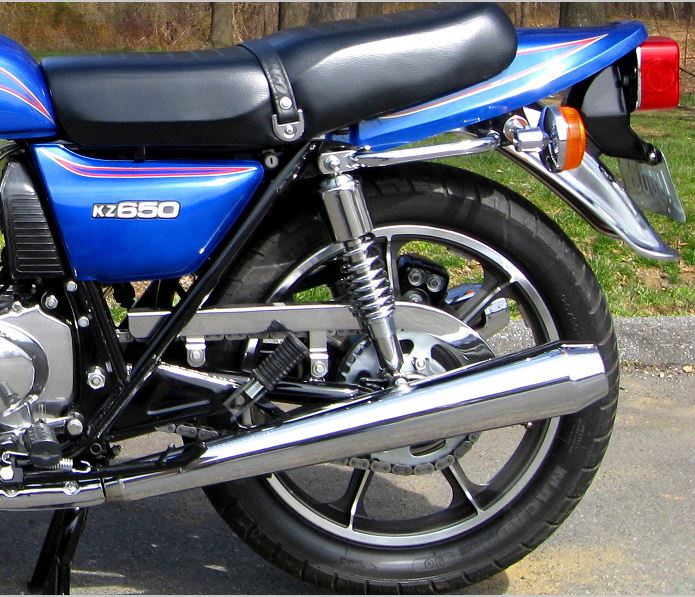

Amazing looking bike. Tell me more about how you mounted the tail light and what year ZX-11 its from. . I want to keep my stock signals just as you have, eliminating only the rear chrome fender. Here is a pic of my bike. Looking foward to hearing from you on the tail light info.

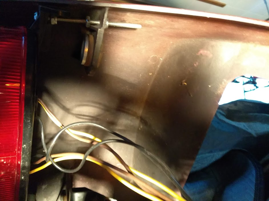

Here's how I mounted the taillight. Don't flame me. I did this 10 years ago and it is still well attached and does not rattle.
As you can see, the zx-11 light fills out the tail section nicely. On each side of the lens, there are factory tabs. I drilled each tab and then inserted some long machine screws. They're the outside screws in photo. The same screws go through the rear mounting tabs of the tail. There's a regular nut in the center on one side of the mount and a nylock nut the other side of each mount on the end of each screw. I used the center nuts to position the light evenly on each side then snugged the nylocks onto the other side of the mounts. I then glued the factory tab on the bottom of the light to the underside of the tail (remeber it is mounted upside down). You can see the reflection of the tab int he photo. It's still holding strong.

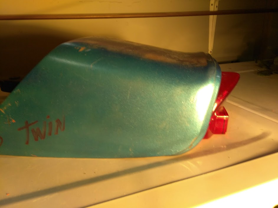

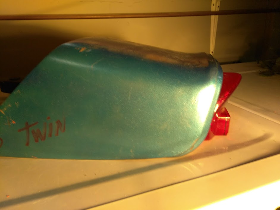

The other photo is a kz twin tail that I'm using the same light but the mounting will be a bit different. That's going ona cb550.

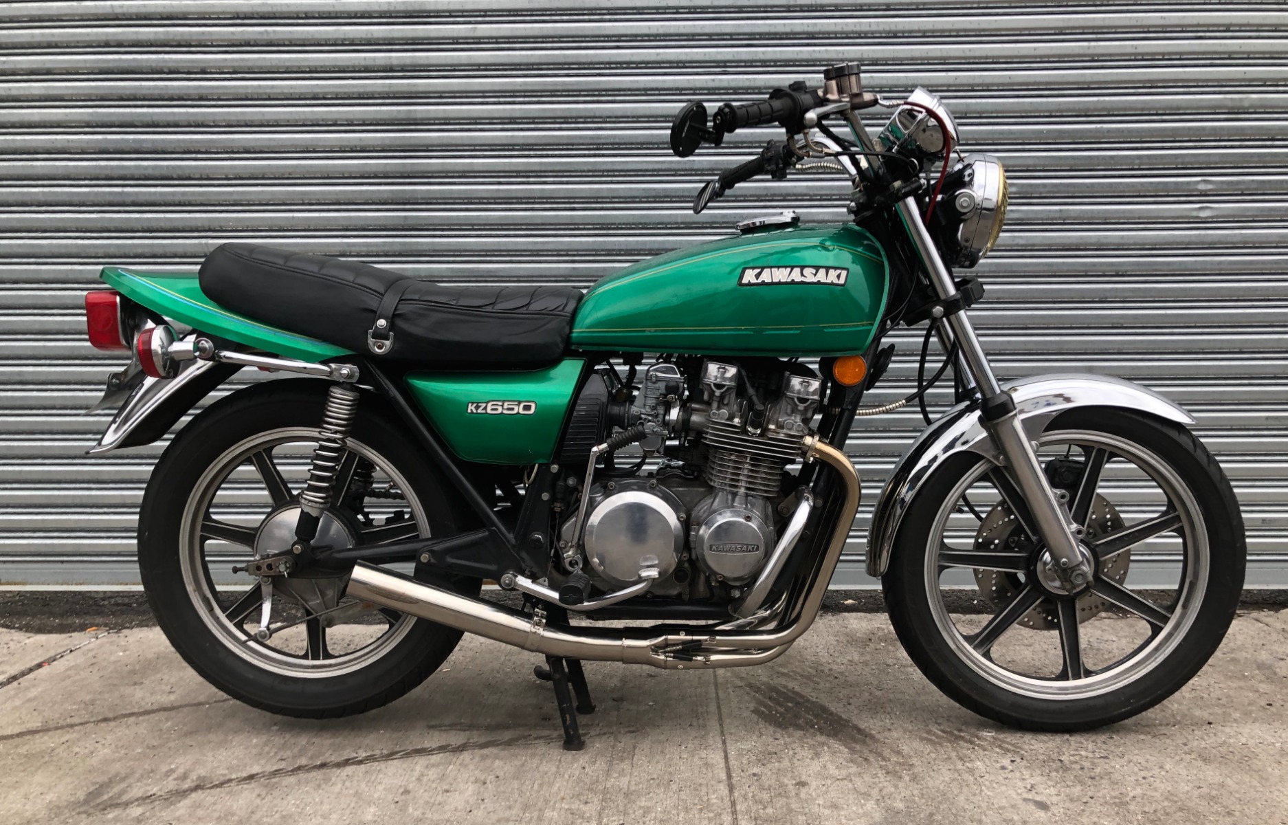

Hey fine folks,
A few updates to share. I was lucky enough to score this tank and body kit from a member on here a few years ago. I was looking for a color change and these were in nicer condition than my previous set. The colors are kind of seafoam and classic white with a green pinstripe.
The new body kit gave me the opportunity to "tuck" the rear taillight up and towards the front. Also swept the license plate bracket back a few degrees.
Other minor cosmetic changes include a smaller front fender which is from a kz550 I think. The mounting holes had to be slotted a bit to achieve the proper fit but it looks much better than my old bent and chopped original.
I had been wanting to switch out the progressive shocks. They were a bit too tall and stiff pushing you forward while riding and especially over bumps. I picked up these cheap shocks which are shorter and softer and working well for now.
Finally switched to gravity fuel delivery. The original petcock was leaking again and I suspected it wasn't flowing well. After the install, I noticed quicker throttle response at about 3/4 throttle and above. Not sure if this makes sense mechanically but...
