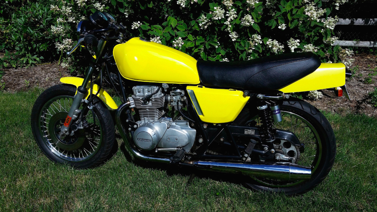

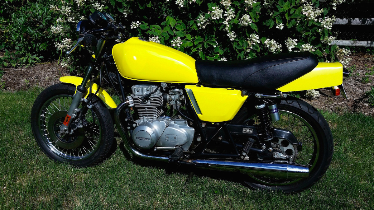

10 Mar 2018 12:26benjamin.p.hall wrote: Cafe racer: Preffered style, more fabrication (a naive positive for me) and a project of my own to keep. Would mean permanent changes that couldn't be altered back to the Z400.
I haven't found any viable aftermarket rearsets for the [K]Z400, so you would likely need to build your own.
Here is a pic of my previous '79 KZ400B2. I cleaned up the rear section by removing the chrome fender and fabricating brackets to hold the combination tail/brake light and license plate holder. I made smaller brackets to hold the turn signals; they are attached using the upper license plate bolts.
It's not an actual cafe bike, but I didn't have to cut anything and all the changes are easily reversible.
