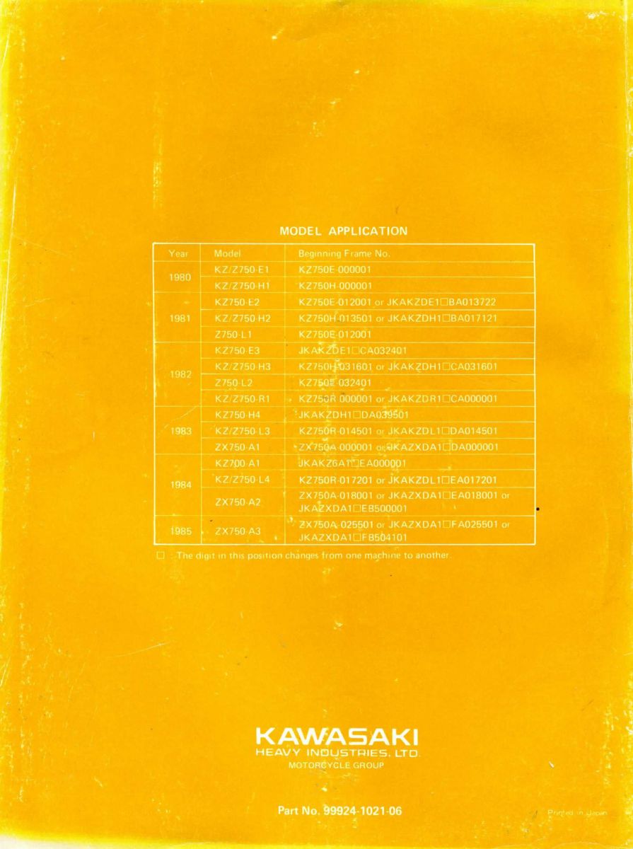

Excellent, thanks Tex. I found those files and immediately bookmarked them, as well as the
schematics on the Kawasaki site
. I also found the
service manual in PDF
format, but bought a physical copy as well.

24 Feb 2018 03:30 - 24 Feb 2018 03:31That one is the xeroxed version. The manual in Scirroco's link is much better; someone probably used a scanner.hookemdevils22 wrote: ..... .....
I also found the service manual in PDF format, but bought a physical copy as well.
