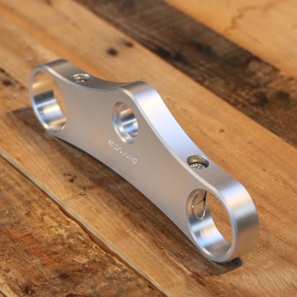

i have bought a
to put a busa front end on a cb750.

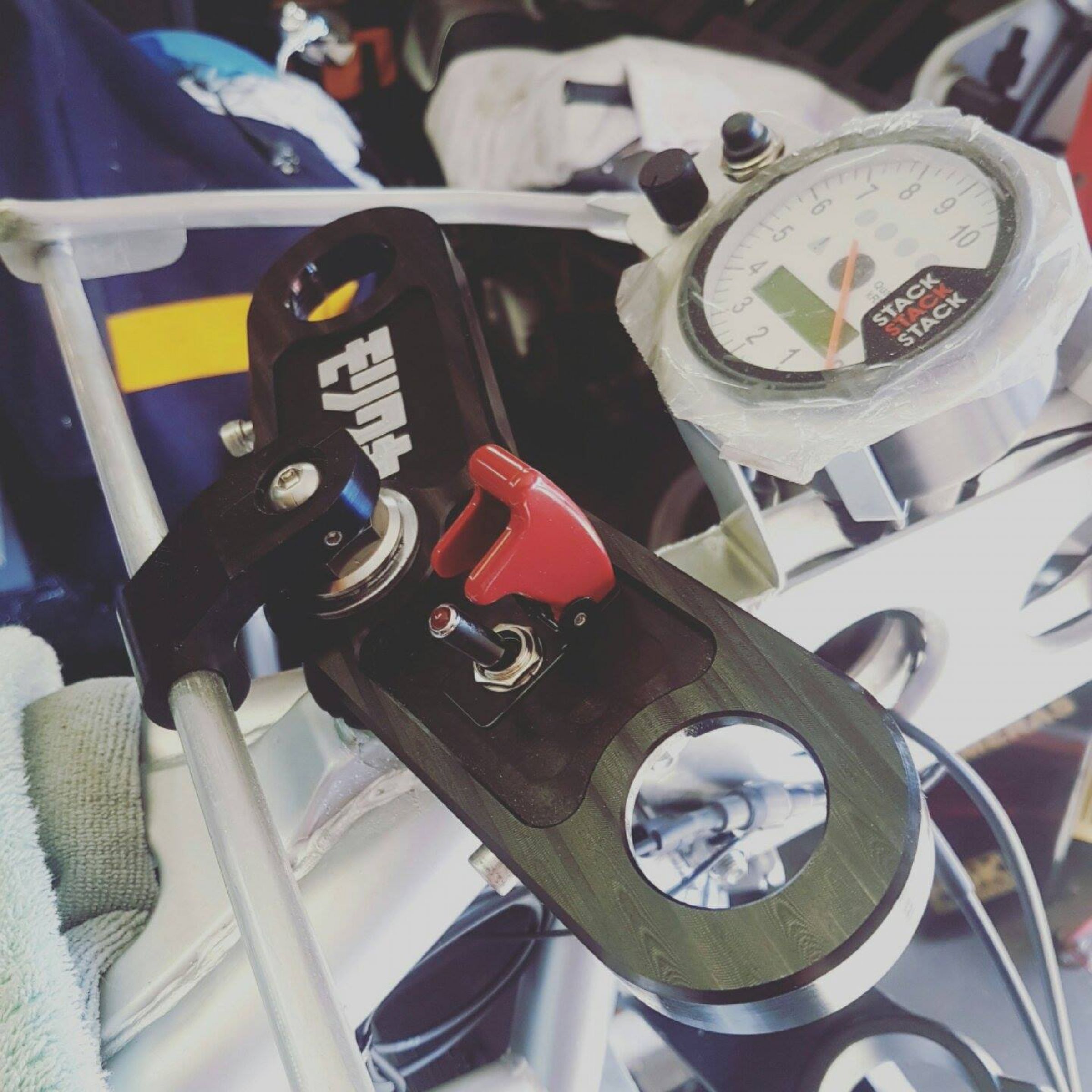

so i am familiar with the wedge lock but had never seen the sliding cylinder type clamping system of your triple.
this bike is very nicely done.
how does this mount not turn with the turning steering stem ????

There's a bearing recessed in the clamp to the fairing stay so the stem can rotate independently of the mount. You can see the grub screw that holds the outer race of the bearing in.
Yeah I like the design, I'm not sure it provides as much "clamping" strength as a traditional as it's effectively a point load on either side of the tube. Should provide the same strength as the wedge type would, Will see if there's any flex between the top and bottom yokes during testing, but I doubt there will be.
