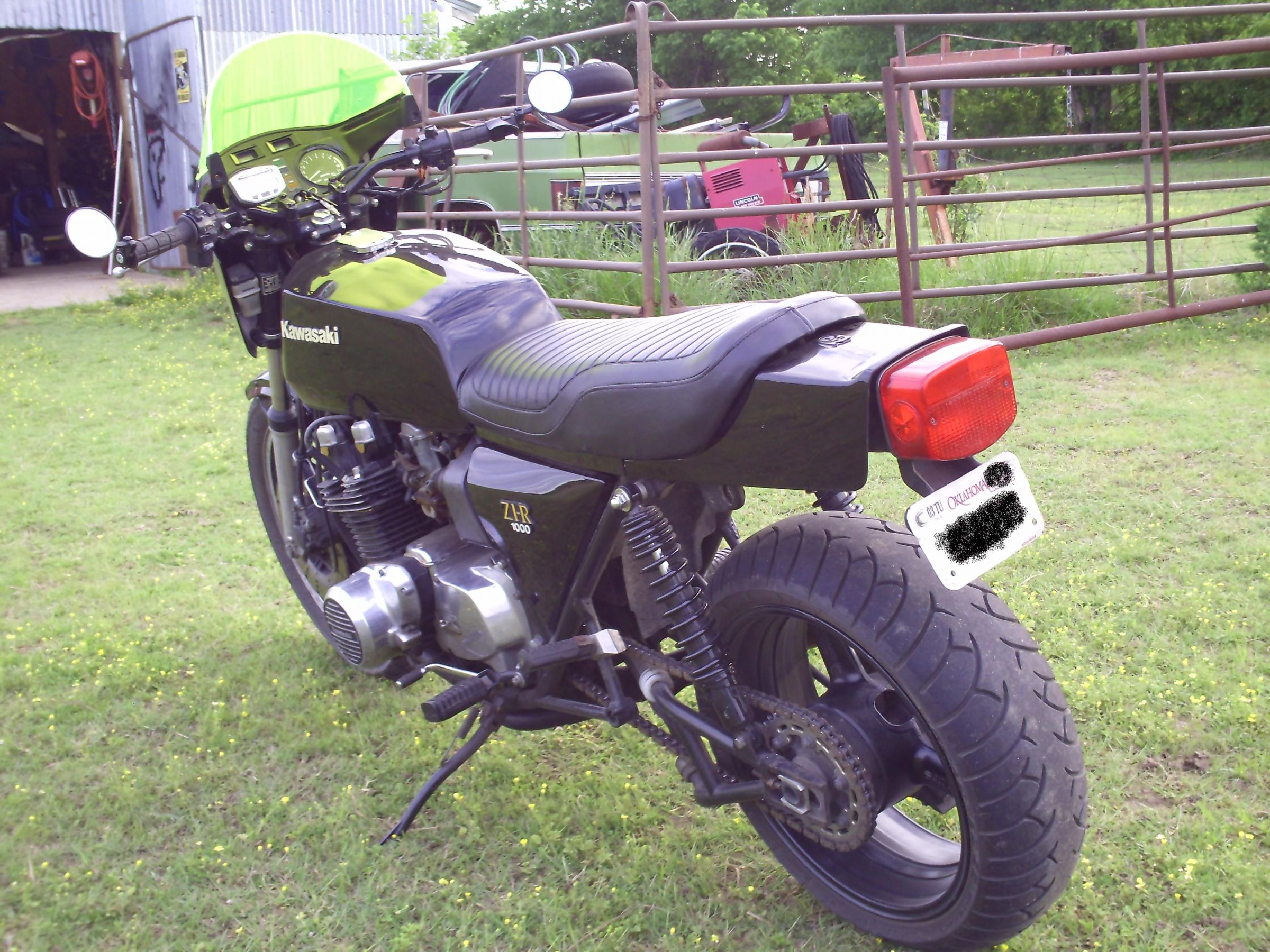

I finally got my seat back and I love the color and look pulse it's super comfy. I used the same come from the original kz550 seat just cut around the edges to fit my fiber glass seat pan

Re: 82 KZ550 LTD cafe racer.
24 Aug 2016 14:56Attachment image-2-3-4-5-6-7-8-9-10-11-12-13-14-15-16-17-18-19-20-21-22-23-24-25-26-27-28-29-30-31-32-33-34-35-36-37-38-39-40-41-42-43-44-45-46-47-48-49-50-51-52-53-54-55-56-57-58-59-60-61-62-63.jpeg not found
Exhaust is next

Don't take this the wrong way, but are your shocks on upside-down? I don't recall ever seeing them mounted with the reservoirs at the bottom.

yeah the way the shocks are adds to the "un-sprung"weight.
which you want "un-sprung"weight to be as low as possible to make the suspensions job as easy as possible .and therefor as good as possible.
love the seat color and the way it lifts in the front and is rolled over the edges.
but,
i wish the cover fit better around the back those lil folds would drive me nuts.it needs to be a nice smooth contour to follow your seat base and body line.you got the body (tank/tail)looking to smooth for that not to be the same.
if you can take it loose from the base around the back and partway forward and let it set in the sun you can set there and slowly stretch it around the base and eliminate those fold creases around the edge and re-attach.
that's my .02 fwiw.
but,
that's my .02 fwiw.

That's a good pointer I was trying to get them to fold back. I put the shocks that way because those certain shocks rub a little on the side of my frame. I'm looking online for a better fit but they are like 500 bucks lol.

If someone could recommend some better shocks that the springs are a little lower, that would help out a lot. As you can see in the pic the tops touch a little

They can't be shimmed out a little? Maybe a thick washer between the mount and the shock?

yeah the bodies of piggy back shock can interfere with the frame sometimes.
like ThatGPzGuy said.
when i built my swingarm on my 80 z1r i had to push my shocks out and machined some nice thick aluminum washers to space them out.
as long as it does not change the angle enough to cause them to bind.
