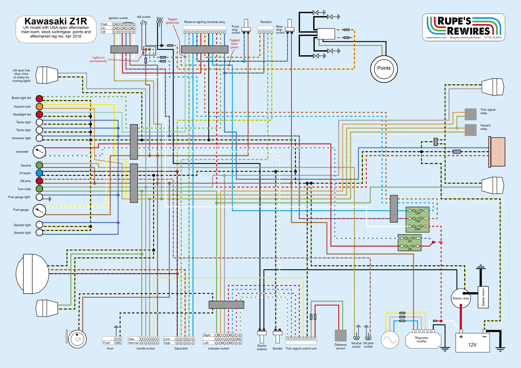

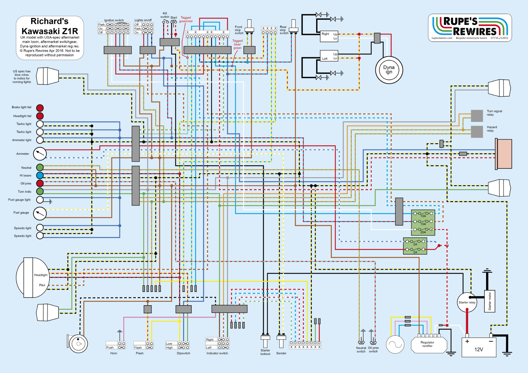

Totally forgot the point of that post! What I was so during does anyone out there have a copy of a D1 wiring diagram that's clear and easy to read? Any help would be greatly appreciated.
  • Scirocco
  • Scirocco's Avatar
  • Premium Member
  • Premium Member
  • Posts: 4420
  • Thanks: 2269
Re: Kiwi Z1R
10 Mar 2019 01:34
#800048
clear and easyto read for you. i hope it helps.
rupesrewires.com/1978-kawasaki-z1r/#prettyPhoto
The following user(s) said Thank You: DOHC, larriken

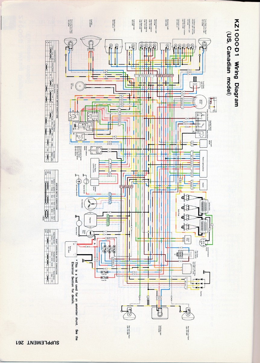

Here is the service manual version just for reference.
My dad's '74 Z1
'00 ZRX1100
The following user(s) said Thank You: larriken

Scirocco wrote: clear and easyto read for you. i hope it helps.
You are an absolute top bloke! Thanks for posting this up. My life just got alot easier.:)

DOHC wrote: Here is the service manual version just for reference.
Really appreciate you posting this up. You also join the top bloke club! :)
