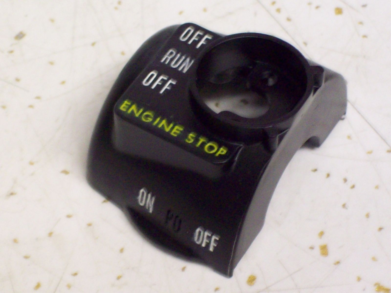

Like Kawboy74 said, model paint works great for the little switch lettering. The tree huggers have made the makers of model paint drop their line of oil-based model paint!!!!! All you can get now is this water-based model paint. I don't know how this new tree hugger paint works on a brush. I tried to use some on a model building I was painting, and it worked like $hit in a air brush!!! Damn tree huggers!!!

25 Nov 2016 23:46Dr. Gamma wrote: Like Kawboy74 said, model paint works great for the little switch lettering. The tree huggers have made the makers of model paint drop their line of oil-based model paint!!!!! All you can get now is this water-based model paint. I don't know how this new tree hugger paint works on a brush. I tried to use some on a model building I was painting, and it worked like $hit in a air brush!!! Damn tree huggers!!!
Nice work! I will have to get down to the local model shop and see what I can find. That's all we had when we built model planes as kids, stinky ol' oil paint!

25 Nov 2016 23:48Kawboy74 wrote: I sand-blasted my switch housings and then painted them. After a good drying spell I used model paint with a tiny needle to drop small amounts of paint into the grooves of the lettering. If I got any with too much paint in them, I took a rag with a dampened varsol spot on it and wiped the top gently, worked great.
Nice job by the way.
David
Thanks David, appreciate your advice. Looking forward to having nice new looking switch gear!

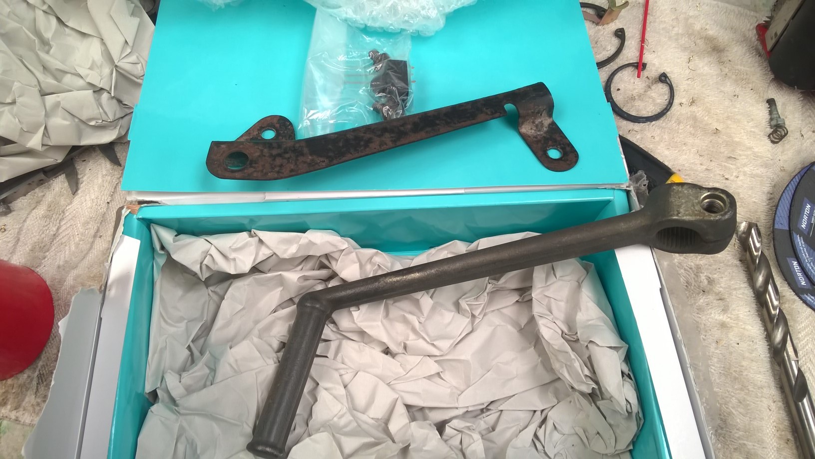

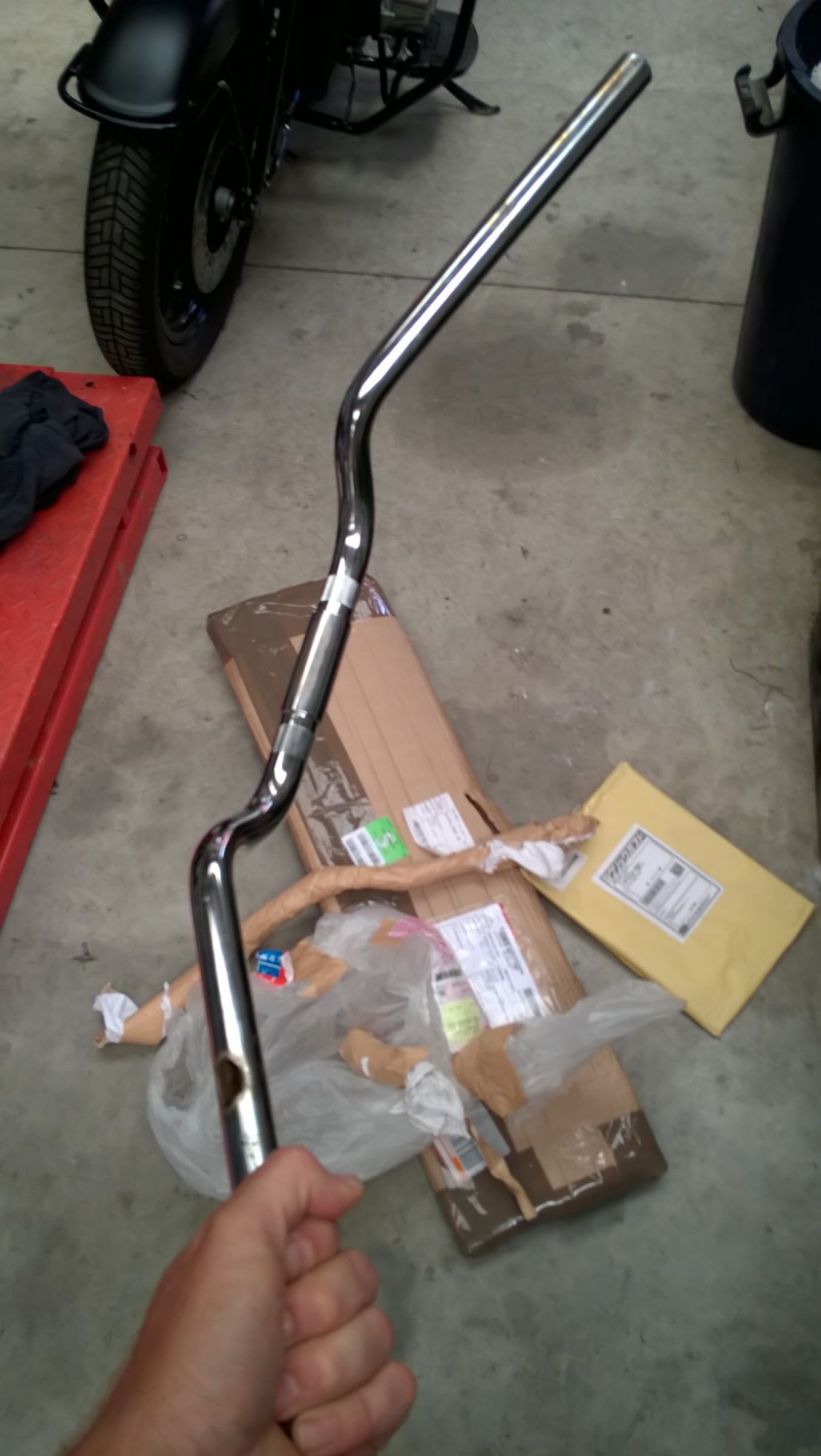

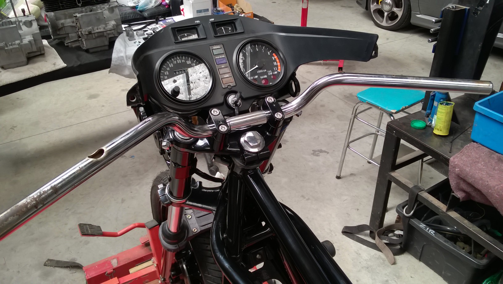

Finally got my mitts on a set of correct bars for the Z1R. Yes, I have been on Yahoo auctions in Japan again.
I would be buggered without Yahoo for picking up all the little bits n bobs that I need that I just can't track down here in New Zealand.

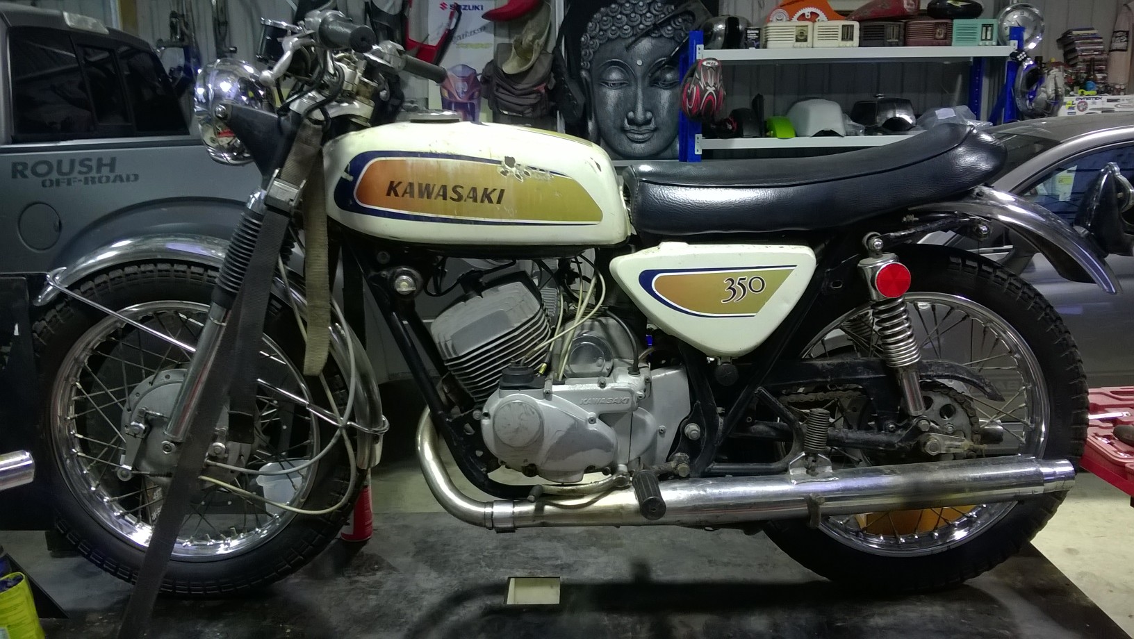

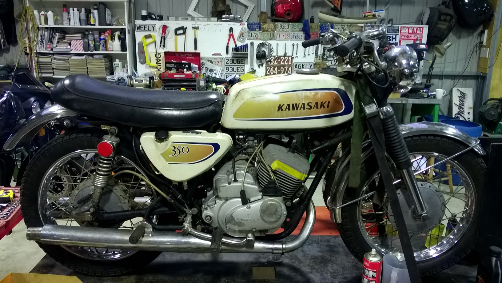

I did buy a 71 Kawasaki Avenger 350 but I am pretty certain that it's not helping get the Zed finished! My kids like it though...

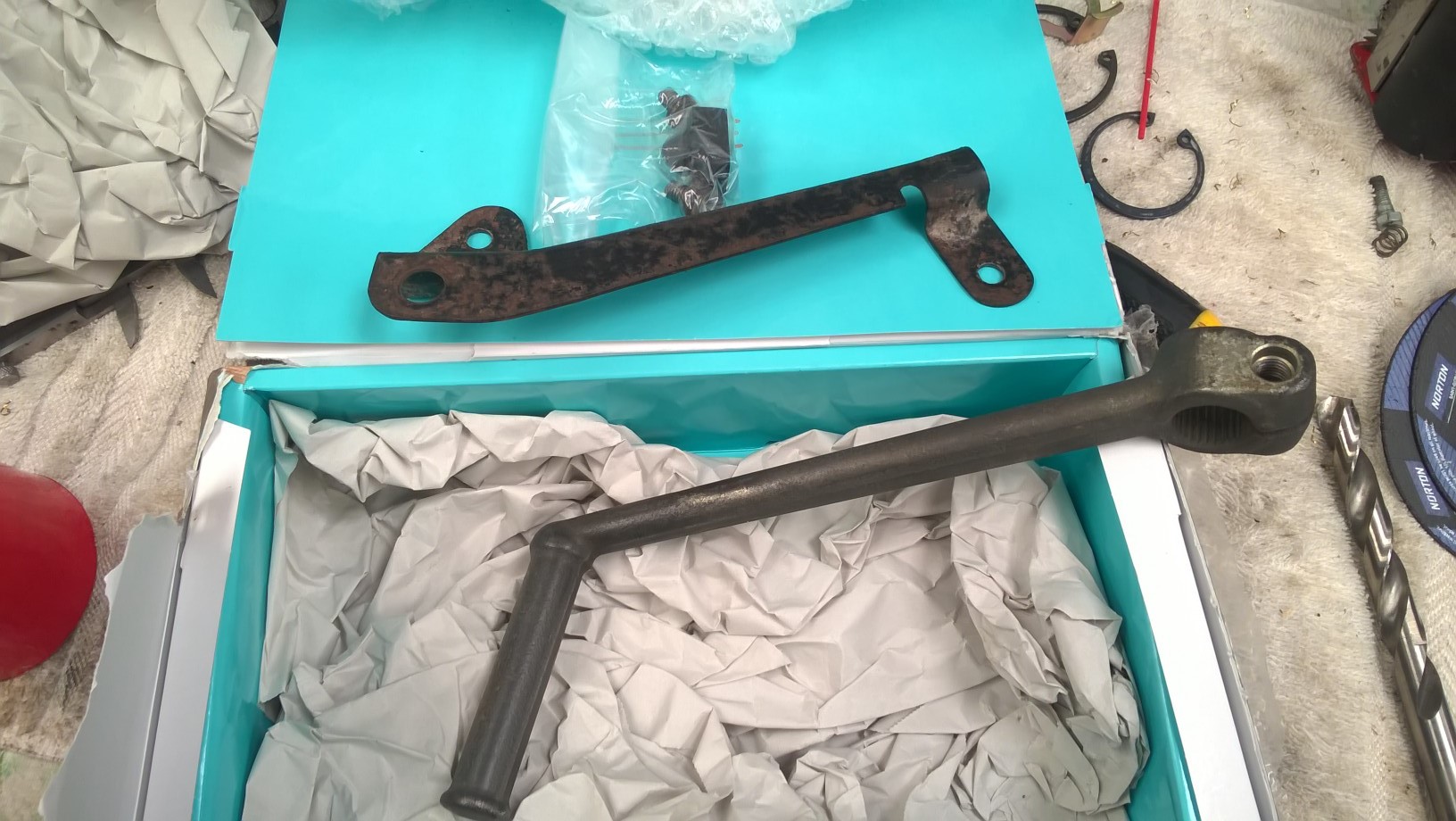

I did have a find a good score from Japan again and finally got a kickstart and the cover for under the seat. You wouldn't believe how long I have been looking for one of these.

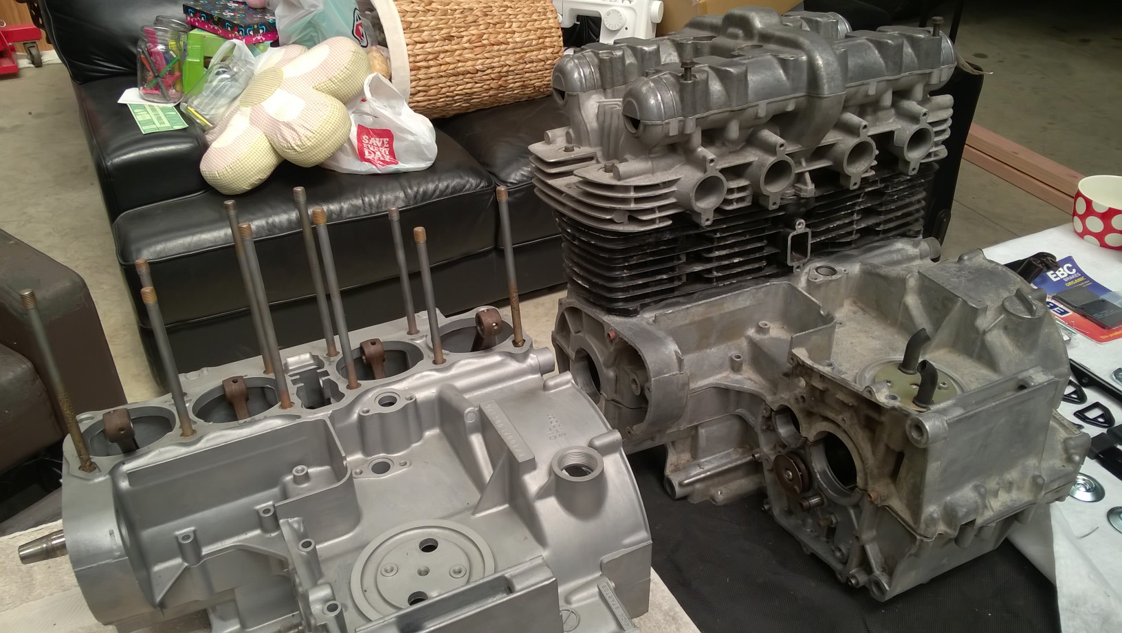

Also started thinking about the motor. Yes, just thinking and working out what I have or more to the point don't have.
Plan to start getting serious on the motor over the next few months. Should be interesting since I am building the motor out of a pile of bits from several different bikes!

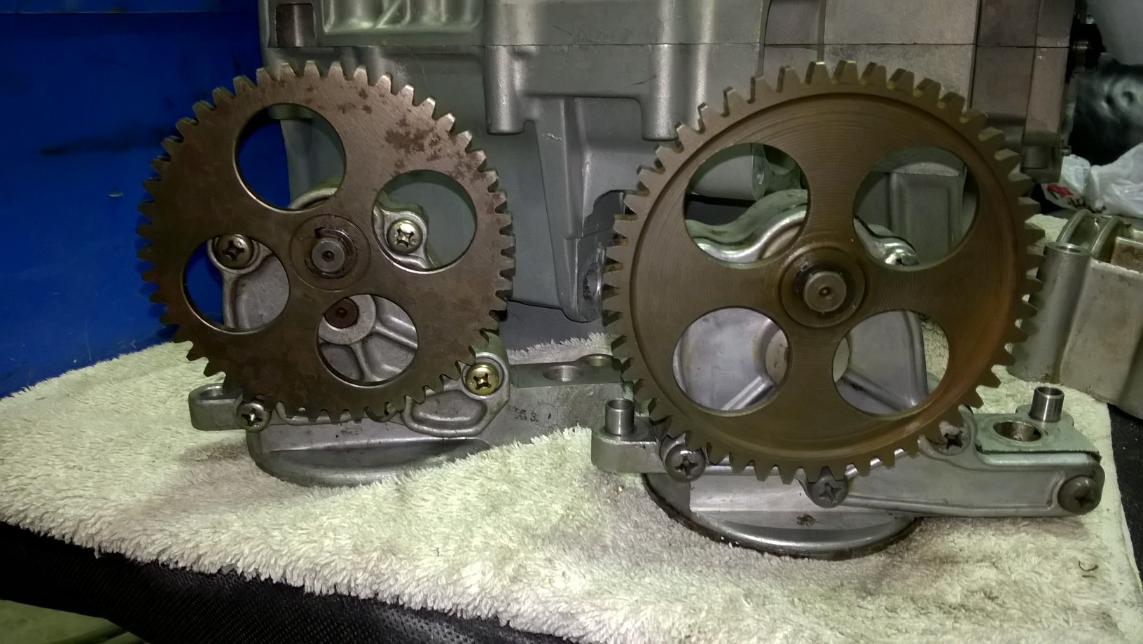

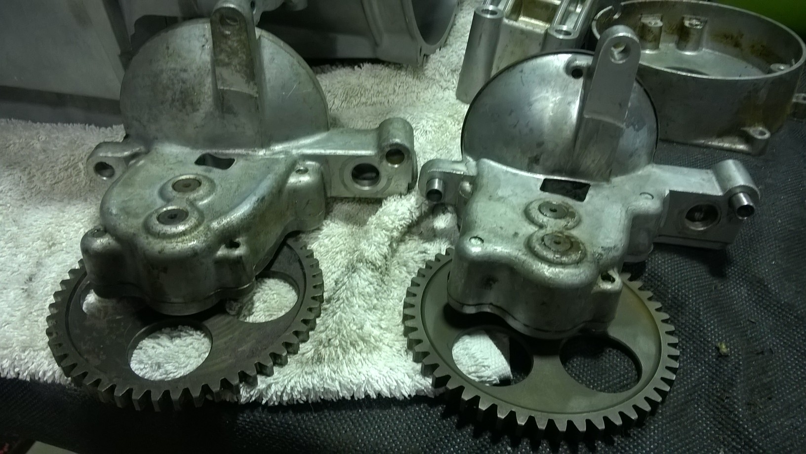

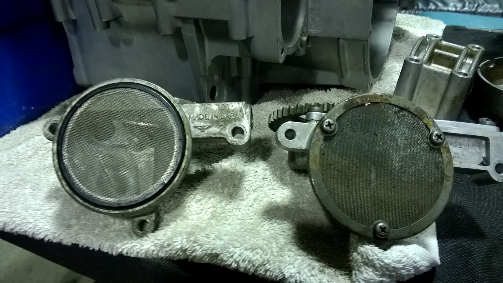

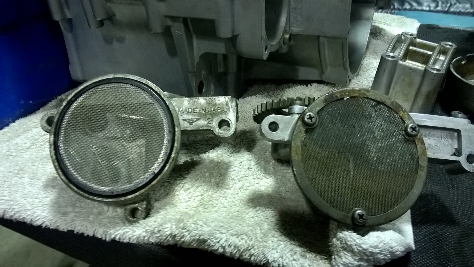

I did discover that I have two oil pumps in my pile of bits. They are both pretty similar but not the same. Does anyone out there have any idea which one is for a Z1000 motor?

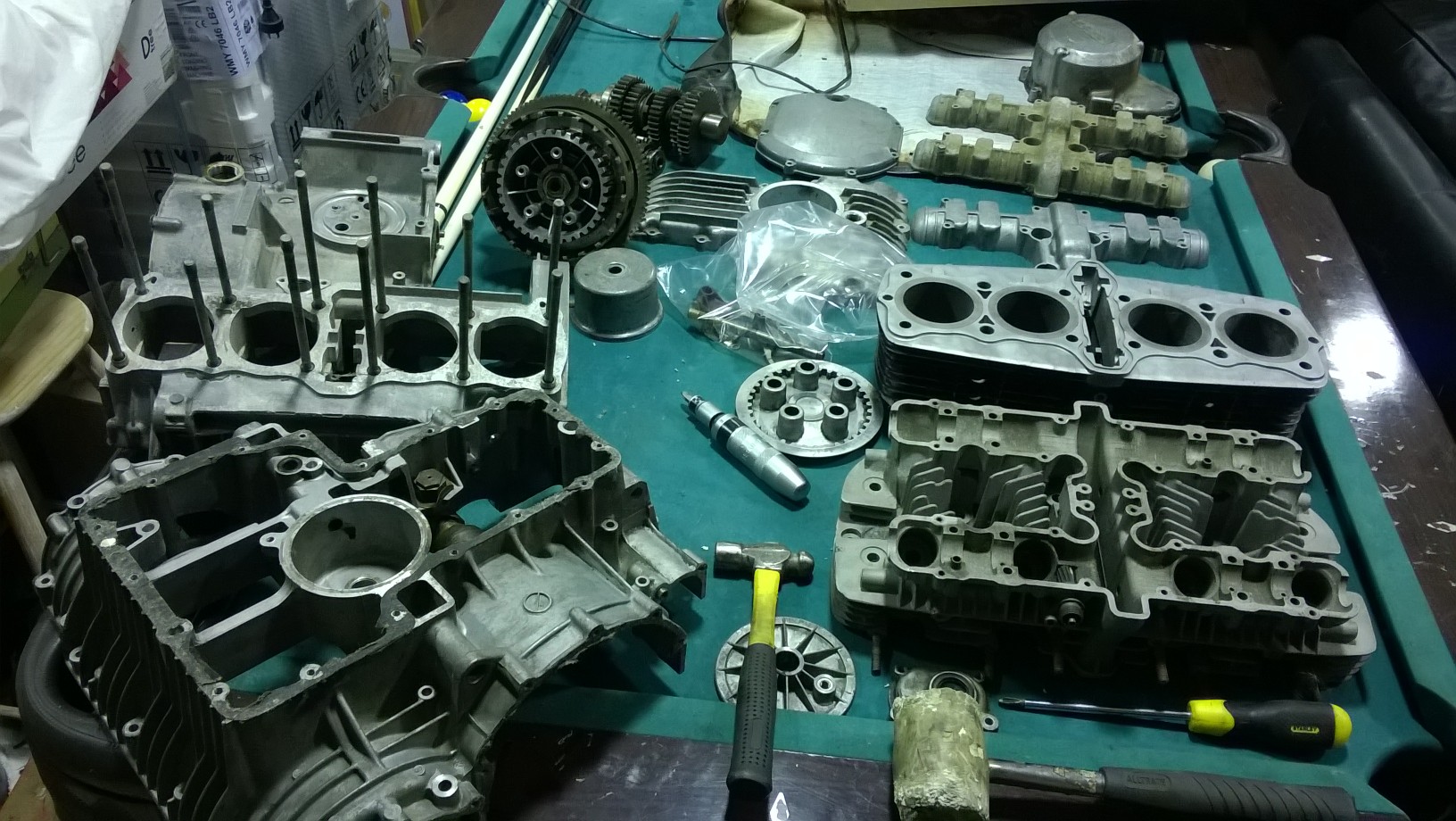

Stuck all my respective bit together to make me feel good lol! It might not have any guts but at least it looks like an engine

The oil pump with the screwed on filter is earlier type for the Z1 units. The later type, that being the 1000 motors had the o-ring attachment of the filter. Check the gears for wear against the housing, there is a tolerance in the manual for it and make sure if you take it apart that you get the gear back on the right way or the gear will hit the screws that hold the halves together at speed. You could use either pump, I would use the one that is tighter for better performance. Also, they take different gaskets if they tear when disassembled.
Good luck.
David
Thanks David, you are a champion! Really appreciate the advice.

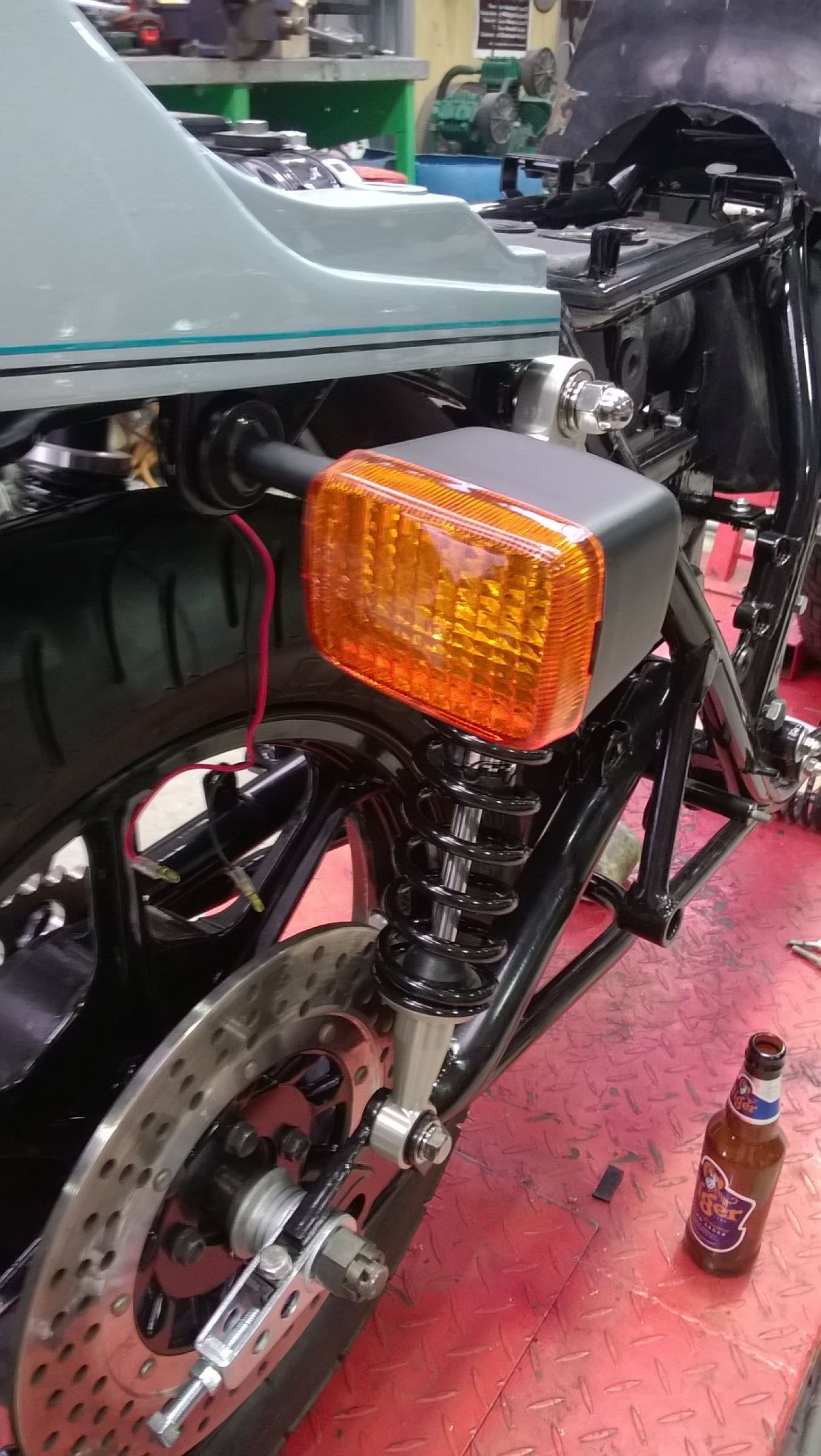

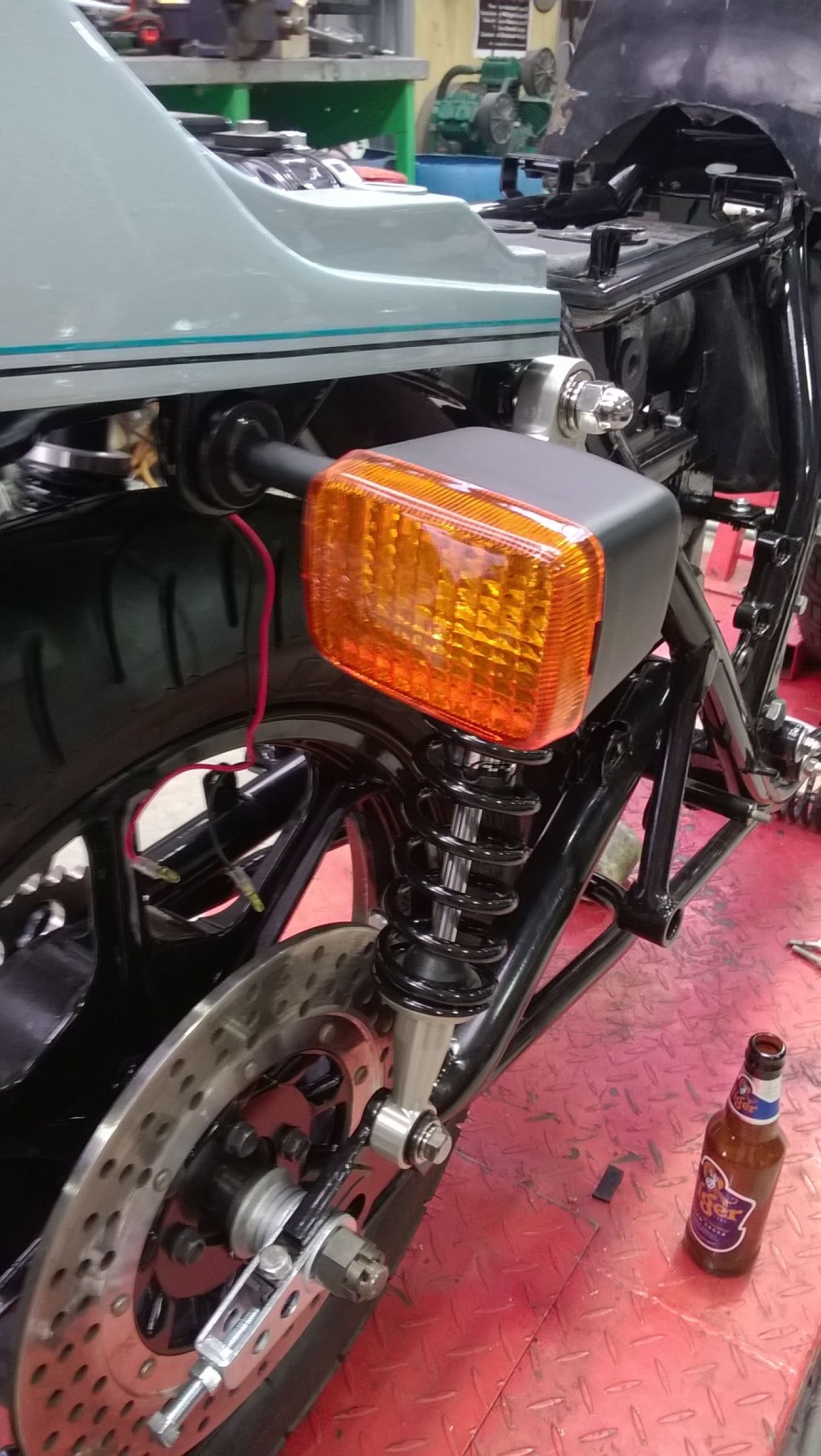

Mmmm decisions, decisions....................... Put on a standard set of turn signals but just not sure if I am going to use the original ones. Maybe something similar in style but a bit smaller. Not sure on this one, will have to keep pondering.

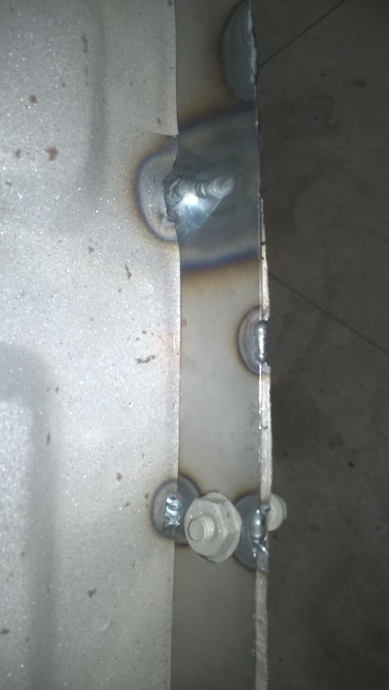

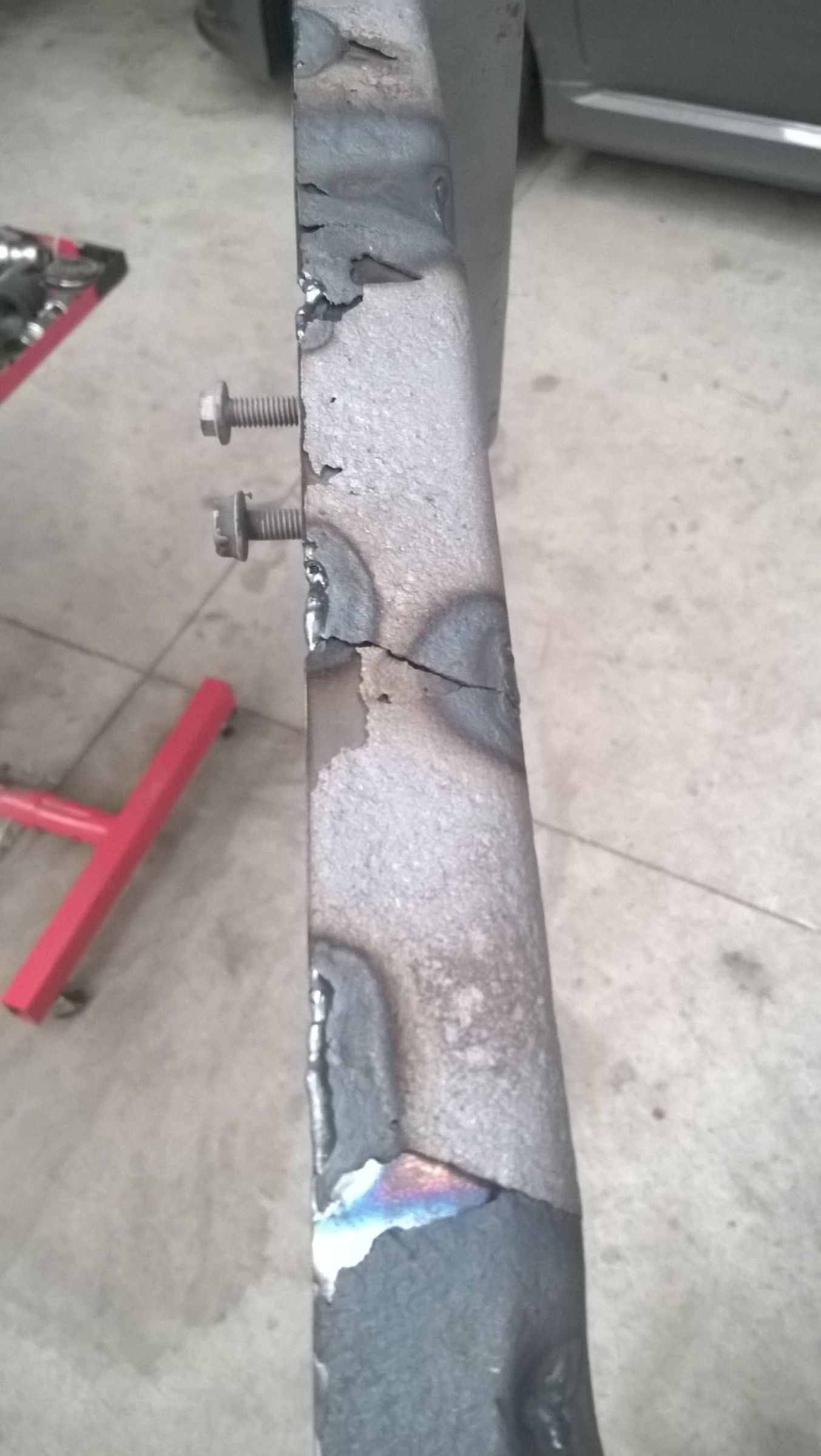

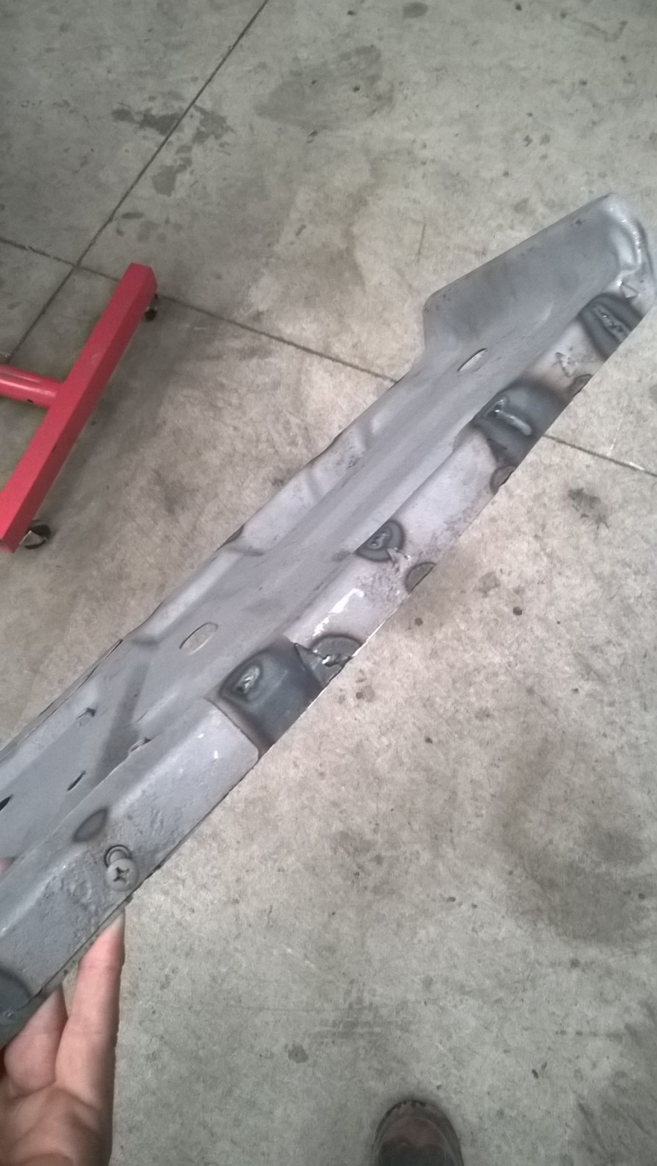

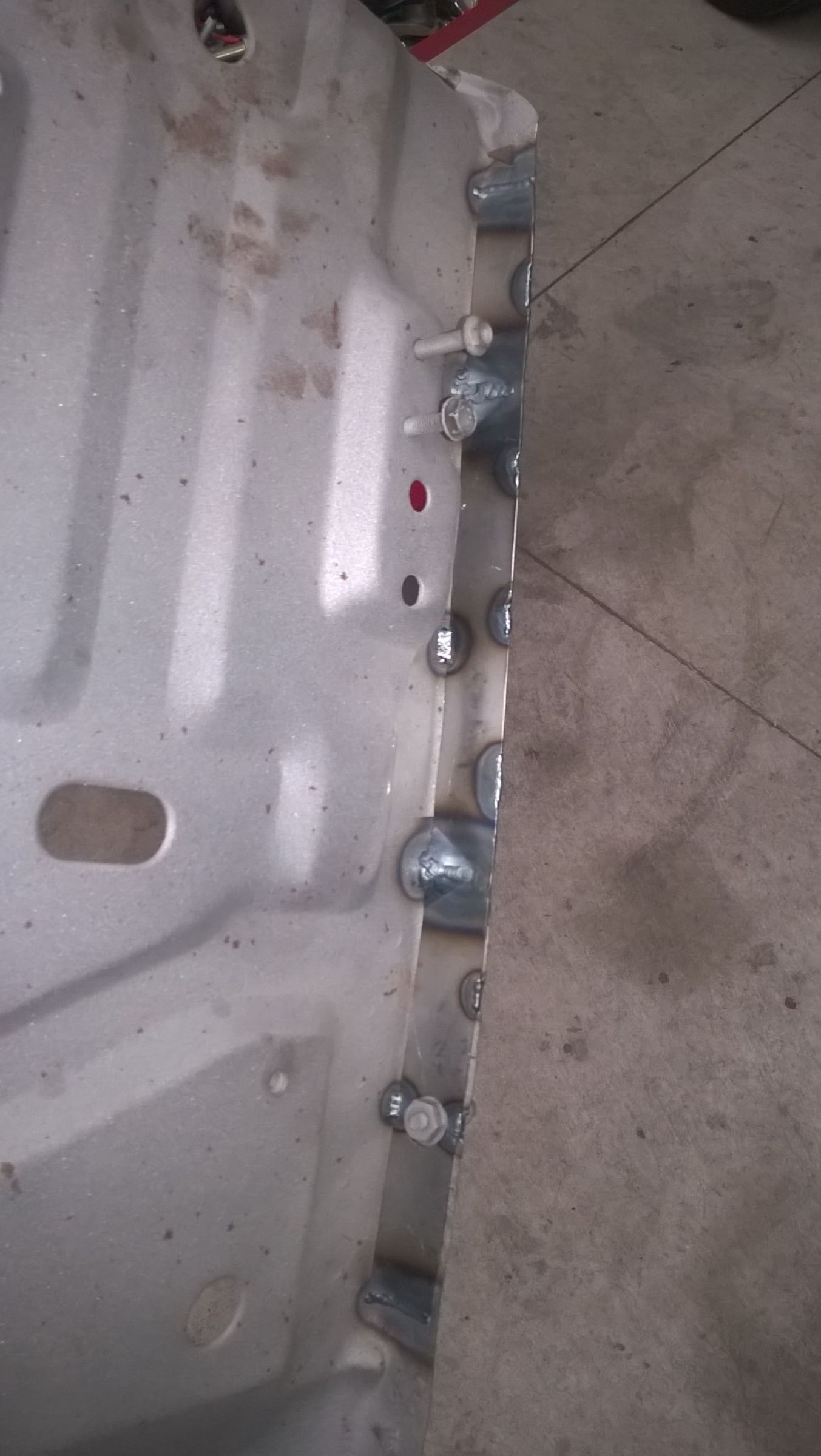

Have also finally got round to getting the seat pan repaired and strengthened at the sides. I decided against doing the repairs myself as I had a feeling my average welding skills might blow the very thin seat pan to bits. Gave it a to a mate of mine and it is now sturdy as and all the rotten bits have a backing bit of steel behind them now. The pan is now ready to be primed and painted and then off to the motor trimmers to be bought back to life again.
