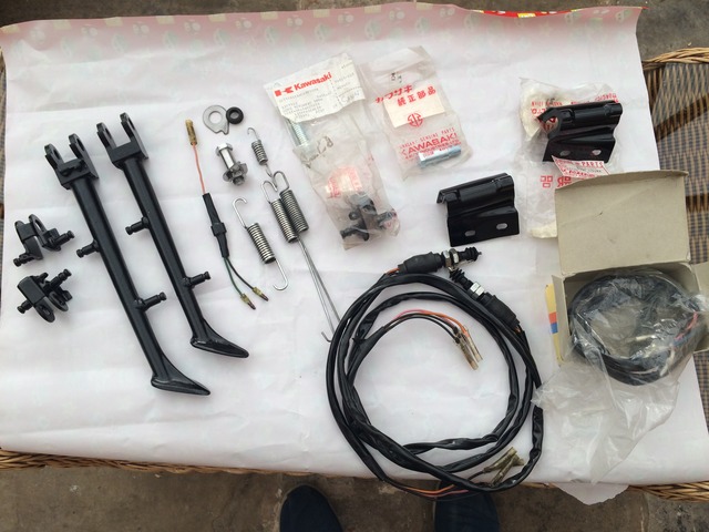

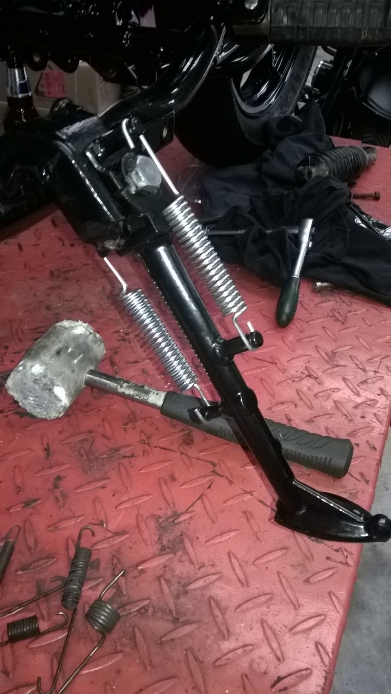

You are going to be sooooooooo impressed with all my hard work today :laugh: Springs finally in and on the side stand. The long spring at the back was the one giving me all the grief as I couldn't find one the right size. Bugger was that this one was to long. No dramas, bit of cutting and bending and hey presto she fits sweet as. Least my bike will stand up now!

i have 4 z1r's and have never seen a kickstand like that. :ohmy:
looks nice tho

02 Nov 2016 11:16Haha I know its an odd setup! This was how the German domestic models came out with the forward mounted stand and double spring. Also had a engine stop on the side stand as well. They wouldn't start if the stand was down. Couple of crap photos but you can kind of see how the stand is mounted. Even have to have a weird bent over gear lever to accommodate the stand set up.

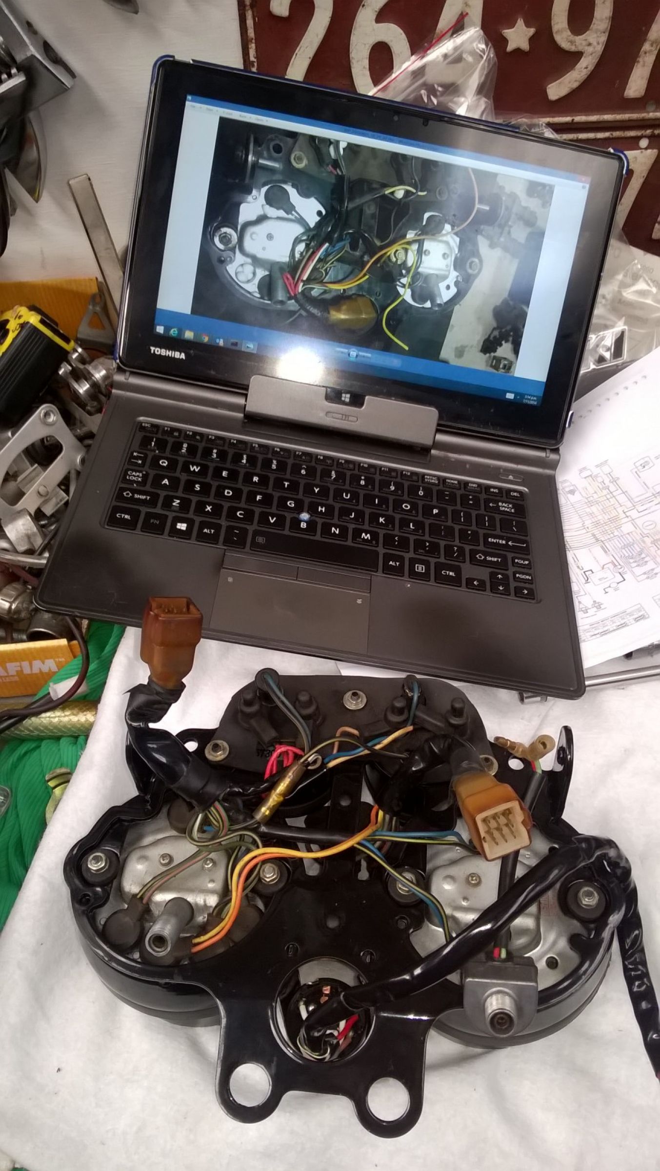

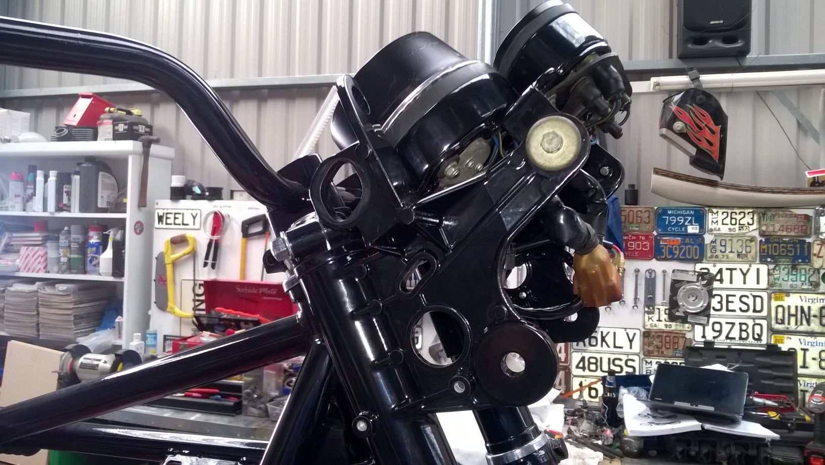

What did we do before phones with cameras! I would be so buggered trying to remember where all the bits n bobs fit back in without the before photos. Probably why I always had bits left over when I used to build bikes pre digital camera! :blush: On a great note though the clocks are now officially attached to the bike, whaaaa farking hooooooooooooo!

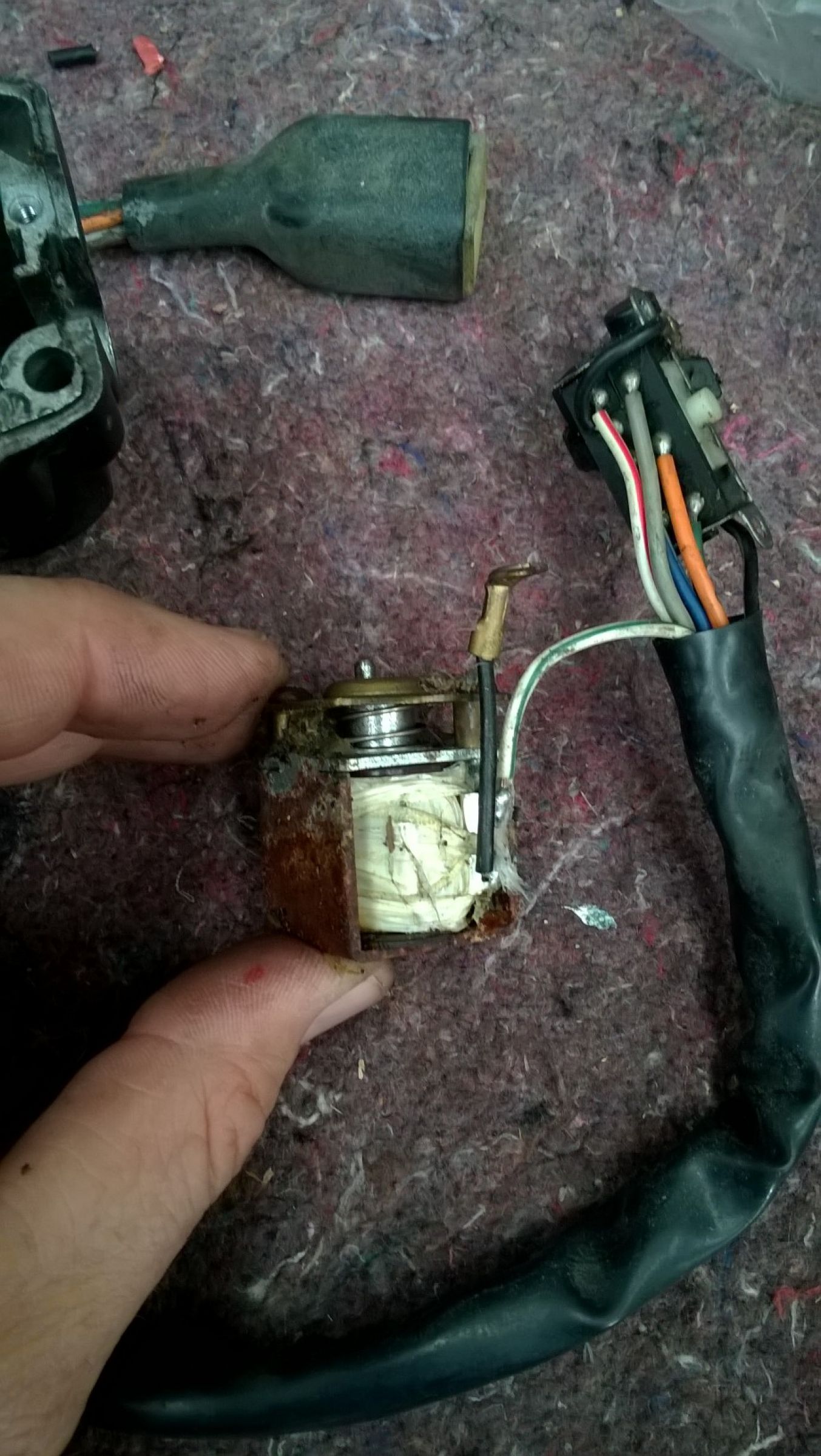

Digging through the boxes and found the old loom and switch gear. Loom is pretty old now and chopped up in a few places. Not sure what I am going to do with it yet, possibly thinking about a new one. We'll see................ Left switch gear is the one that I got from Rimbin and I will restore it as it has the turn signal turny off bit in it and is a "quintessential" part that makes a Z1R (in my opinion anyways). The right is one I got in a box of bits with the frame when I bought it but it looks like it has seen better days. Thinking it will be retired and will order a repop one to replace it.
Not sure how the heck I am going to repaint the words but hey, we'll figure it out.
The heart of the beast, indicators won't turn off without this bad boy. Hope it still works!
