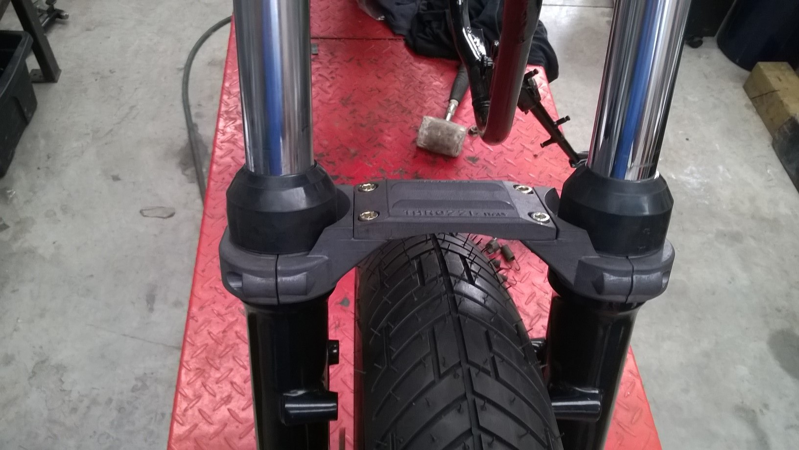

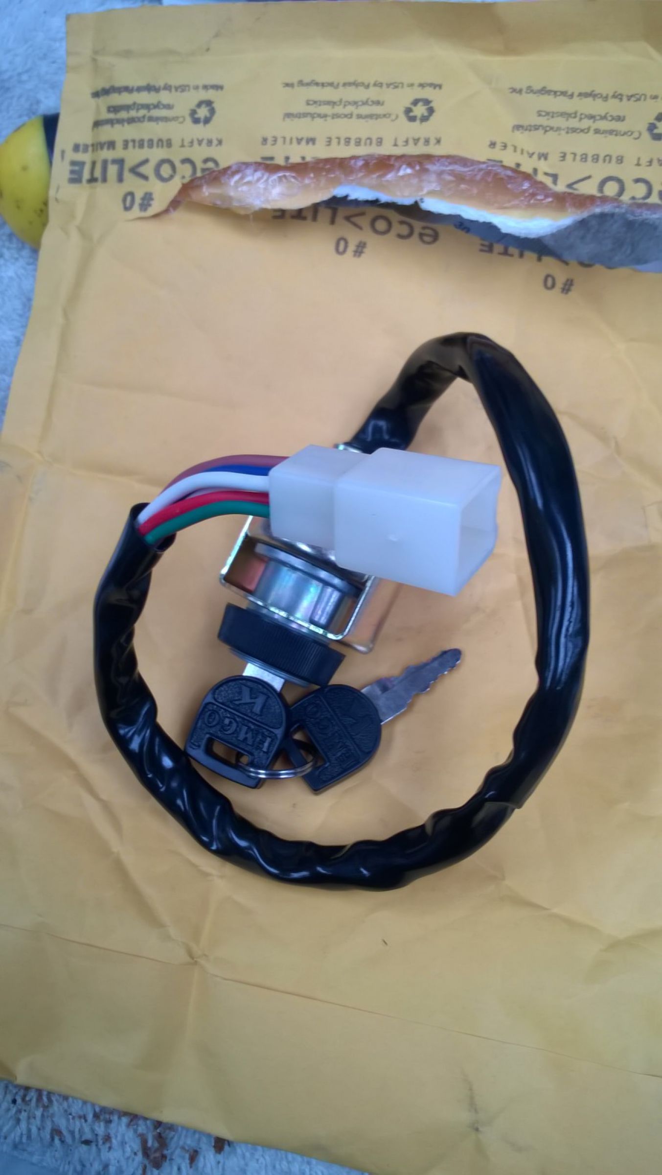

Coolest package I have had so far for the Z1R. Picked this bad boy up from American Classix, really good price too. Couldn't hold on so had to fit it lol!

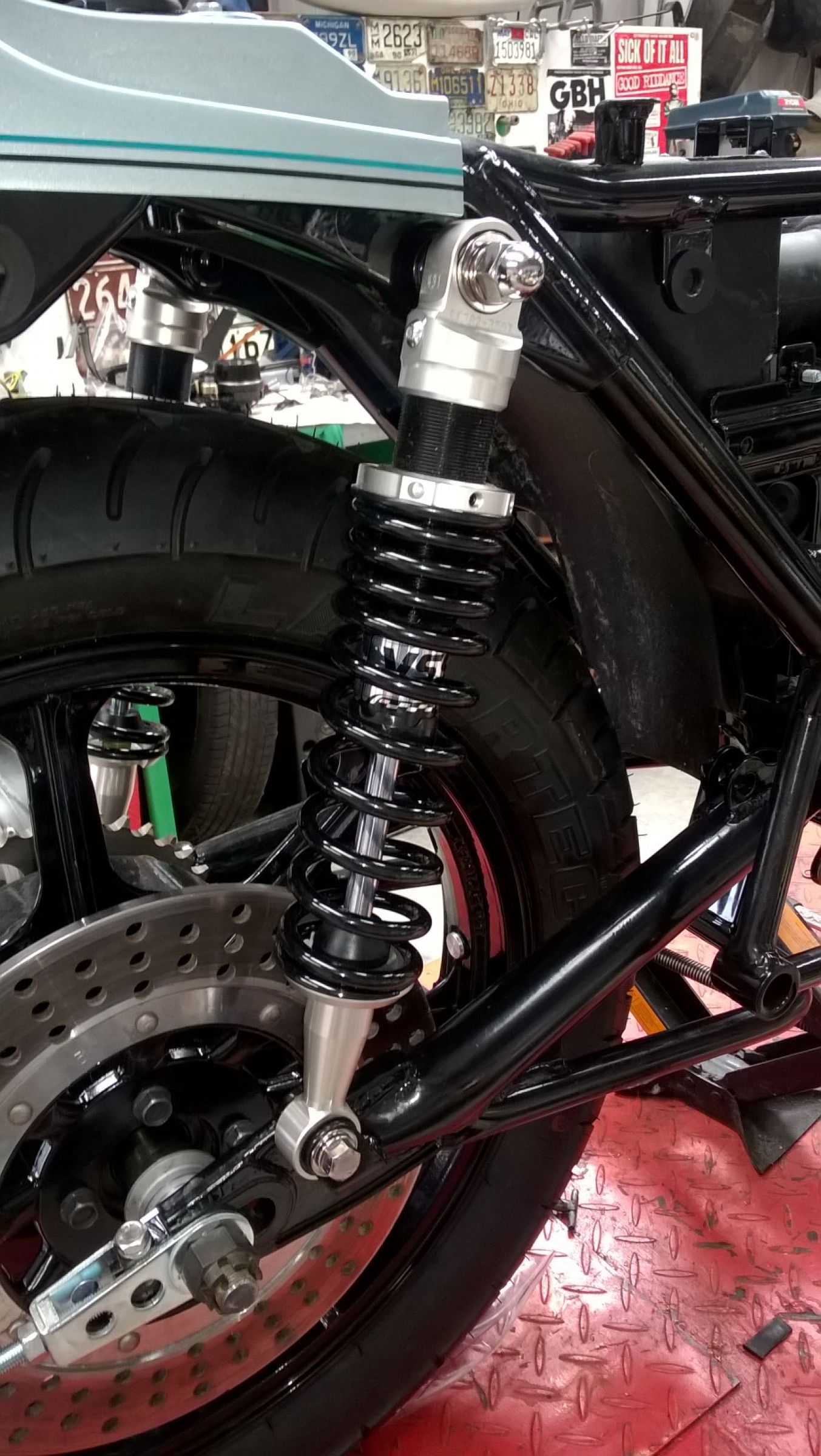

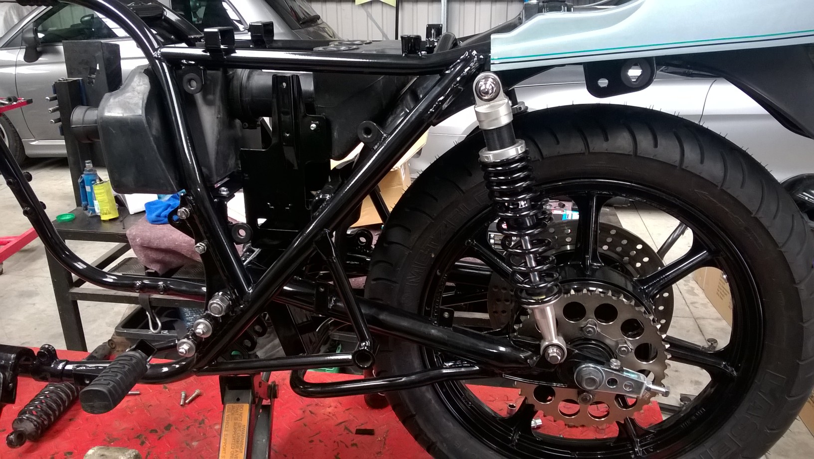

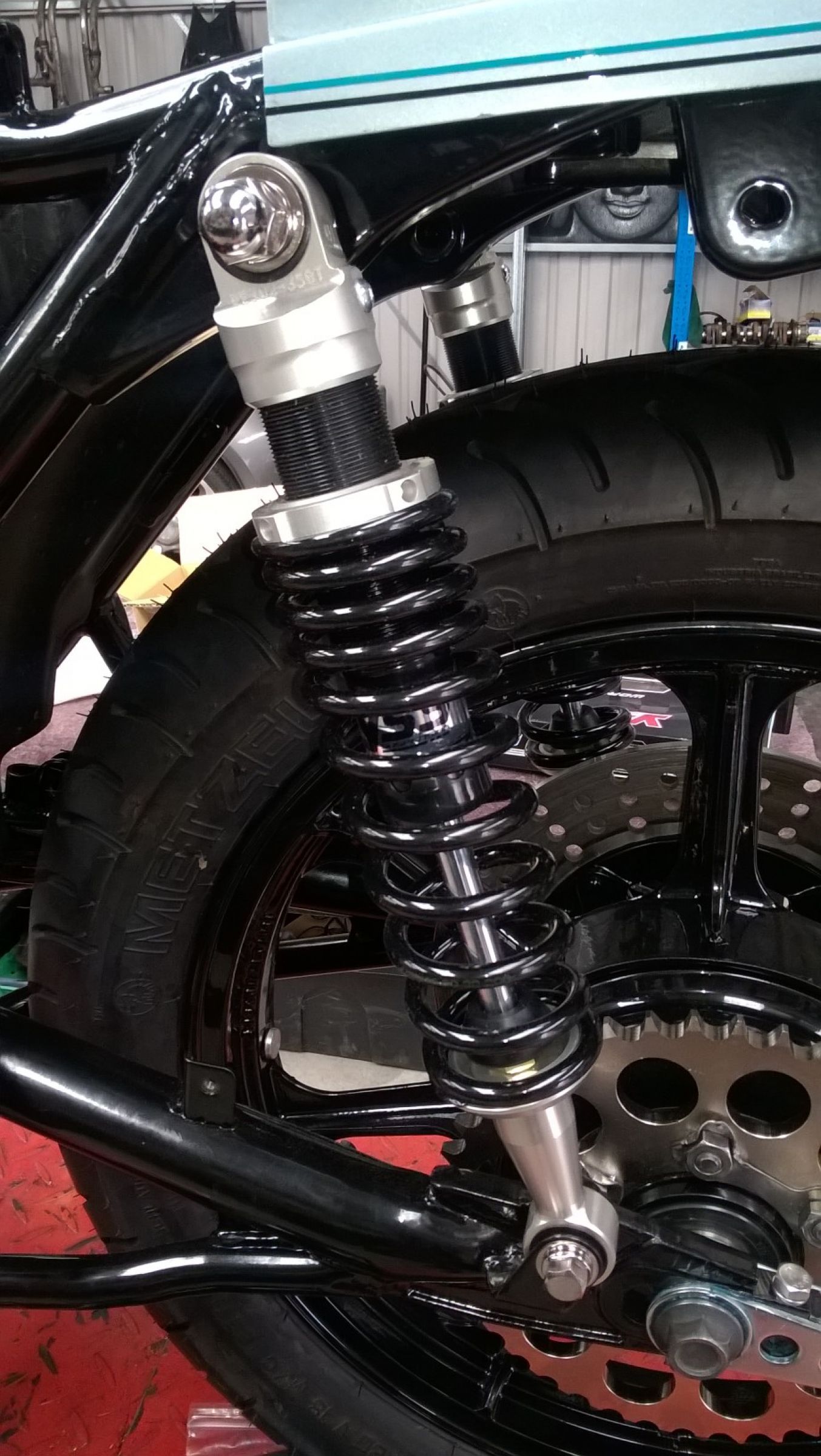

Nothing happens for ages and then bamo! It all starts again with a hiss and and roar and we are on a roll again. I had been pondering for a while about what to use for rear shocks. The originals were stuffed beyond repair and I had visions of a million trillion dollar set of Ohlins taking there place. Then reality set in, or more to the point my budget lol :lol: . I did a bit of research on a reasonable priced set of shocks that would work well and not blow the budget. End result was a set of YSS shocks. Not the top end model unfortunately as I just couldn't afford them so I went with their budget version but I upgraded the spring to accomodate my 100kg's and the Z1R's nearly 300. I bought them from Brooks Suspension in the UK and they arrived really quickly and in piece despite the box looking like a dog had mauled it. First impressions are that they are a nice bit of kit and look well made. Came with lots of spacers to get the correct fit and look nice on too. Just have to wait about ten years for the road test when I finally get the bike going!

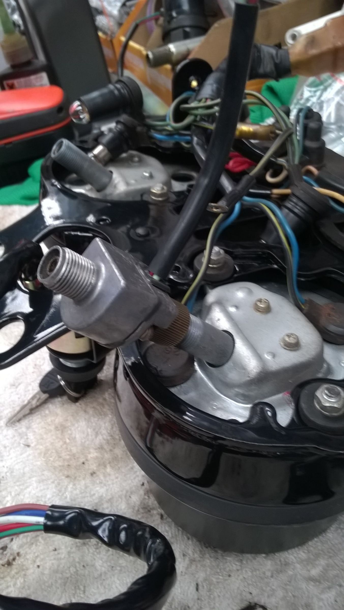

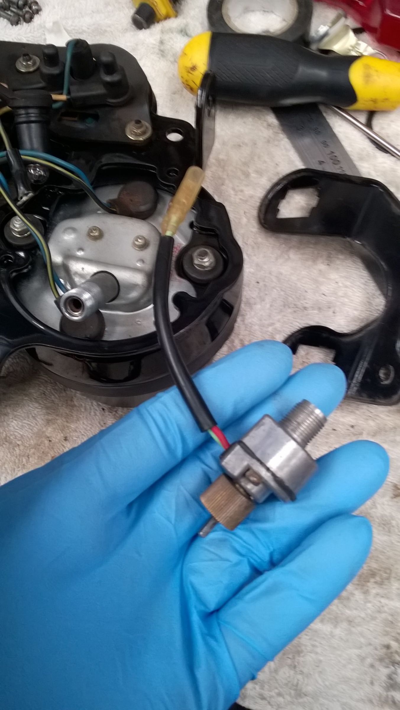

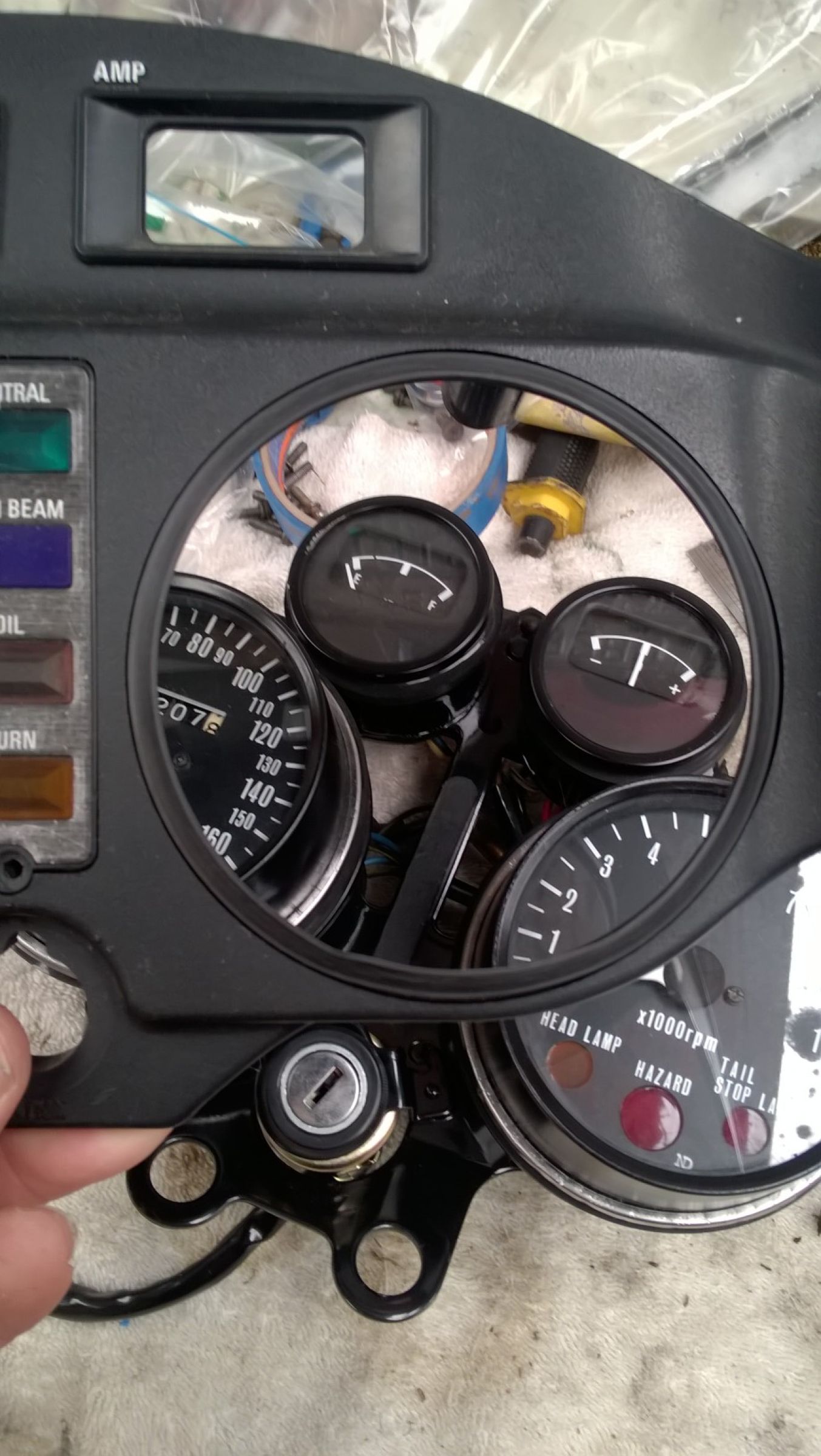

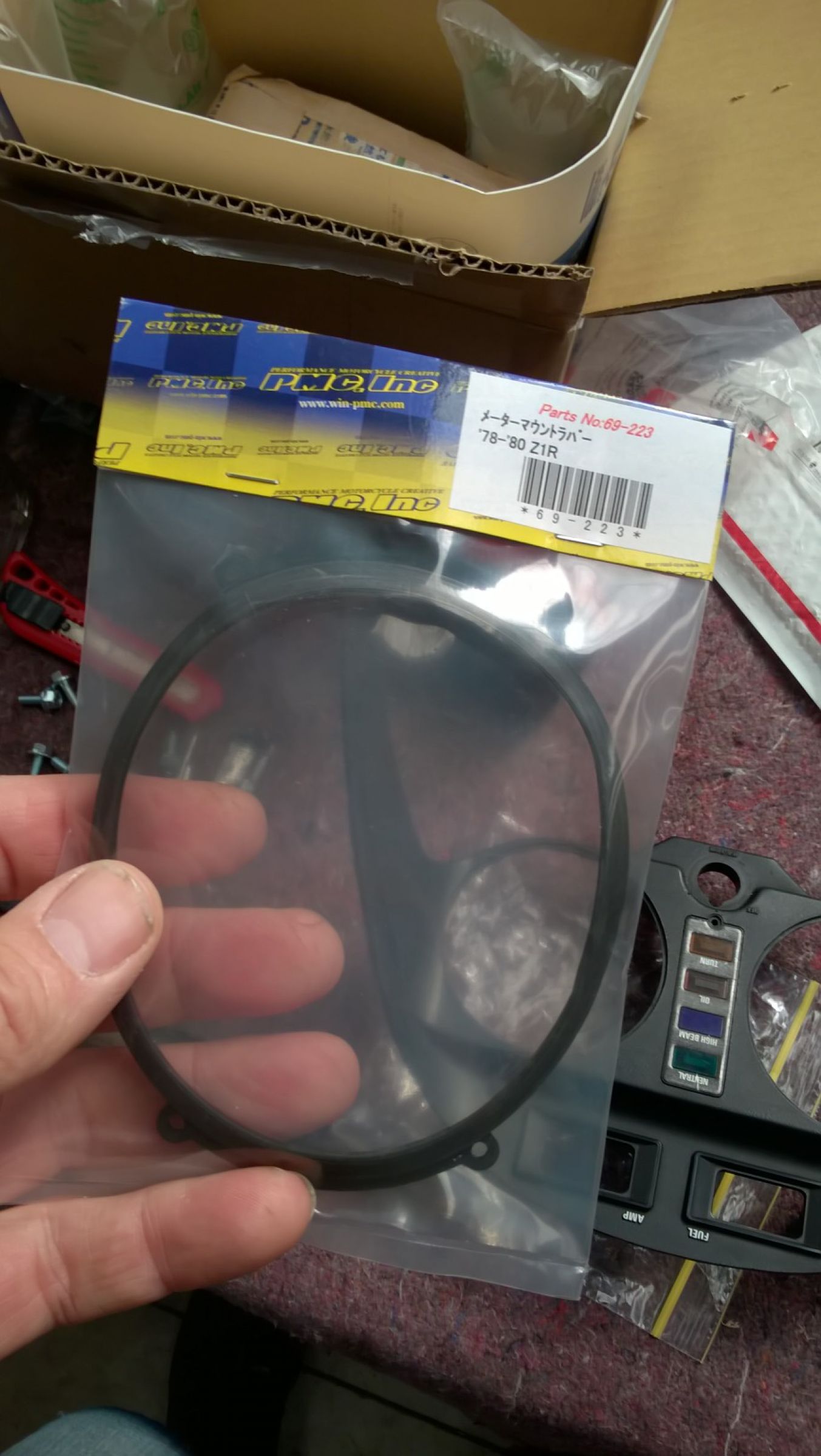

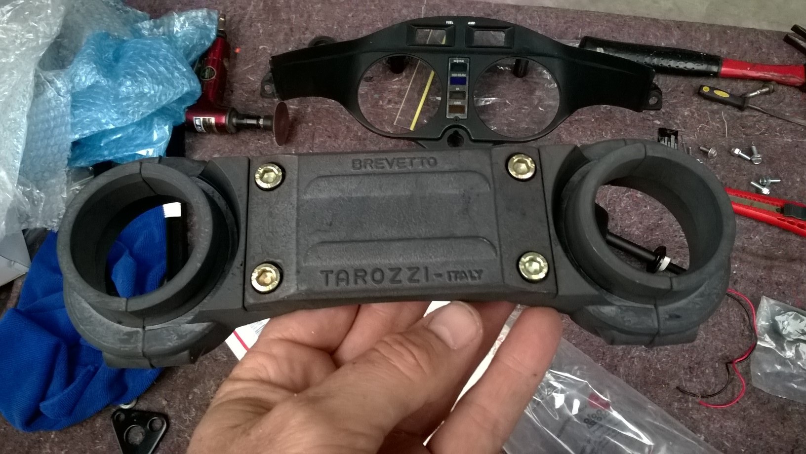

Also picked up a few parts from PMC in Japan. Mainly rubbers and bits n bobs so I can get the clocks and things fitted. Also picked up a new ignition barrel as well. That is this afternoons job to the clocks mounted on the bike. I think I finally have all the correct bits together. Even managed to track down the speedo sensor (last photo) which was a real bonus as I had been having a bit of a major trying to find one.
