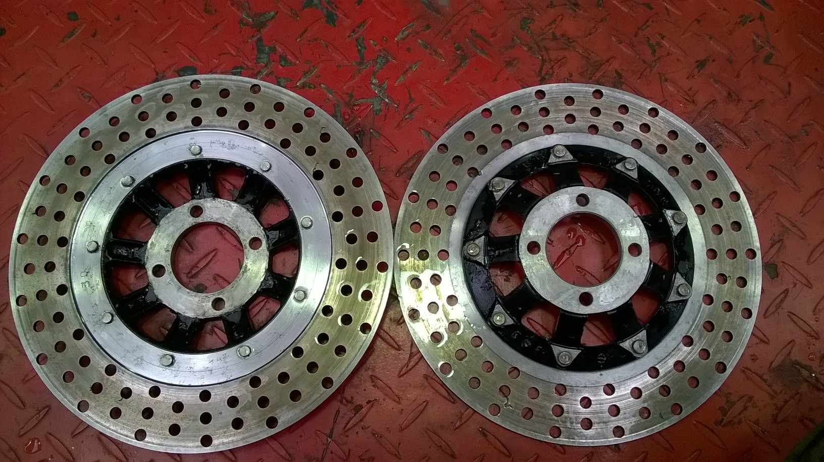

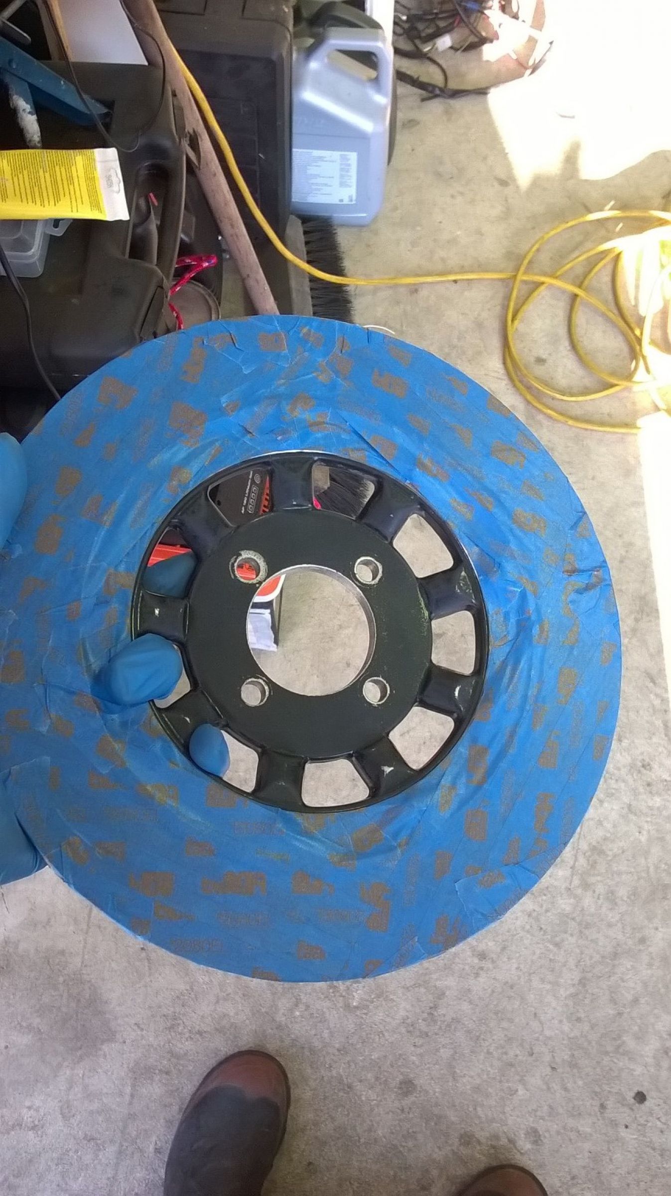

Started sorting out the disc rotors. Attacked the rear one first. Taped, sanded, and painted, then back on the rim. Job's done!
Remember those rusty rotors I scored for the front............................
Here they are now after a bit of scrub and a bit of love. Just need to get the inners sanded tomorrow and get them painted.

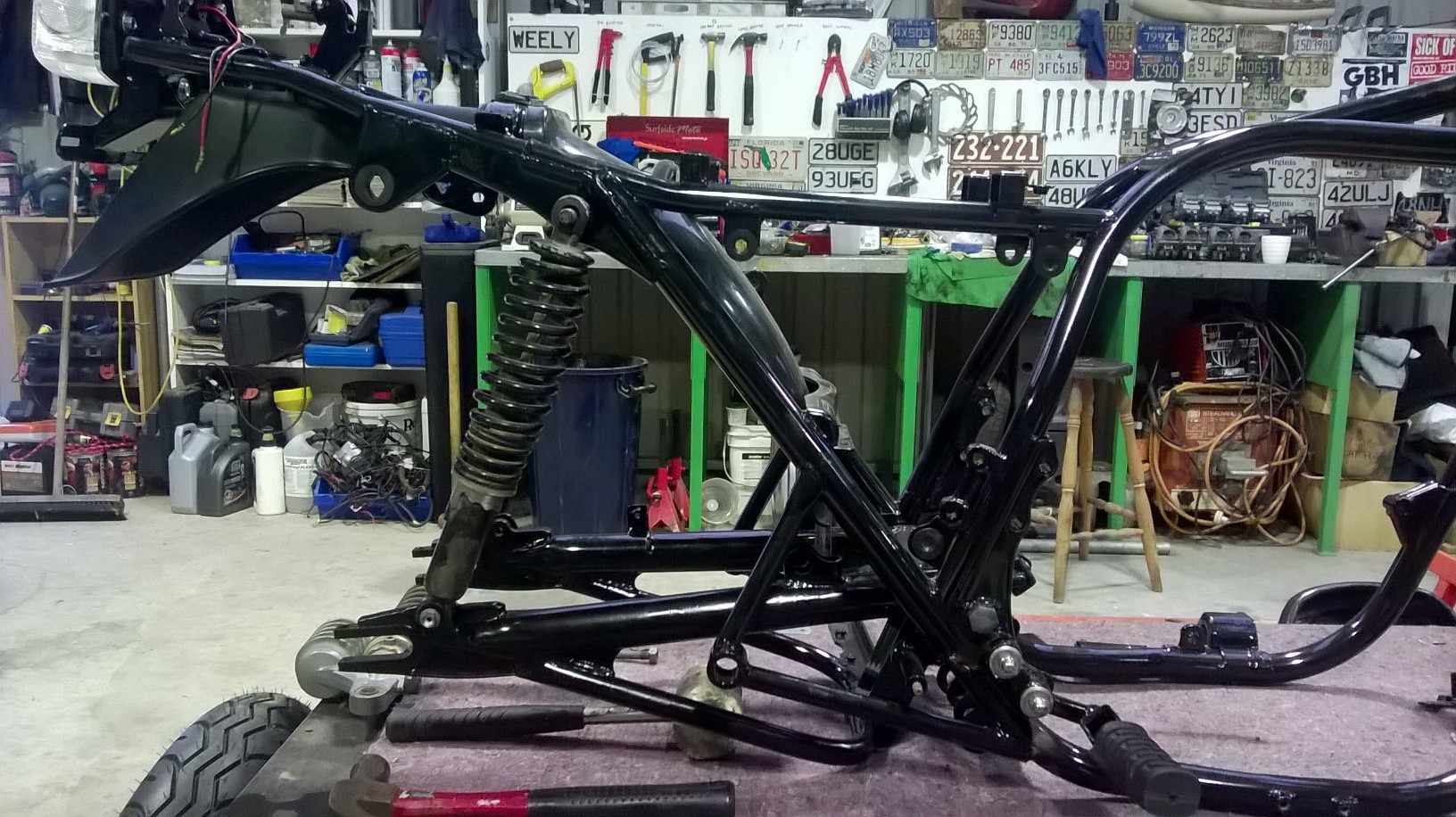

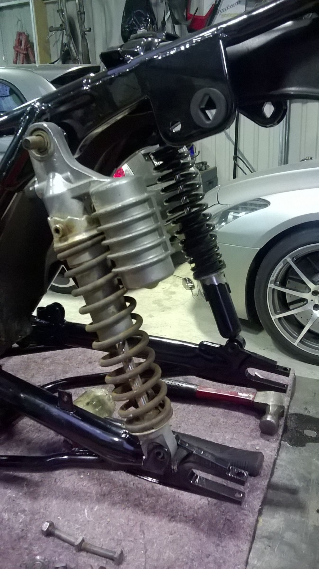

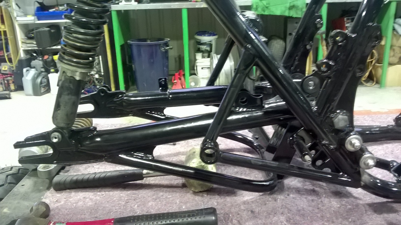

While I was on a role I thought I should get off my arse and fit the swingarm that has been sitting there looking at me for ages. Bam! It's in! Should have done that a while back but just been a bit busy with work and other peoples bikes lol. Have changed my mind about ten times on rear shocks and currently don't have a set. I would still like to go with a piggy back style shock and still pondering the best way to lay down the shocks a bit more but I will keep working on this one.

nice job on the rotors!
they actually grew hair eh? :whistle: :woohoo: good save,or shave as it we're
arm looks good in there.
are you wanting to lay the upper shock mounts forward like the sanctuary guys etc.do?

Still think I will do it by going backwards with a bracket off the rear of the swingarm. Not 100% yet but will get a bit more serious once I have the bike up on wheels.
