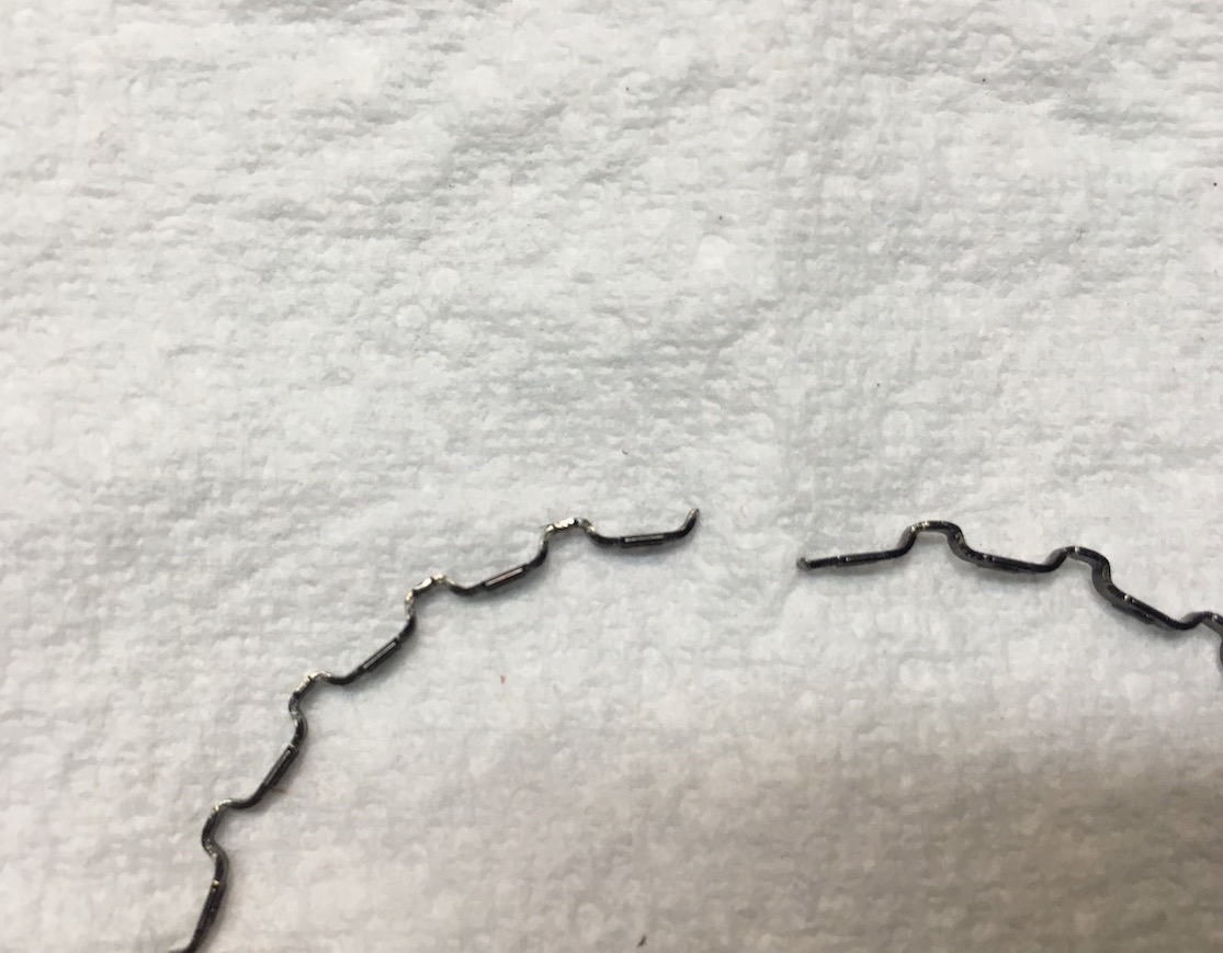

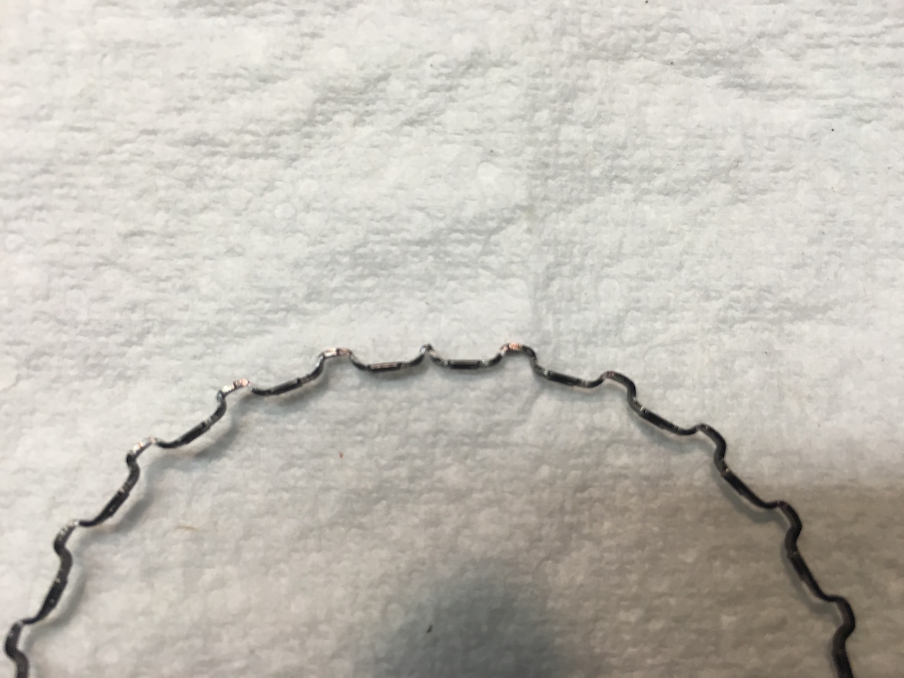

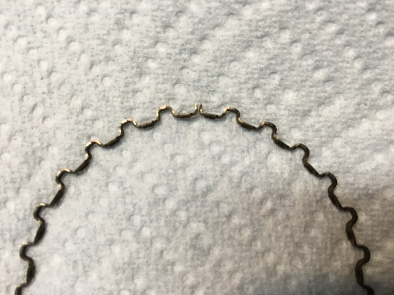

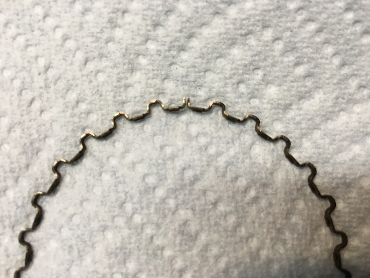

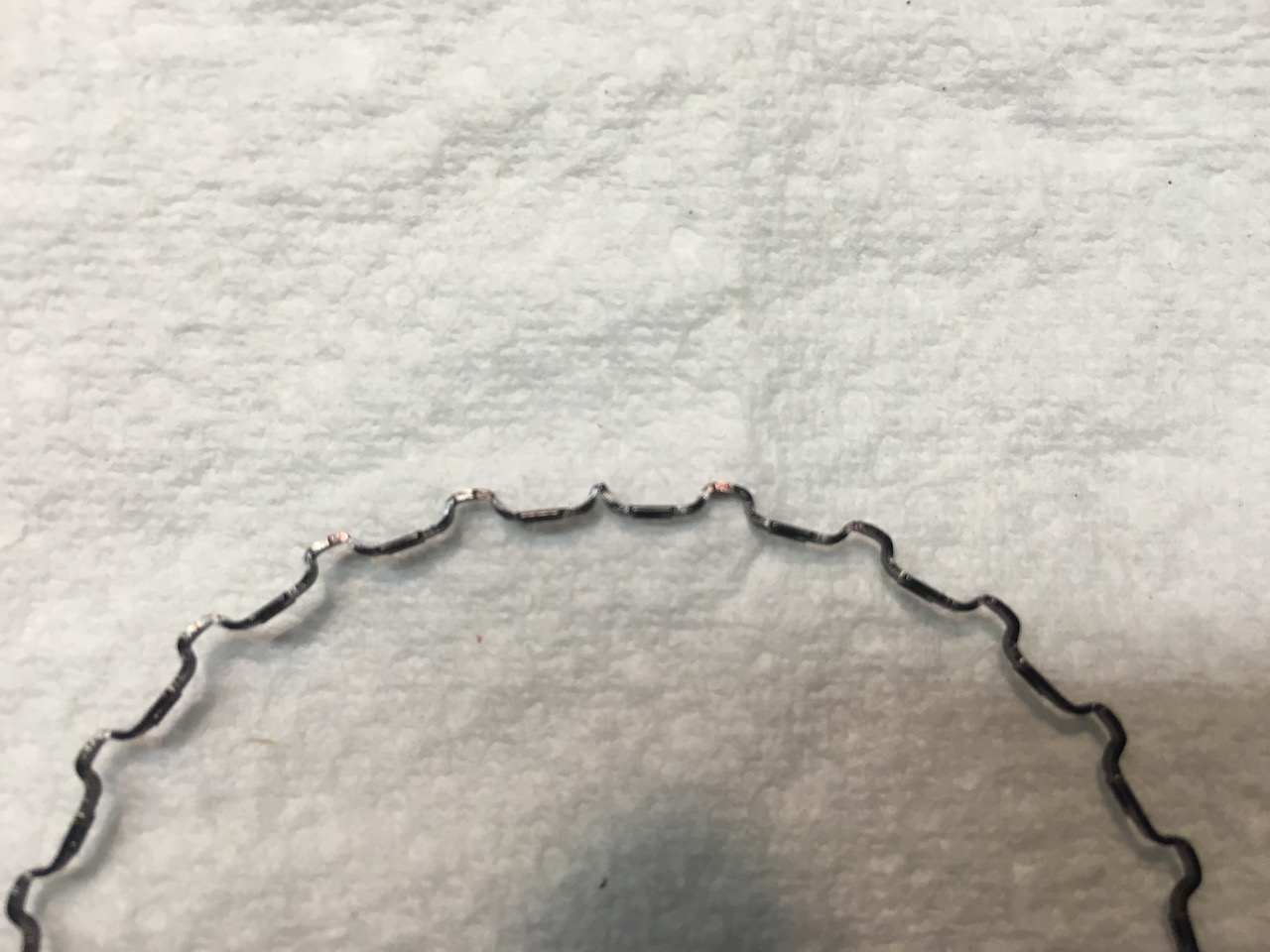

After removing the rings to get a closer look, it turns out not only did the expander ring jump, but part of the little tang had broken off.
Initially I had issues where the ends of the expander ring met where one end was not cut properly and it had sort of an "S" shape and it would not meet up flush with the other end. So I put a file in my vise an proceeded to very carefully file of the end flush. Apparently I was not gentle enough and must be the reason it broke off. So this situation was caused by the ring being defective and me not fixing it properly.
I gave up on the up on the idea of using a different manufacturer of rings as the Cruzinimage pistons use 1mm for the top ring and 1.5mm for the second and 2.5 for the oil scrapers. I could not find another aftermarket set of rings with that combination of ring sizes and in 69mm, so I just bit the bullet and ordered 5 sets Cruzinimage rings so I have enough to replace my current ring issue and have spares for a later date.
Broken ring
How its supposed to look
What the OEM one looks like
Broken ring
