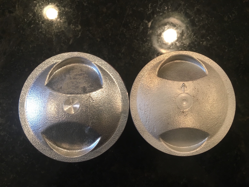

The pistons look very respectable and were packaged very well. No scratches or flashing or sharp edges on the milled areas. They are essentially stock 9.5:1 pistons only 3mm over sized, but with my smaller non-quench chambers I will still have close to 10.5:1 compression.
Compared to the stock 9:1 pistons.

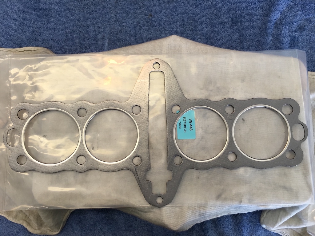

The head gasket is a MLS type that looks identical in construction to the OEM Kawasaki gasket I used on my zr550.

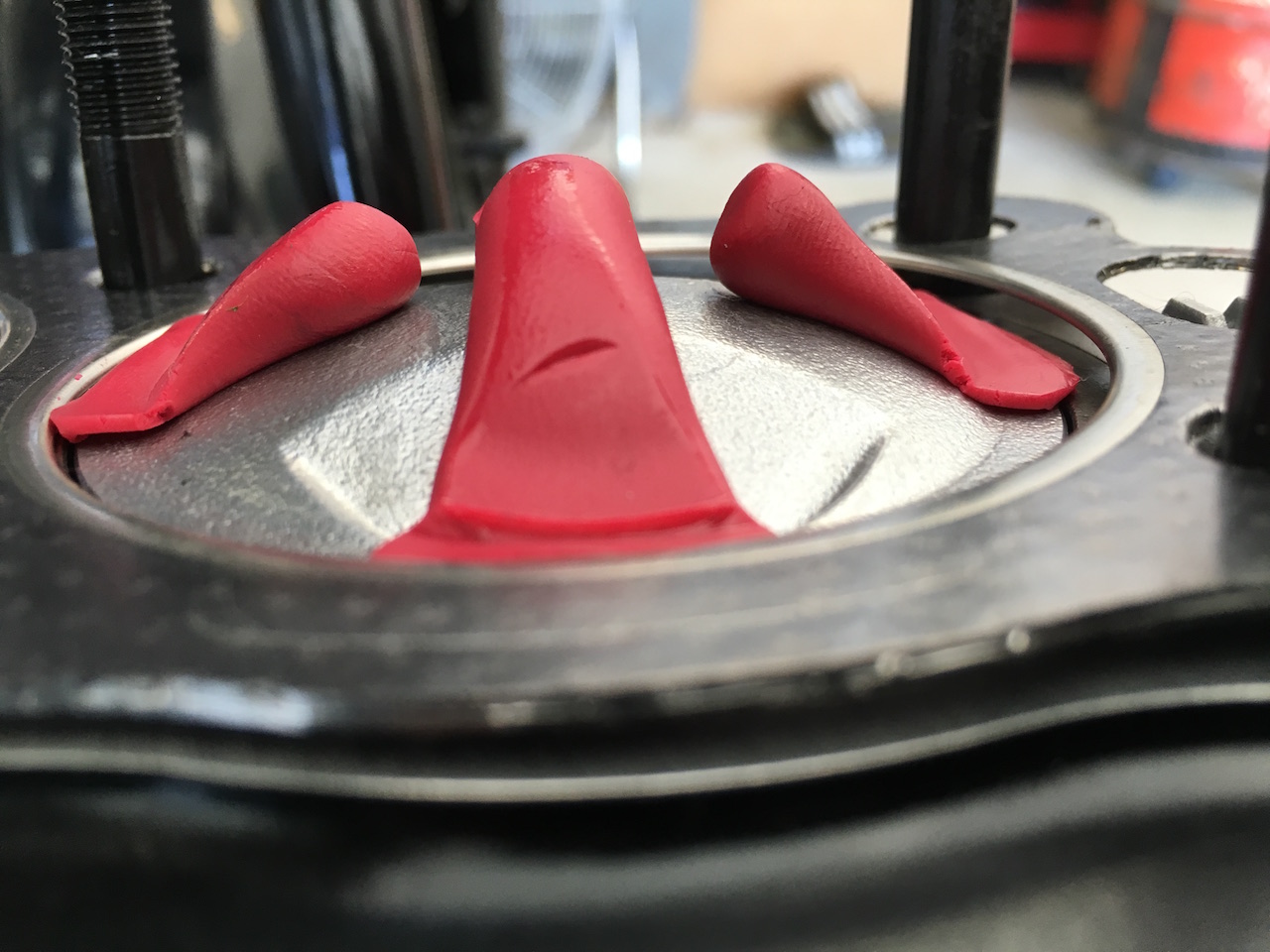

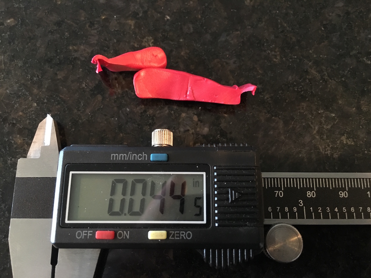

Once that was done, I now had to determine if the pistons would make contact with my non-quench cut head. I had posed the question in a separate thread if using 9.5:1 or 69mm pistons in a non-quench head was possible, but no one was able to deny or confirm if it was possible. So I made some clay strips and placed them in the bores, torqued down the head down and and spun the piston up and over TDC, removed head and measured. Thankfully I have a .044” quench ring clearance and gap between the piston dome and lip of the chamber. The quench ring varies from 7mm wide on the sides to 5mm at the valve pockets which hopefully will help keep down the risk of detonation and help with squish effect mixture circulation.
I’m just relived that nothing collided.
Non-quench cut chambers in question

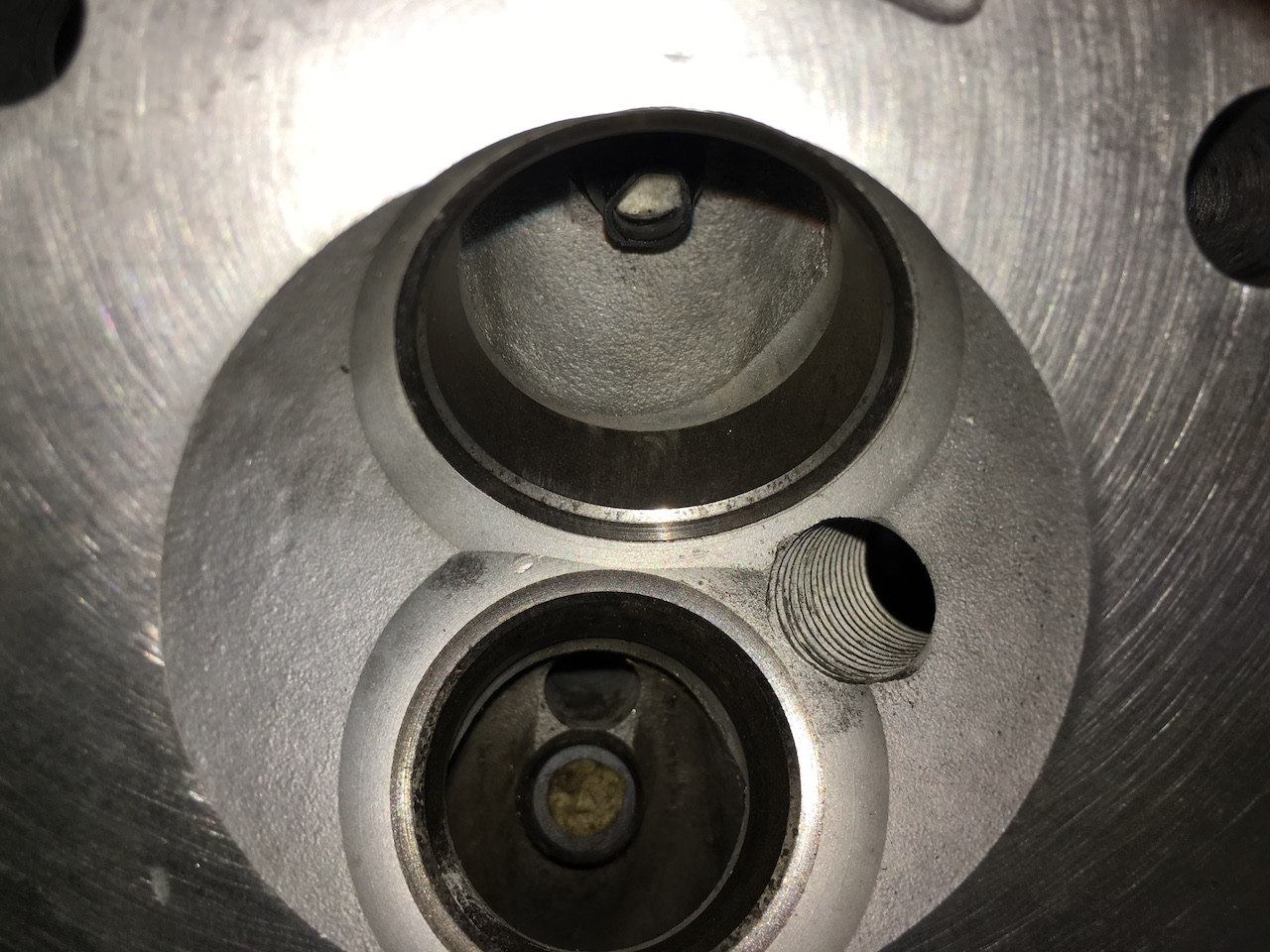

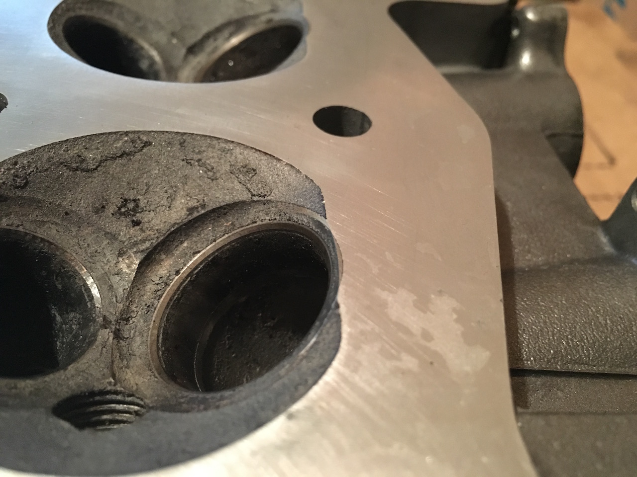

For my head I decided to do a mild porting job to match the inlet and exhaust runners to the valve seats. From the factory, both the intake and exhaust had a massive lip from where the pocket was milled for the valve seat and where the runners started. So my objective was to smooth those out, match the intake boots to the intakes ports and remove casting defects and nothing more. The only significant amount of material removed were the afore mentioned lips at the valve seats.
I seem to have lost the pictures of the exhaust side porting, but it simply looks no different than the intake side. I first practiced on junk head for a couple of days before I had the confidence to start for real on my good one.
Example picture of lip under valve seats in all of the ports
After lip removal
Matched intake ports

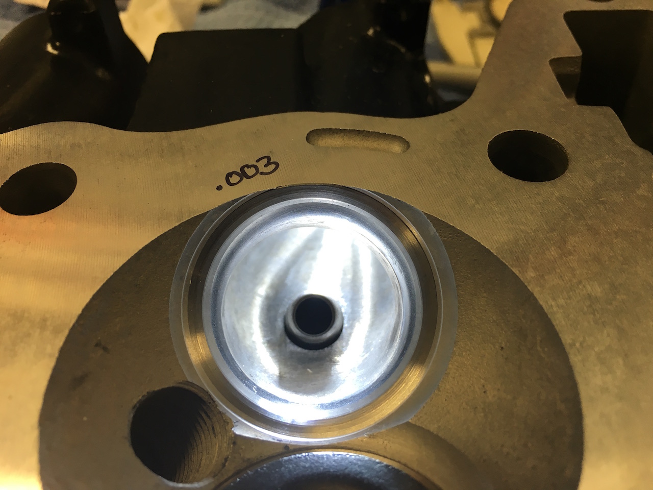

I had to have both the head and cylinder block milled flat roughly .003” each, and you can see that even that small amount of material removed cut into the exhaust valve seat.

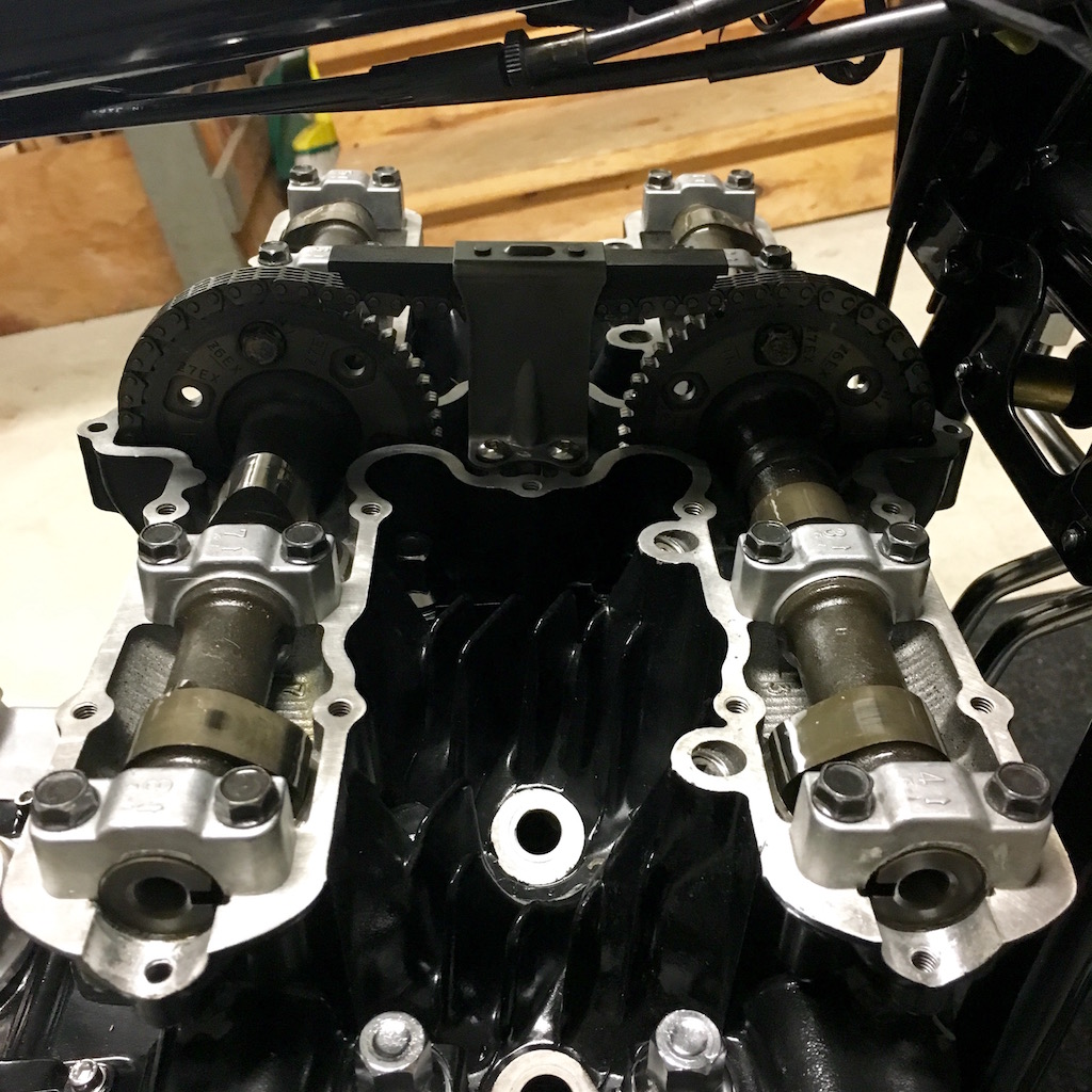

Using the Unitrak gpz/zx750 cams turned out to be easier than I thought in regards to valve shimming. Because the exhaust cam has a 1mm smaller base circle, I was afraid that I wouldn’t be able to find a shim thick enough to properly set the valve lash. But once I had a 3 angle valve job done on the head, it has sunk the exhaust valves enough that I was able to shim them all with a range of shims from 2.50~2.70.

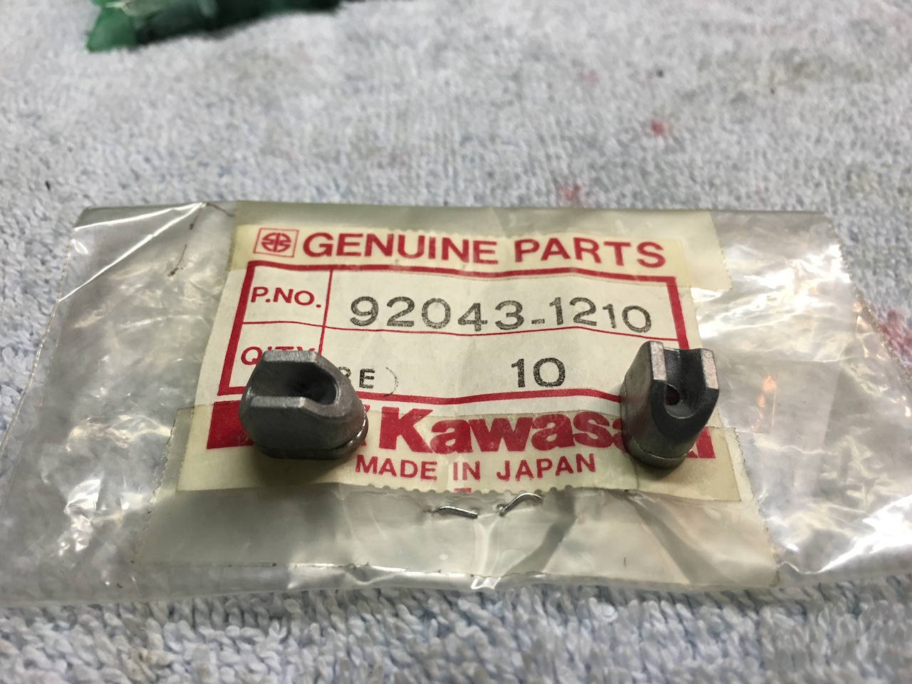

The intake side required that I have the valves stems trimmed in order to get the shims to fit and lash properly set. I made sure to use Viton valves seals all around.
I indexed the cams to the factory zx750 specs and temporarily used a zr-7 upper cam chain guide to verify that the cam timing marks lined up properly.
I am also using a Kreiger manual cam chain tensioner.
I also used a zr-7 cam chain (as well as the matching primary chain) that came in a lot of used parts I bought. The zr-7 chain showed to be exactly the same length as the original kz750 one, but it is of a slightly beefier construction.
**Side note: The zr-7 also has dramatically different internal cam chain guides. The front one extends all the way down to the very bottom of the engine case, but is designed to work around the primary chain tensioner the zr-7 uses, so it seemed I could not reliably make it work in my kz750 engine case. The rear guide is also longer but the tensioner area is shaped very differently and would have required making a custom cam chain tensioner. Just food for thought.**
zx750 cams installed with zr-7 guide to confirm proper timing.
Because I started to worry about oil leaks in the head from the additional oil pressure from the zr-7 pump, I decided to use the later style oil nozzles in the cylinder block that have wings on the sides that direct oil pressure/flow up and into the head thus protecting the oval o-ring from direct oil pressure. I’m hoping it will help prevent leaks.
Because I am not using any of the air injector equipment, I tapped the ports in the top of the head threaded in a 3/8” bung to keep exhaust gasses from creeping into the valve cover. I ordered what I thought were thick aluminum block off plates for the valve covers, but turned out to only be a couple of mm thick. So I cut the tops off the stock covers and filed them flat making a riser for the thin plates to sit on.

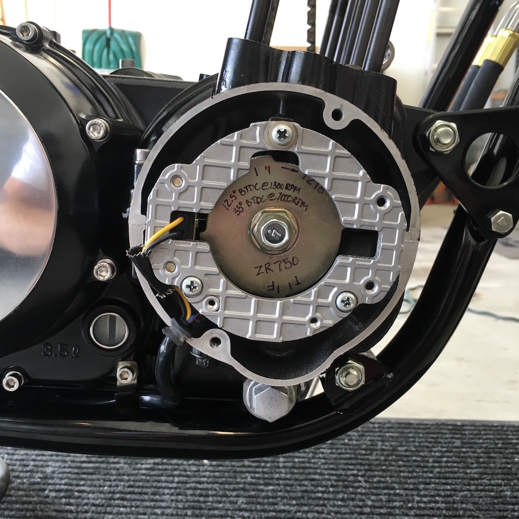

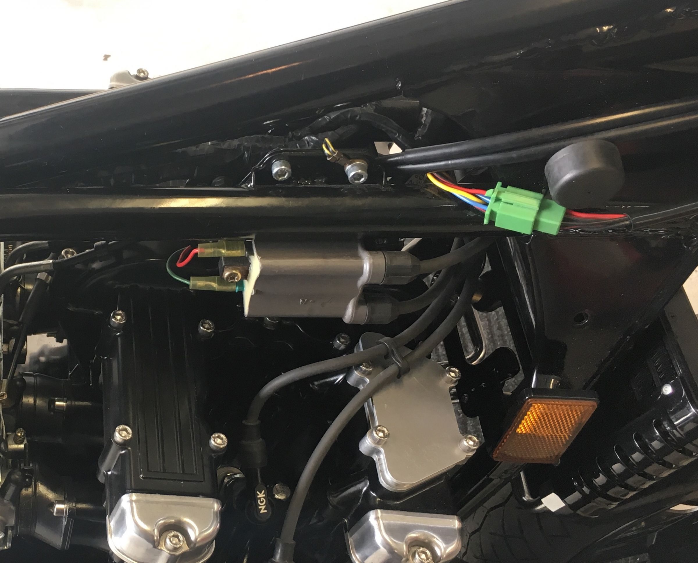

My ignition system is made up of a Zephyr 750 ignition timing rotor, and Zephyr 550 pickup coil, CDI and coils.
The bracket that the pickup coil is mounts on had to have the top mounting hole elongated in order for it to bolt up properly to my engine case. I had a bracket from both a Zephyr 550 and 750 and they are identical, but for some reason the kz750 engine case has the top mounting boss moved forward about 2mm. Beyond that, the ignition rotor, bracket and oil pressure sensor wiring bolts right up.
The coils fit almost as if they were designed to be there after drilling new mounting holes in the factory bracket.

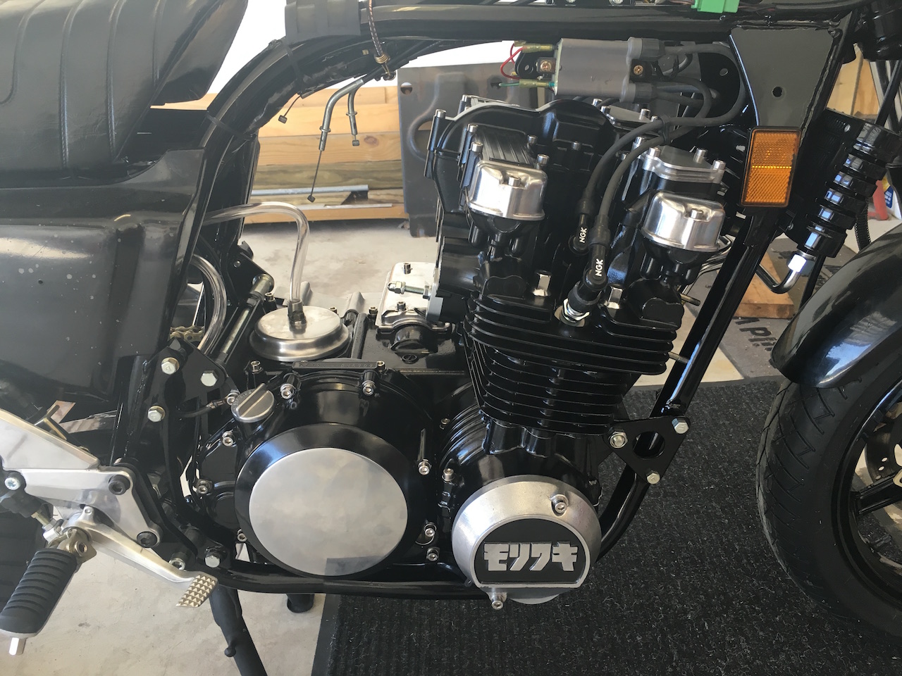

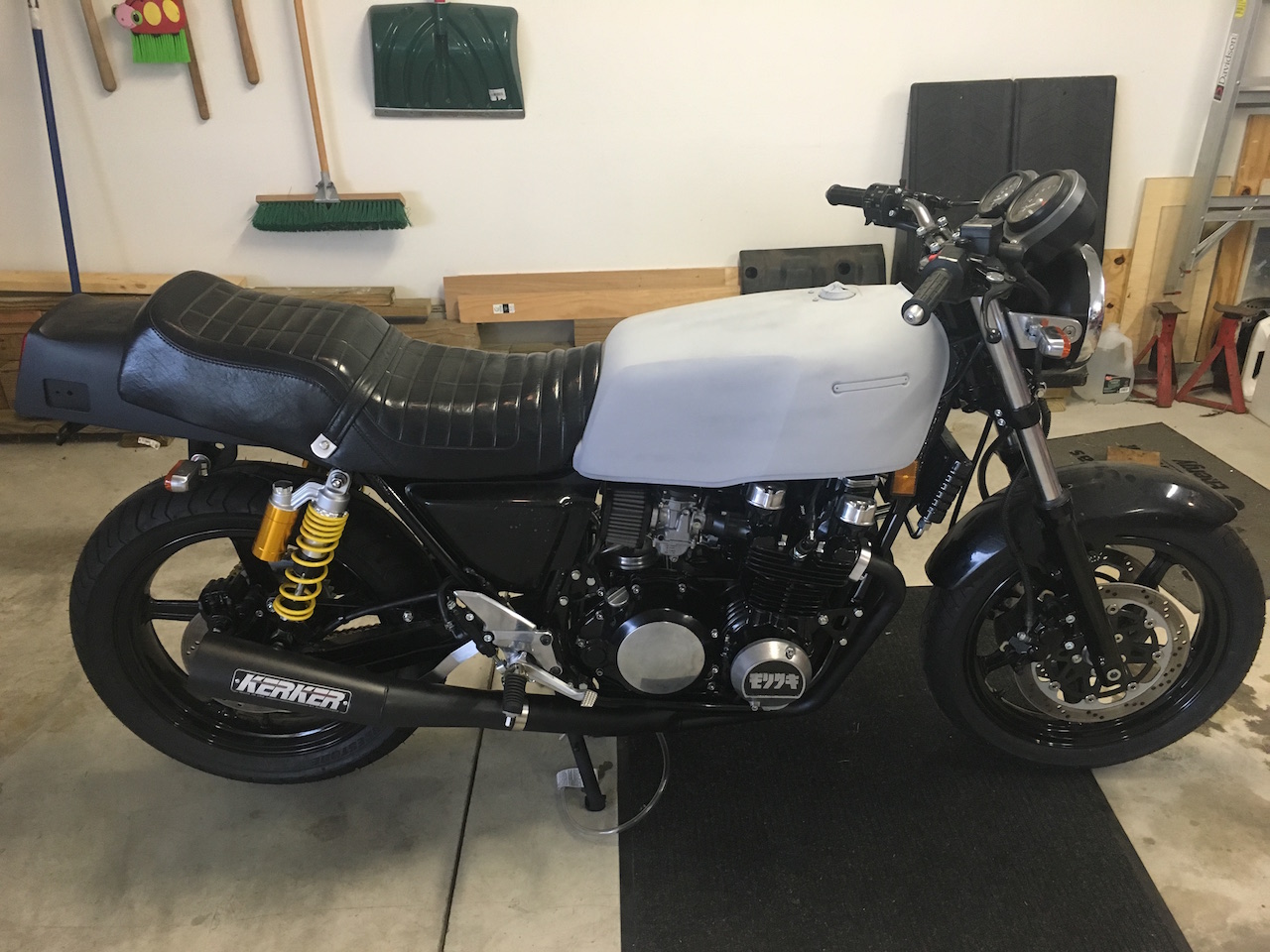

My gas tank has been Red-Koted but is not quite is ready for gas, so......
As long as my cheap pistons, custom wiring harness, pieced together ignition system, unproven carb settings and all the other "improvements" i have made don't totally fail me....this may start tomorrow.

You can order MLS head gaskets in almost any thickness you desire, that would be one way to get a modest rise in compression without touching the head..Same could be done with the base gasket as well... Nice build...

Nessism- I think I remember that thread and the issue brought up about the valve seats being so close and getting cut down when the head is skimmed. Thats the exact reason I bothered to post a picture of the valve seat, so I could illustrate just how close the seat is to the deck surface.
I was worried about it, until I saw the junk zr550 head I was practicing my porting on. It is totally stock and it has a fair amount of the Intake valve seat material removed from the factory deck cut. So I guess even more can be safely removed from the kz750 head before it gets dicey.
Stock zr550
NOTE:
In my earlier post I listed the valve seat that got cut into as the exhaust side. It is actually the intake valve seat.
But It won't let me edit the error in the post.
I CC'ed my combustion chambers after the valve job and they all are right at 25cc (+- 1cc) They are supposed to be 24.8cc from the factory, but the valves get recessed into the head after the seats are cut, so it seems about right.
I used an online compression ratio calculator, and I should end up at around 10.5:1 with the non-quench chambers and the smaller piston domes. Which is just fine by me.
Stock zr550
NOTE:
