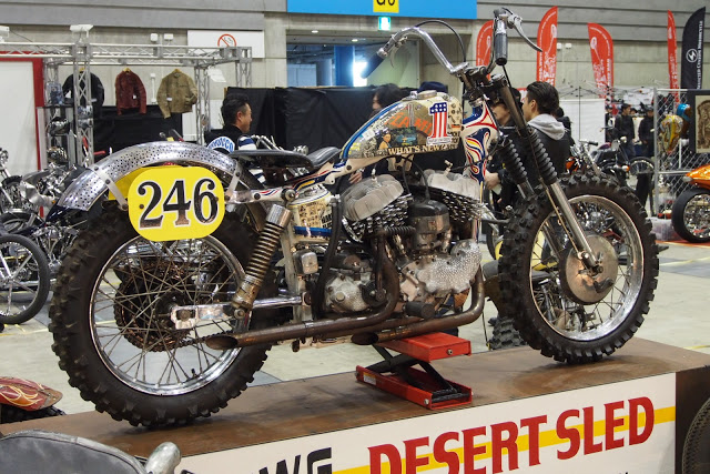

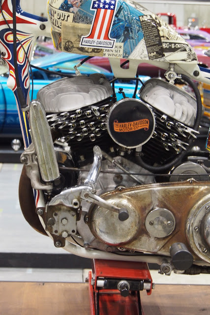

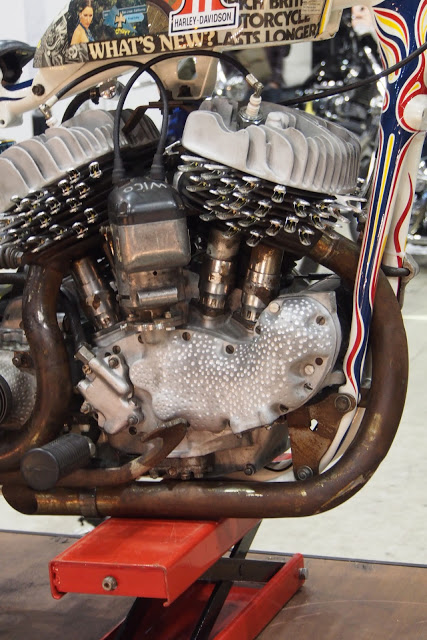

i searched for awhile yesterday to find the pics to illustrate what i'm talking about but couldn't.
i have seen pics from the vintage motorcycle scene in japan and noticed that some of the more race oriented looking bikes would sometimes have these aluminum looking clothes pin type deals clipped onto all of the fins ,side by side everywhere they could fit them.
seems like it would make sense that you are adding area but maybe disrupting the air more than necessary.
edit : found some pics.

wow, crocodile clips, and not even painted matt black. But the idea is there, just badly executed. Could be worthy of an experiment with an infra red thermometer, to see if it makes any appreciable difference.
I love the Japs engineering and a lot of their culture , but some parts of the custom bike scene in Japan is goofy beyond belief.
