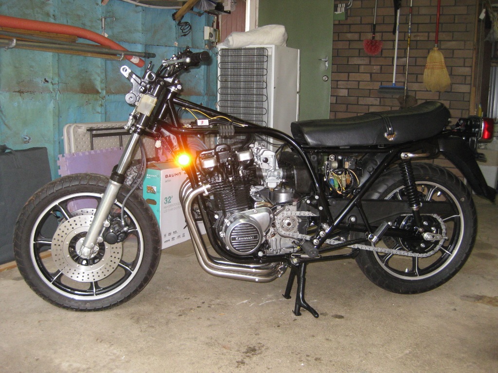

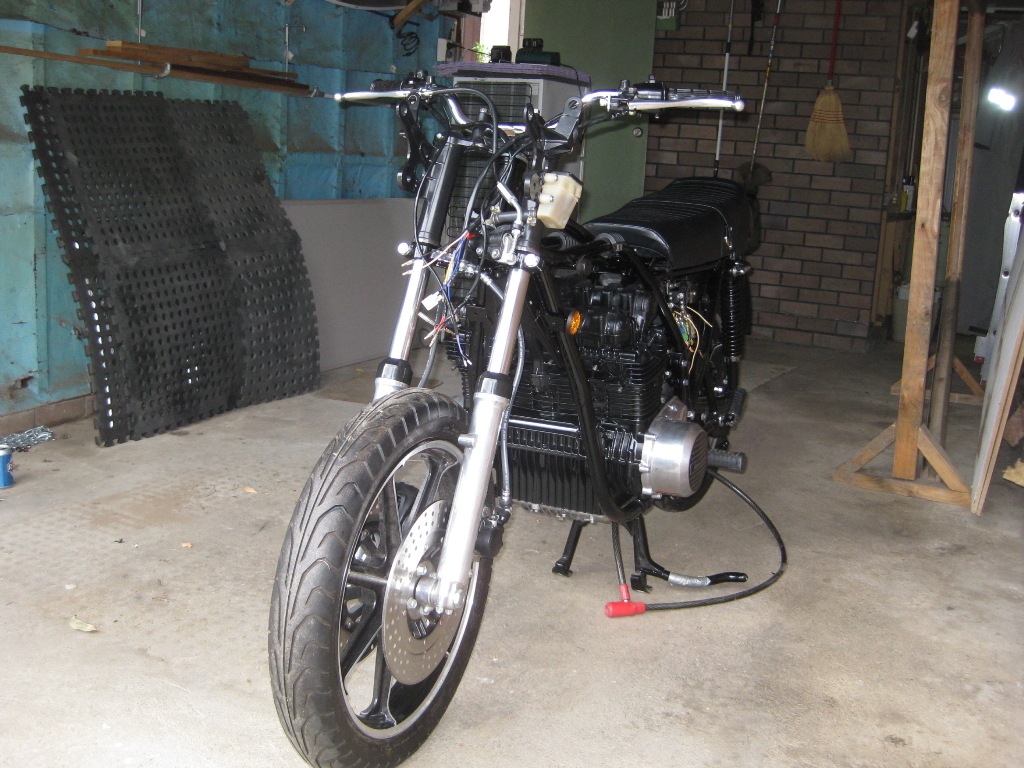

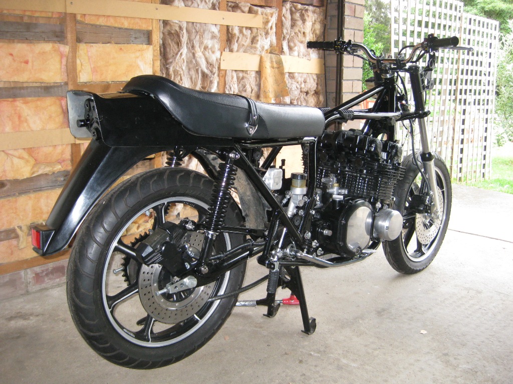

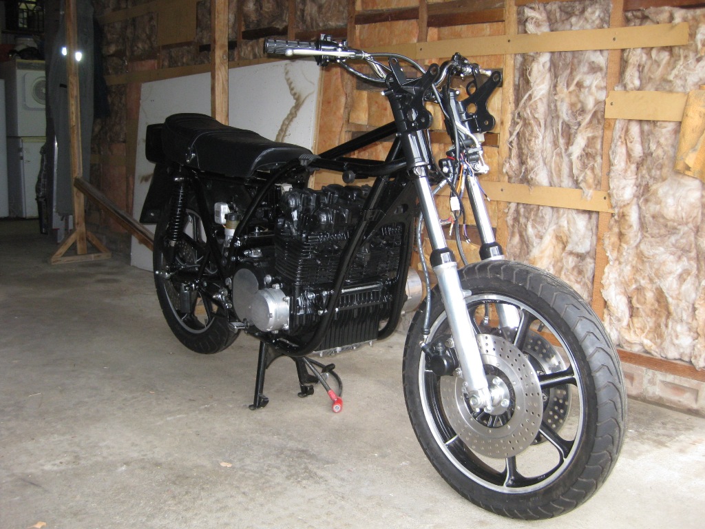

I had some time last weekend, I was able to re-unite the engine with frame.
Got my son and a mate to help get that big fella back where it belongs - took a bit of sweat and jiggling but it's in! :woohoo:
Cupla pics to prove it (otherwise it didn't happen - right...?)
Next step is to fit carbs (still finishing off the rebuilds with all new jets, o-rings, needles)

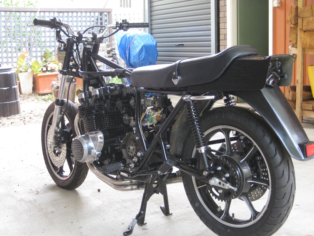

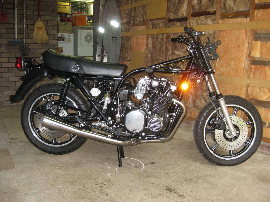

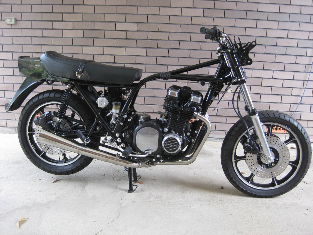

As promised here are a few pics of the Delkevic full SS 4:1 on my '78 Z1-R.
Very high quality system - welds are superb and the whole thing fits really snugly with nil mods required.
Delkevic don't actually have a dedicated system for Z1-R but the one that they sent which is for Z1000
fits perfectly - the footrest bracket for the silencer is P/N PR 2544 and is designed for KZ650 and KZ750
but it is spot on fit for the Z1-R.
The kit comes with a tube of high temp grease to assist with assembly, a spring puller
to load the collector to pipe springs and a centre stand "stopper' - yet to fit this as I don't have a z1-R stand yet.
Anyway - progress is happening!

Looking great....question
Motor on you z1r looks like a J Motor like the one that came on the 80 model . Had motor been change?

Yep, well spotted - it' a 79 Z1000A3 MK11 and is the motor that came with the basket case when I bought it.
Maybe if someone has a spare Z1-R motor they'd like to swap for my fully refurbished MK11
donk then we can do a deal? :silly:

The US bikes all seem to have shorter fenders, I thought my bike had a LTD rear fender, before I realized it was the Z1000's I was used to from the UK that had those long fenders. My Japanese built KZ650B1 seems to have longer fenders front and rear.
The bike looks great with what you have so far. I like the exhaust too, while the original would be nice to have, that one looks much better IMO.

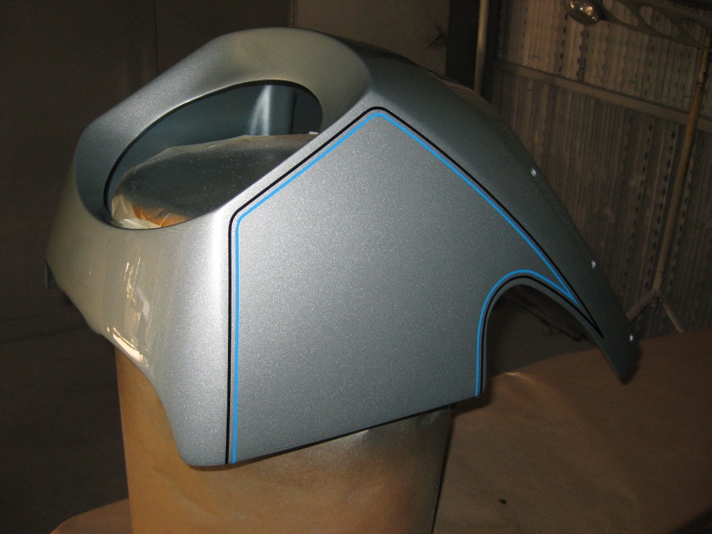

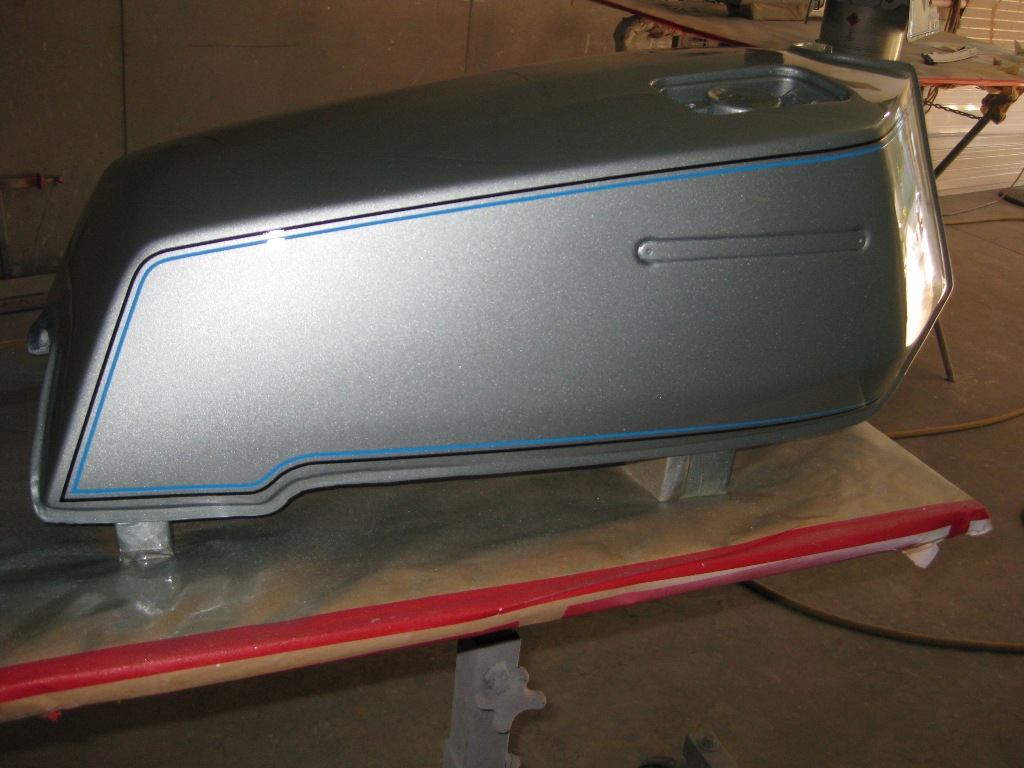

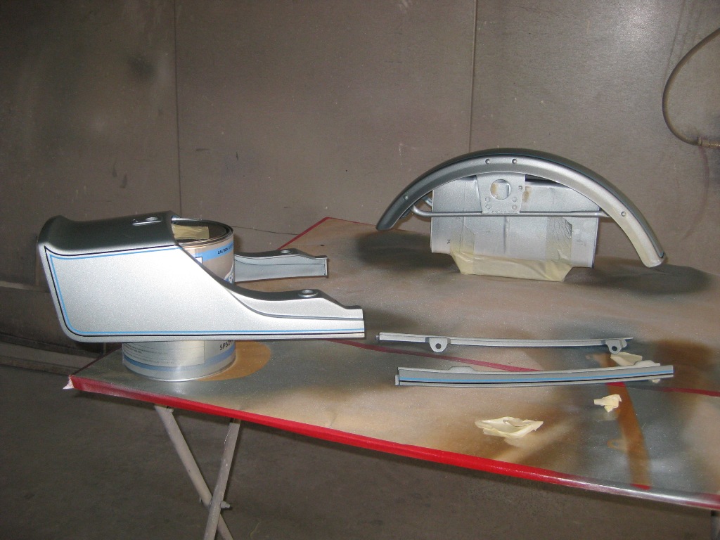

Made some progress recently - got the carbs rebuilt and refitted - will do the fuel level test when I get the tank back.
Got the bodywork back from the painter - cupla prelim pics also - will take some more when I get a chance to set 'em all out before refitting.
