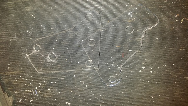

There has been progress this winter and will report on it later. Right now I am trying to fit GSX 1400 Bandit 4 pot Nissin Calipers on a Zephyr 750 fork, running a ZR-7 front wheel with ZXR400L 310mm brake rotors.
Sound easy? Yeah Right!
I would probably had chosen another route if had known what I know now. :pinch:
Ok caliper mount cc on the Zephyr fork is 55mm, the Nissin mounts are 90mm cc.
There is not much space between the rotor and fork leg, ca 6 mm on each side. Not enough to fit a bracket on the inside if I want to secure it with a nut (I could probably mill off 5mm of the inside of the fork leg mount without losing integrity, but the Nissin caliper mount holes are treaded and want’s the bracket to go on the outside)
So the bracket has to go on the outside of the caliper mount on the fork leg and outside of the caliper. The Zephyr caliper mounts are of course countersunk.
So inspired by DoctoRot and Leon’s ideas in DoctoRot’s Saving a 750 Twin, maybe I could fix the fork in the mill and shave of the countersunk holes, fab an outside bracket to fixate the caliper with.
Tried to find something to make a template of and found some packing plywood lying around in the snow. Wet, cheap plywood is probably not the easiest material to make a template of but it had to go.
Sure, a bit crude
And fitted it might work, even though the bracket doesn’t line up on the fork leg because of the countersunk.
Milling down the countersunk will move he bracket 7 mm closer to the rotor and if I use 8mm 6061 Alu sheet I need to fit two 5-7mm spacers between the bracket and the caliper in order to center the caliper correctly over the rotor.
Or does anybody have any other ideas? :blink:

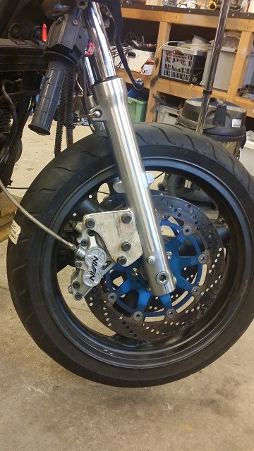

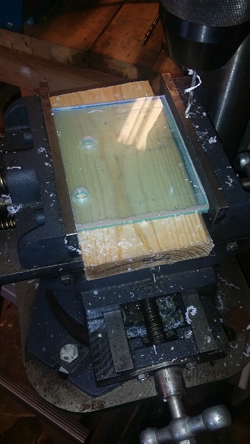

It all looked so simple when Dr Root posted the templates he made in Acrylic plastic for his brake caliper bracket, so I tried out the same route. Darn it’s hard to figure out where the caliper shall go in reference to the fork leg.
After playing around with the plastic and producing serious amount of shattered glass.:blink:
It actually started to look like something that could be tried on and the position of the caliper could be decided.

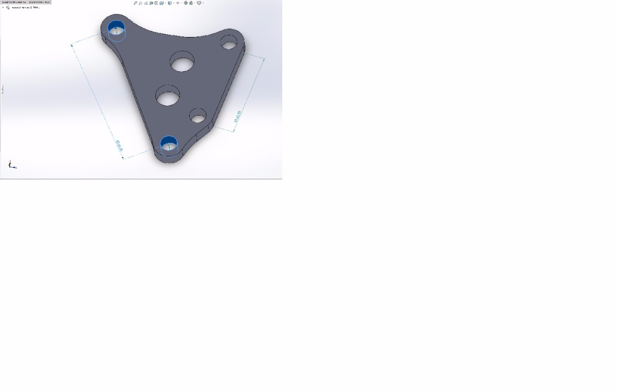

So with a template of plexi I went home and sought the support of my seventeen year old daughter who’s in a technical college. Within a few minutes she had sketched up just what I need. Damn I like that girl!
So with the CAD drawing on a USB memory and a sheet of 6mm 6061 Aluminium I went to another fancy shop around the corner that sports a water cutting machine this Monday.
This morning I went by and picked up the result, bad ass can’t wait until Saturday when I can go to Erik’s garage and try them on.:woohoo: :woohoo:
