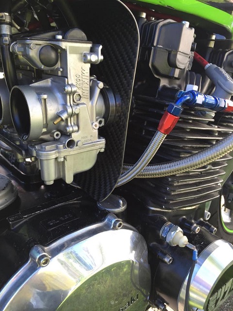

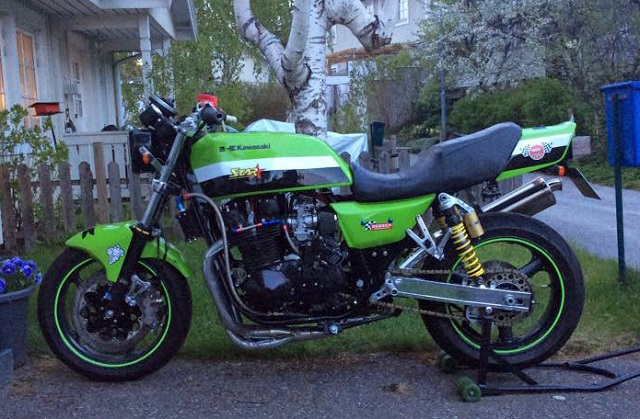

Yes the engine does fit with some minor alterations to the frame. It fits nicely when done. I can even take the top end off without removing the engine from the frame. I was also told it would not fit but I am one of those weird people who just tries it anyway to prove it can be done. I wanted it as light as possible and managed to get it at 420 pound with fuel. It has about 125 HP so the power to weight ratios is around 3.36 HP per pounds. I am really pleased with how it came out. Here are some pics

24 Aug 2016 22:17baldy110 wrote: Yes the engine does fit with some minor alterations to the frame. It fits nicely when done. I can even take the top end off without removing the engine from the frame. I was also told it would not fit but I am one of those weird people who just tries it anyway to prove it can be done. I wanted it as light as possible and managed to get it at 420 pound with fuel. It has about 125 HP so the power to weight ratios is around 3.36 HP per pounds. I am really pleased with how it came out. Here are some pics
Damn, I wish I knew that last year when a beat up, seized, and moldy 82 GPz750 came up for sale here last year. I won't pass up the next one, though.
Now I'm thinking how much fun a 420 lb. GPz1428 cc Big Block, 200 RWHP Lime Green "GPz750" would be....

With regards to Z1000/Gpz1100 implants in Gpz750R1’s, look at the pics of Tommy’s bike
Tommy didn’t drop the frame though when he implanted the 1100 engine, so he has to take the engine out in order to set the valves.

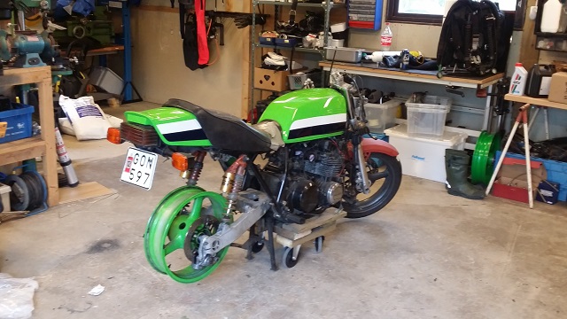

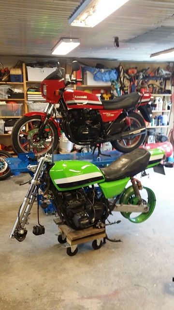

I on the other hand, is ashamed of my slow progress but was mocking up the bike today when I paid Erik a visit.
As you can see, the only thing better than a Gpz750R1, is two
(note that Erik’s R1 gets to ride the new Chinese lift table, whereas mine is still on the Ugandan model)

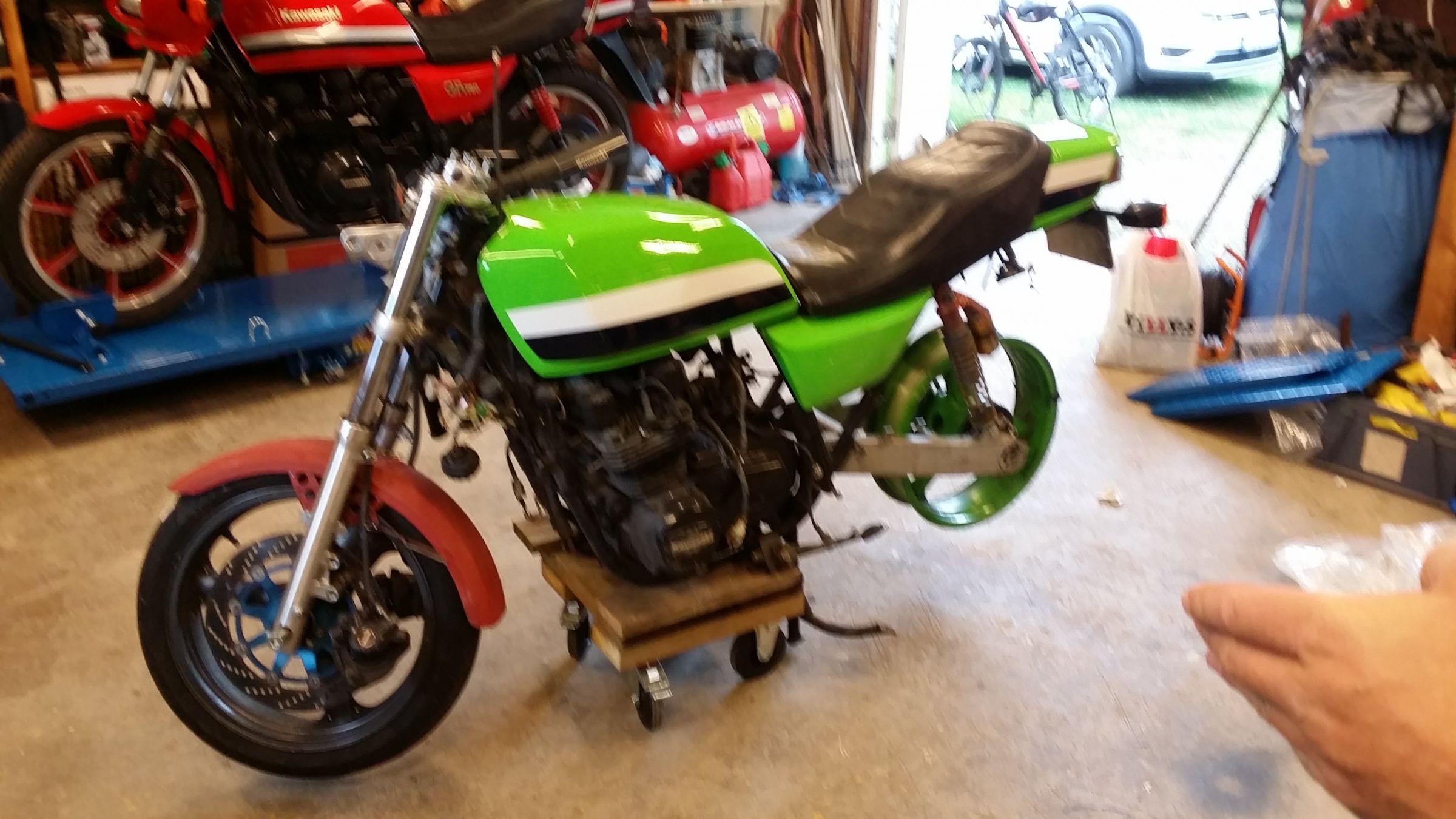

X-cuse the shitty pic, but I had to mock up the front wheel with the original front fender that we have split and widened by 1’. It will take some more fabing before we get a perfect fit on the Zephyr fork and it might look a little bit awkward with the 17' rim, but then we just have to come up with something else.
No real job got done, but we measured up a whole lot of stuff that we are going to get started with now that days are getting shorter.
